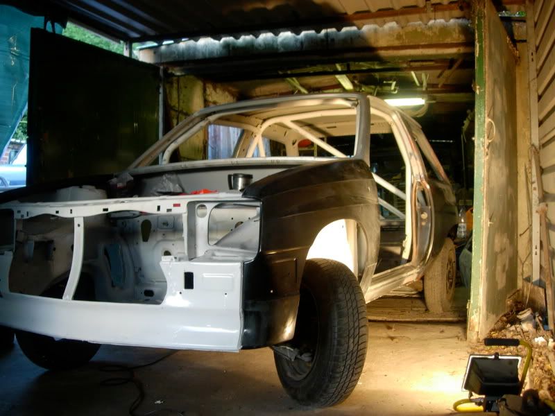

First off we fitted the front wings. We had quite a few issues with them not sitting properly and catching in places as expected for pattern parts, but nothing a bit of grinding and filing didn't sort.
Wings on and stonechipped the insides too
http://img.photobucket.com/albums/v3...a/DSCN2275.jpg

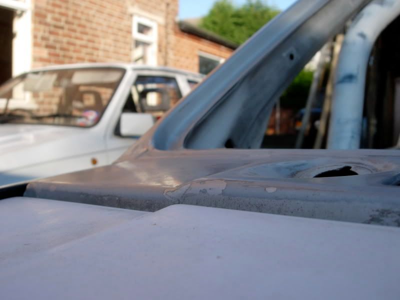

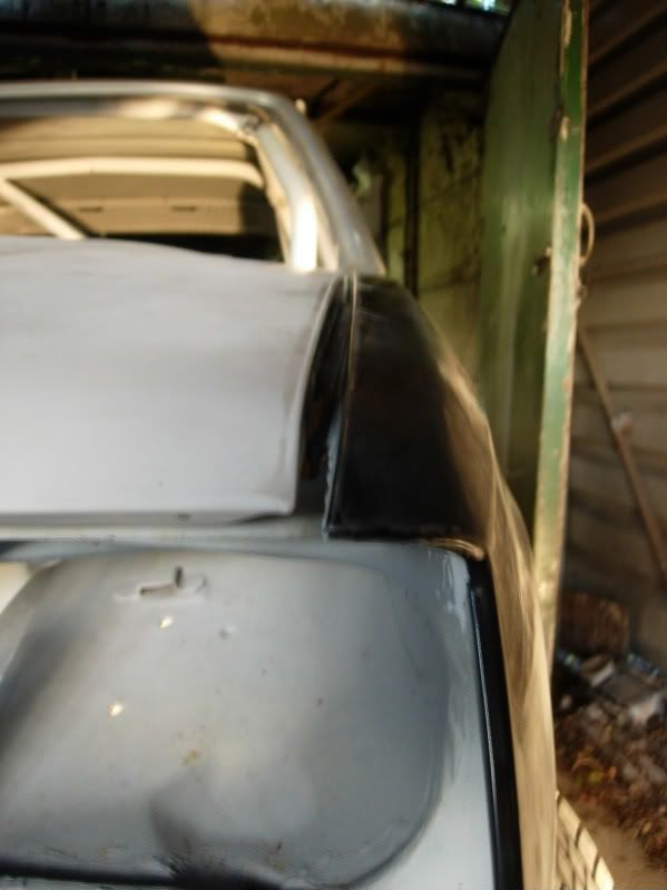

Rested bonnet on to see how straight the wings sat (I know theres a bigger gap on one side compared to other but thats just because we rested the bonnet on and it wasn't sat exactly in the middle!)
http://img.photobucket.com/albums/v3...a/DSCN2277.jpg
http://img.photobucket.com/albums/v3...a/DSCN2278.jpg

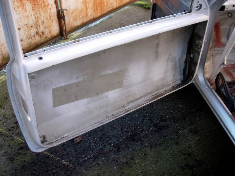

Finished cutting the doors out
http://img.photobucket.com/albums/v3...a/DSCN2272.jpg

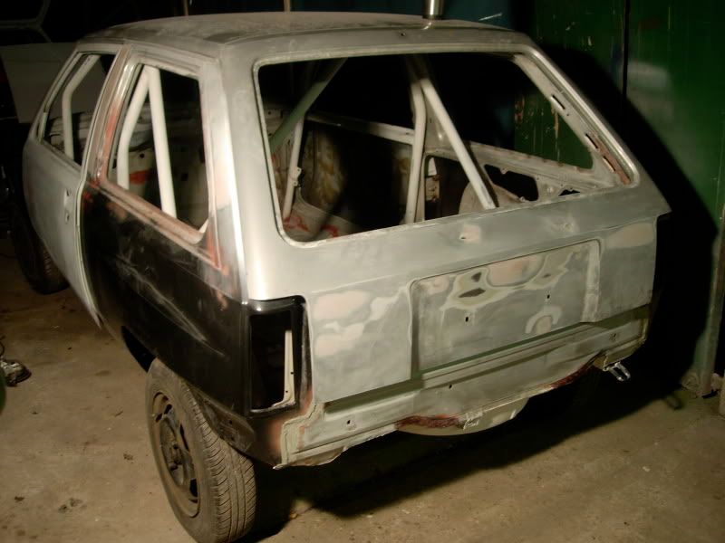

Then fitted them and fettled with the wings again to get the best pannel gaps we could. Then got the tailgate on
http://img.photobucket.com/albums/v3...a/DSCN2279.jpg

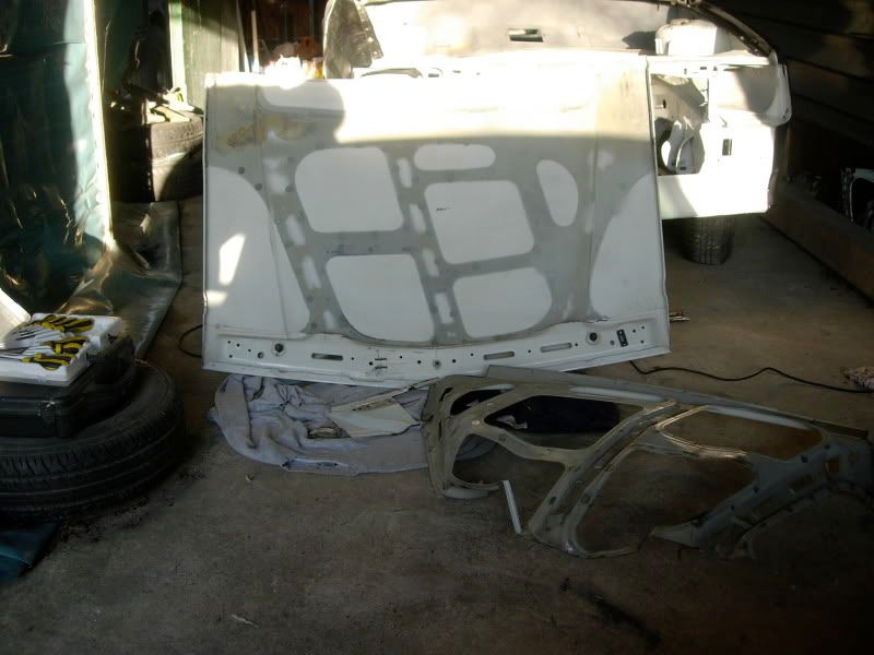

And finally chopped the strengthening out the bonnet to lighten it
http://img.photobucket.com/albums/v3...a/DSCN2297.jpg

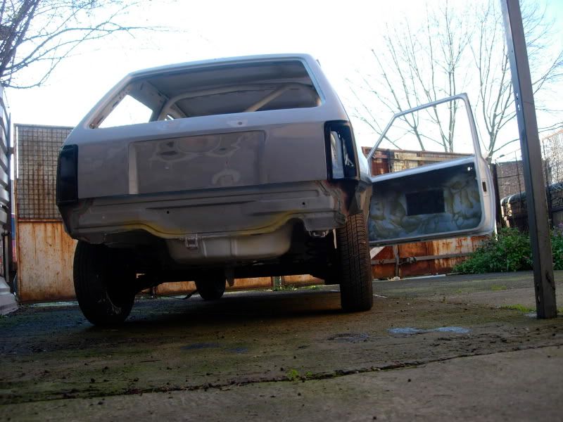

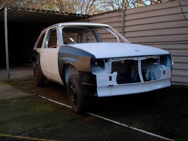

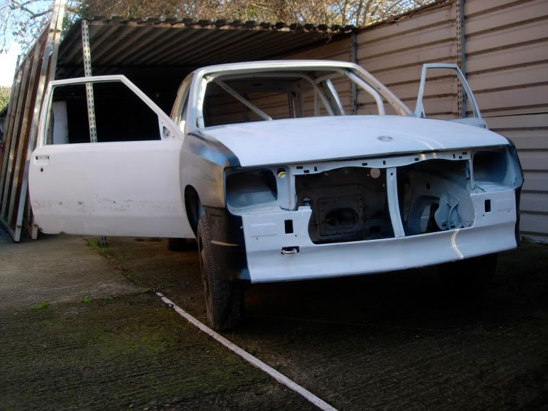

Then just finished of some filling and sanding and general tidying up. Heres a few pics of the car that now once again resembles a nova!!
http://img.photobucket.com/albums/v3...a/DSCN2284.jpg
http://img.photobucket.com/albums/v3...a/DSCN2286.jpg
http://img.photobucket.com/albums/v3...a/DSCN2288.jpg
http://img.photobucket.com/albums/v3...a/DSCN2291.jpg

proper neat job on gutting out the doors mate, look wicked :thumb:
