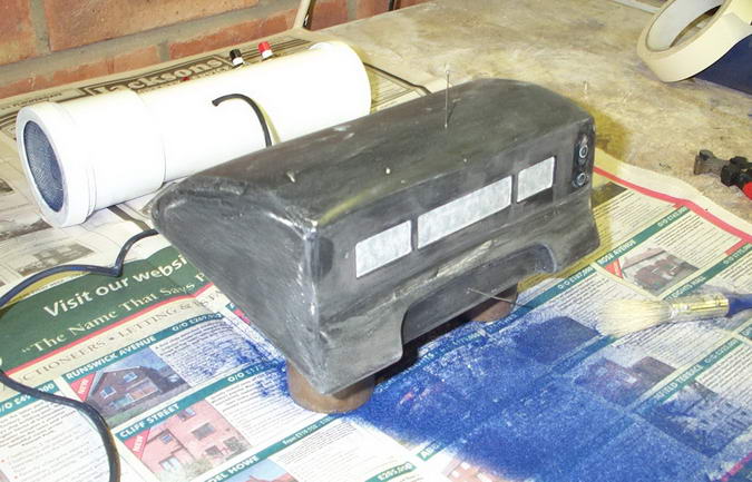

Talking of which the ash tray cover is now going to house the air temp / time / date readout
which normally lives on the top of the dash - pic :-

When I am happy with the overall fit and smoothness of the whole of the dash I am going to start flocking.
I will give the ashtray concept the first flock in blue just to see how it comes out, and if there are any
problems it isn't too big to rub down again!

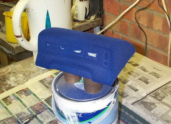

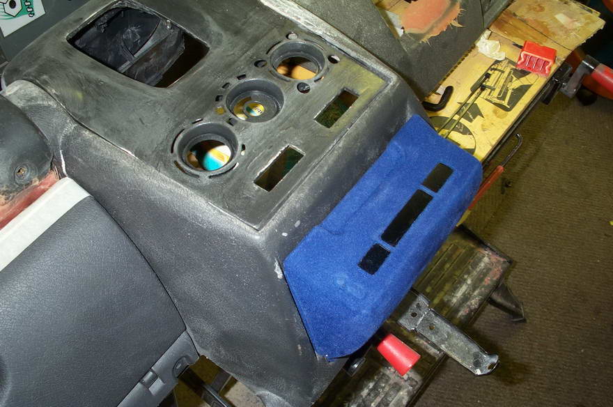

Right .... been sorting this flocking business out!!
I have finished the ashtray which looks like this :-
http://www.elsamak.karoo.net/Ash1a.jpg
It then got flocked which looked like this :-

And it fits in the dash like so :-
http://www.elsamak.karoo.net/Ash3a.jpg
Quite happy with the results so far!
Joff
