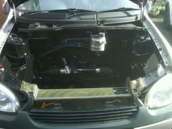

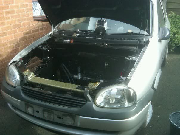

From there it was all engine bay & front end work really. Undersealed an cleaned out the inner archs, changed washer pump from twin outlet to single, cleaned the washer bottle out, cleaned down & prepped the bay etc etc
http://i80.photobucket.com/albums/j1...er/granola.jpg
http://i80.photobucket.com/albums/j1.../hamburger.jpg
http://i80.photobucket.com/albums/j1...er/pornage.jpg
http://i80.photobucket.com/albums/j1...acker/bay2.jpg
http://i80.photobucket.com/albums/j1...nacker/bay.jpg

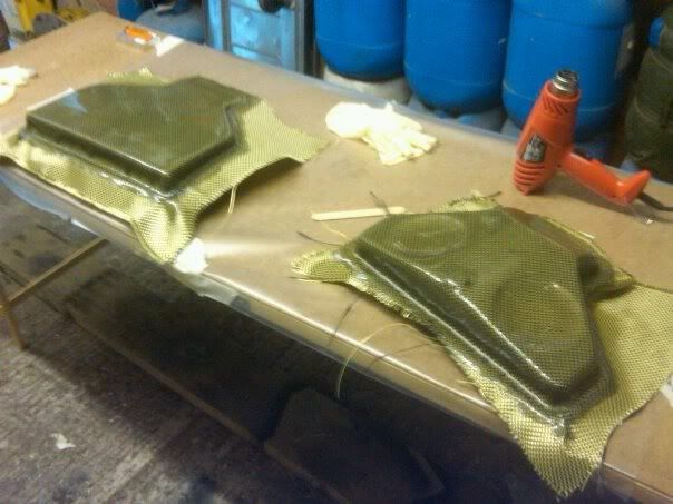

Monday just gone I was really REALLY bored at home but the weather was poop. Staring at the roof vent I had something was amiss......
Just woundnt've looked right if Id have fitted it painted up as it was so I had a master plan.
Carbon kevlar wrap it :)
http://i80.photobucket.com/albums/j1...cker/vent1.jpg

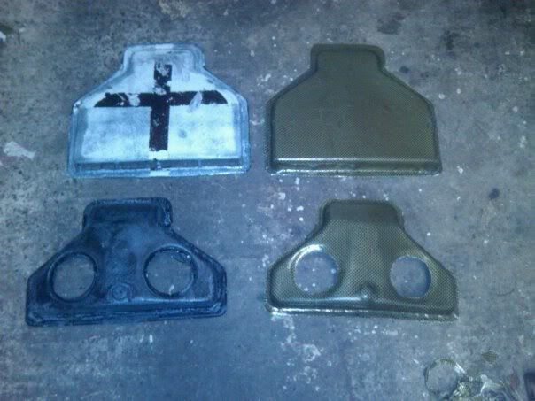

But the master plan got even better by a complete random chance of luck! The epoxy Id put on the vent reacted with the paint turning it into goo so once the kev set hard I could prise it off (WIN!) and end up with x2 roof vents!
http://i80.photobucket.com/albums/j1...cker/vent2.jpg
Once removed I reinforced the inside of the vent with some roving & black out epoxy....
A quick spray wax & buff later....
http://i80.photobucket.com/albums/j1...cker/vent3.jpg
With the Fiat directional vents attached the complete kit weights in at a shade over 480 gram's.
