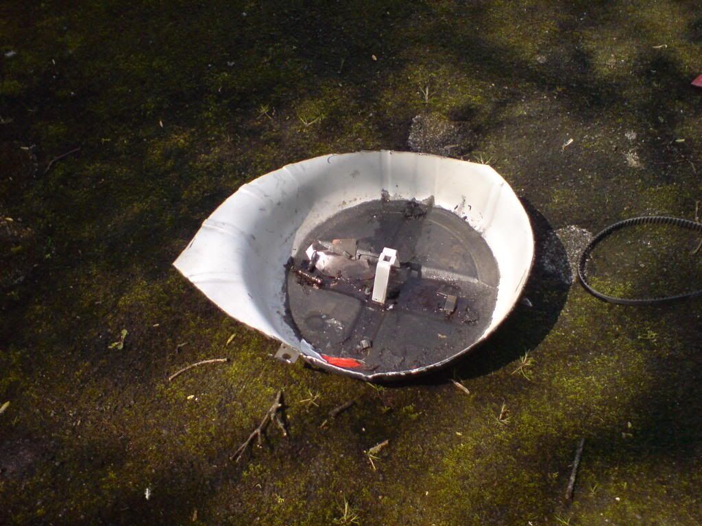

this is a crack (the so called porus) head..

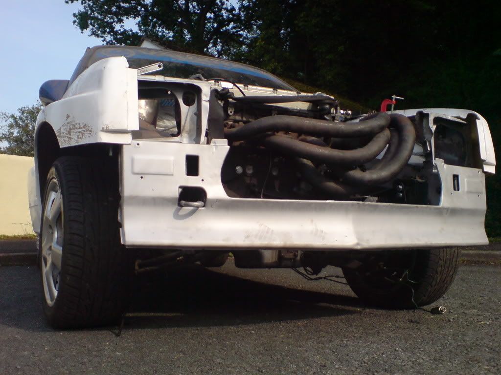

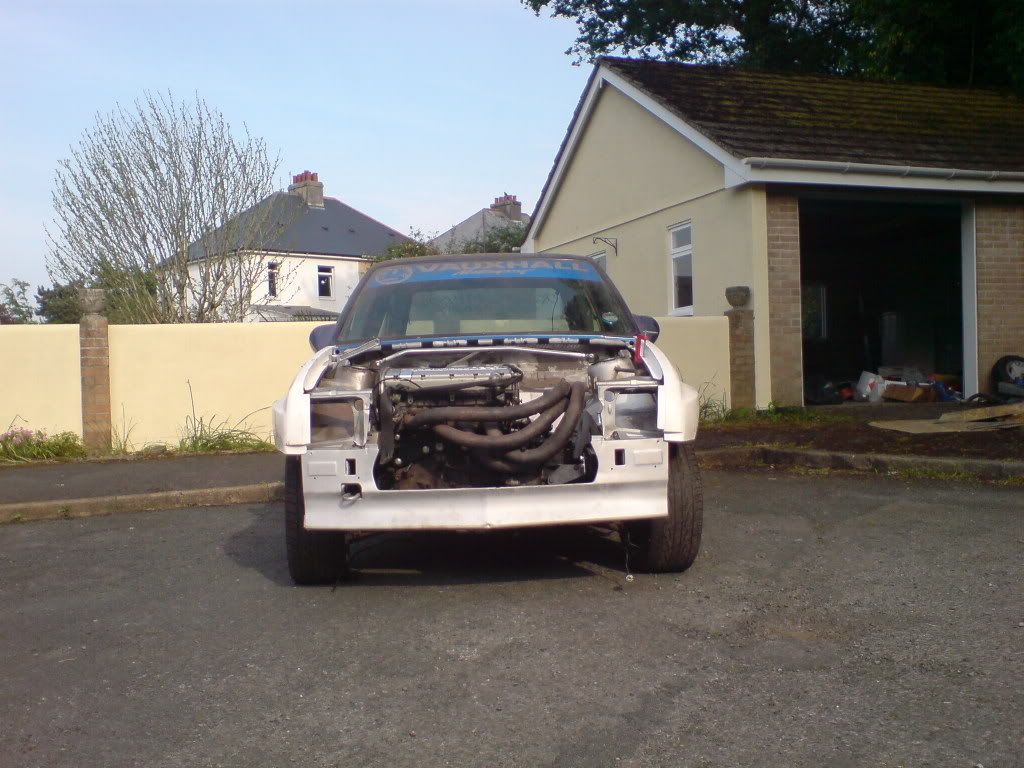

Then it came to mounting the engine in the car to weld the six speed mount into place.
(this first bit is copied from my other tread )
Bought this conversion kit little under 2 years ago
http://cgi.ebay.co.uk/ws/eBayISAPI.d...MEWA:IT&ih=013
And yesterday my and a mate went to fit the engine alone with a f28 to weld the 6 speed mount into place. Thats what we thought, we bolted the drivers side mount on first all seems good. Then to the rear mount which took us about 2 hours to get it in line with the hole to put the bolt through. we done that and all still seemed ok untill we tryed the 6 speed mount and went down hill from there. And the 6 speed mount was bought from C Ashley so we know that will be fine and the gap was about 1 - 1 1/2 inches to short for the mount to fit :eek: and chris drilled the holes abit to close together for the bolts to line up with the rubber mount so off it came anyway to make one of the holes big enough so i can get both bolts in the hole. So then we taken the drivers mount off and put just the 6 speed mount on and pushed the engine over to the left and could not get the drivers mount on at all. So we thought wtf is wrong and then looked at some projects treads and other mounts for sale. then it hit us they sent the corsa mount :mad: And that left me with hours of work for nothing :cry: Well here are a few pics to show you anyway.
When i first put the engine in on just the drivers mount
http://i241.photobucket.com/albums/f...va/bigs123.jpg
http://i241.photobucket.com/albums/f...va/bigs121.jpg
And just the 6 speed mount on the leg which fits very nice
http://i241.photobucket.com/albums/f.../bigs013-1.jpg
http://i241.photobucket.com/albums/f.../bigs012-1.jpg
http://www.pngclub.com/forum/new3.5/buttons/edit.gif http://www.pngclub.com/forum/new3.5/buttons/quote.gif http://www.pngclub.com/forum/new3.5/...quickreply.gif
And because we were so mad and needed cheering up we decided to fit my manifold to see what it looks like :D I will be cutting out the slam panel to so dont worry about it being abit close on the pass side.
http://i241.photobucket.com/albums/f...va/bigs007.jpg
http://i241.photobucket.com/albums/f...va/bigs009.jpg
http://i241.photobucket.com/albums/f...va/bigs008.jpg
http://i241.photobucket.com/albums/f.../bigs011-1.jpg
http://i241.photobucket.com/albums/f.../bigs010-1.jpg
And then orderd the 2ltr mount for chris ashley to sort the problem out
Then a few days later this came in the post :D
http://i241.photobucket.com/albums/f...newnova005.jpg
So then started right away to finsh mounting the engine and gearbox. heres the pic of the mount in place
http://i241.photobucket.com/albums/f...wnova006-1.jpg
then ck welding the six speed mount into place after we got the car level then the engine
http://i241.photobucket.com/albums/f...wnova007-1.jpg
and to make sure the engine wasnt going to move i filled the mount up with tigerseal
http://i241.photobucket.com/albums/f...ltrbits071.jpg
and the mount spot welding in place intill i take the engine out and fully weld it allround
http://i241.photobucket.com/albums/f...wnova009-1.jpg
here you can see ive cut the slam panel out so it dont hit the manifold
http://i241.photobucket.com/albums/f...wnova008-1.jpg

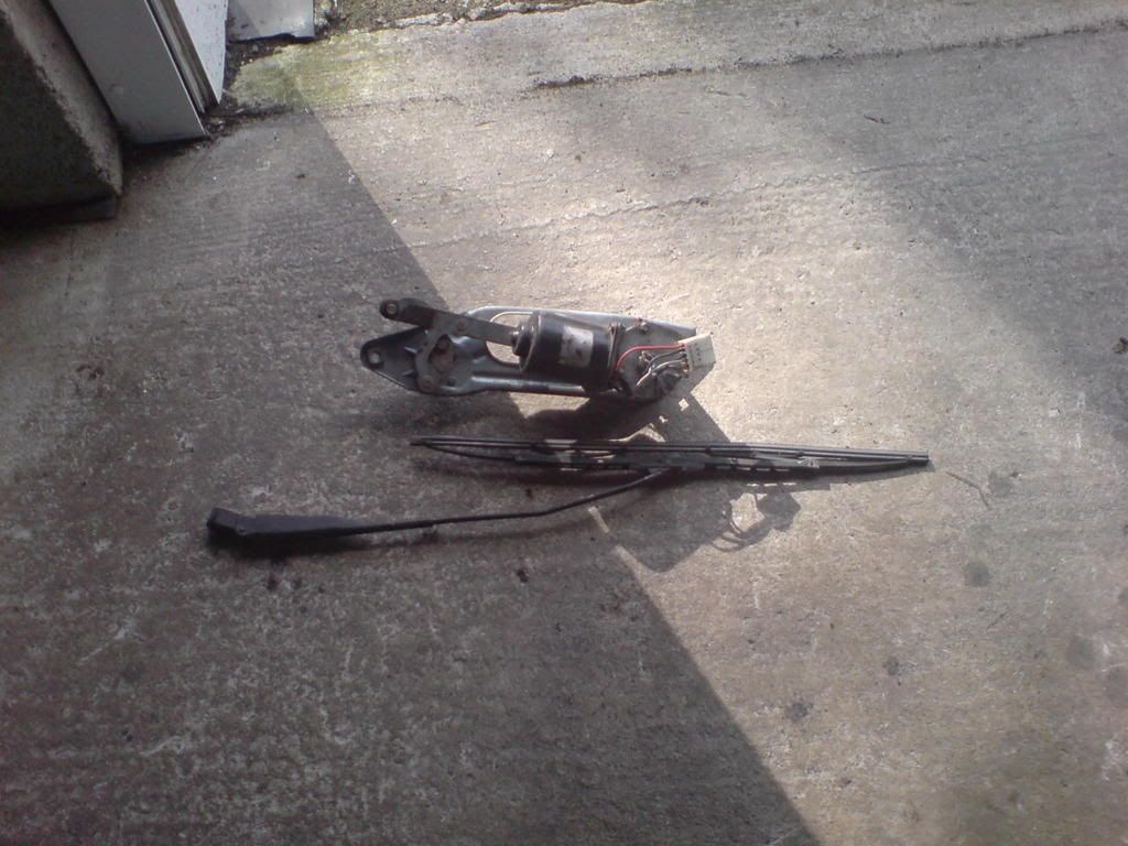

ax gt single wiper motor
http://i241.photobucket.com/albums/f...ltrbits063.jpg

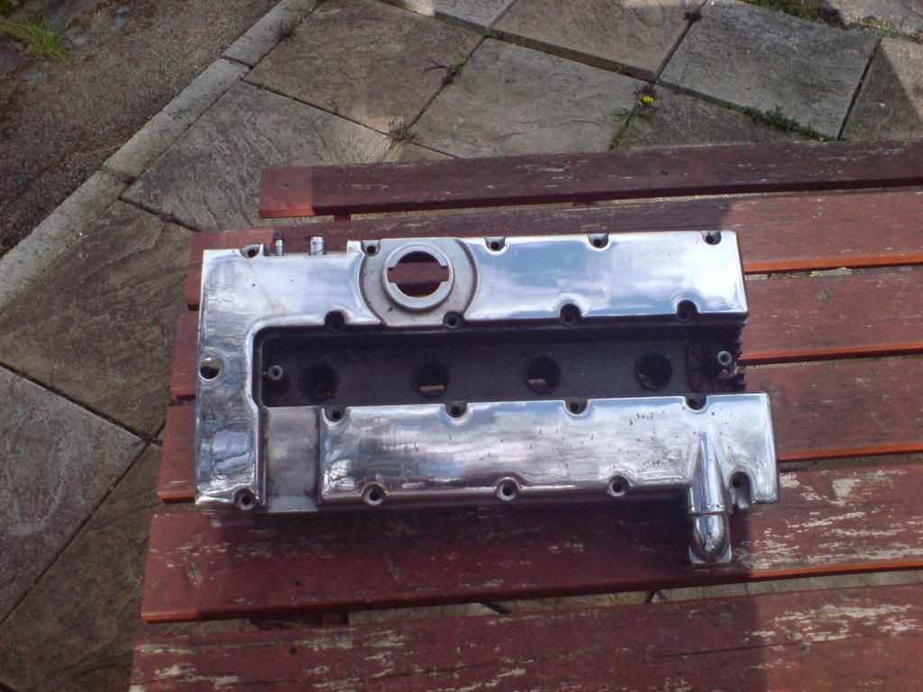

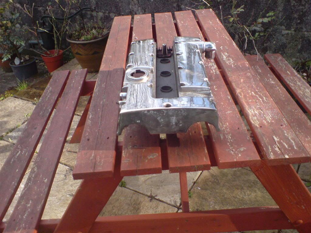

modified cam cover ( can you work out whats different )
http://i241.photobucket.com/albums/f...ltrbits066.jpg
http://i241.photobucket.com/albums/f...ltrbits065.jpg

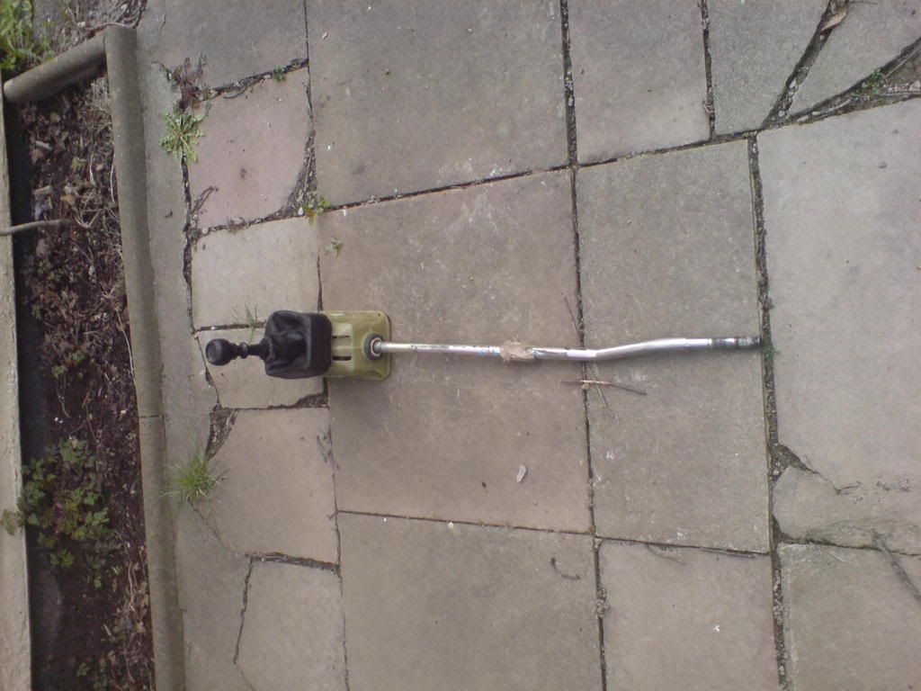

cavi turbo six speed gear shifter
http://i241.photobucket.com/albums/f...ltrbits070.jpg

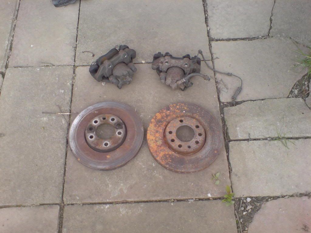

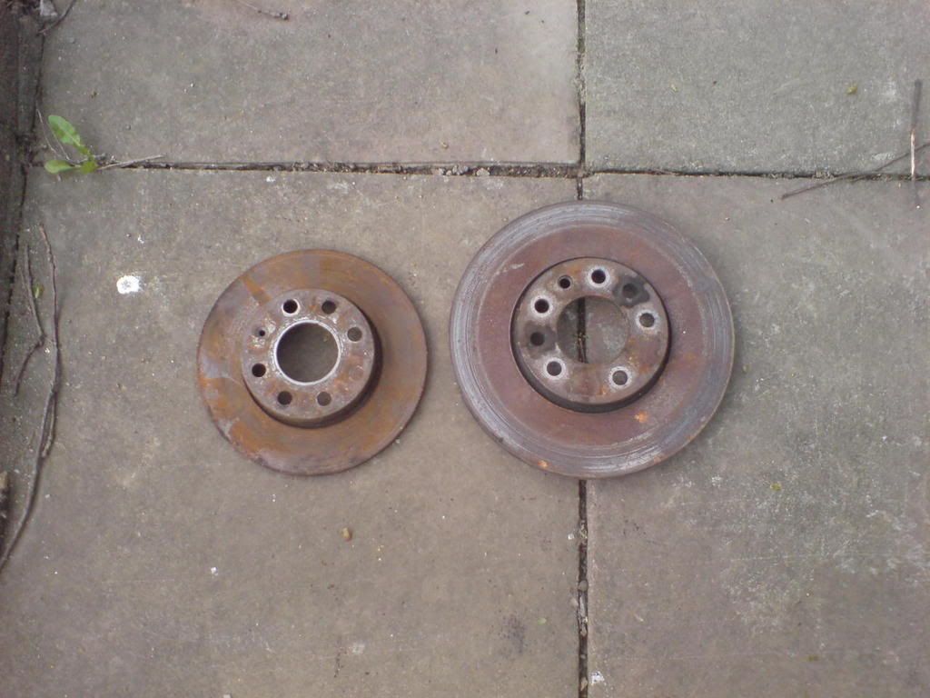

vectra v6 brakes
http://i241.photobucket.com/albums/f...ltrbits067.jpg
beside nova gte disks
http://i241.photobucket.com/albums/f...ltrbits068.jpg

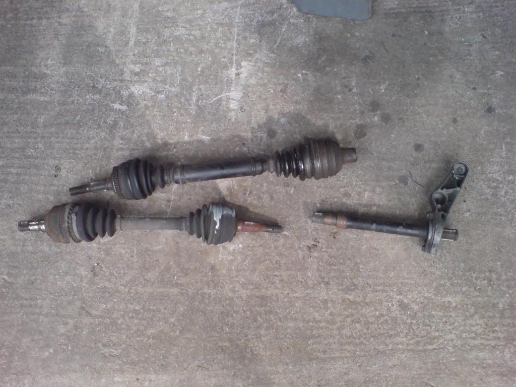

six speed fwd conversion kit
http://i241.photobucket.com/albums/f...ltrbits075.jpg

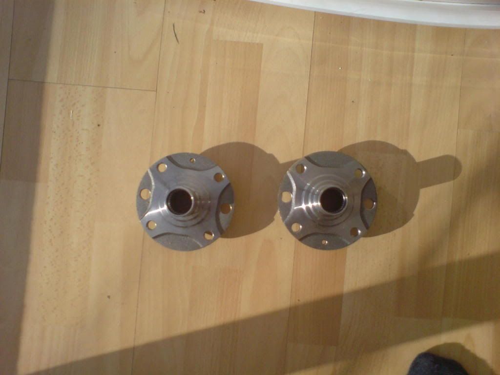

conversion hubs
http://i241.photobucket.com/albums/f...ltrbits074.jpg

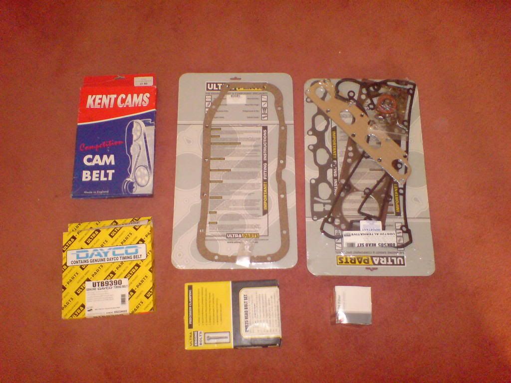

full gasket kit
http://i241.photobucket.com/albums/f...ltrbits078.jpg

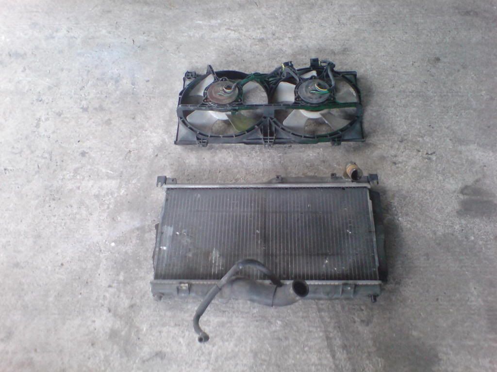

maxda rx7 twin turbo rad and twin fan
http://i241.photobucket.com/albums/f...ltrbits046.jpg

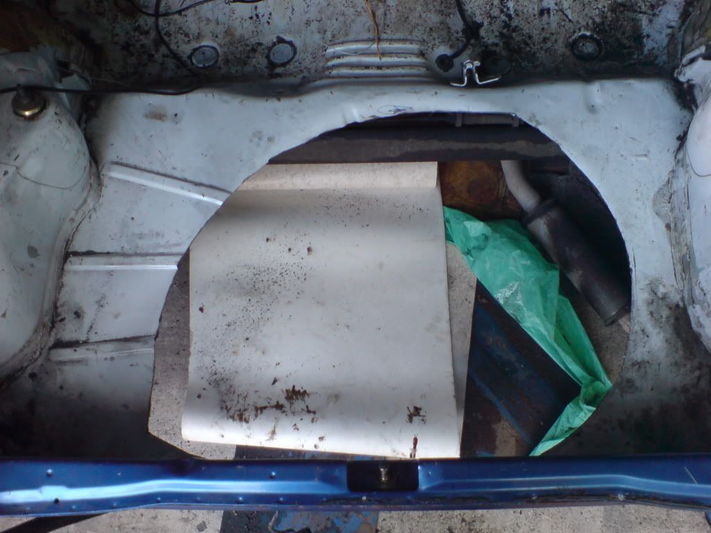

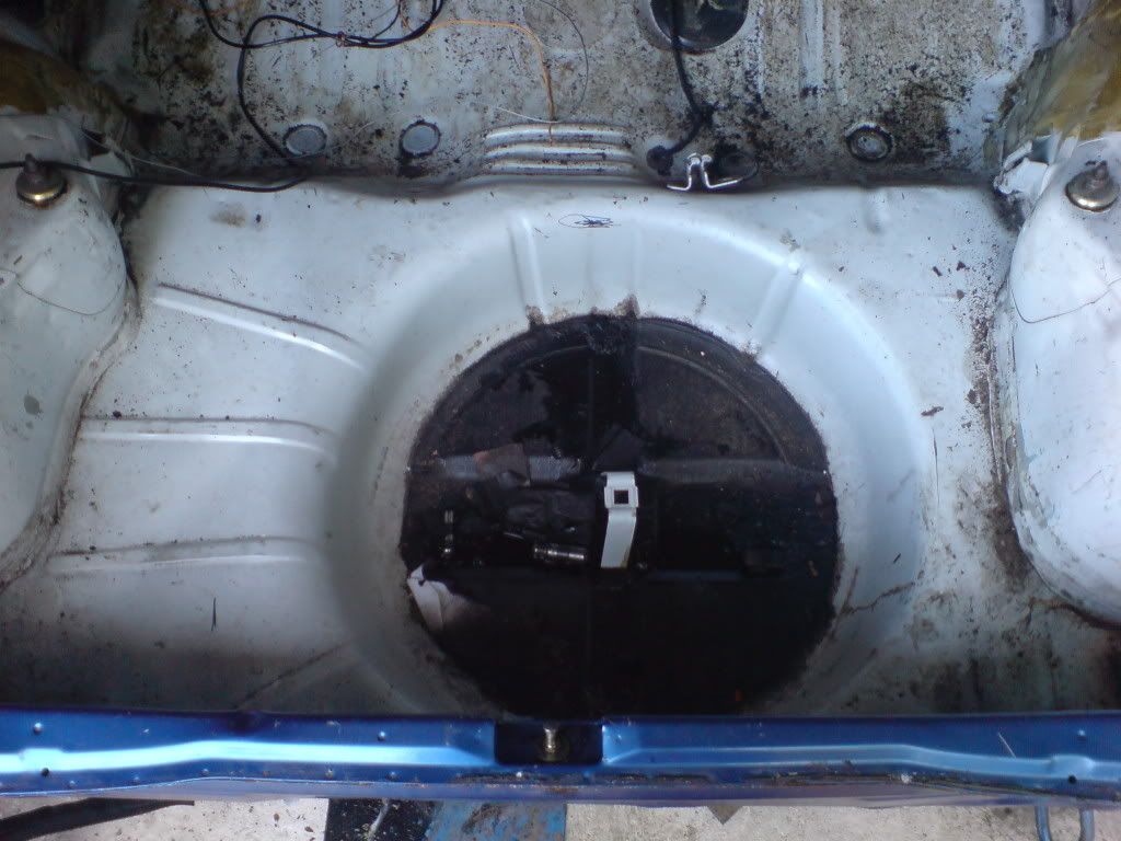

and here ive started cutting the spare wheel out ready to put the rad in the boot
http://i241.photobucket.com/albums/f...va/bigs030.jpg
http://i241.photobucket.com/albums/f...va/bigs031.jpg
http://i241.photobucket.com/albums/f...va/bigs032.jpg

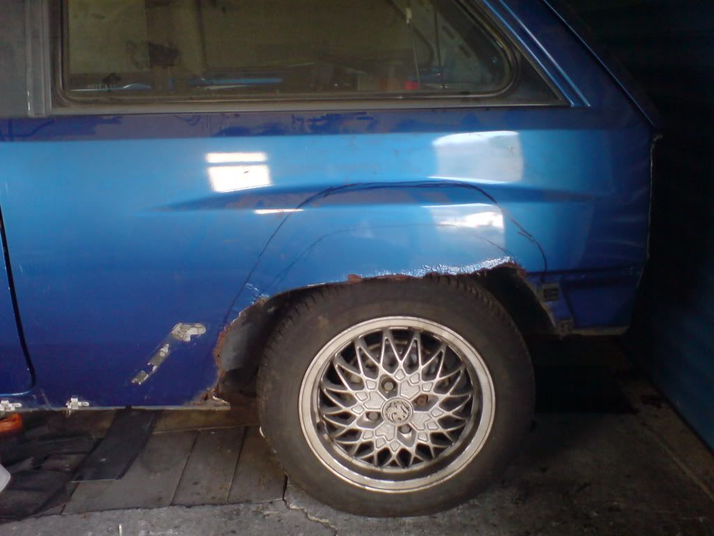

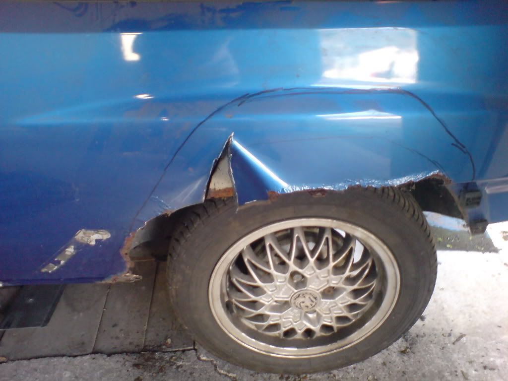

and here ive marked out there about where i want to cut the rear arch out for the rear arches.
http://i241.photobucket.com/albums/f...va/bigs024.jpg
just to make sure i cut a little bit first to see behind
http://i241.photobucket.com/albums/f...va/bigs025.jpg
i was and had plenty to play with so......
http://i241.photobucket.com/albums/f...va/bigs029.jpg
http://i241.photobucket.com/albums/f...va/bigs028.jpg
still plenty that can get cut out

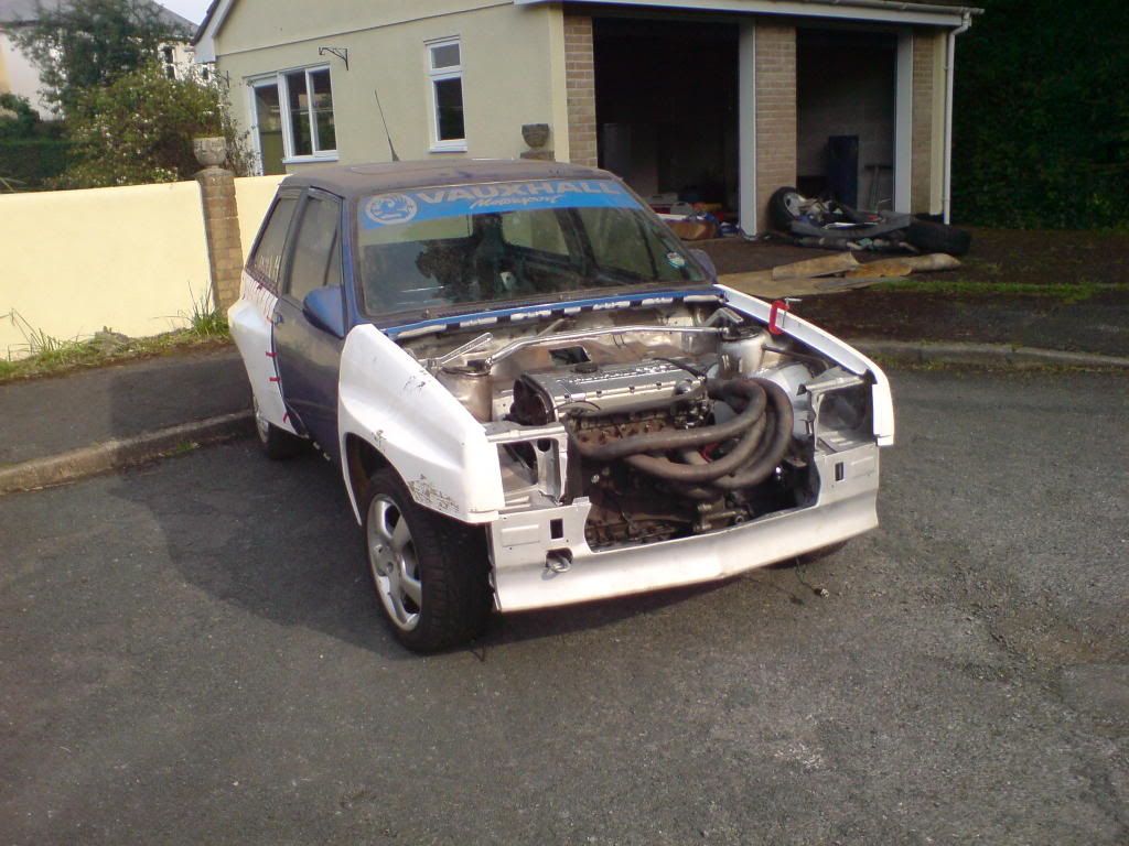

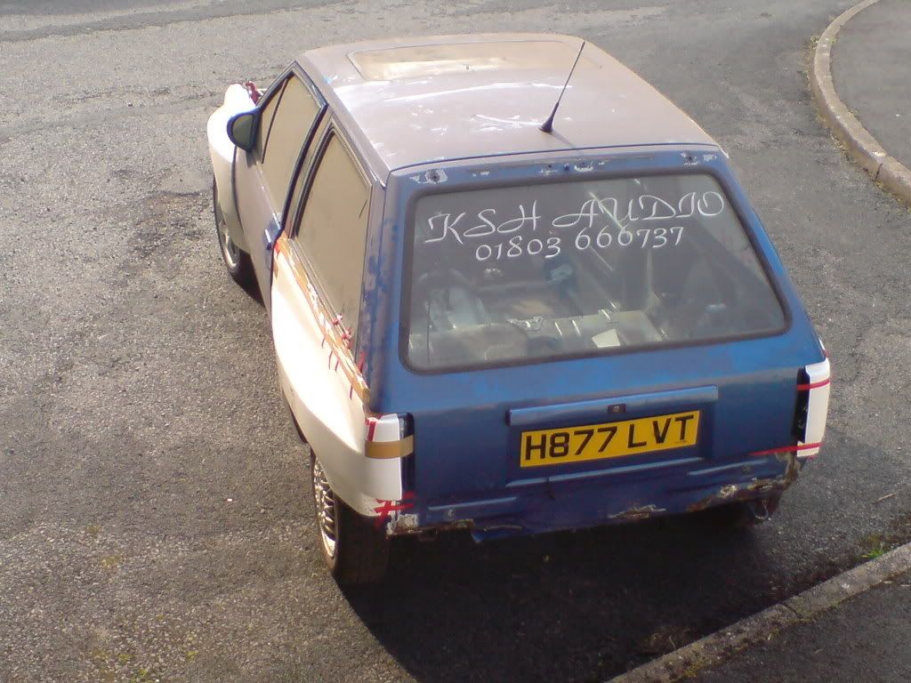

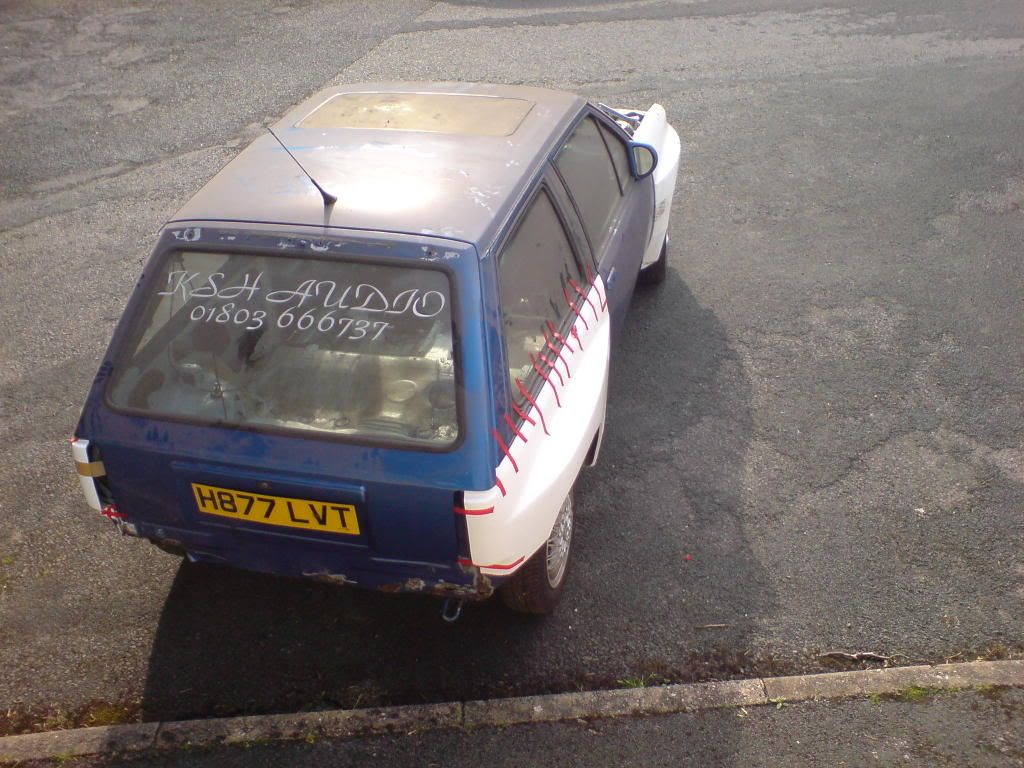

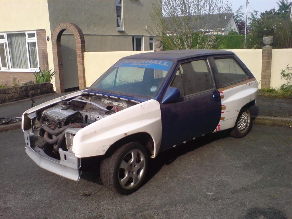

And finishing for now with a few pics of the car on wheels with the kit on with tape lol just so i could see what it will look like. from a previous tread a week or so ago.
http://i241.photobucket.com/albums/f...newnova099.jpg
http://i241.photobucket.com/albums/f...newnova098.jpg
http://i241.photobucket.com/albums/f...newnova097.jpg
http://i241.photobucket.com/albums/f...newnova096.jpg
http://i241.photobucket.com/albums/f...newnova095.jpg
http://i241.photobucket.com/albums/f...newnova094.jpg
http://i241.photobucket.com/albums/f...newnova100.jpg
:cool:

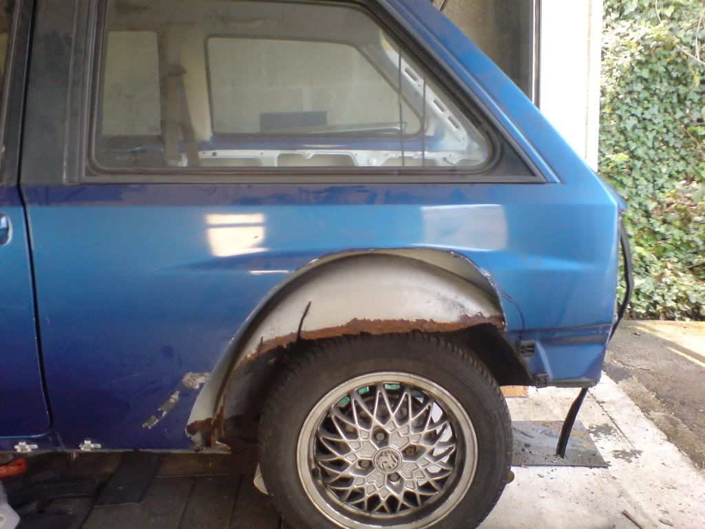

Whoa that is shell is a pear! lol
I would keep my eye out for a mint 1.2 shell etc there are a few about at the moment....
You will always be chasing the rot around tbh...
very interesting read bigs,hope it all works out for you mate.i think priority is a mint shell,(the current one dont look in good health),then start on the chassis work(priority),a fully prepared shell will then be waiting for a fully prepared engine.im loving the enthusiasm you have and if i had a decent wedge going in the bank,then id be totaly in the same frame of mind.good luck once again mate, will be keeping close tabs on this thread.:thumb:
I dont mean to be rude but whats the idea with the banana manifold? Wish i had the space to do a track car
There is more chyance of me finishing my Escort off than that car being finished !
Find yourself a good shell mate as that is NOT worth putting anytime into.
Personally I'd also sell that manifold and get a BTB or Simpson one, there is nothing cool about having half of the engine bay hanging through the front bumper
Yup and TBH how are you going to crack 300bhp from a xe when swindon with unlimited budget did not?Quote:
Originally Posted by Jonlem
i believe swindon had to stick to the 1998cc, this is going to be 2.2 or 2.3 when the engine is built. not saying its going to hit 300hp but in the long run it would have developed into a similar spec to sbd's 292+ kit and swindons top spec all be it a larger capacity. it could even be lower in power due it being a longer stroke but it should make up for that in torque.
