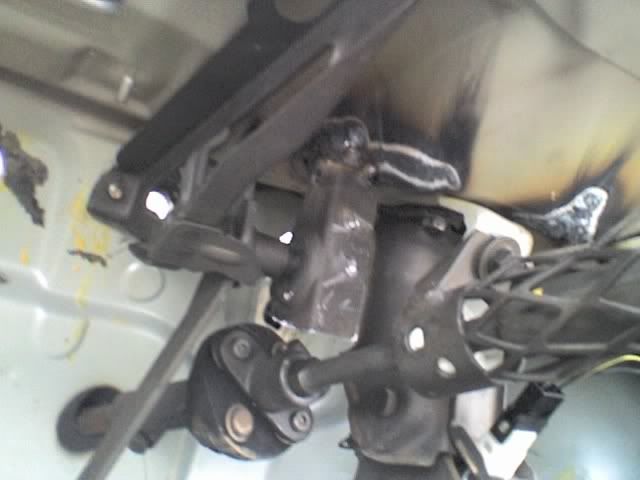

Shaun's mate Michael came over with his welder and got busy! I'll let the pics do the talking. It was so nice to basicaly see no rust that needed repairing. I never had much on the red one but this ones ace!
http://img.photobucket.com/albums/v3...t/06-07-08.jpg
http://img.photobucket.com/albums/v3.../06-07-081.jpg
http://img.photobucket.com/albums/v3.../06-07-082.jpg
And welded up my clutch pedal support...
http://img.photobucket.com/albums/v3.../06-07-089.jpg
