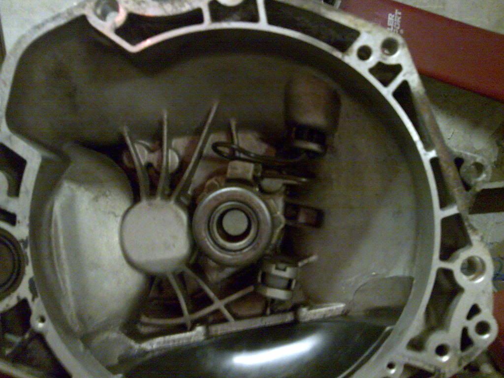

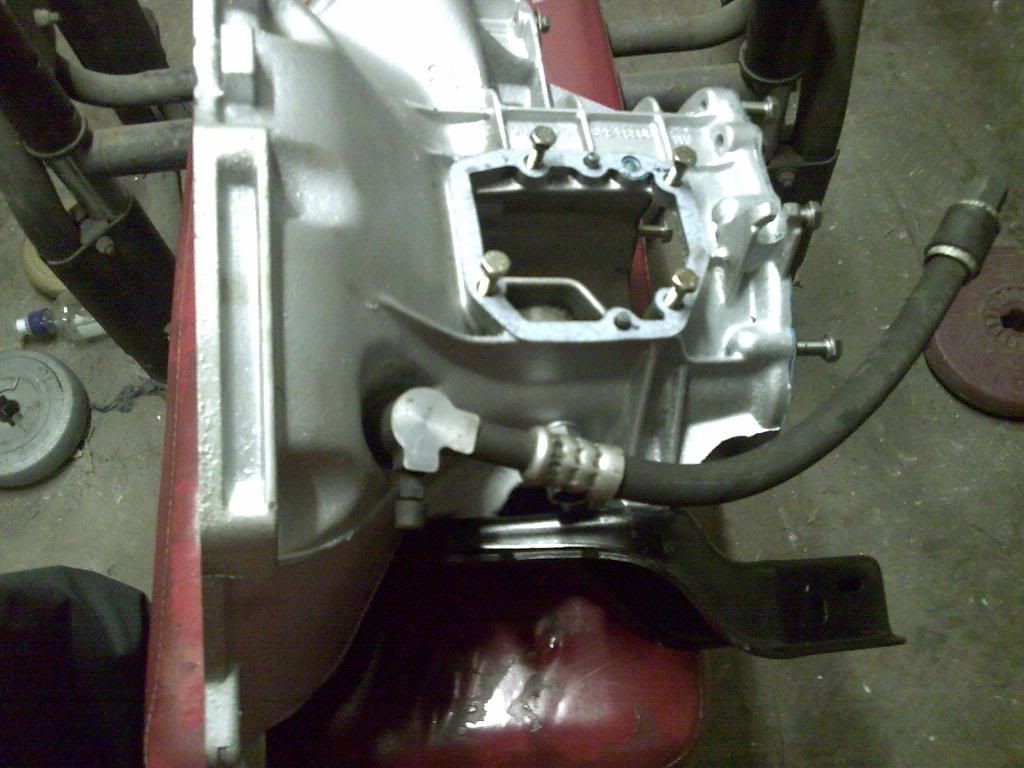

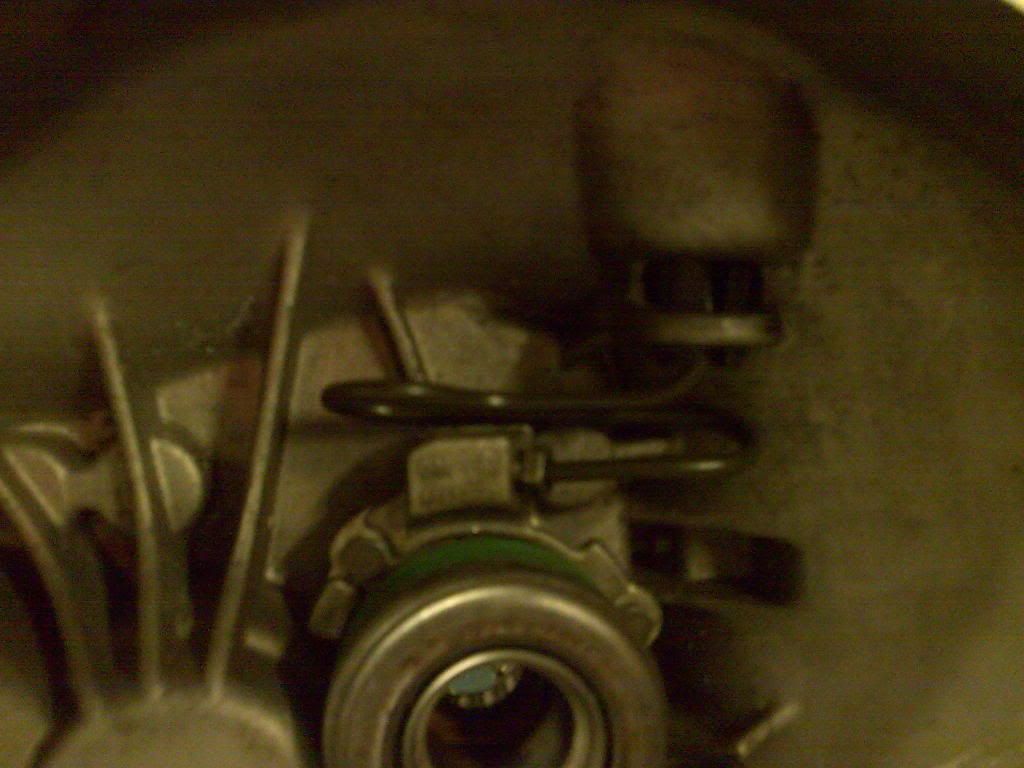

Converted the clutch release to hydraulic slave this afternoon, heres a few pic's:
http://i227.photobucket.com/albums/d...d/Hydslave.jpg
Removed the fork, bar and cable release and replaced with a vectra slave cylinder.
http://i227.photobucket.com/albums/d.../Slavefeed.jpg
Supply to the slave cylinder
http://i227.photobucket.com/albums/d.../Hydslave2.jpg
Waiting for the diff bearings then box is finished. Thanks for looking.

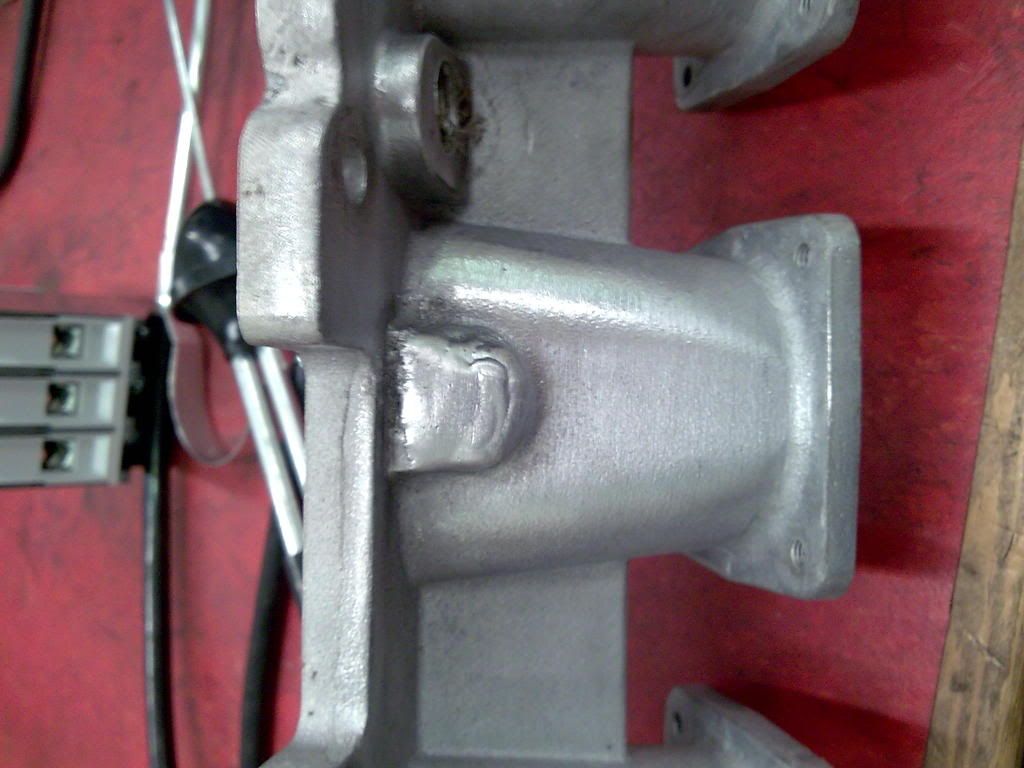

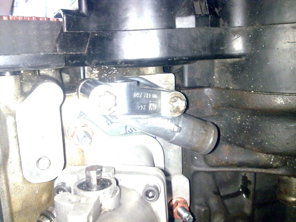

Firstly used the ac tig to weld up the vacum take off for the servo
http://i227.photobucket.com/albums/d...te_ed/Weld.jpg

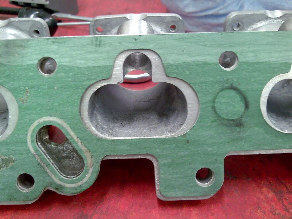

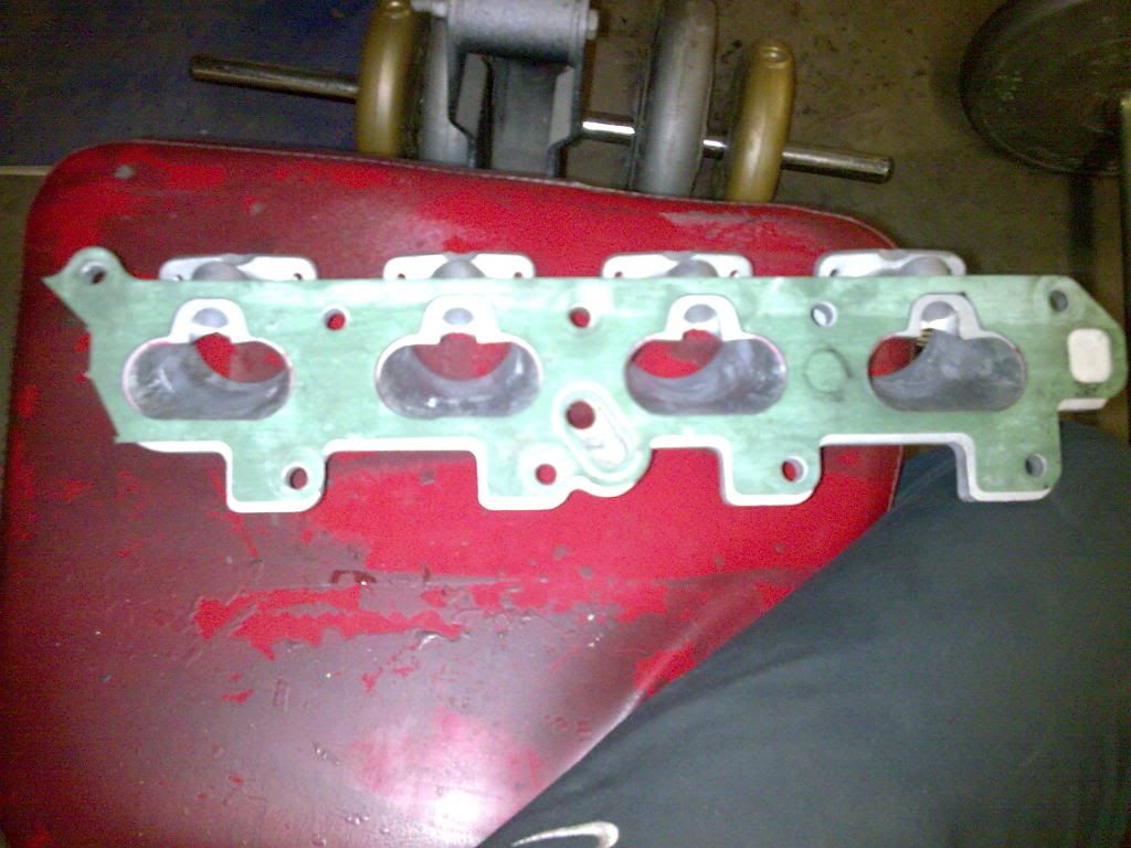

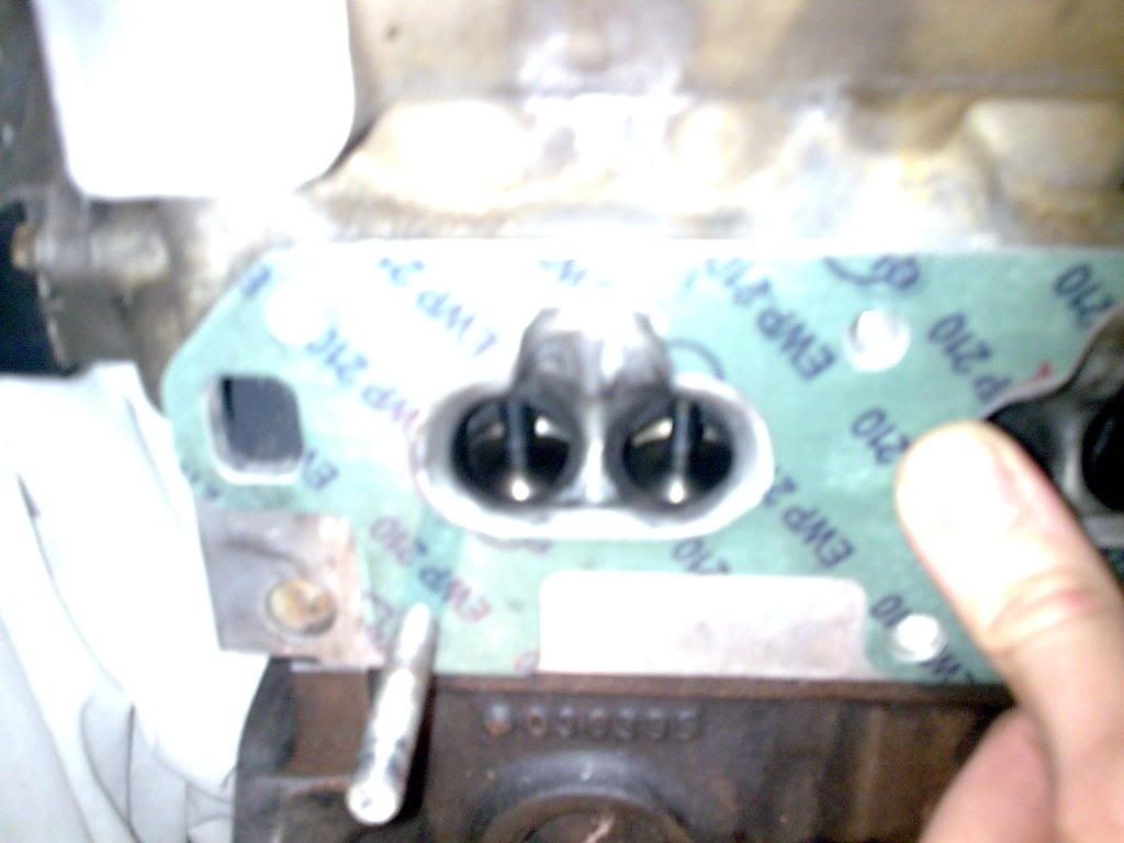

Then opened up the ports on the inlet to match the gasket as the cylinder head has also been matched.
Before
http://i227.photobucket.com/albums/d..._ed/before.jpg
After
http://i227.photobucket.com/albums/d...e_ed/after.jpg

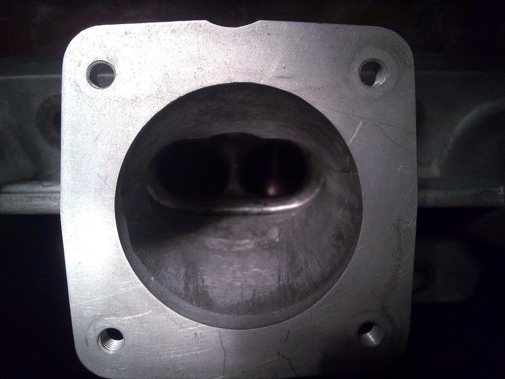

Heres a photo of the inlet on port 4. Smoooth
http://i227.photobucket.com/albums/d...te_ed/Port.jpg

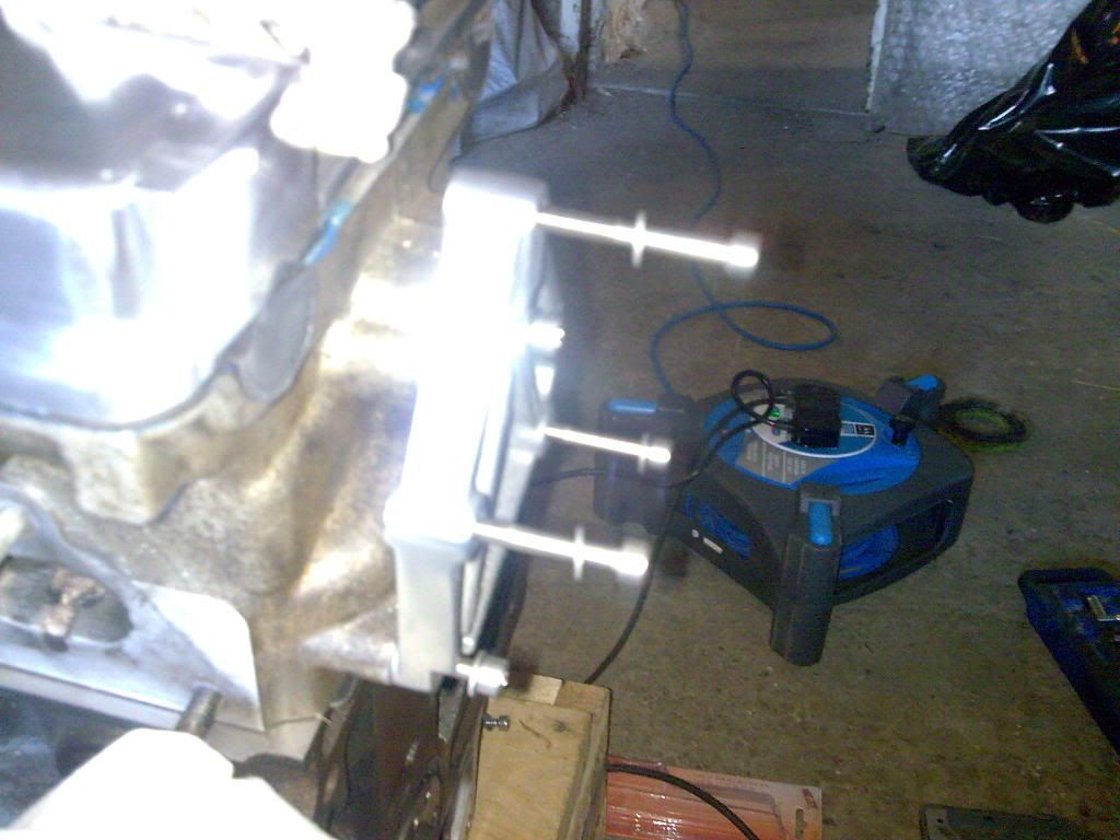

Waiting for my new studs and nuts from vaux so i can bolt the inlet side of things on. Iv also been stripping dow the taperd bodys and cleaning them up. Sat down and wrote down my full engine spec:

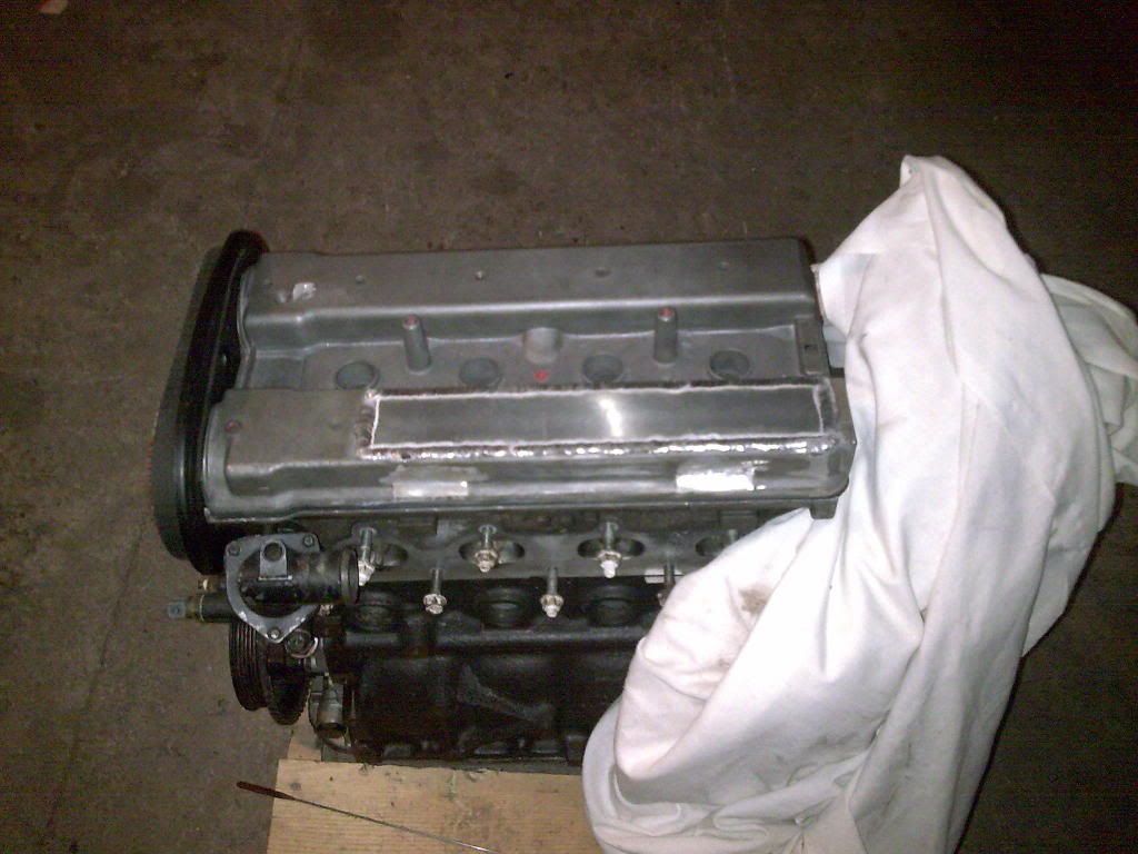

Nearly finished the cam cover. Tigged it up today, just wants the welds polishing out, holes drilling and painting.
http://i227.photobucket.com/albums/d...d/Camcover.jpg

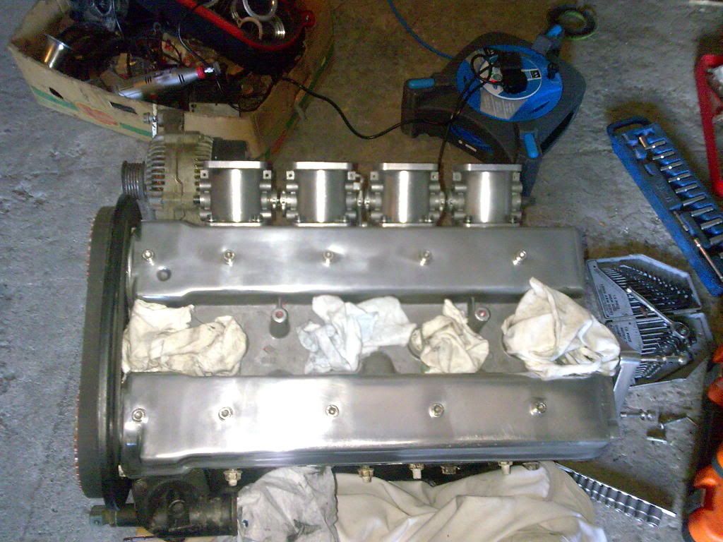

Had an afternoon tarting things up today. Finally finished my cam cover....http://i227.photobucket.com/albums/d...overpolish.jpg
You can hardly tell that there was an oil cap and breather there. Really happy with how it turned out.

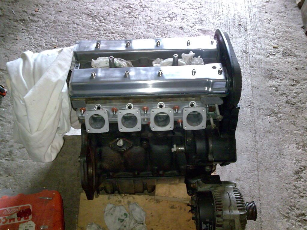

Started bolting things back onto the engine too, cam cover, inlet and bodies.
http://i227.photobucket.com/albums/d...ginebodies.jpg
http://i227.photobucket.com/albums/d...d/Bodieson.jpg
