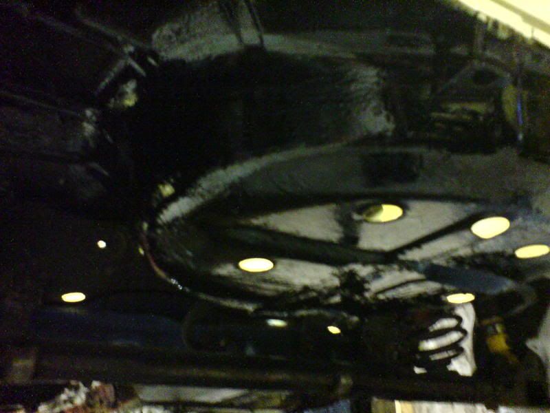

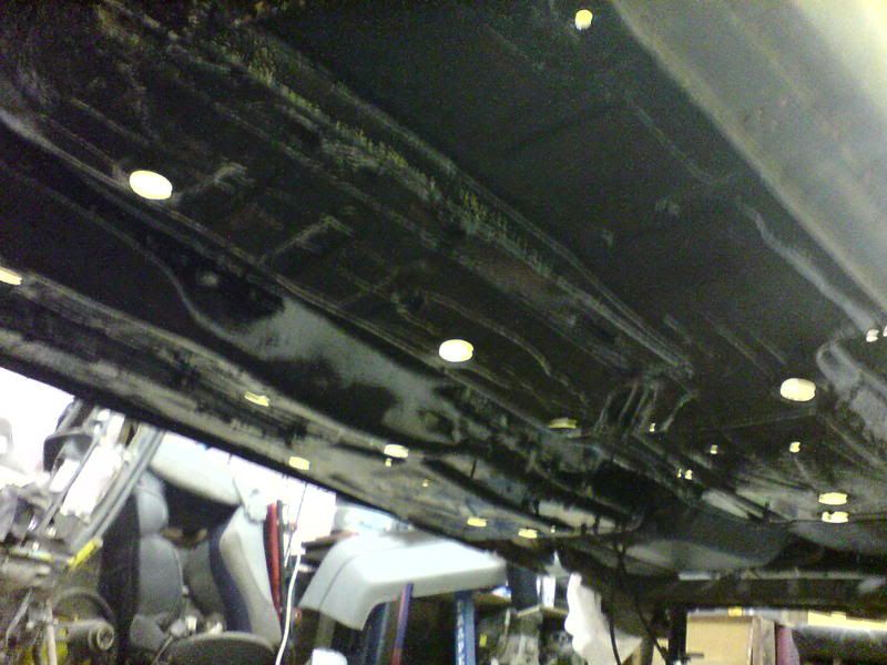

Right, decided that I like the arches so much to do the whole underside of the car:
http://img.photobucket.com/albums/v1...a/DSC00201.jpg
http://img.photobucket.com/albums/v1...a/DSC00200.jpg
http://img.photobucket.com/albums/v1...a/DSC00203.jpg

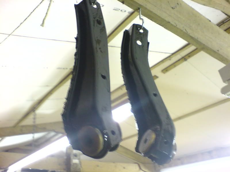

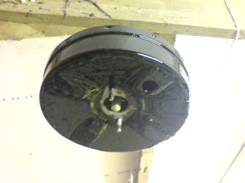

Also done these few bits:
http://img.photobucket.com/albums/v1...a/DSC00195.jpg
http://img.photobucket.com/albums/v1...a/DSC00194.jpg

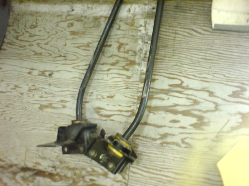

These were just de-greased:
http://img.photobucket.com/albums/v1...a/DSC00196.jpg
