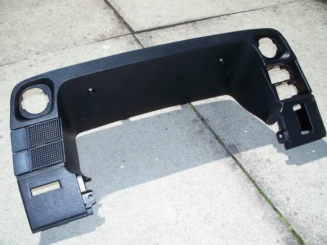

Also; ive acquired a mk1 dash which im messing with indoors ? getting it to look how I want it to..
http://img.photobucket.com/albums/v1...r/SP_A0285.jpg

Is that a brown mk1 dash dave??!
^^ oooh! big up craig,.. thanks for the tip. :)
yes john.. rich asked me that too when he popped round, lol..
blame dave marshall on mig.. he was pretty much giving it away.. :(
Dodgy dave ay!? lol
Didnt think he did nova bits anymore?
Good luck with the digi dash, a mate of mine spent ages getting it to fit his mk1 dash perfectly, I think he cut out the square console around the clocks and made up brackets for it first, then glued the main console back in.
dodgy? .. yes at the mo..
but please its a wip.. :)
Im kinda with u tho steve; what ur friend has done- is the same kinda idea i have, tho i think one of these, cut and adapted to fit, will play a part..

I take it thats a mk2 astra one? could work although might take quite a bit of fiddling.
I'll see if I can get a pic of my mates one. :thumb:
yeah astra mk2 gte.. yes fiddling lol.
its all in the details.
yeah, pic would be cool mate. thanks.

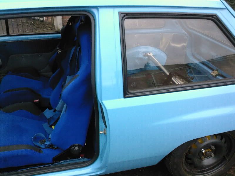

Seat subframe faffin the return..
Finally a ‘prototype’ lol has been mocked up. It nearly fits so just a little re-jigging and we’ve got one done.
The aim is a success.. the frame is more central, the seat will sit lower and without using the floor of the car. So we’ve improved upon the original design ; something ive not really done before.. Although over that original cobra design it wasn’t difficult.
Please note – welding is rough and tacked for the time being.. (mate has done the welding)
http://img.photobucket.com/albums/v1...r/SP_A0607.jpg
In car.. a little dark when we got there..
http://img.photobucket.com/albums/v1...r/SP_A0608.jpg
http://img.photobucket.com/albums/v1...r/SP_A0609.jpg
Will take better pics later in the week; hoping to finish it properly, painted up.. then refit the passenger seat in its new, lower position. Awesome.
Then gotta do the drivers frame lol. Hope to get that done in one day tho.

Moving on - nipped everything up properly on the finished, just unpainted, seat frame and its spot on. Sod all movement, much lower.. not floor contact - brill.
http://img.photobucket.com/albums/v1...r/SP_A0635.jpg
http://img.photobucket.com/albums/v1...r/SP_A0636.jpg
http://img.photobucket.com/albums/v1...r/SP_A0637.jpg
It is hard to see any major difference in height but its ample for me, seats are and feel much better. Less movement as well. Cobra wanna be takin note i tell you.. load of bollocks the orginal lark was.
