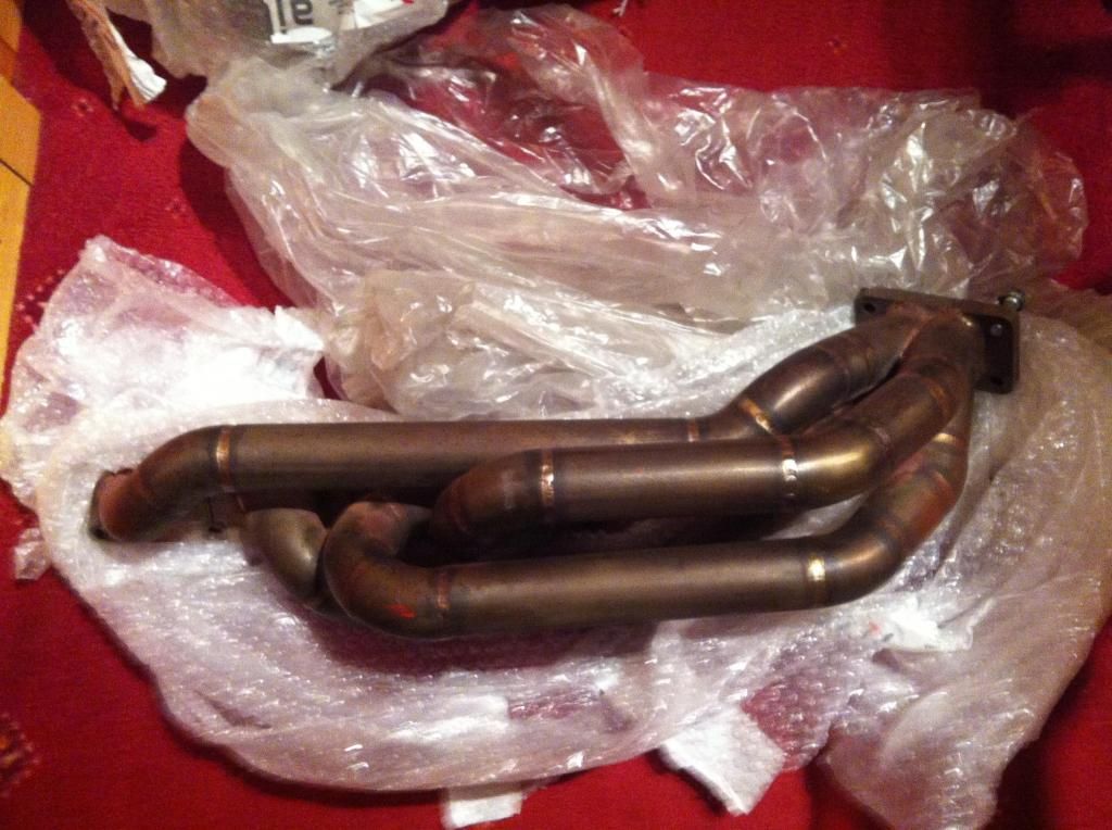

Not an update but thought i'd put up some pics of the engine, exhaust manifold, turbo and inlet manifold. i bought the engine around 2 years ago from a 54k mile calibra turbo that had been rear ended. The turbo is a precision turbo 6262 got this, the exhaust manifold and wastegate off david dixon on here. heres some pics, not the best quality as taken with my iphone again.

I absaloutly love exhaust manifold like that! looks mean lol
