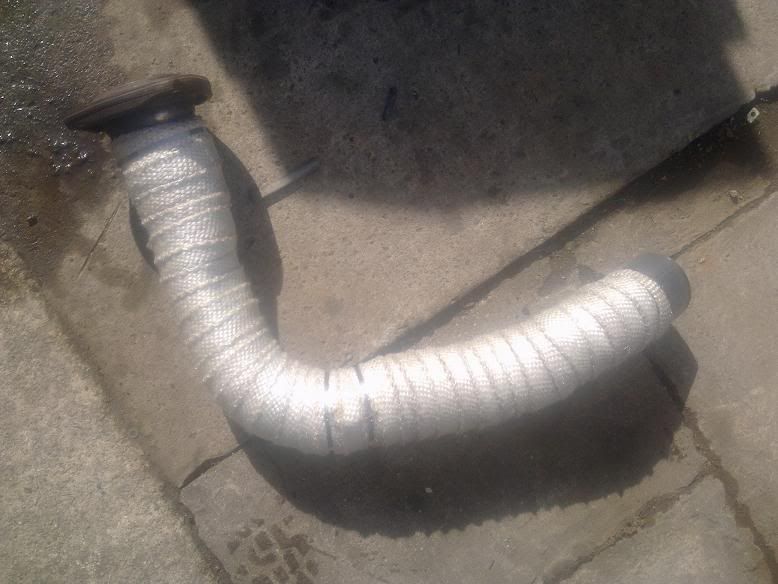

well we've been cracking on over the weekend but i didn't get round to taking pics apart from the down pipe after welding and wrapping.
We have got all the wiring finished off, turbo feed pipes welded up and wrapped along with the down pipe, fuel lines are finished off with a black top race fuel reg and gauge, high pressure in-tank pump to replace the nova SPI pump, we have fitted a set of C20LET yellow injectors which should see us ok, we are just about finished the exhaust system, we went for 3" all the way through (including silencers) until it reaches the rear where it splits to 2 x 2 & 1/8" back boxes coming out the middle.
all suspension, bearing type tie bars and poly bushing complete.
The only real things we need is;
1 meter of 3" pipe to finish the system
turbo oil feed pipes,
fittings for external oil cooler (binned the water type)
fit the innovate wideband
intercooler piping to turn up so we can fit it all up
fit shafts and brakes then refit the front end!
http://img.photobucket.com/albums/v8.../Image0367.jpg
