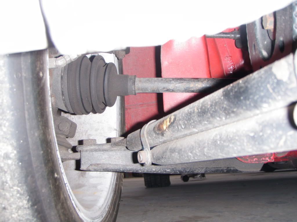

Very nice purchase. Have you any pics of what angle's the shafts are at due to the engine sitting lower.

It's hard to get a photo head on of the driveshafts, here's my attempts;
http://i285.photobucket.com/albums/l...ort/0023-1.jpg
http://i285.photobucket.com/albums/l...ort/0033-2.jpg
Whereas on a standard Nova the driveshafts have to go uphill from the gearbox to the uprights, on this one their journey is downhill!
