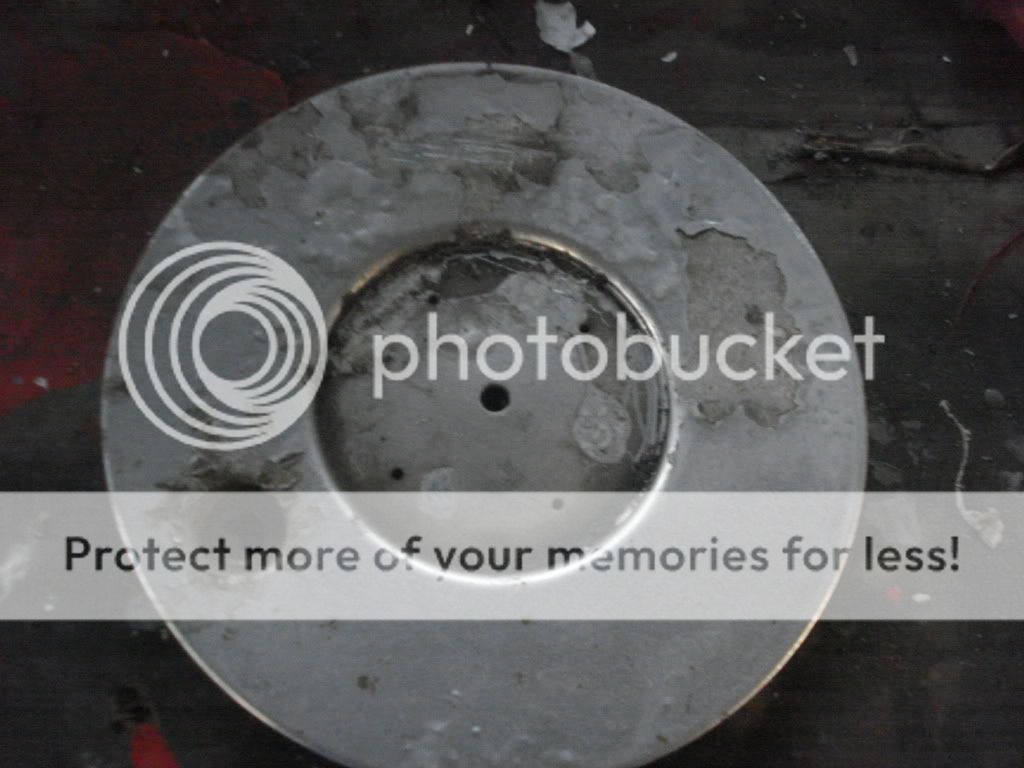

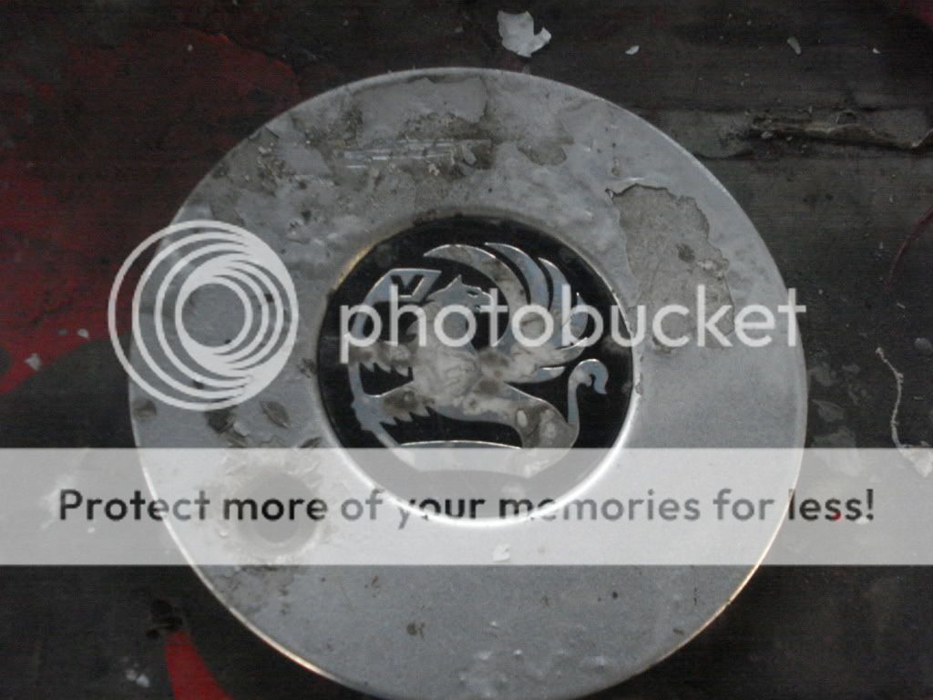

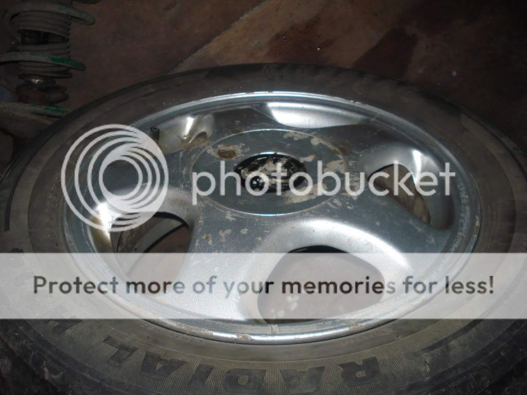

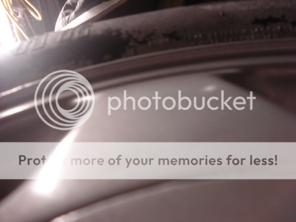

started with this
http://i959.photobucket.com/albums/a..._040/004-1.jpg
http://i959.photobucket.com/albums/a...or_040/001.jpg
http://i959.photobucket.com/albums/a...or_040/002.jpg

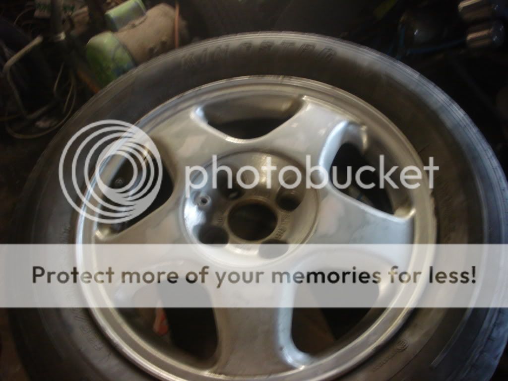

nitromors and sanded
http://i959.photobucket.com/albums/a..._040/004-2.jpg

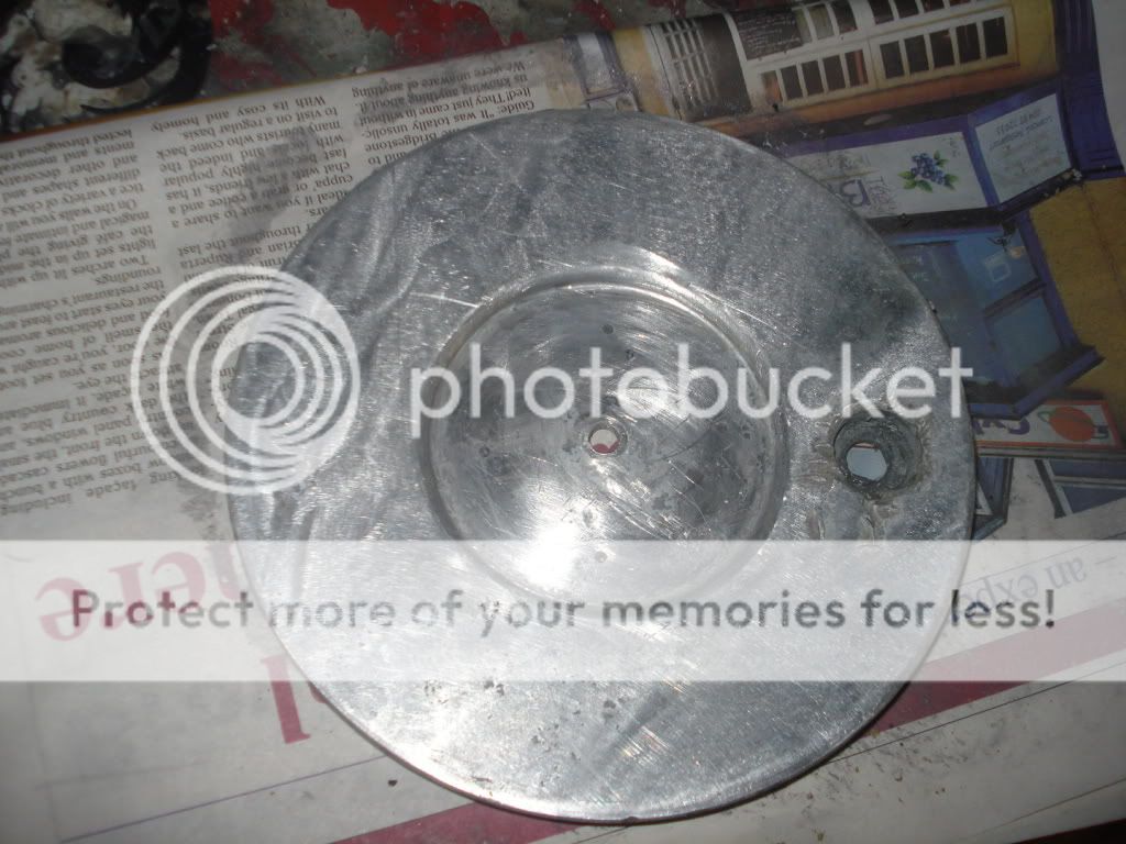

fibreglass to make it smooth
http://i959.photobucket.com/albums/a...or_040/020.jpg
http://i959.photobucket.com/albums/a...or_040/022.jpg

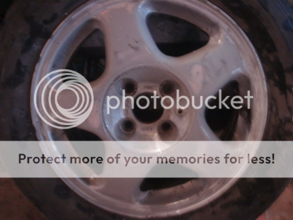

filler,sanded and primed
http://i959.photobucket.com/albums/a...or_040/023.jpg
http://i959.photobucket.com/albums/a..._040/005-2.jpg

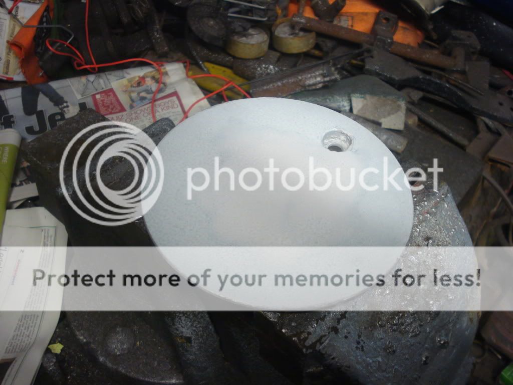

wheel sanded with 180

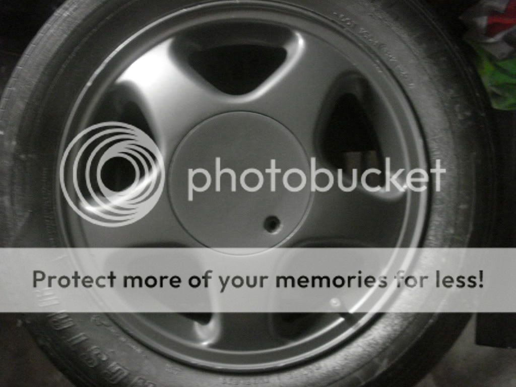

and painted
http://i959.photobucket.com/albums/a...or_040/013.jpg
http://i959.photobucket.com/albums/a...or_040/024.jpg

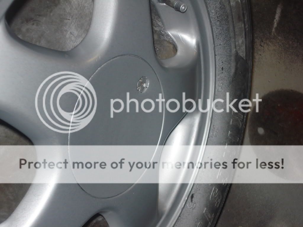

lightly flatted with 2000,buffed and waxed
http://i959.photobucket.com/albums/a...or_040/041.jpg
