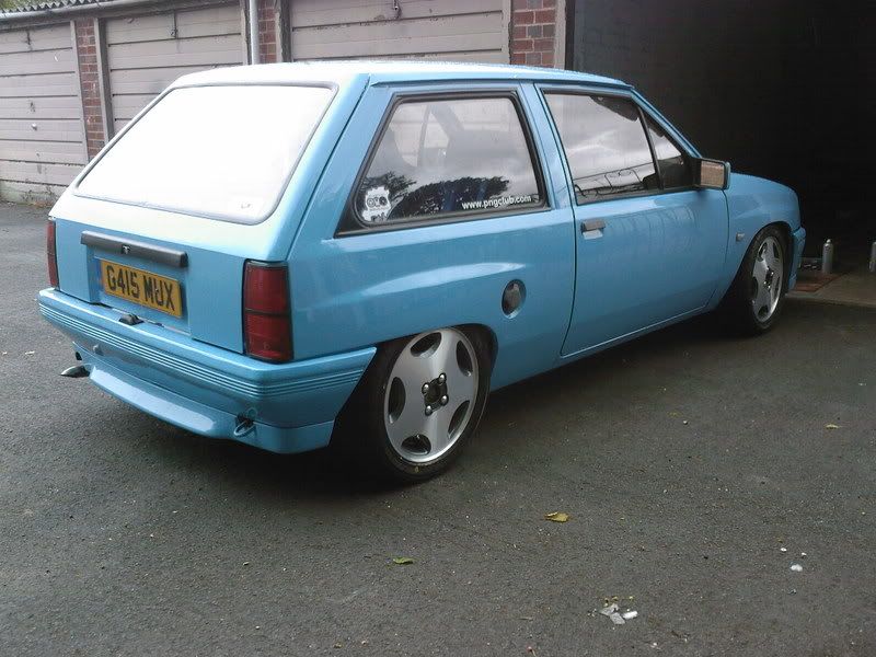

*small update..
http://img.photobucket.com/albums/v1...r/SP_A1223.jpg
Ive been driving it about a bit a day, but havent given it a 'blast' or 'run' as yet..
Jobs: single wiper, sorting the rear farbon cibre cards and painting the rear, inside arches are next to do.. also from monday payday, i hope to be able to sort the exhaust too.. all in time for billing.
Ive bagsied mike's top rear shock poly bushes; those along with the front and rear braces will get fitted soon by the camber/castor setter-up man. lol
Went up the garage today and finished the single wiper kit (painting, cleaning it, was used) but stop start rain was peeing me off and i have a date.. lol.
Laters..
Thanks for all the comments peeps; im glad its going down well.. DOES make it all worthwhile, tho tbh, for me this project has been nice n easy, things have gone relatively well.. Guess ive been lucky there.
More to come.
.. forgot to add.. the car doesnt drive too bad steering wise with the suspension as unsetup as it is.. but the ride is well bouncy n harsh lol. Hope i can soften it up a bit. Need to find out if the shocks adjust for damping there is a screw that pops out the bottom but im still not sure.
The chap who will align the car may be able to tell me.
Also it cuts out randomly when off the accelerator; so idle valve playing; needs cleaning, replacing.
