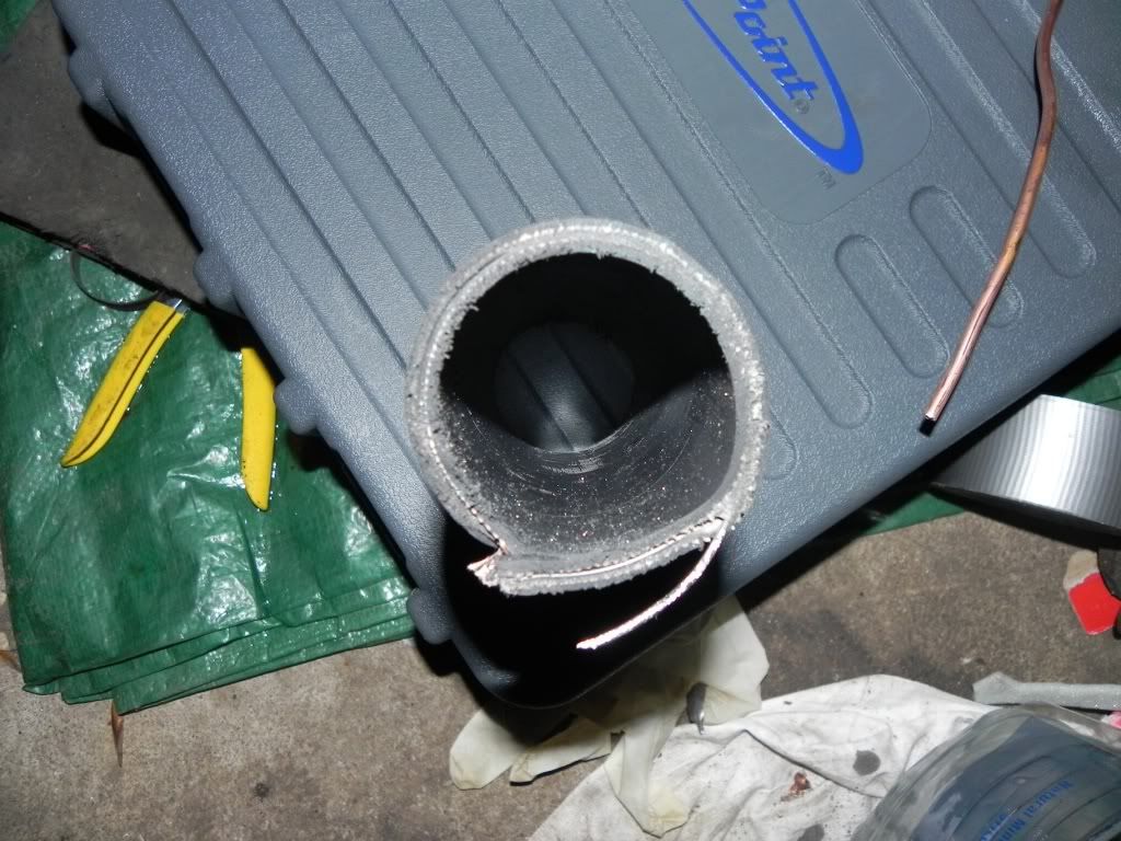

Good work dude but I'd be a bit sceptical of that hose between the filler neck, in the back of my mind I'd be wondering when it'll split and fill up the inner wing.
thanks guys.
im not worried about the hose splitting tek, its 3 layers with a spiral wire all the way through it. it dont flex or bend so i dont think it will split. pic of said layers...
