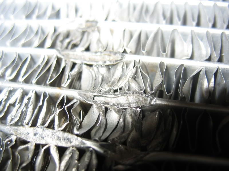

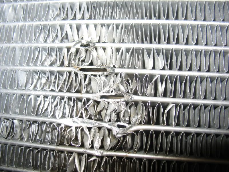

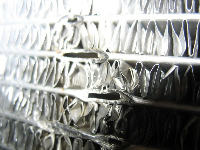

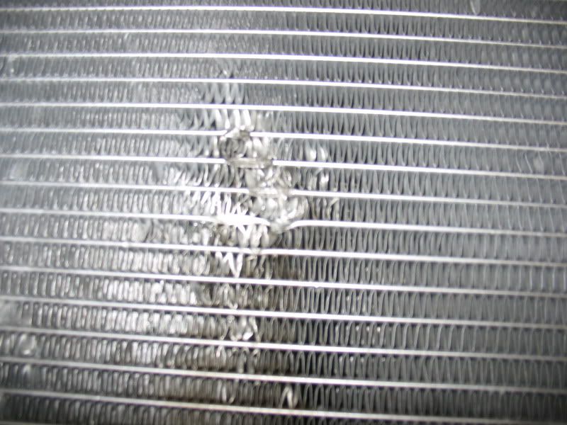

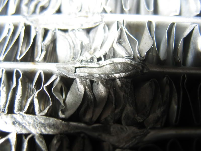

Driving home on Friday i noticed the water temp was getting very hot. Think it might be air in the system i just let the air out.. Sat morning found the header tank was empty. So i just simply topped it up thinking i had lost alot when i changed a hose.
While talking with Dan, we noticed it looked like one of the lines was leaking.. Well it was leaking! The metal end to the turbo hose has touched, i knew it had been but didn't think it was this bad.. So...
http://img.photobucket.com/albums/v3...Brokenrad5.jpg
Get the rad out to inspect.
http://img.photobucket.com/albums/v3...Brokenrad6.jpg
Where the hose has been touching...
http://img.photobucket.com/albums/v3...Brokenrad7.jpg
Looks like it's gone thru...
http://img.photobucket.com/albums/v3...Brokenrad3.jpg
No it has..
http://img.photobucket.com/albums/v3...Brokenrad1.jpg
http://img.photobucket.com/albums/v3...Brokenrad2.jpg
Gotta take it to a guy i know, see if he can weld it up on Monday...
