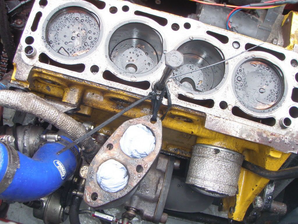

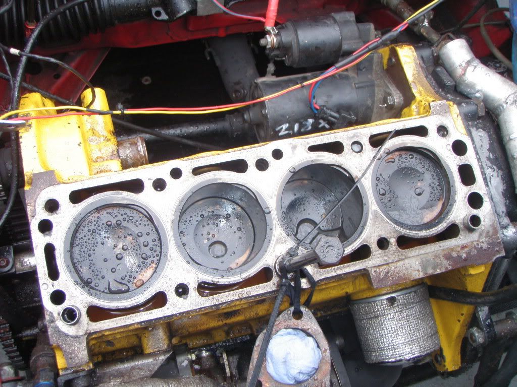

The internals of my engine..........first time I've ever seen inside it as well;
http://i285.photobucket.com/albums/l...ort/005-32.jpg
http://i285.photobucket.com/albums/l...ort/006-33.jpg
Note the liners inside the bores and rather small pistons.
The only consolation of this disaster is that it makes getting at the starter motor and block oil breather so much easier.
So I've taken the chance to replace the starter motor with a Z18XE one (same weight, but geared to make starting easier), and I'm revising the crankcase breather to the later GSi style one.
I've also taken the opportunity to replace some of the old water hoses buried under the inlet plenum with some silicone ones.
Whilst the head is off I will also be doing some measurements on the pistons to see if there's any chance of getting a 16v head on there one day.
Thanks to Mowgli for his research on small GM 16v engines around the World!

Just got off the phone to Andrew Bradley (BTEC Racing) who built my Nova and the engine in it.
He's wondering whether the problem could be down to the hydraulic lifters pumping up as a result of the new revs (8k).
I'm out of my experience here, so who knows FACTS about the rev capability of standard lifters, and whether this could explain my sudden loss of power (and the fact that it subsequently ran ok again at idle and revving it up in the paddock).......
There doesn't seem to any leakage on any of the boost hoses, which was one of my possibilities.
I still have to check the fuel pressure in case there is any problem there.
PS - my bore size measures 70.5mm
