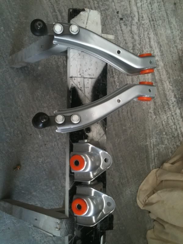

up early today to go and collect every bolt from the last 10 years haha

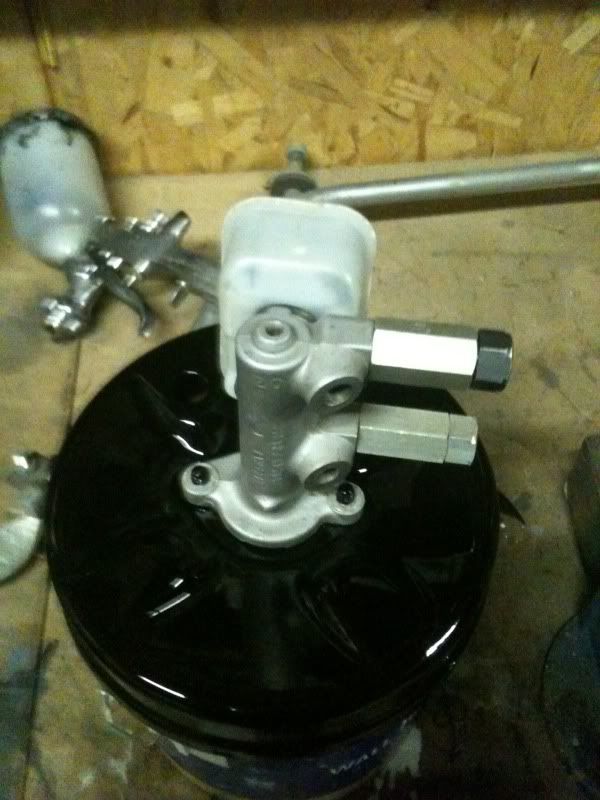

Been degreased, acid dipped, zinc coated
Im proper happy with the results although the pictures dont do the justice, not a bit of rust/grease in sight

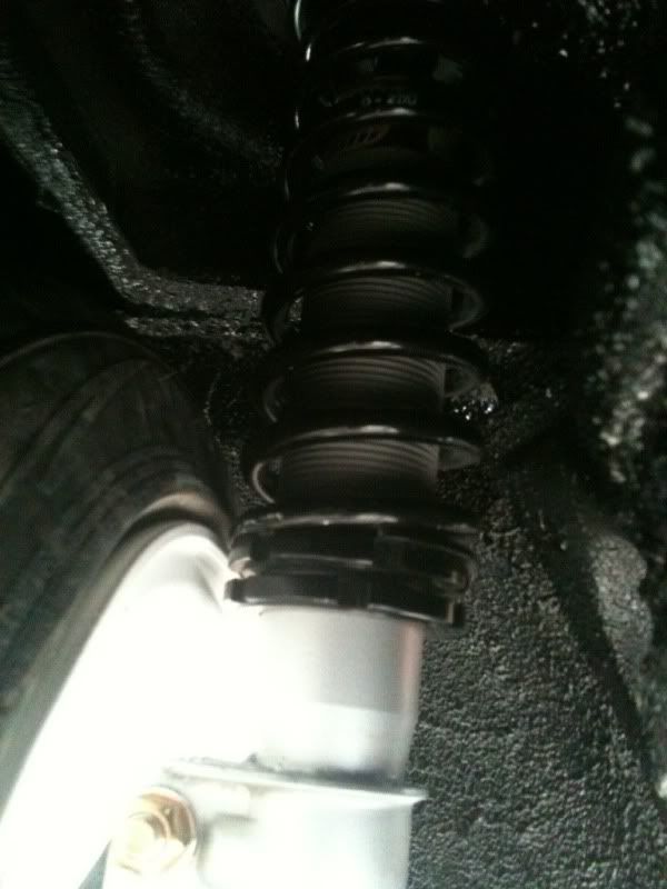

Gave the gaz coilovers a coat of zinc as well the went rusty in teh ****ing box :(
its so nice to fit everything thats brand new, come home just as clean as i left which was weird lol

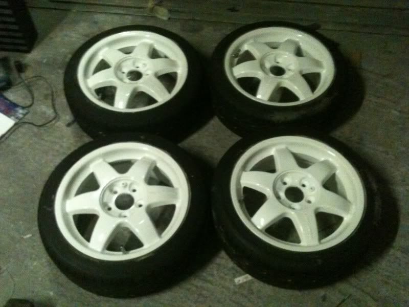

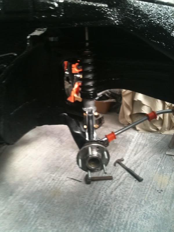

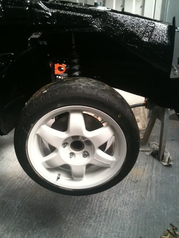

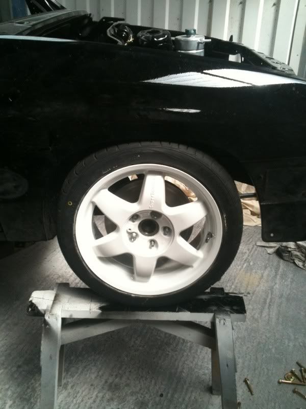

Front legs built up, calipers re sealed and fitted. collected my wheels in the week but need another as one has a flat spot in it :(
not complete yet but it progress
rear end tomorrow i hope :thumb:

Nice contrasting colours. Looking clean.
All I could think of sorry.
**** thats clean, Love it :) great work mate :thumb:b
bahhhhhhhhhhhhhhhhhhhhhhhhhhhhhhhaaaaaaaaaaaaaaaaa aa
the pictures really dont do it justice really buddy
