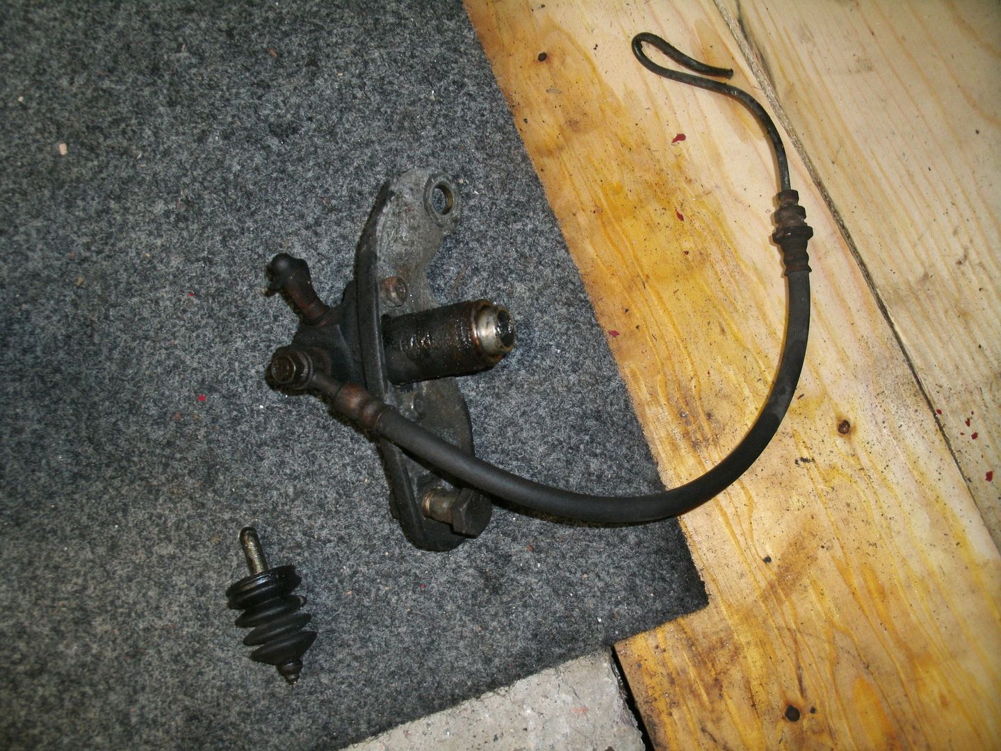

I took the engine and gearbox out of the Daewoo Lanos today, with a view to swapping all the hydraulic clutch bits onto my F13 gearbox in the Nova.

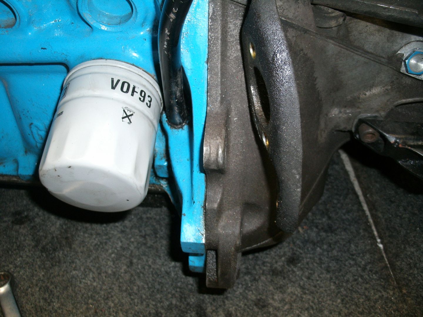

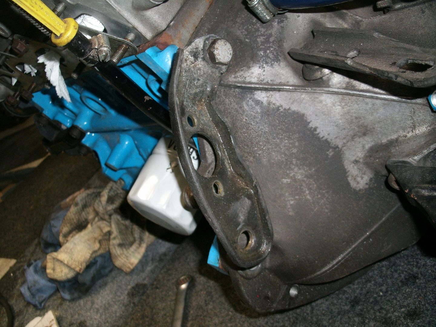

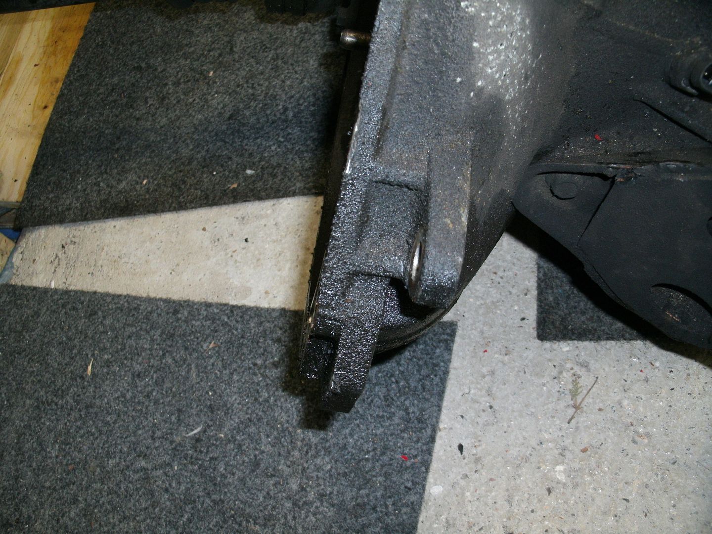

Not quite as straightforward as I had hoped! The Lanos obviously has a slightly different gearbox casing, as the bracket for the clutch slave cylinder will only attach by one out of two bolts;
http://i285.photobucket.com/albums/l...ps5a1534e8.jpg
As you can see, there is a design difference at this part of the gearbox, where the second bracket bolt attaches on the Lanos;
NOVA;
http://i285.photobucket.com/albums/l...pse70098ce.jpg
LANOS;
http://i285.photobucket.com/albums/l...ps16a2eb4c.jpg

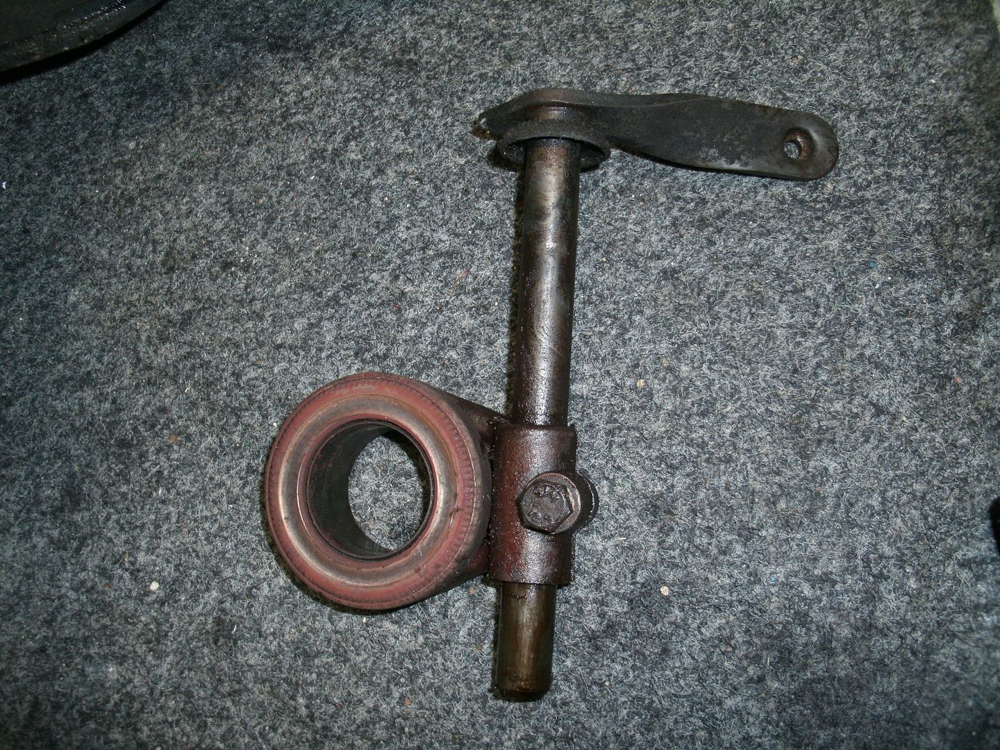

Anyway, not the end of the World, the clutch release arm bolts in OK, although I have posted a question in 'Mechanical' as I need help with knowing how much 'throw' is need on a clutch release bearing!
Anyway, the Lanos has donated the important bits for the conversion;

Looks interesting that, can you not put your cluster in the lanos casing?
Hi Ben,
Yes, that may be a possibility, although there may be other differences which might prevent that, I'm not sure.
But this Lanos casing does feel heavier (I haven't weighed it, it's just the impression I get), and I do like the fact that the F13 'box has the access plate to allow the clutch to be accessed in-situ.

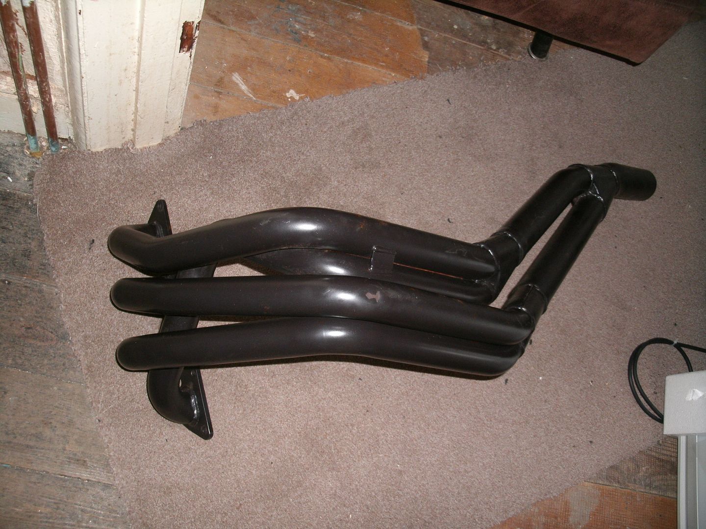

With thanks to Jezz (Toymex on here) I now have a nicer looking manifold for the engine - a BTB one which has been coated by Camcoats;
http://i285.photobucket.com/albums/l...ps3f34193d.jpg
http://i285.photobucket.com/albums/l...pse726ff00.jpg

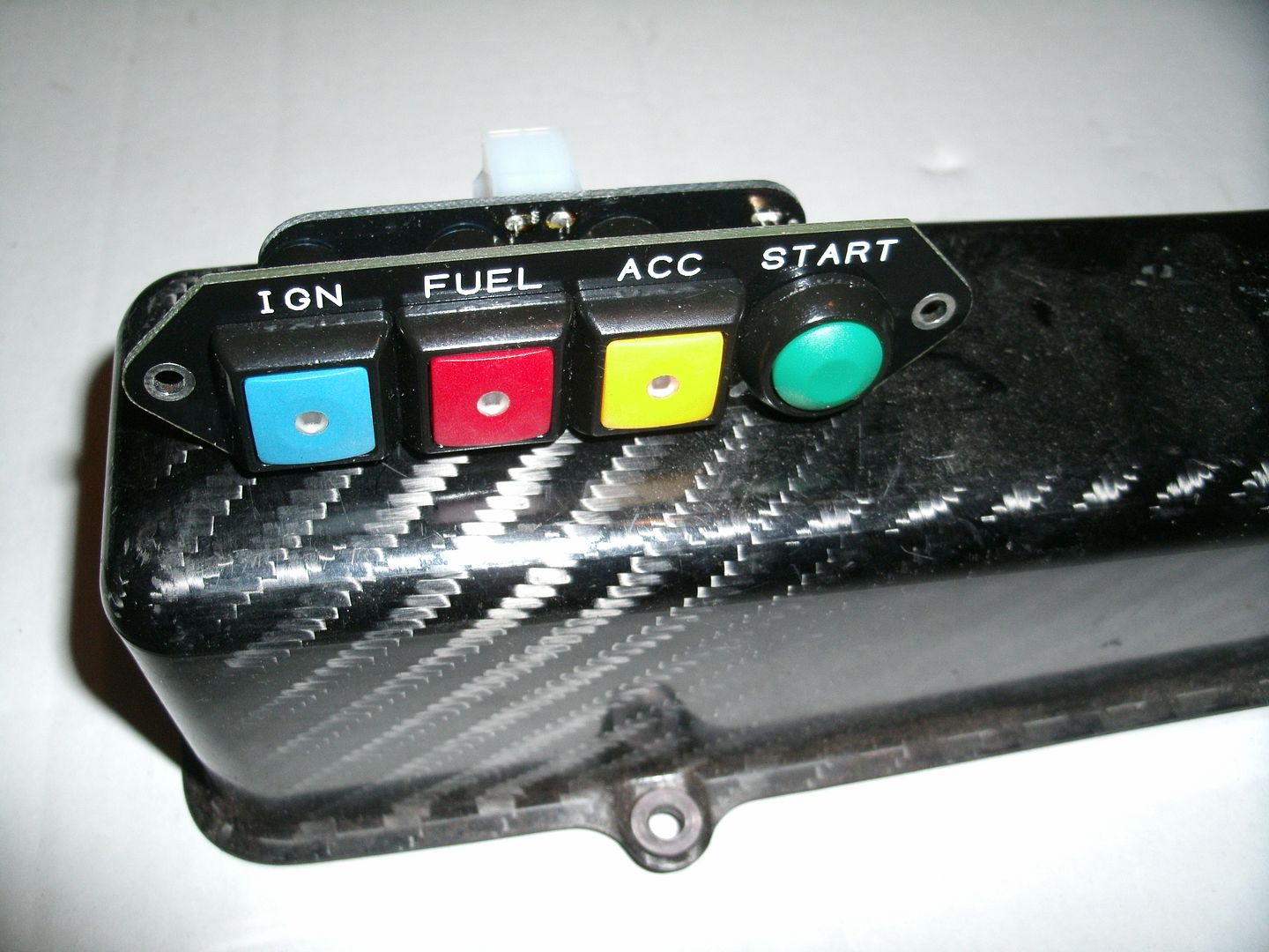

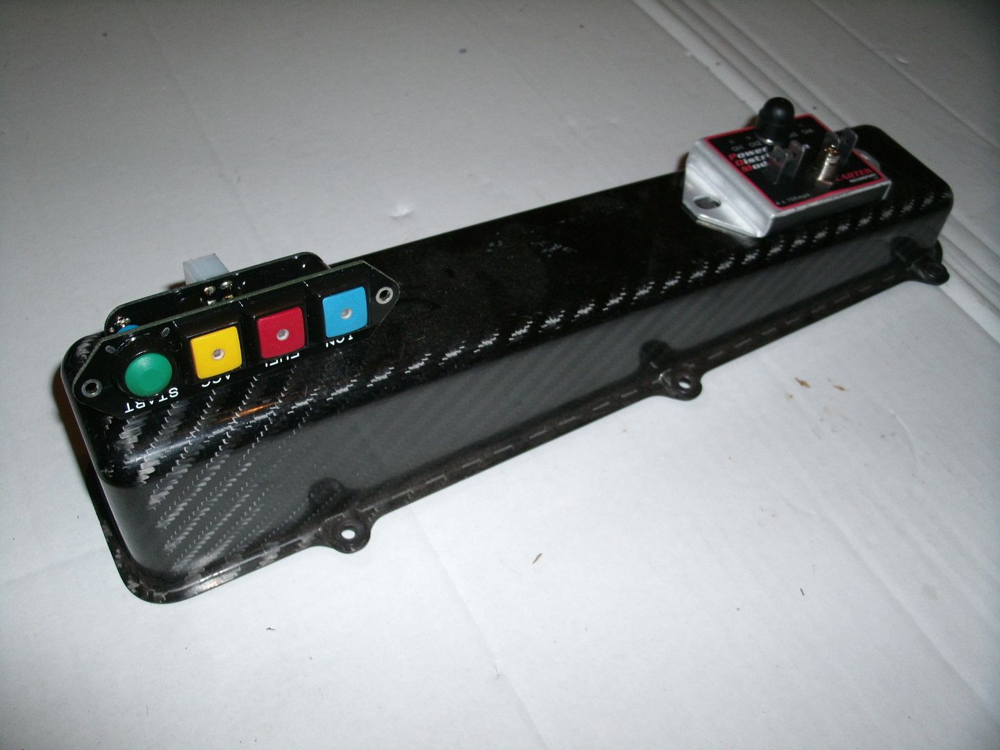

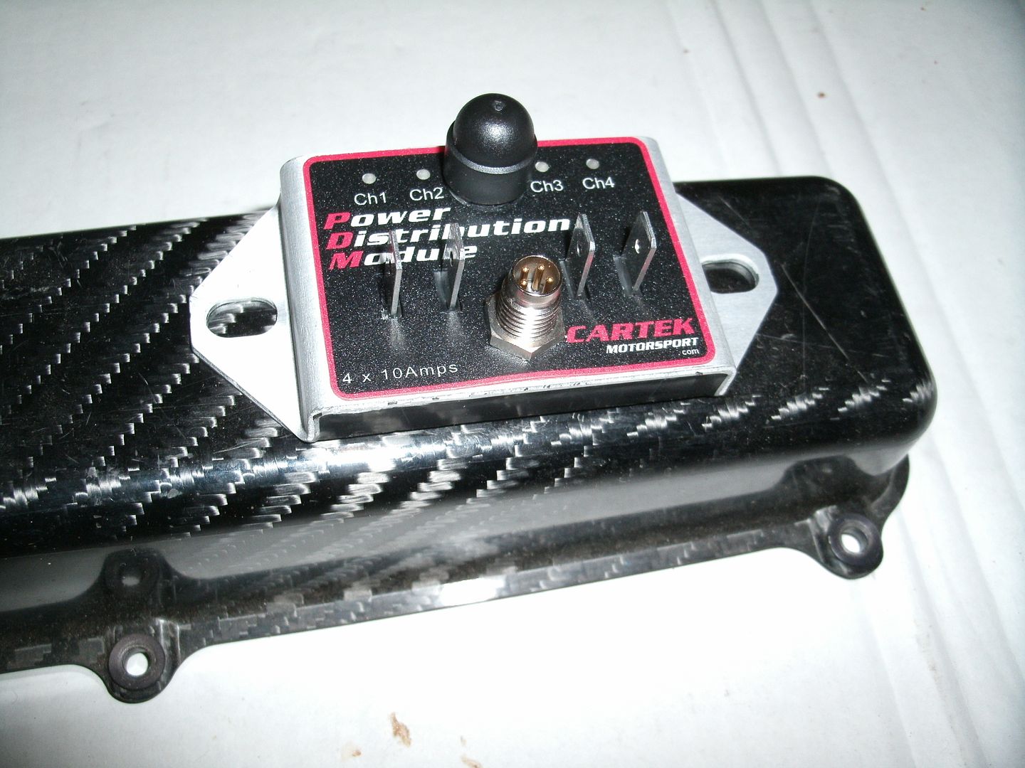

Time to replace the ancient old switches and fuse box (with ceramic fuses!) in my Nova;
http://i285.photobucket.com/albums/l...ps1coazecs.jpg
http://i285.photobucket.com/albums/l...psms0vjwtf.jpg
http://i285.photobucket.com/albums/l...pseubstoj9.jpg
I'm using the excellent CARTEK stuff (they've also supplied me a battery isolator kit) - they are fairly local to me and did me a great deal on the parts.
