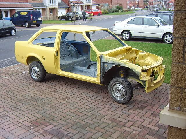

Paint work so far looks great.
Excellent, will be good to see how it looks, ive just done my shocks jamaica yellow and i'd forgotten how good it looks!

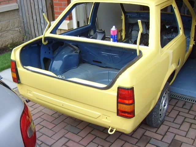

Will get pics up hopefully today, but may be hindered as it's the wife's birthday, but she has said it's ok to work on the car. Taking her out for dinner this evening so will post up the pics when I come back. Going food shopping just now, back by 10am, engine WILL be running by midday. Progress is steaming along and it's looking great. Was out at the back of 5 this morning puting the loom in.
Please bear with me......
Sounds like your making excellent progress mate, best of luck with the re-build and cant wait to see some pictures of it with the paint on, whats the finish like? are you pleased with all the work?

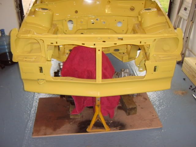

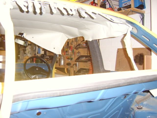

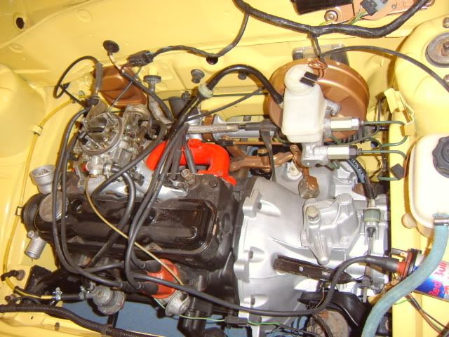

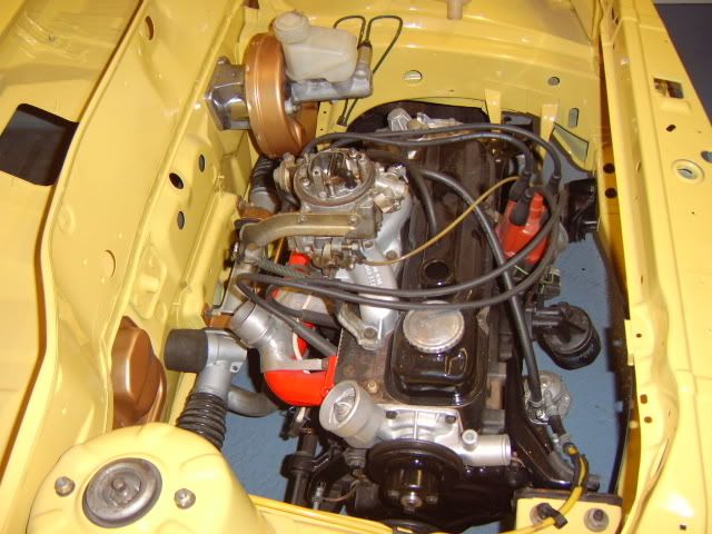

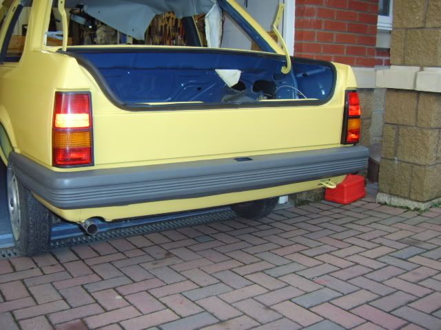

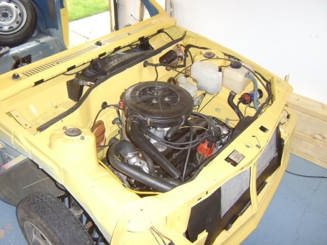

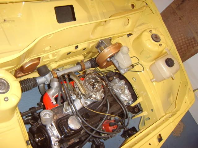

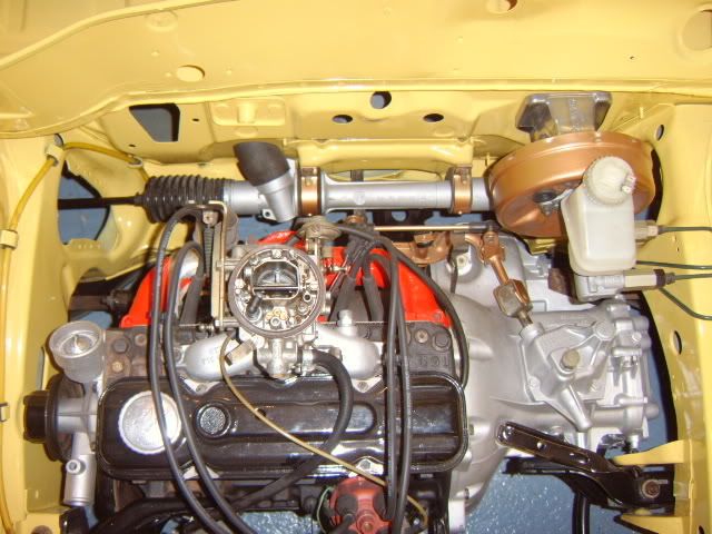

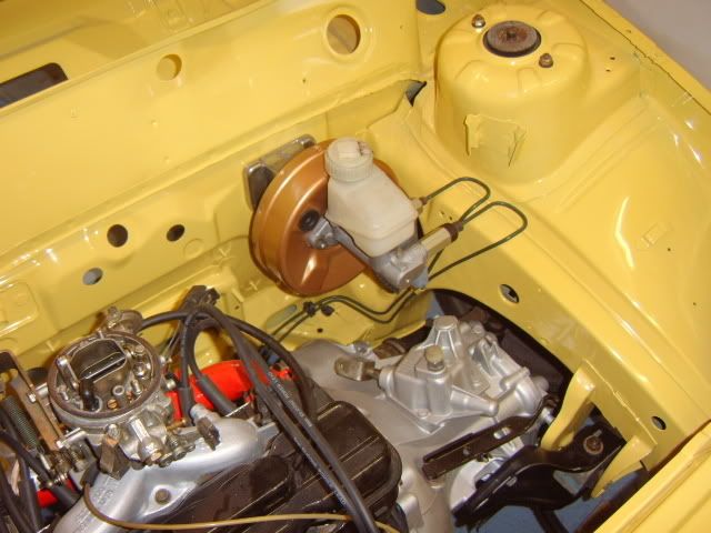

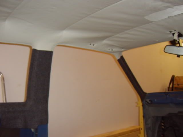

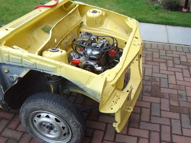

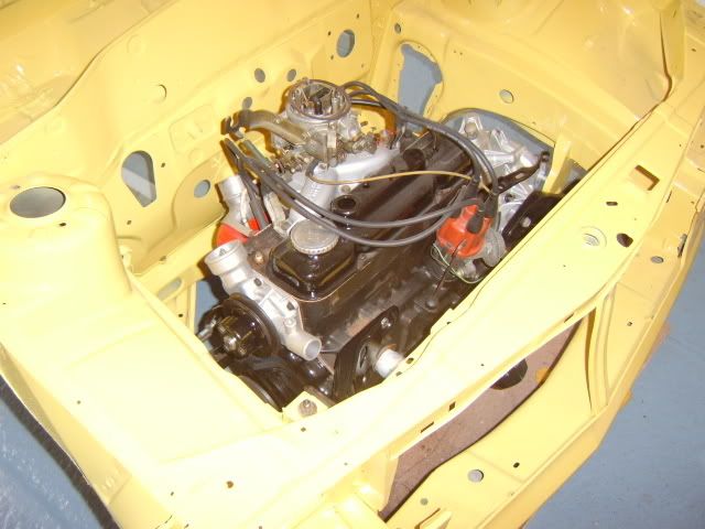

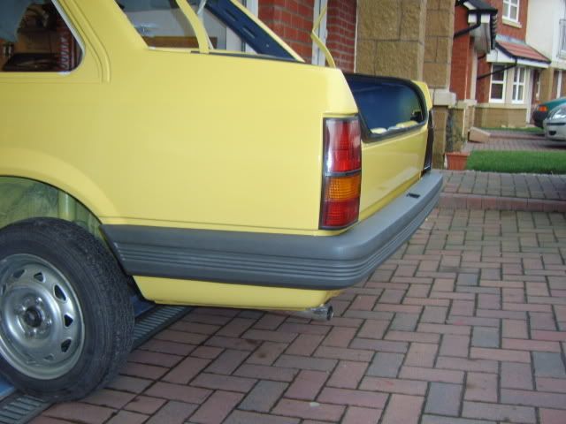

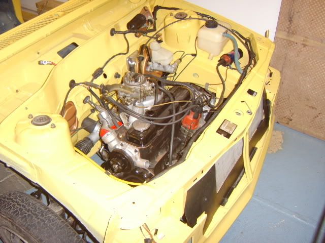

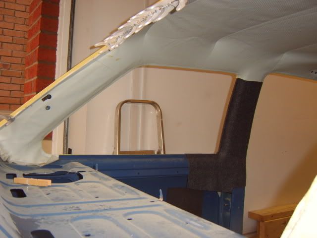

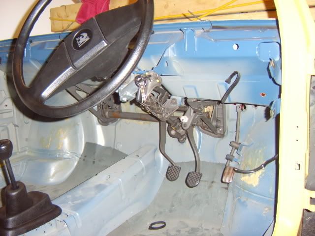

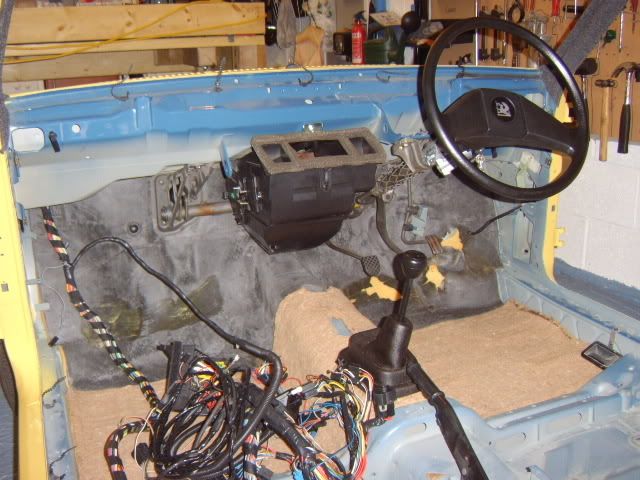

Went to collect the car at 10am on Saturday, was home with it and ready to work on it by 11am, engine was in by 12pm. Then in went the rear brake pipes & brake master cylinder, fuel tank, exhaust, pedal box, steering rack. Wiring loom went in this morning at 5am along with the radiator. Had to go shopping but got ?5's worth of fuel, back at 10am, engine was running at 11.40am after having to suck the fuel through the lines as the pump was taking forever and draining the battery due to cranking over for ages. Then onto the A & B pillar trims which is accoustic cloth, then on with the roof lining which is only fixed on the passenger side, waiting for this to dry before tensioning across to the drivers side. Will fit the passenger door rubber and rear passenger window first before doing so. Rear bumper is on along with the rear lights (cheers Steve for the Euro-Fog). Pretty much that's it so far.
