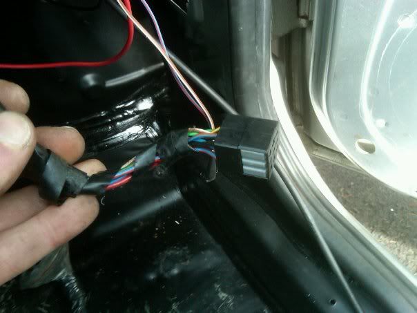

Right next to the 9 pin ECU one? Thats also part of it, Can't remember exactly what it does, Might not even be needed for your XE conversion.Quote:

How many wires and what colours are they?

This plug Alex, in the drivers footwell...
http://i80.photobucket.com/albums/j1...cker/plug1.jpg
9 pin connector that goes to the engine loom, for the clocks etc.:thumb:
Ah ha, clocks as in , speedo/rpm/fuel gauge etc etc?Quote:
Originally Posted by Pancho
yeah, plus it has a perm live and a switched which come in handy for turning the ecu on....
and your fuel pump wire :thumb:
Yeah just checked the engine loom I removed from the car an the other half of it is there.Quote:
RPM wire
Fuel x2
Handbrake
Indicator light x2
And 3 others that ive forgot already lol probably EML, ABS & Fog light warnings at a guess though.
How it connects to the Jenvey loom though is another story lol lol
iirc the jenvey loom diag should show you what goes where. yeah the others are em light, abs and a/c...
Yeah they do, cant remember if they supply there looms as a DIY hard wire type affair or with multi plugs on the end though.
Not that it matters to me actually lol
diy hardwire, but look for aircraft type bayonet connectors, proper spiffy....
