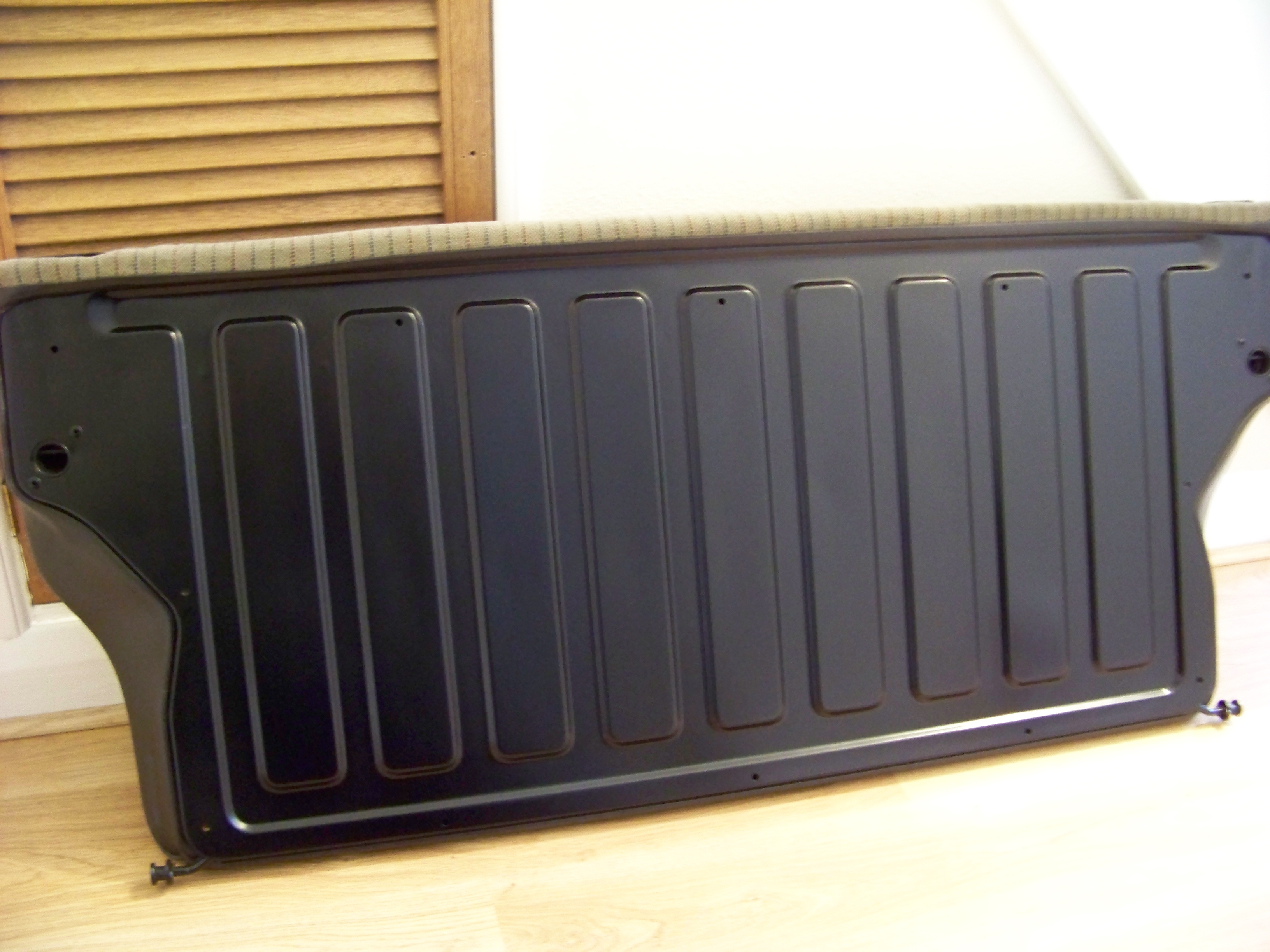

Weather was still crap, but I took the rear bench to the garage to finish off what I started. Managed to empty half a new can of satin black, should give it enough protection.
https://images2.imgbox.com/af/18/ehkixSzW_o.jpg
http://img140.imageshack.us/img140/7632/1000819a.jpg

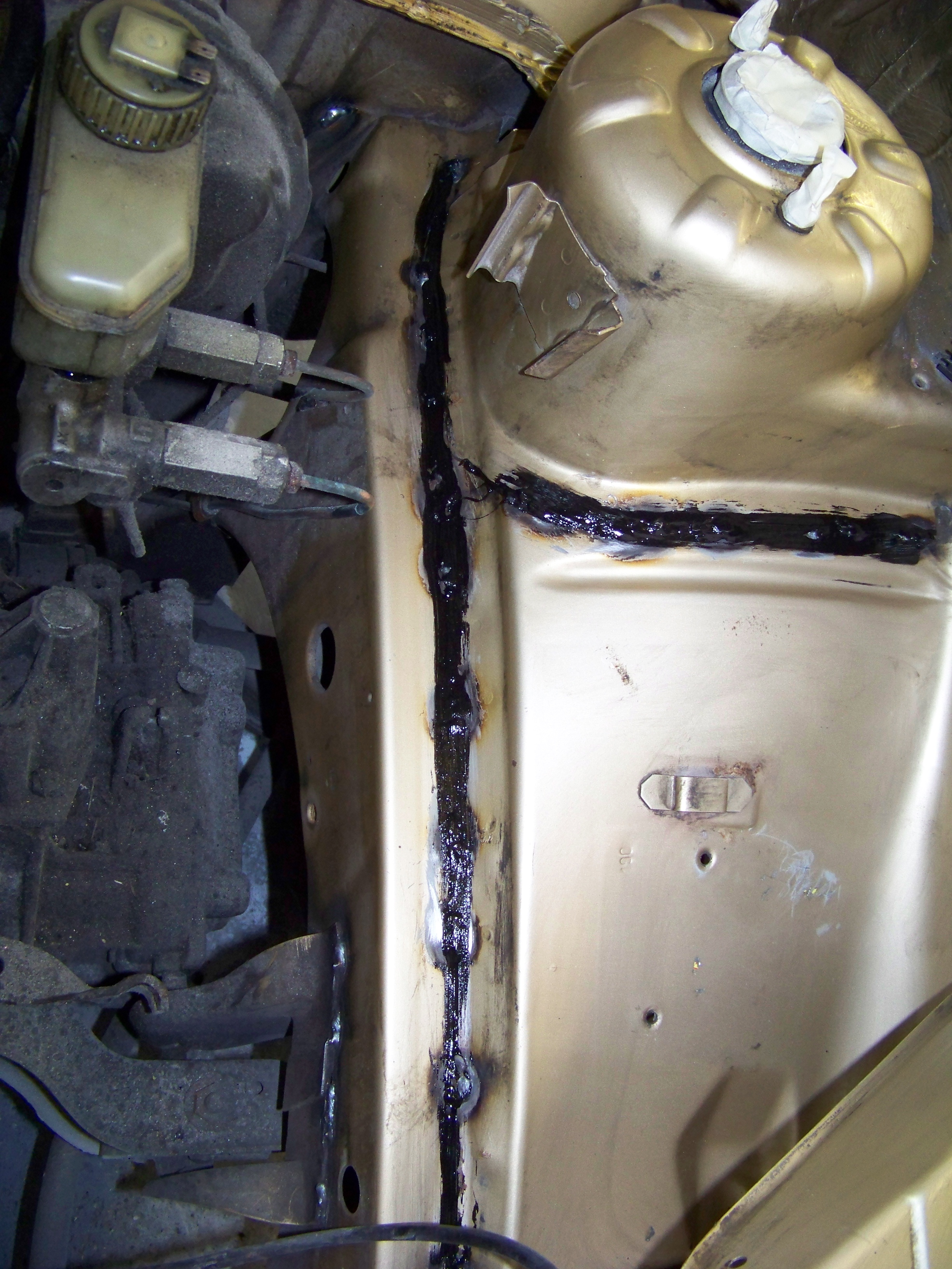

N/S chassis leg
https://images2.imgbox.com/13/d5/aF10Wh6Z_o.jpg

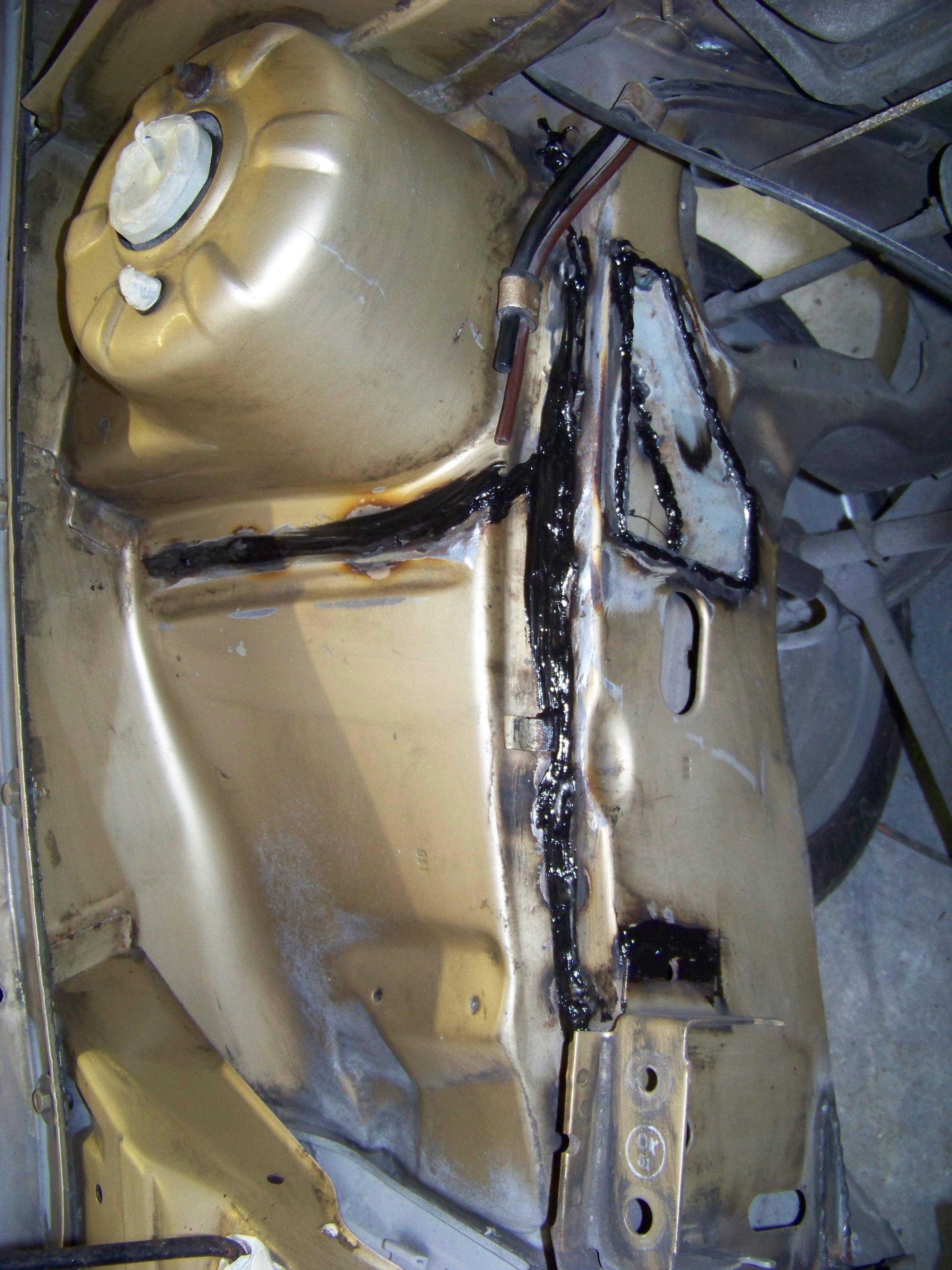

O/S chassis leg, alternator and bottom pulley areas cut out and box sectioned
https://images2.imgbox.com/d0/61/A2iKWBhT_o.jpg

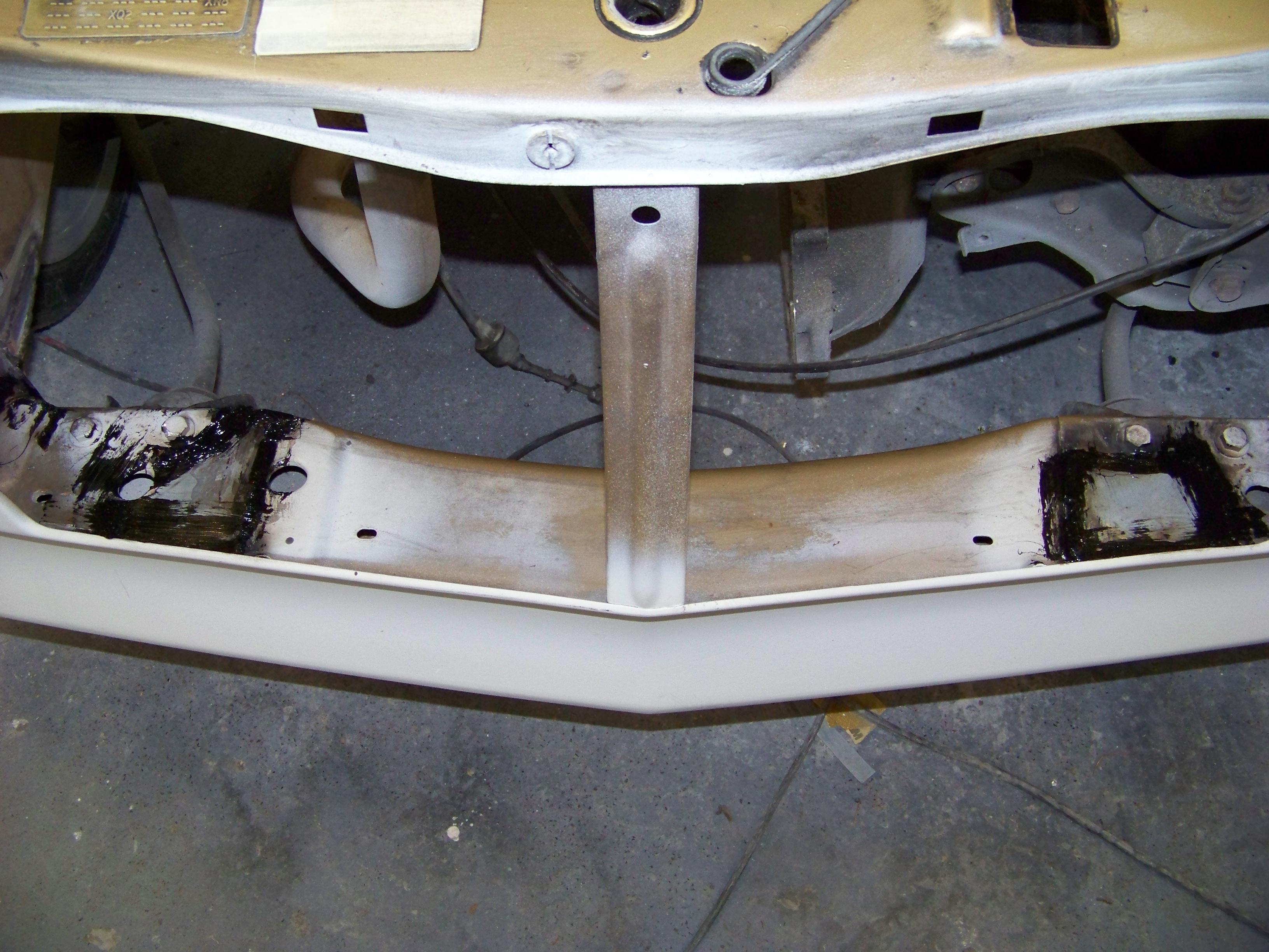

Cross-member tie bar points were a bit rusty and crusty, one side had a hole which was covered by filler. The other side was better but he cut out the infected areas and plated them.
https://images2.imgbox.com/af/d2/EKjHprjV_o.jpg

did the bodyshop do the cutout for alternator clearance? doesnt look like its open at the top? alternator will still hit
