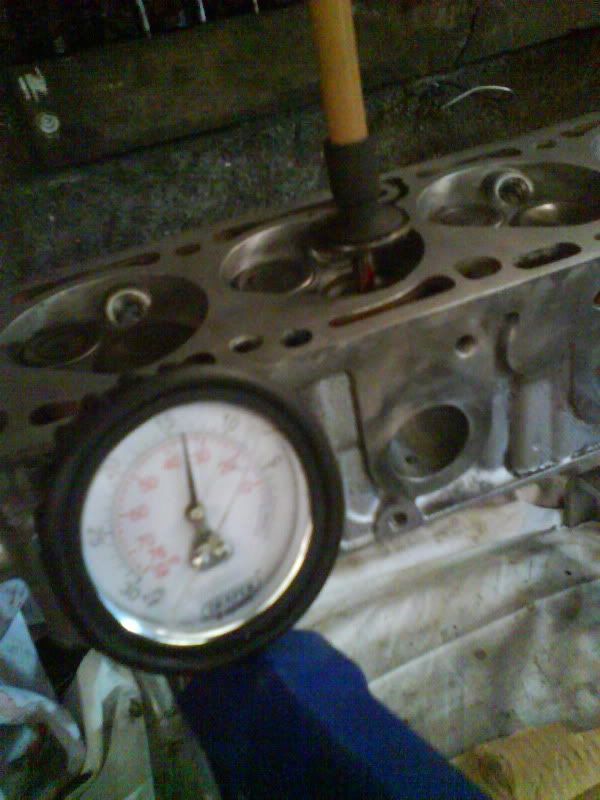

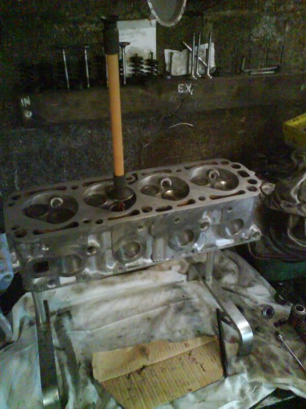

OK, to recap for those at the back - the head had new guides, valve seats cut and been away for a skim....so time to rebuild it. :thumb:
I happily lapped the valves in and then vacuum tested them - and then found only 4 out of 8 were sealing properly :roll:..... so back out they came and after another 2 or 3 goes each theyre looking good - all hold decent figures.
Tryin to take pics with one hand while holding everythin else with the other wasnt working - i was struggling to hold the gauge on and pump up etc - but you get the idea:
