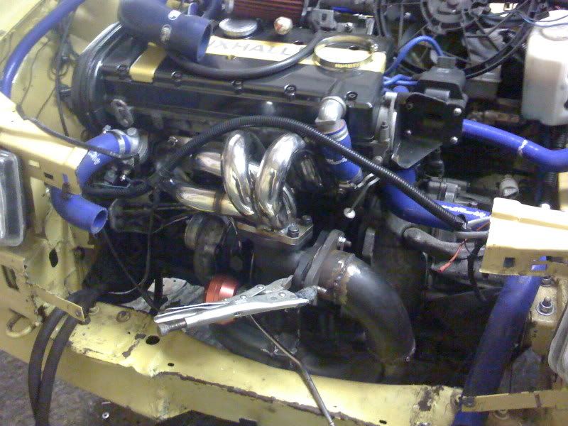

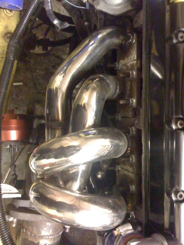

Few pics, excuse my Iphone quality pics lol:

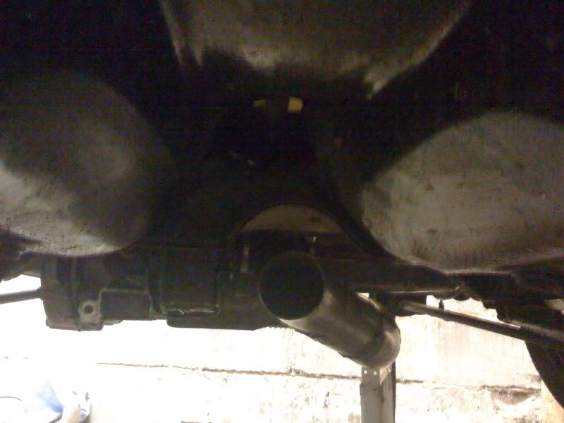

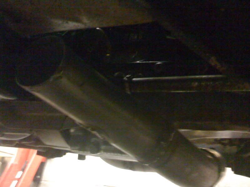

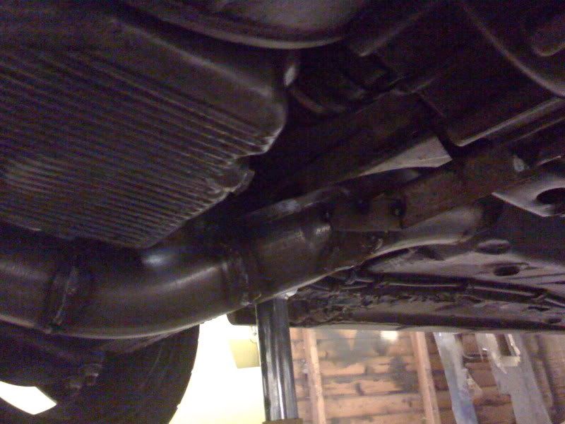

Downpipe I've been making:
