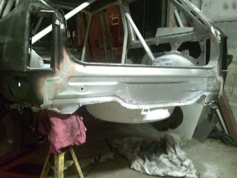

- Second coat of paint on the off side rear arch

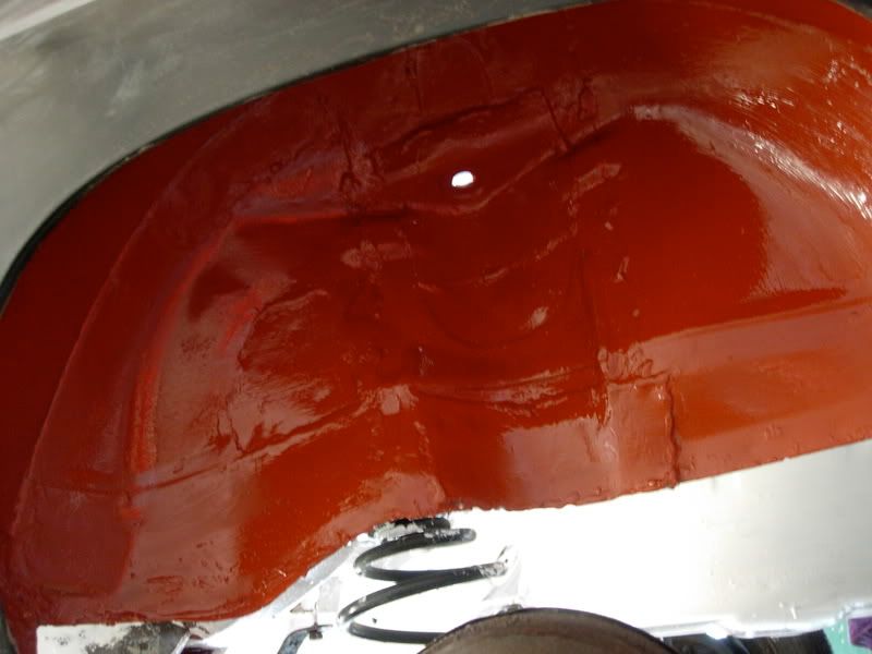

- Seam sealed near side rear arch but it reacted really badly with the primer so I will have to clean it off and do it again :roll:
http://img.photobucket.com/albums/v3...a/Image053.jpg

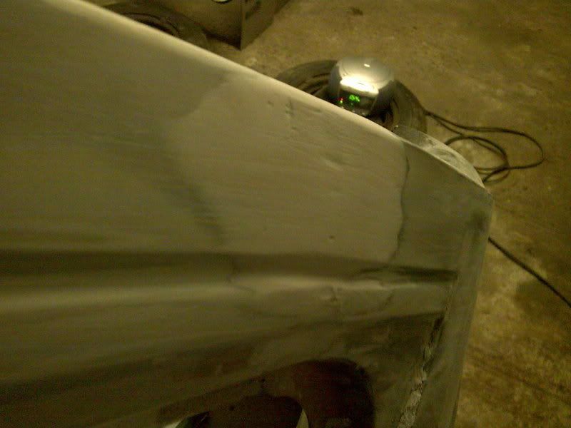

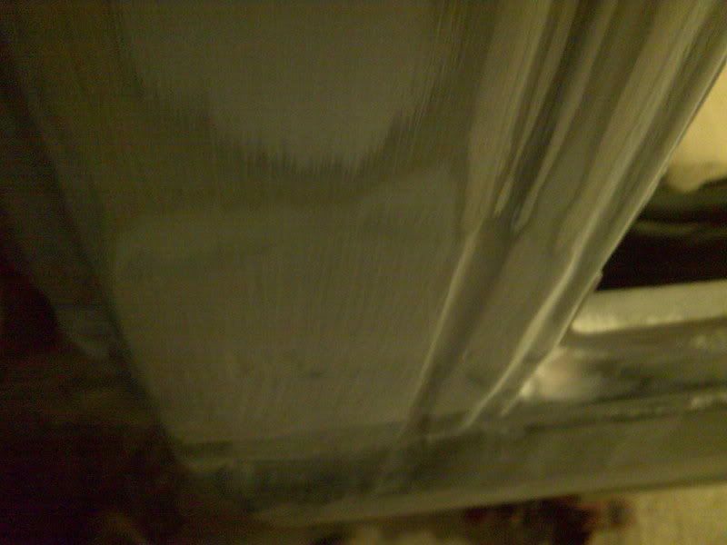

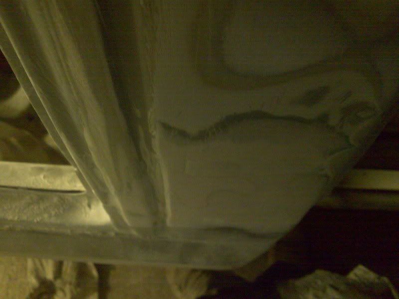

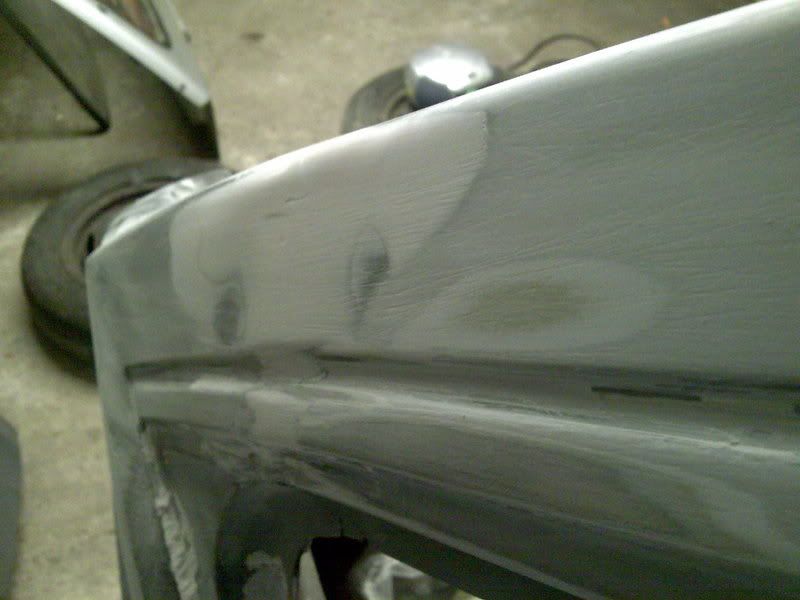

- Carried on smoothing and shaping the 1/4 pannel joins on the b pillar and behind the rear window (I'm going to call it the C pillar!:tard: :) )
Near side B pillar
http://img.photobucket.com/albums/v3...a/Image049.jpg
and Near side C pillar
http://img.photobucket.com/albums/v3...Image045-1.jpg
Off side B pillar
http://img.photobucket.com/albums/v3...a/Image050.jpg
and off side C pillar
http://img.photobucket.com/albums/v3...a/Image048.jpg
Bit more fettling required, there never going to be perfect, but look loads better and for an amateur at bodywork I recon I have done quite a good job!!:thumb:

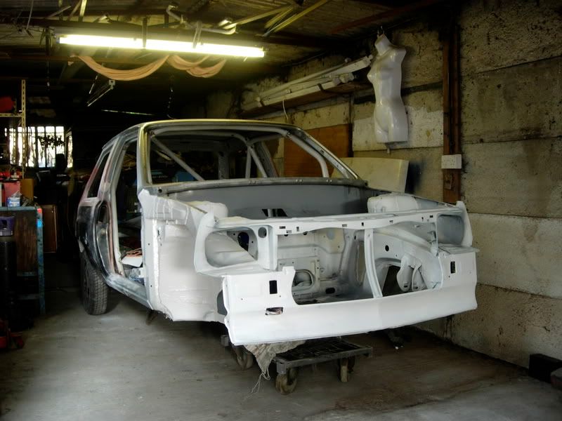

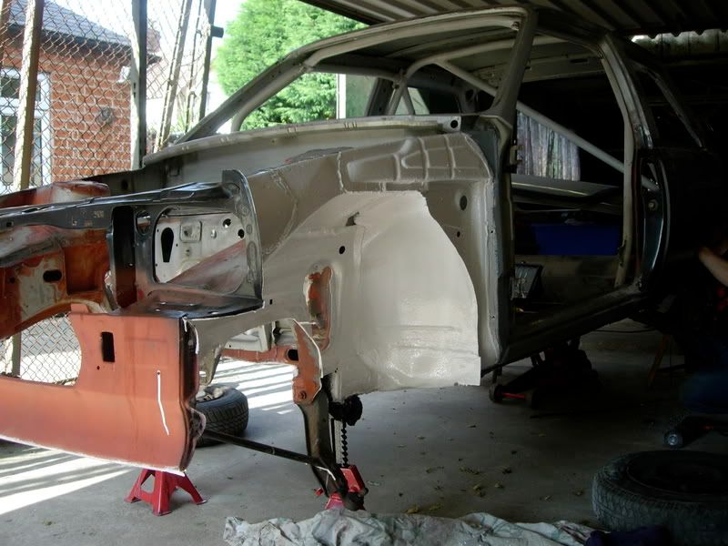

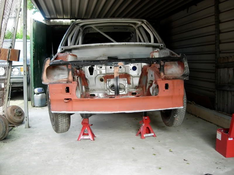

Got the car on stands again and front end stripped for the final coat of paint on the front arches
http://img.photobucket.com/albums/v3...a/DSCN2190.jpg
and painted
http://img.photobucket.com/albums/v3...a/DSCN2191.jpg

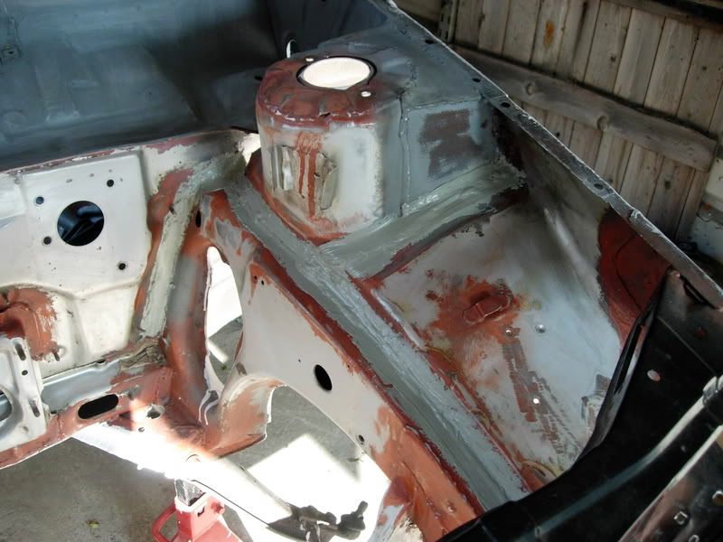

Whilst I was doing this ste set about cleaning out the reacted seam sealer from the near side rear arch with the wire brush drill attachment and re red oxided it ready for a fresh coat of sealer
http://img.photobucket.com/albums/v3...a/DSCN2196.jpg
and finally the bay seams sealed
http://img.photobucket.com/albums/v3...a/DSCN2193.jpg
http://img.photobucket.com/albums/v3...a/DSCN2194.jpg
The bays ready for some primer now. should look better with a coat of primer as it will be all one colour!lol

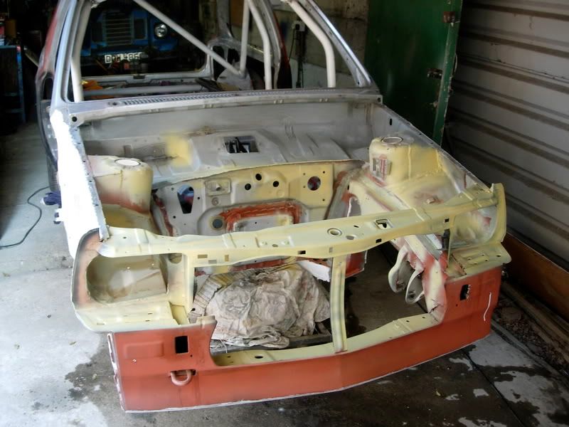

another update, only a couple of pics though

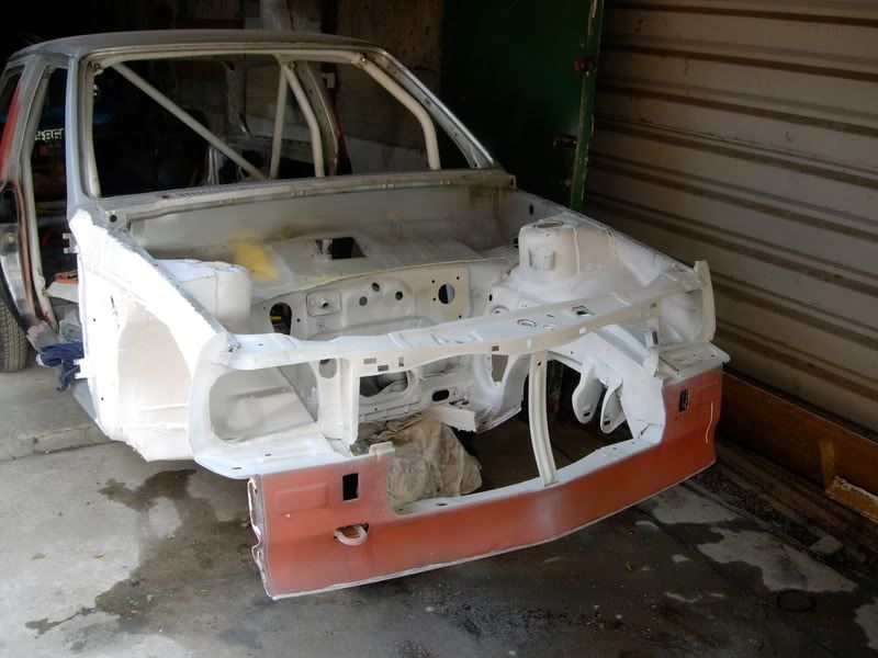

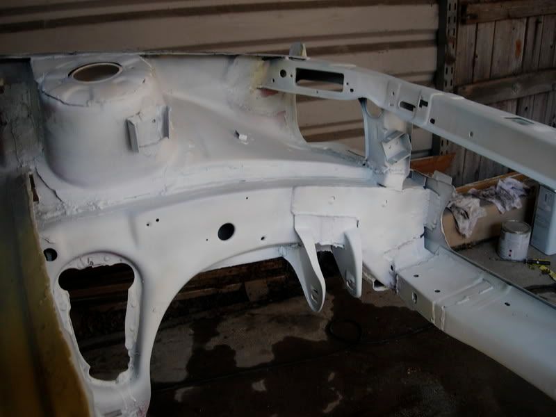

Finished rubbing down the bay and blew off the dust with airline then wiped down with some thinners. Etch primer applied to bare metal areas and on the slam pannel
http://img.photobucket.com/albums/v3...a/DSCN2242.jpg
Part way through priming
http://img.photobucket.com/albums/v3...a/DSCN2243.jpg
And all done
http://img.photobucket.com/albums/v3...a/DSCN2246.jpg
http://img.photobucket.com/albums/v3...a/DSCN2244.jpg
http://img.photobucket.com/albums/v3...a/DSCN2247.jpg
The eagled eyed amongst you may notice the battery tray area is grey primer and the rest of the bay is white! this is because I ran out of white and only had grey left lol
Will get covered anyway:cool:
