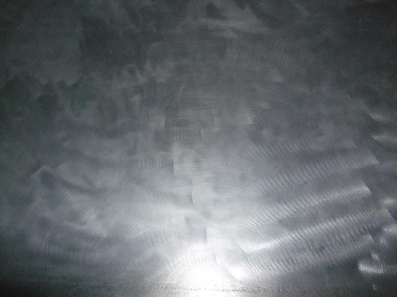

I started with the acid cleaner & passivate to prepare the metal...

This brought the metal back to a perfectly clean state with no corrosion, the stuff is fookin awesome but it burns like hell when you get it on you!

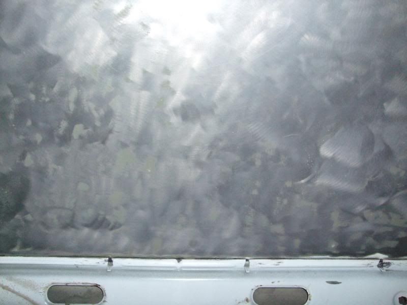

I then used the second stage stuff with puts a protective finish on the metal which readies it for paint...

BTW, the brown round the edge of the roof is the Dinitrol cavity wax.

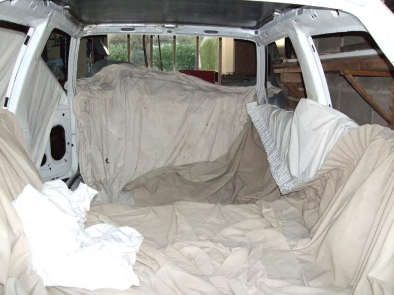

I put plenty of sheets down to protect the rest of the shell...

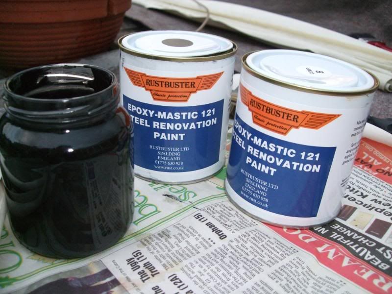

Then mixed the Epoxy Mastic paint which dries rock hard like Araldite and seals the surface to stop any further corrosion...
http://img.photobucket.com/albums/v3...t/DSCF1502.jpg
