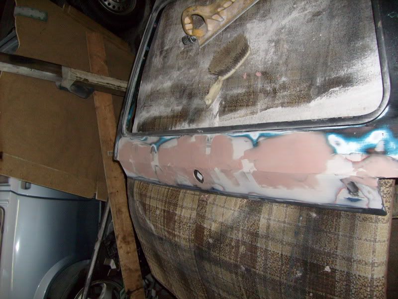

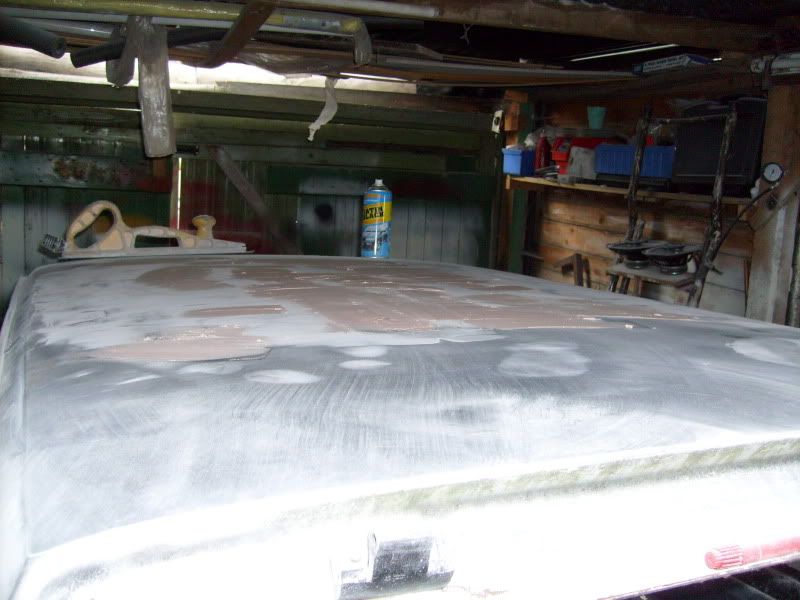

another pic of how the roof is looking
http://i12.photobucket.com/albums/a2...n/S7302945.jpg

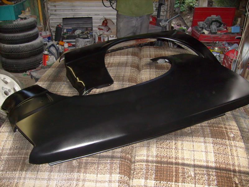

put her outside to do some of the panel work
http://i12.photobucket.com/albums/a2...n/S7302946.jpg
bonnet during painting
http://i12.photobucket.com/albums/a2...n/S7302947.jpg
wings all done
http://i12.photobucket.com/albums/a2...n/S7302949.jpg

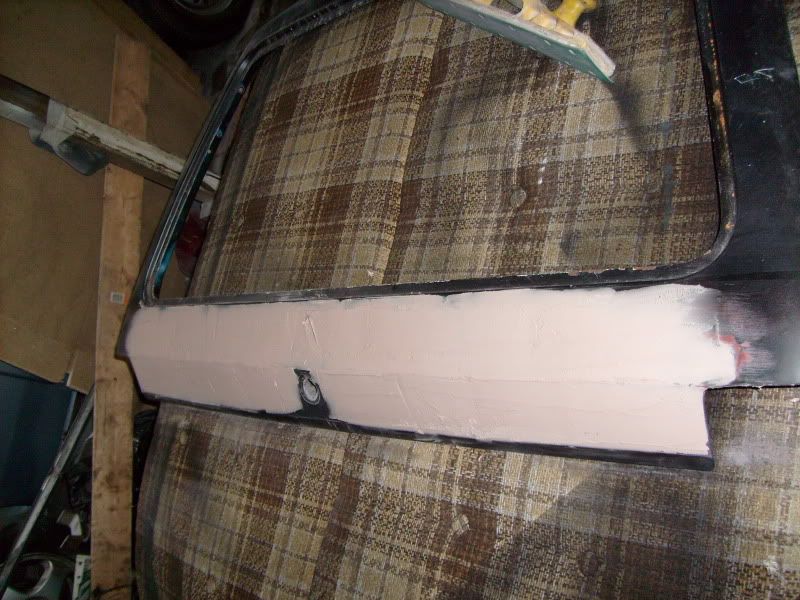

then started on the boot. one full skim
http://i12.photobucket.com/albums/a2...n/S7302951.jpg
then a second
http://i12.photobucket.com/albums/a2...n/S7302952.jpg
and third. gonna need a tiny bit more but its basically done :D

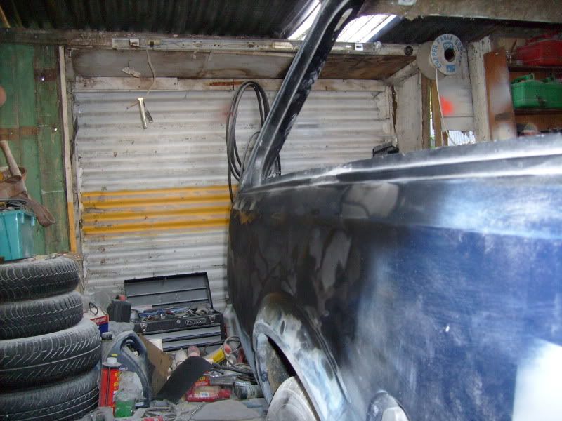

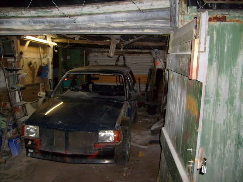

tucked up for the night
http://i12.photobucket.com/albums/a2...n/S7302954.jpg

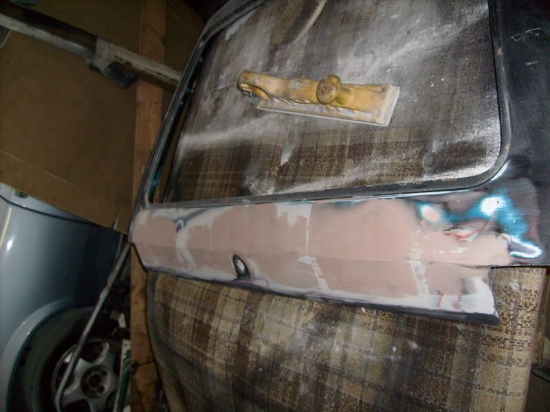

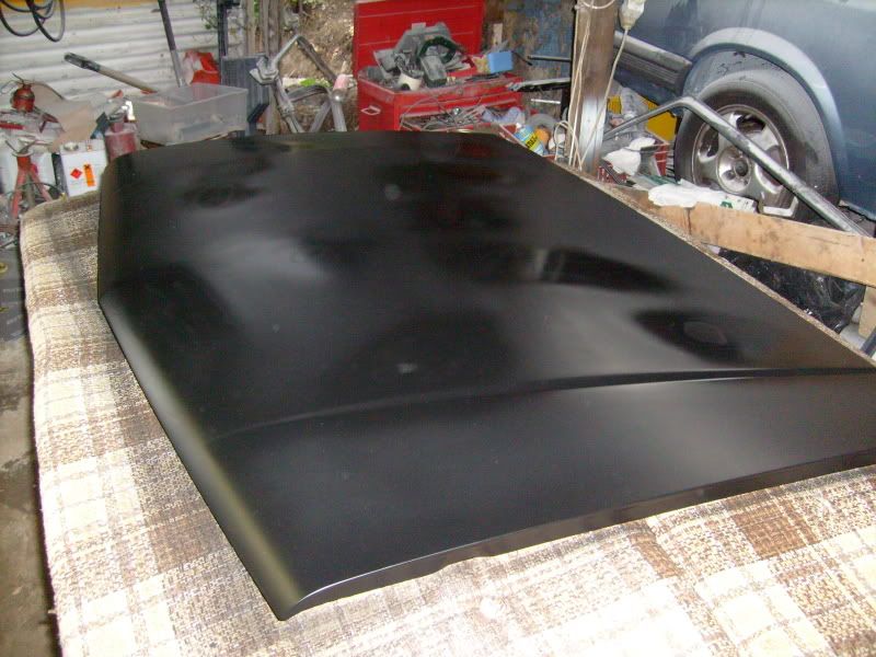

well todays task was the rear quarters and paint the bonnet.
the bonnet is an epic fail!!! basically the paint didnt cover the blemishes which meant i had to primer it. so tried primering and that reacted:mad: so put that to one side and got on with the quarters
first set up the radio :p
http://i12.photobucket.com/albums/a2...n/S7302960.jpg

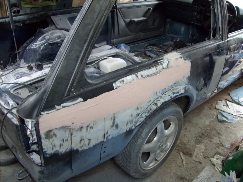

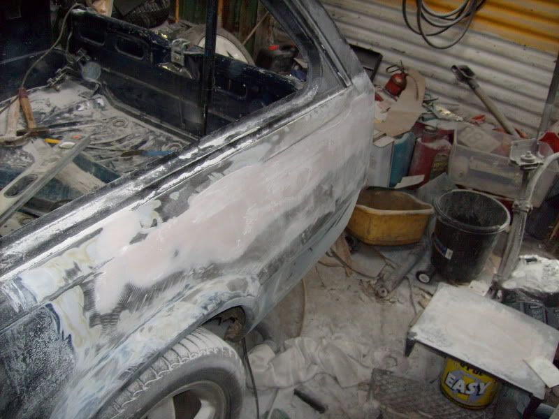

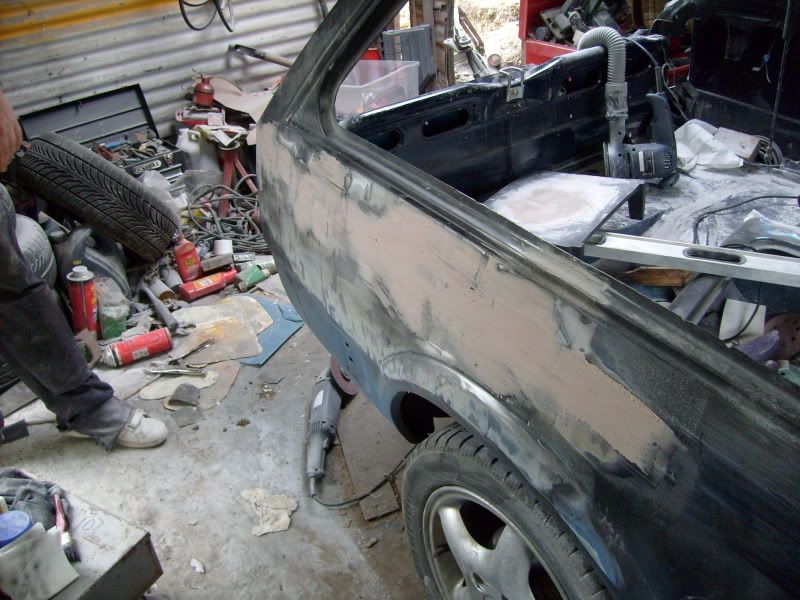

then as with the roof i decided best course of action was rip the fibreglass off, didnt get a pic but this is with the first skim of filler
http://i12.photobucket.com/albums/a2...n/S7302956.jpg
http://i12.photobucket.com/albums/a2...n/S7302957.jpg

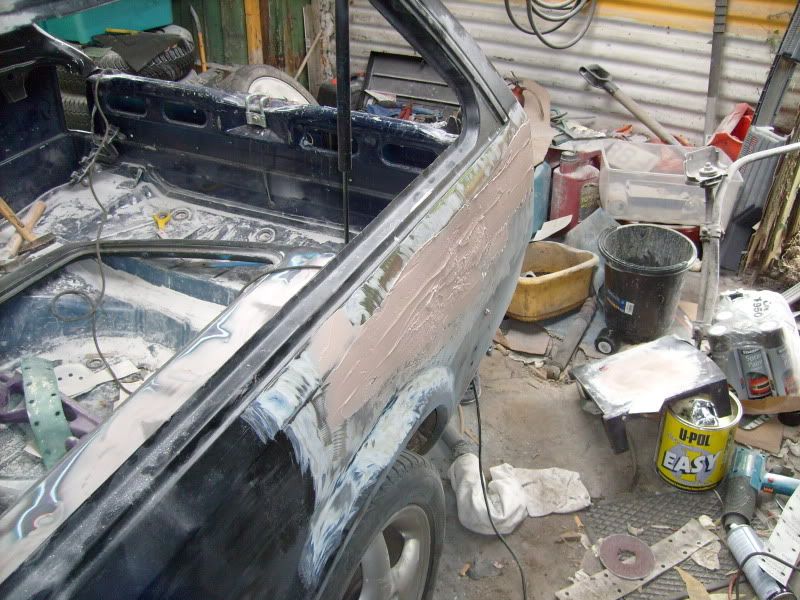

then basically rubbing down and more layers
http://i12.photobucket.com/albums/a2...n/S7302959.jpg
http://i12.photobucket.com/albums/a2...n/S7302961.jpg
using the string to get an idea of where the line is supposed to be
http://i12.photobucket.com/albums/a2...n/S7302962.jpg

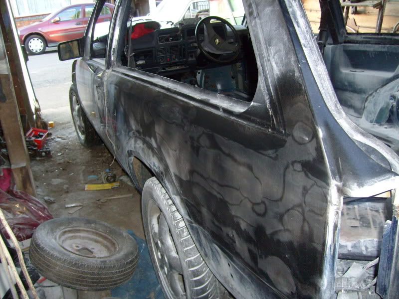

not the best pics but they are basically there. need a little skim here and there but im happy with how they are going. its patchy because its a guide coat
http://i12.photobucket.com/albums/a2...n/S7302963.jpg
http://i12.photobucket.com/albums/a2...n/S7302964.jpg
Its Matt paint you're using yeah? Its a right tit for reacting with everything in sight and tends to be pretty thin. It will show up any blemishes and doesnt take a 2nd or 3rd coat too well mate. CHances are you'll need to rub the bonnet right back and give it a real good cleaning before priming it again.
