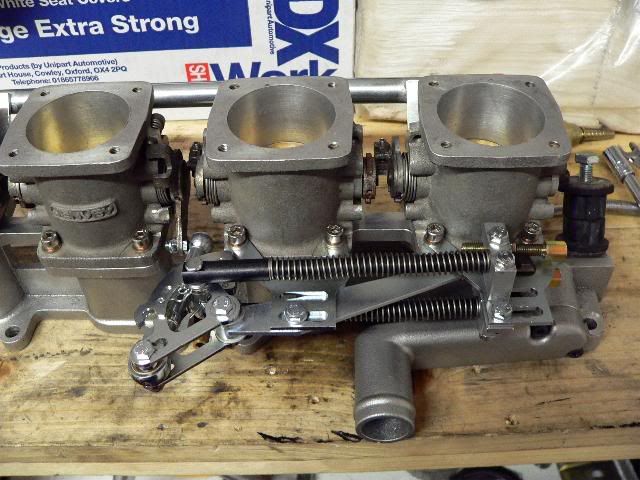

im running throttle bodies and only on 50psi ?
It depends on the injectors/map your using.
You could run 3bar if you want, if the injectors were suitalbe sized and the ecu mapped to suit.
V. high pressure usually means your using quite small injectors, ehence needing more pressure to deliver more fuel

I see, i didnt even think the small peco injectors wanted that sorta pressure, cheers for the explanation :thumb:Quote:

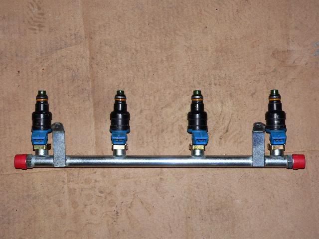

Olly uses standard XE creams :thumb:

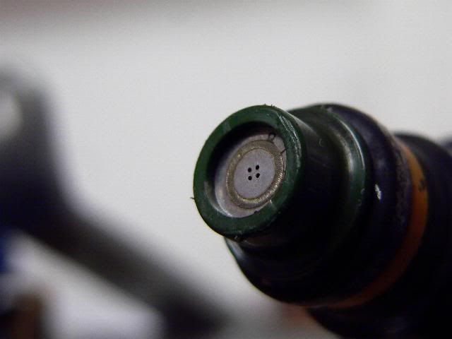

thought it was blues he was useing as they have a better spray pattern 4 holes! as appose to the creams with have one HUGE hole and blues i believe are a slightly larger cc/min than creams
Defo creams...
i was just going by this thats all my bad he has obviously changed them for creams! :thumb:
he has indeed.....
