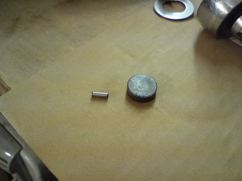

Got a feeling that its fitted inside one of the shafts, same as the standard one. I'll got check mine later. I assume the magnet is there for scale referance.
EDIT: Didn't show your second post at first lol
looks good cp! that pin does look suspisciously like a roller from a bearing though, which could be not great news if you've built it all up now, magnet goes in a slot in the casing iirc
top job love the build!
No its not out of a bearing, they are complete with nothing to fall out - it came in a seperate packet with circlips and roll pins etc. I'm wondering if its something to do with the selector turret assembly - I dont have the uprated one at the moment:confused:Quote:

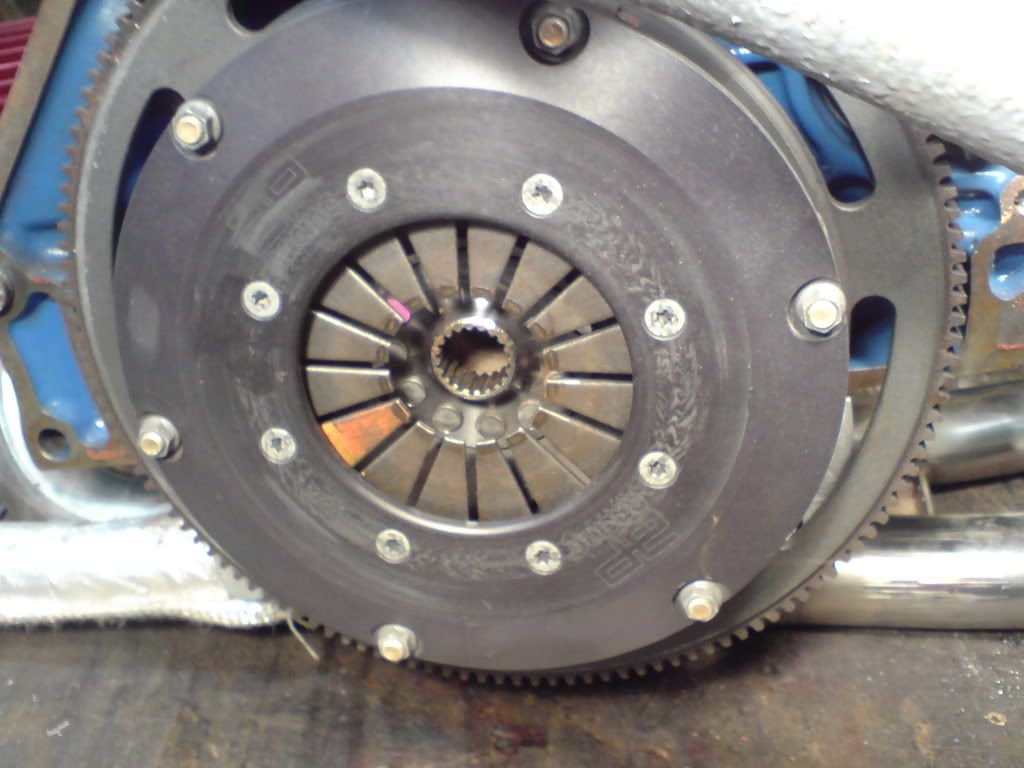

BTW Lee i found out the problem with the clutch apparently not biting - ahem:roll: :gay:
The splined input shaft that slides through the clutch was too small. The 5SCCR is std sized. The AP clutch pack is made specifically for the dog box which has a large diameter splined shaftlol . So i had effectively rigged it with the input shaft not actually touching the splines of the clutchlol muppet!
http://i205.photobucket.com/albums/b...ostdone020.jpg

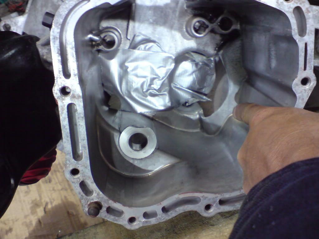

In order to fit a dog box material from the gear box has to be removed (similar stylee to fitting quaife ATB LSD) here:
http://i205.photobucket.com/albums/b...ostdone016.jpg
and here
http://i205.photobucket.com/albums/b...ostdone017.jpg.

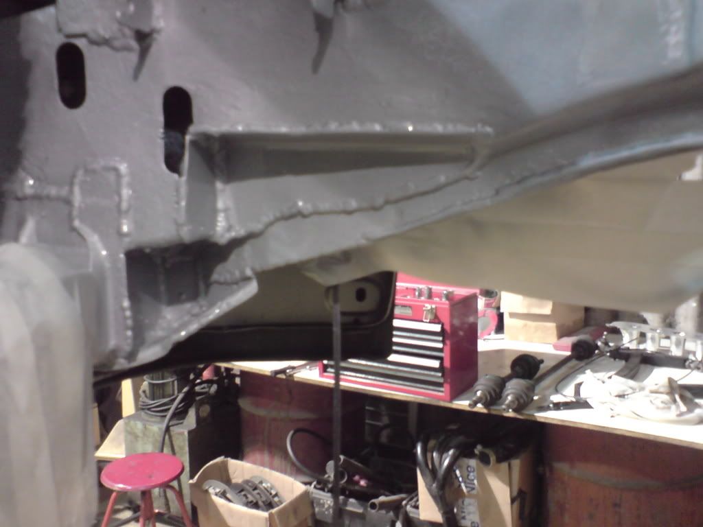

Other jobs. Sorted out the chassis leg where the oli pump sprocket gets in the way
http://i205.photobucket.com/albums/b...ostdone018.jpg

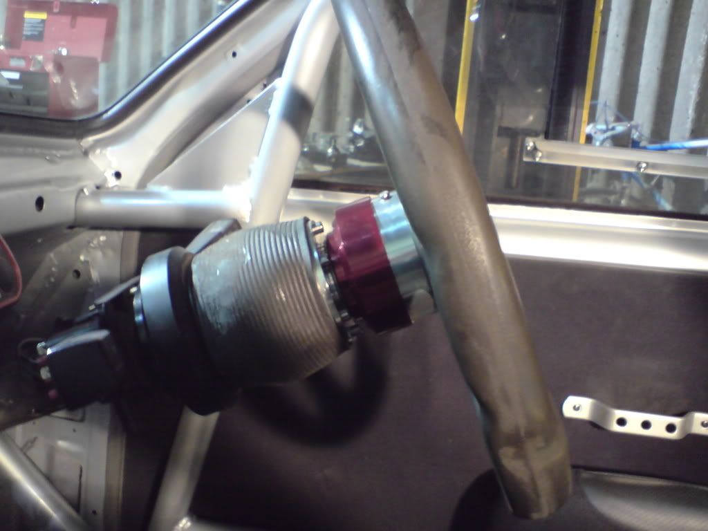

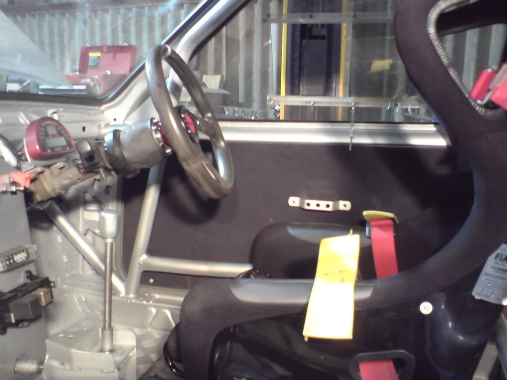

and fitted my snap off steering wheel
http://i205.photobucket.com/albums/b...ostdone019.jpg
http://i205.photobucket.com/albums/b...ostdone021.jpg

Found it - quaife's website have exploded diagrams of their boxes.Quote:
Originally Posted by CP
Its a dowell on the output shaft which means its all got to come apart again:mad:
BUGG+R!! :mad: :mad:Quote:
