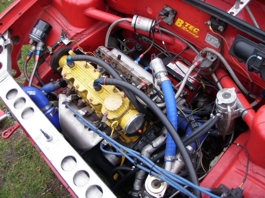

Sorry, here you go, not much to see though really, as there's lots of re-fitting and things to be done;Quote:

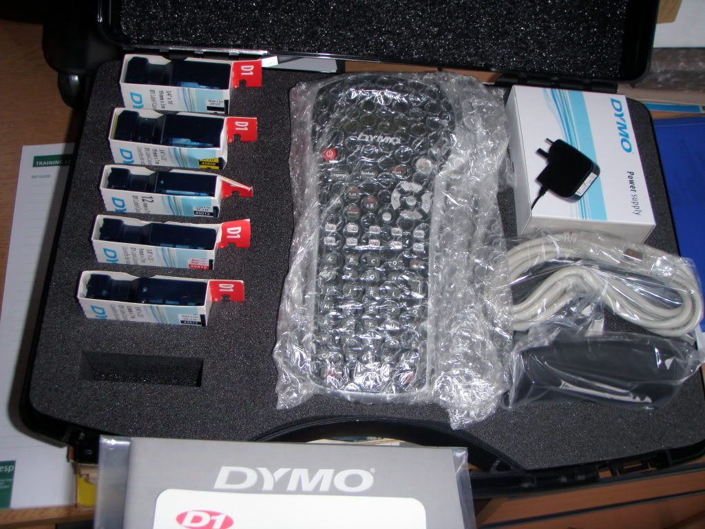

Also got myself a rather flash Dymo label printer, which will allow me to do some fancy labelling for switches, fuses etc.;

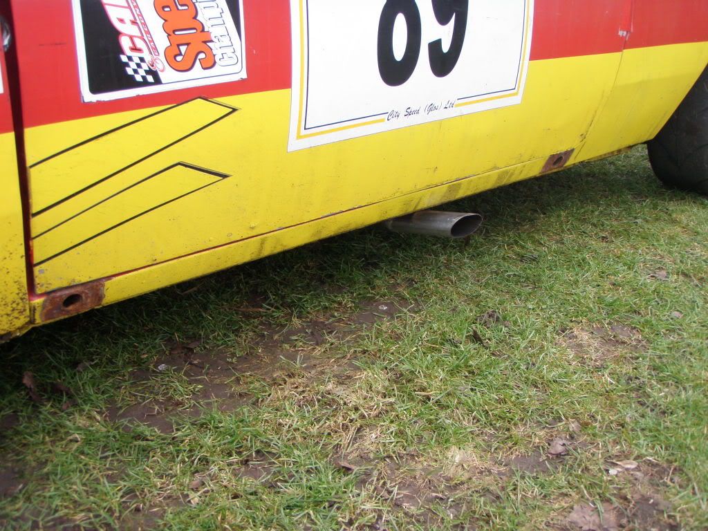

The new exhaust system now exits on the passenger side;
http://i285.photobucket.com/albums/l...ort/011-21.jpg
It's currently unsilenced, and may well be too loud to get away with at race meetings. The old exhaust system has been modified so it can be re-fitted in case of emergencies........

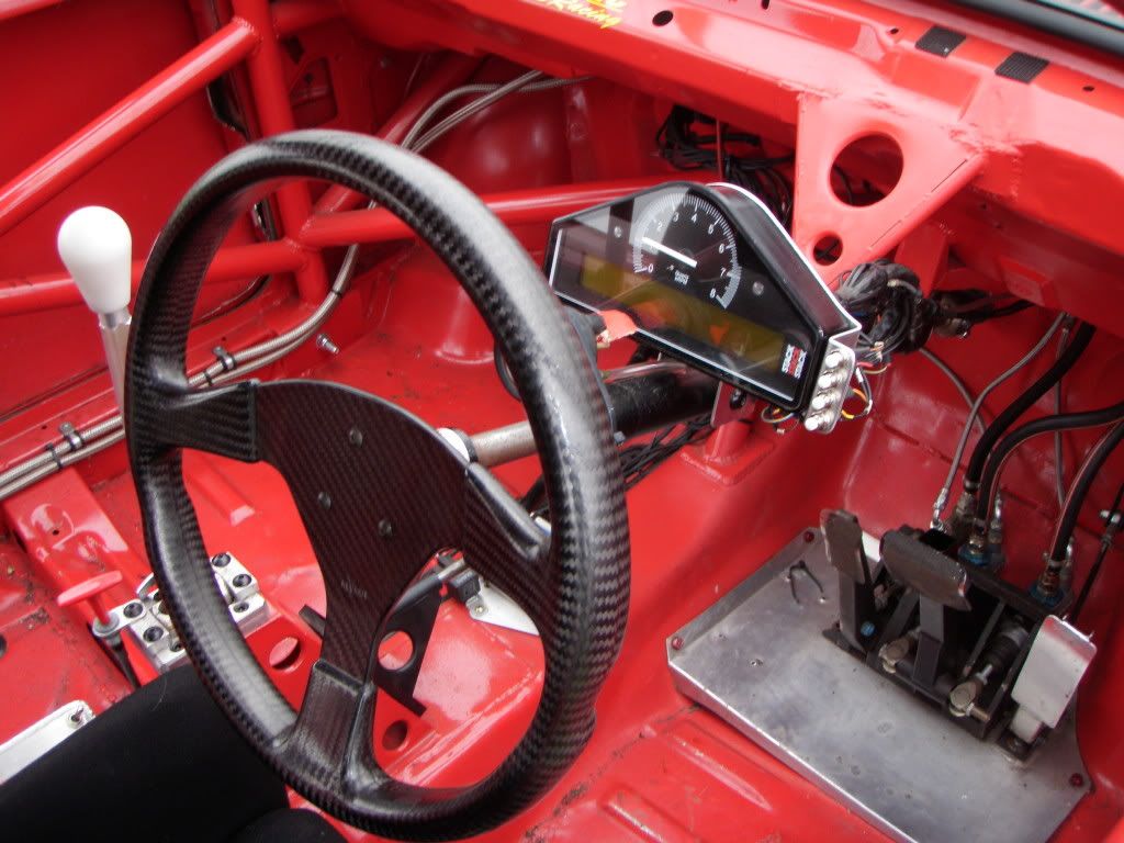

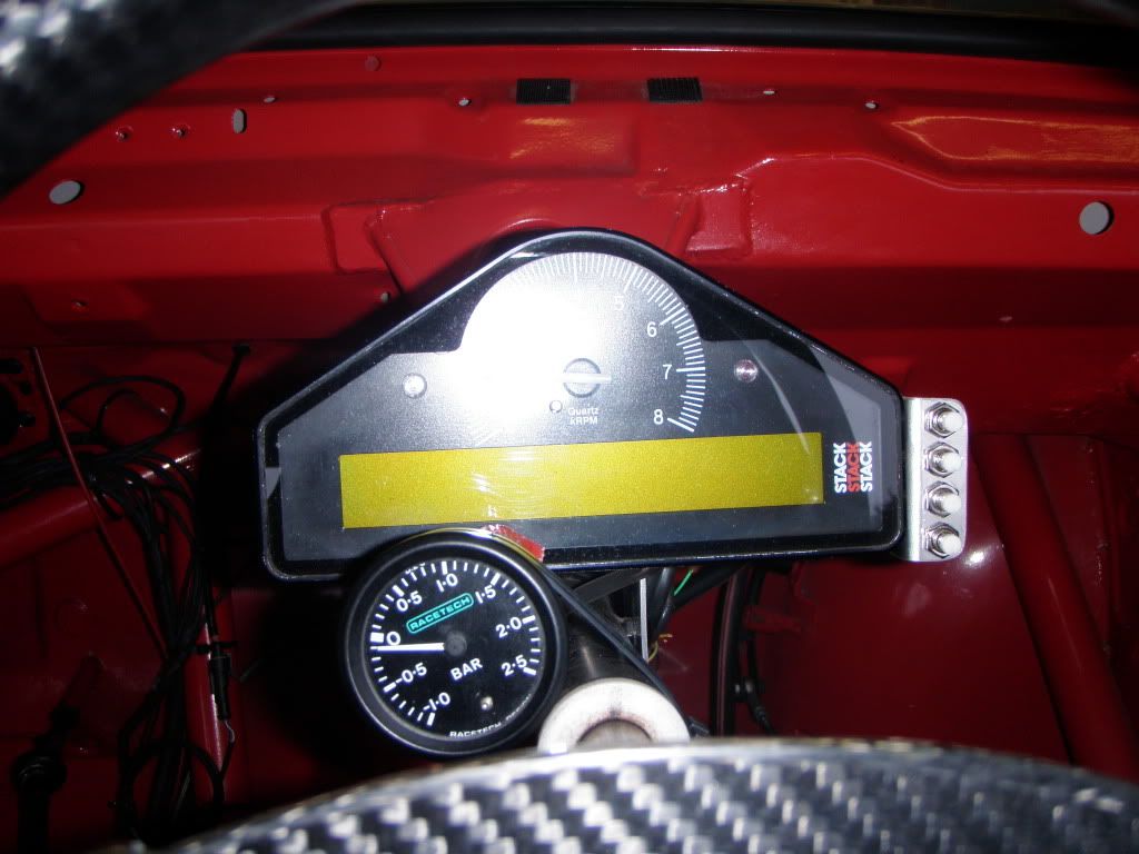

The new STACK dash is lovely, but the boost pressure sensor that came with it seems to be faulty, and at £250 +VAT for a new one, I'll make do with a temporarily rigged up separate boost gauge for the moment;
http://i285.photobucket.com/albums/l...ort/019-20.jpg
http://i285.photobucket.com/albums/l...ort/016-21.jpg

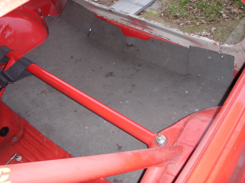

The boot floor will be covered with carbon fibre, I will make up a cardboard template first, based on the Vauxhall-supplied carpet template;
http://i285.photobucket.com/albums/l...cort/025-7.jpg

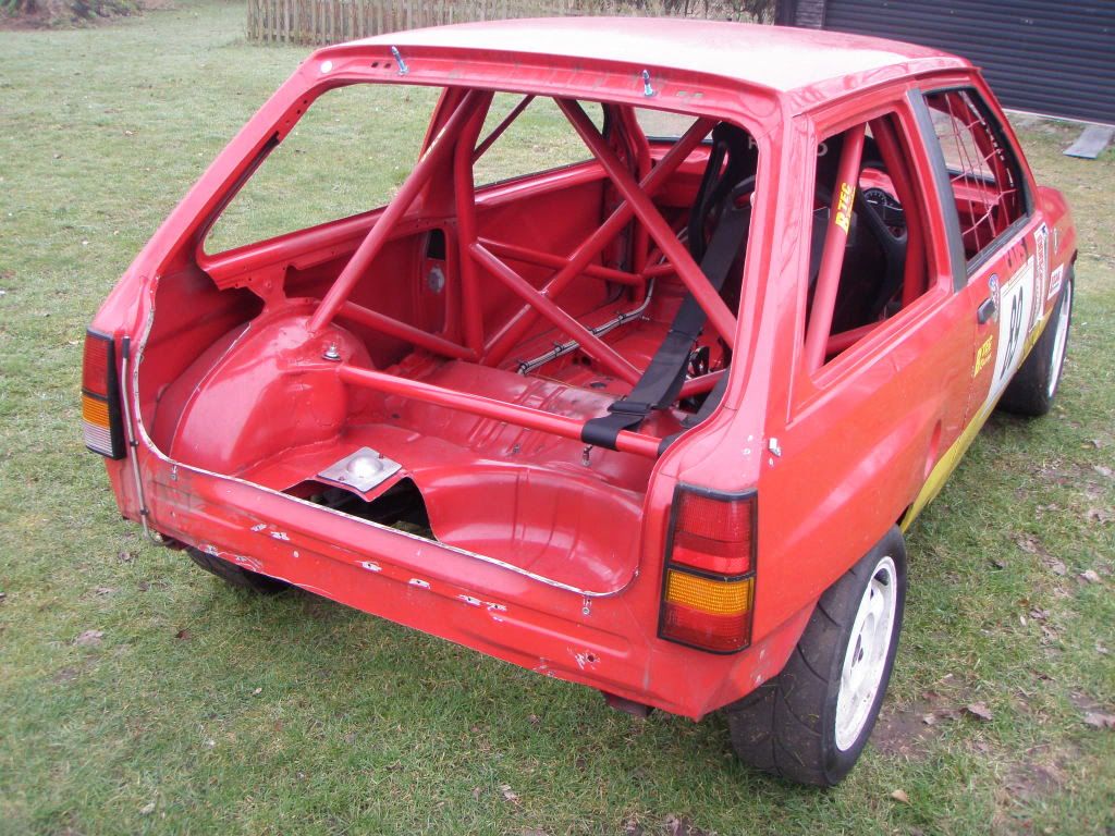

The rear piece of the bodykit which incorporates the rear light blanks is ridculously heavy for fibreglass!!;
http://i285.photobucket.com/albums/l...cort/024-8.jpg

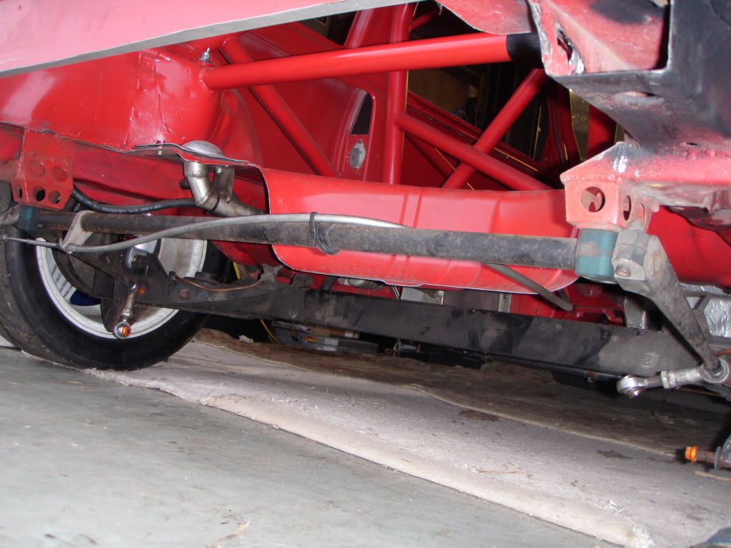

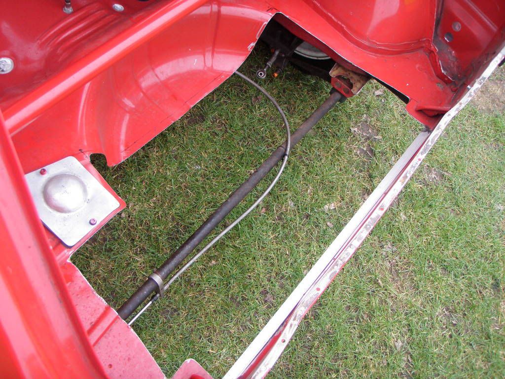

And I think I'll do away with the rear towing eye, saves a small amount of weight, but more importantly it reduces the overall length which it needs to fit into my enclosed trailer;
http://i285.photobucket.com/albums/l...cort/026-9.jpg
The rear anti-roll bar can be used as a towing point without a problem.
The ARB has another useful purpose, I can stand in the hole cut-out in the boot floor and lift the whole rear end off the floor with ease.

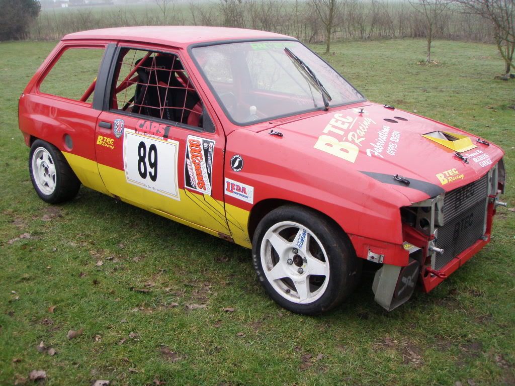

Dragged it out into the sunshine this morning to get a bit of work done on it;
http://i285.photobucket.com/albums/l...cort/027-7.jpg
http://i285.photobucket.com/albums/l...cort/028-7.jpg
http://i285.photobucket.com/albums/l...cort/029-9.jpg
http://i285.photobucket.com/albums/l...cort/030-8.jpg
More detailed photos later, depending on progress!
colin, i can't remember.... are you swapping the bonnet or not?? the cooling scoop does look a touch odd, is there a tidier way of doing it?
I'm not planning to swap the bonnet.Quote:
Originally Posted by mowgli
The cooling scoop is a hangover from an earlier intercooler installation from quite a few years back. It's redundant now.
I have a carbon fibre scoop that could be fitted, or I could just glassfibre over the hole. It's not on the 'high priority' list with all the other jobs that need doing though!

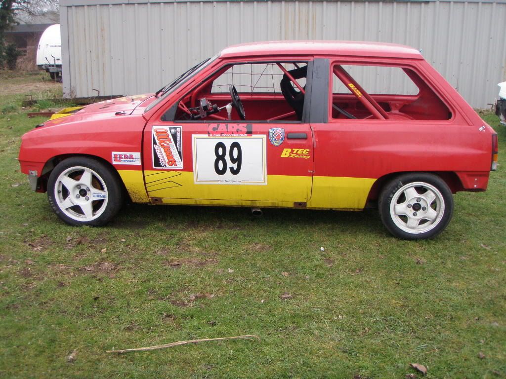

Mattig-kitted with 8" x 15" Compomotive split rims, Redtop 2.0 16v, unused for 10 years (when it was built). Very much a stripped out track/sprint car, but it is road legal.Quote:
Originally Posted by boffer8
Just got a new MoT on it, and it is up for sale....
