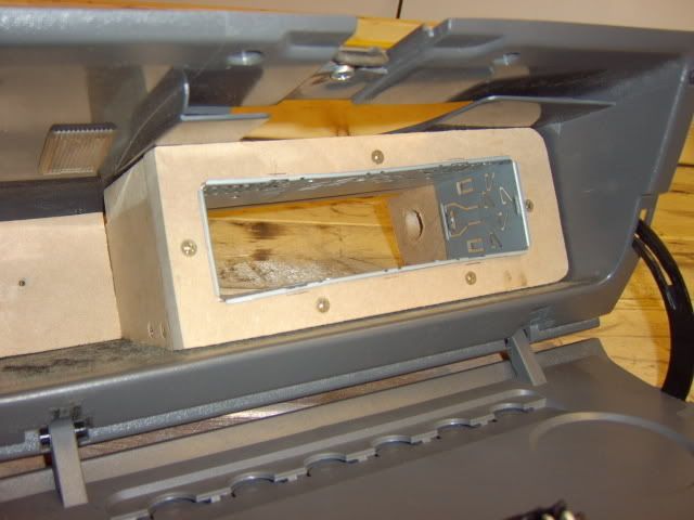

I am re-fitting the stereo blanking plate that you can see in this photo.
http://i73.photobucket.com/albums/i2...s/STA60036.jpg

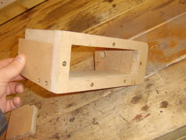

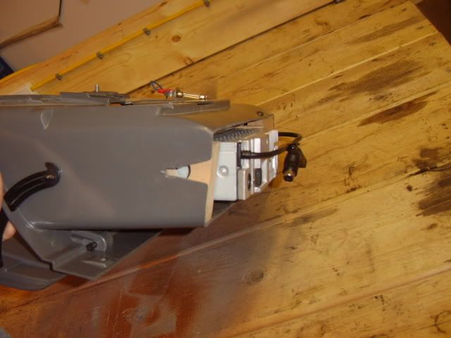

So will be re-locating the head unit to the glove box, so a little trimming in MDF is required.
http://i73.photobucket.com/albums/i2...STA60010-3.jpg

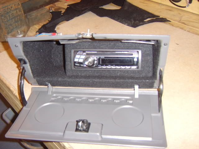

Have cut the back off the glove box for access.
http://i73.photobucket.com/albums/i2...STA60009-2.jpg
Still have a little space for gloves on the left of the head unit.
http://i73.photobucket.com/albums/i2...STA60008-2.jpg
Just have to take apart and cover in accoustic felt and that's another job done.

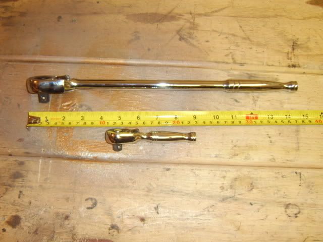

And this:
http://i73.photobucket.com/albums/i2...STA60014-1.jpg
My Mum got me these:
http://i73.photobucket.com/albums/i2...e/STA60013.jpg

Nice, like the stealthy head unit lol
looks like someone had a better xmas than me! I just got the usual clothes lol
i really like the idea of the head unit in the glove box mate, very cleaver.
iain

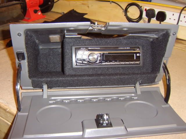

Doing the same with my sport.
Did it on my spider, but you'll need to add a fan to keep it cool if your tightly enclosing it
^ and especially with an alpine, I found they run much hotter than anything else..

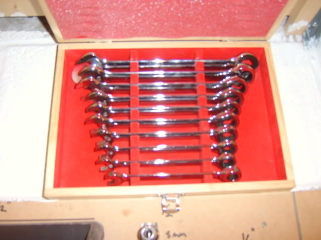

Always nice to get some new tools, rachet spanners are probably the most useful tool(s) i've bought so far.
Dismantled ready for re-trim.
http://i73.photobucket.com/albums/i2...STA60014-2.jpg
Apologies for not taking photos along the way, hands were a bit gummed up.
http://i73.photobucket.com/albums/i2...l/STA60015.jpg
Was a tight fit getting this all back in there with the additional thickness of the carpet. Pretty chuffed with the results.
http://i73.photobucket.com/albums/i2...l/STA60016.jpg

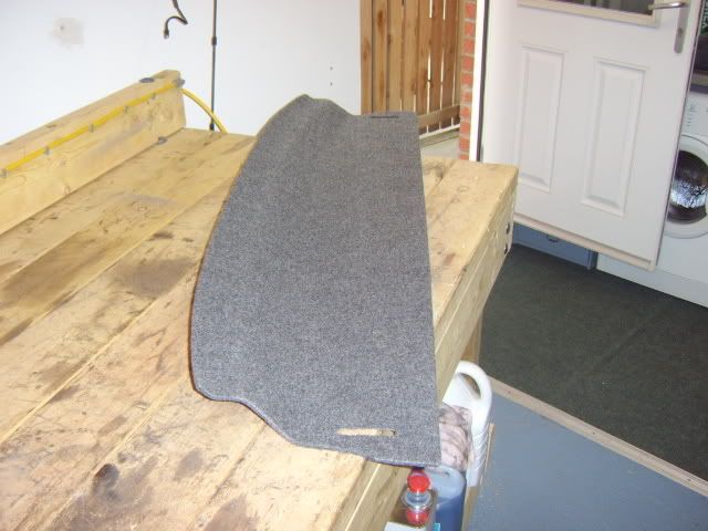

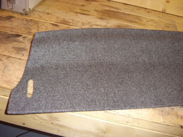

As I was in a trimming mood, the parcel shelf thingy got the same treatment.
http://i73.photobucket.com/albums/i2...l/STA60017.jpg
http://i73.photobucket.com/albums/i2...l/STA60018.jpg
http://i73.photobucket.com/albums/i2...l/STA60019.jpg
The 6x9's with be mounted below and not protrude at all.

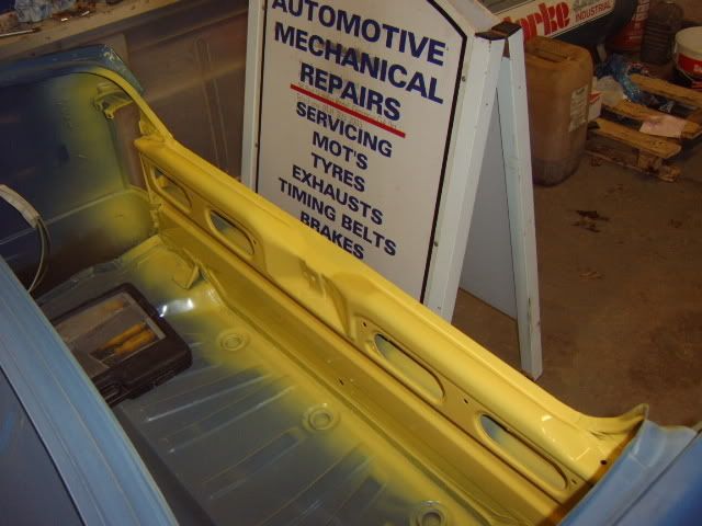

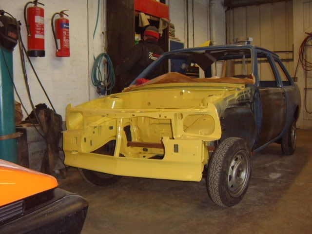

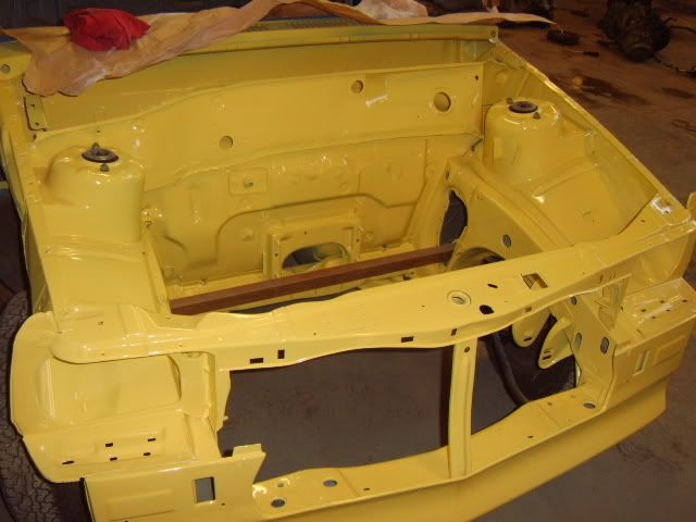

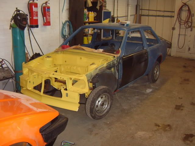

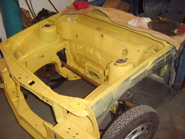

"Finally" I hear you cry, there's paint on the car.
Ok, it's just the engine bay and boot lip, but it's a start. Hopefully have the shell painted this time next week.
http://i73.photobucket.com/albums/i2...STA60015-1.jpg
http://i73.photobucket.com/albums/i2...STA60016-1.jpg
http://i73.photobucket.com/albums/i2...STA60017-1.jpg
http://i73.photobucket.com/albums/i2...l/STA60020.jpg
http://i73.photobucket.com/albums/i2...STA60019-1.jpg
The valance has just had a guide coat to highlight any imperfections, but all is ok so it'll get flatted and painted again.
http://i73.photobucket.com/albums/i2...STA60018-1.jpg
The inside isn't being painted as apart from the doors, there will be not metal exposed.
