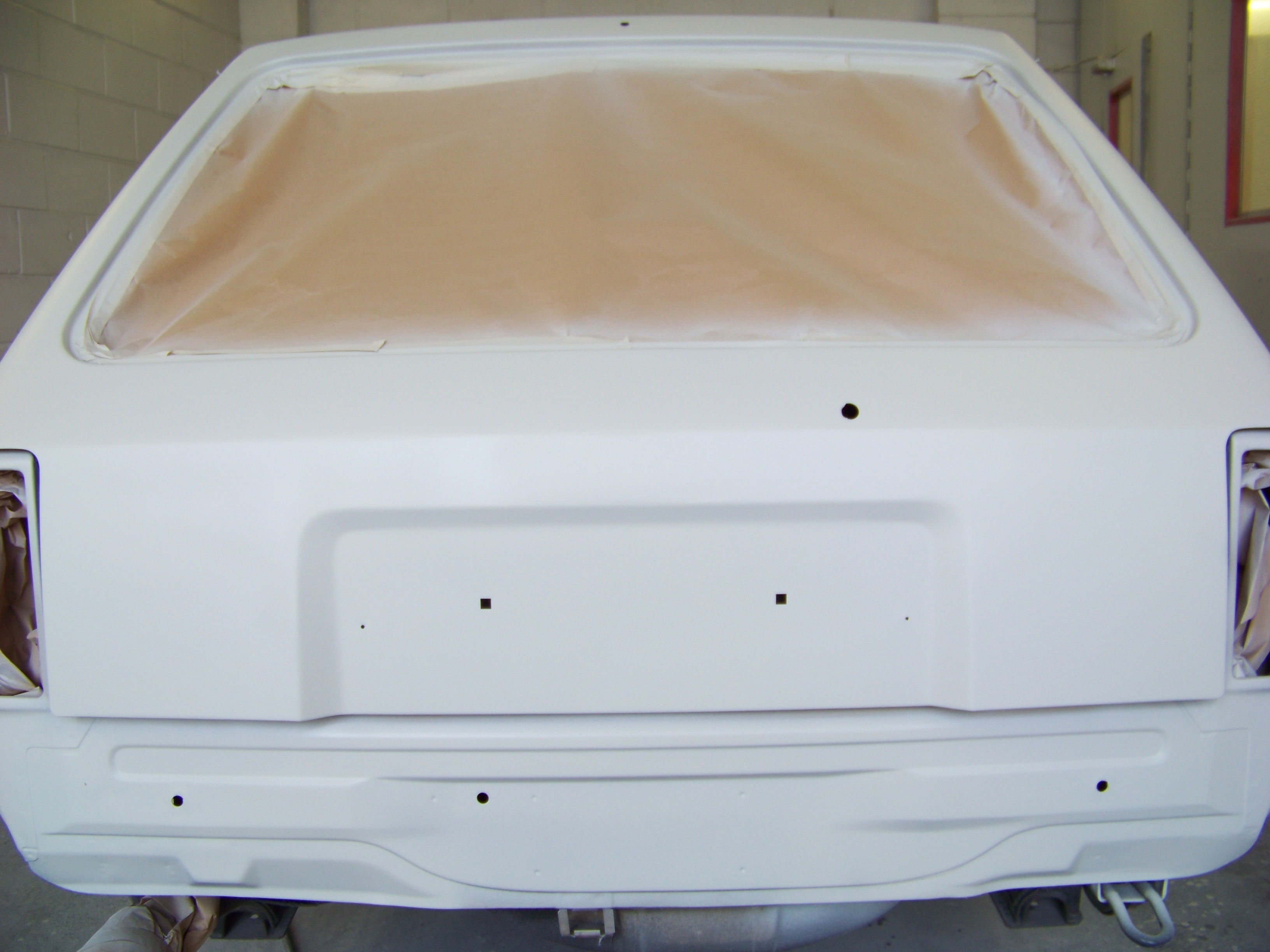

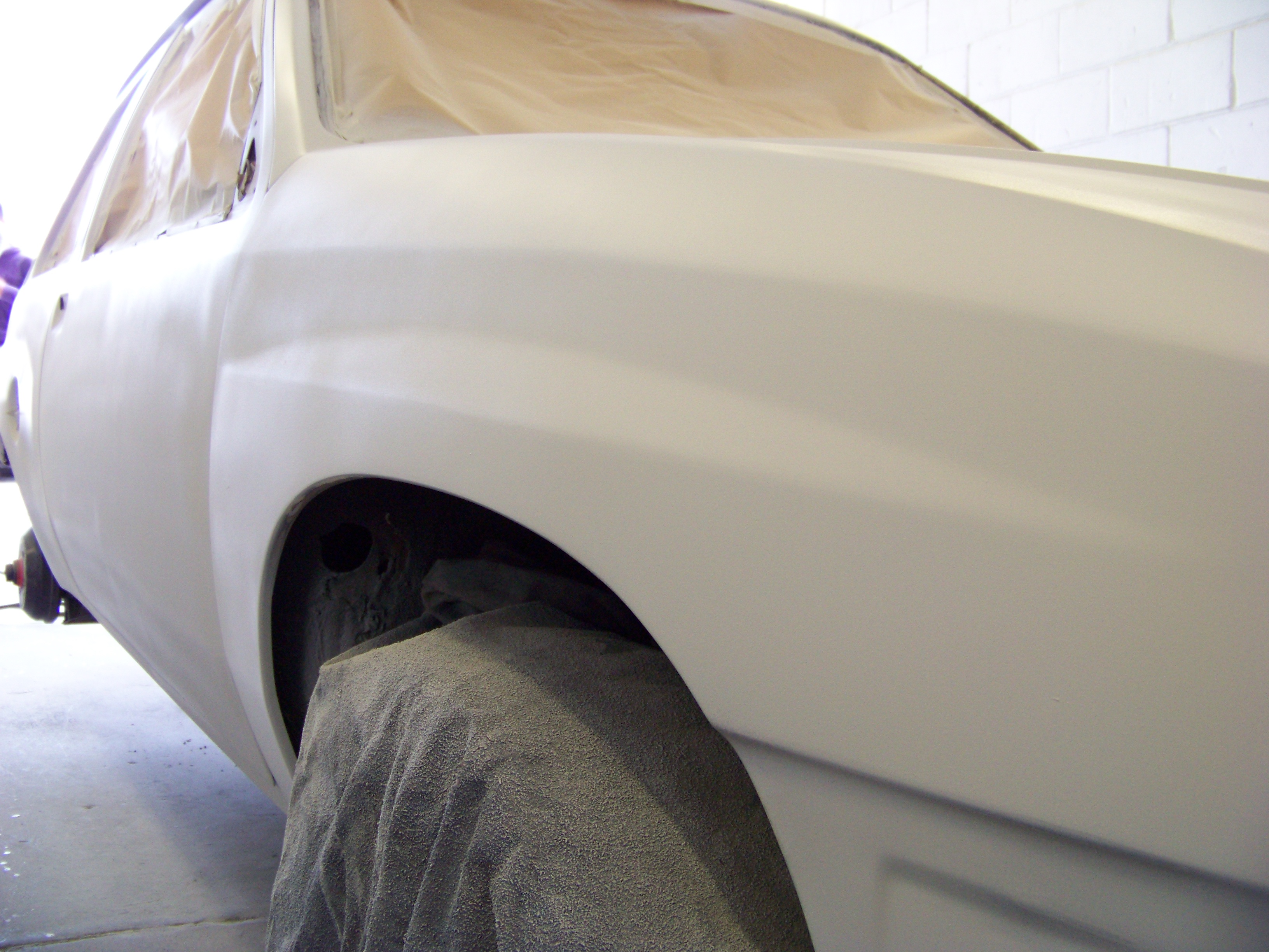

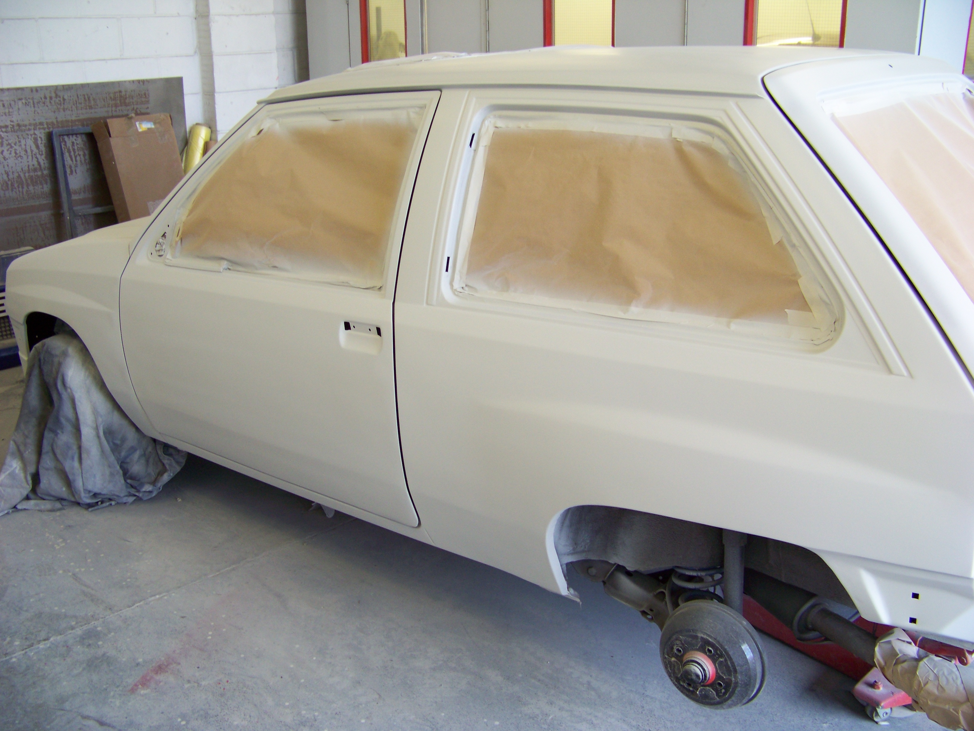

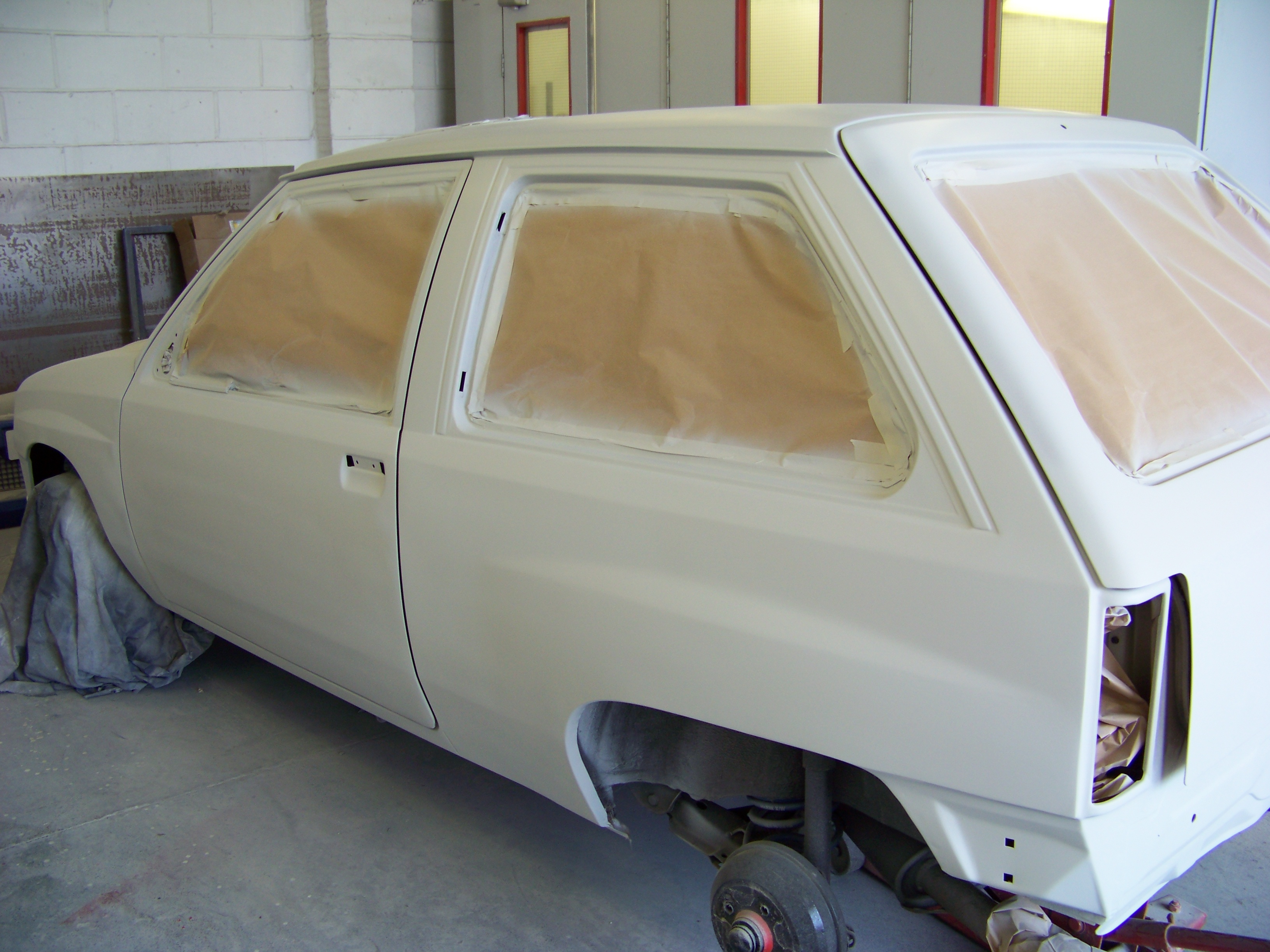

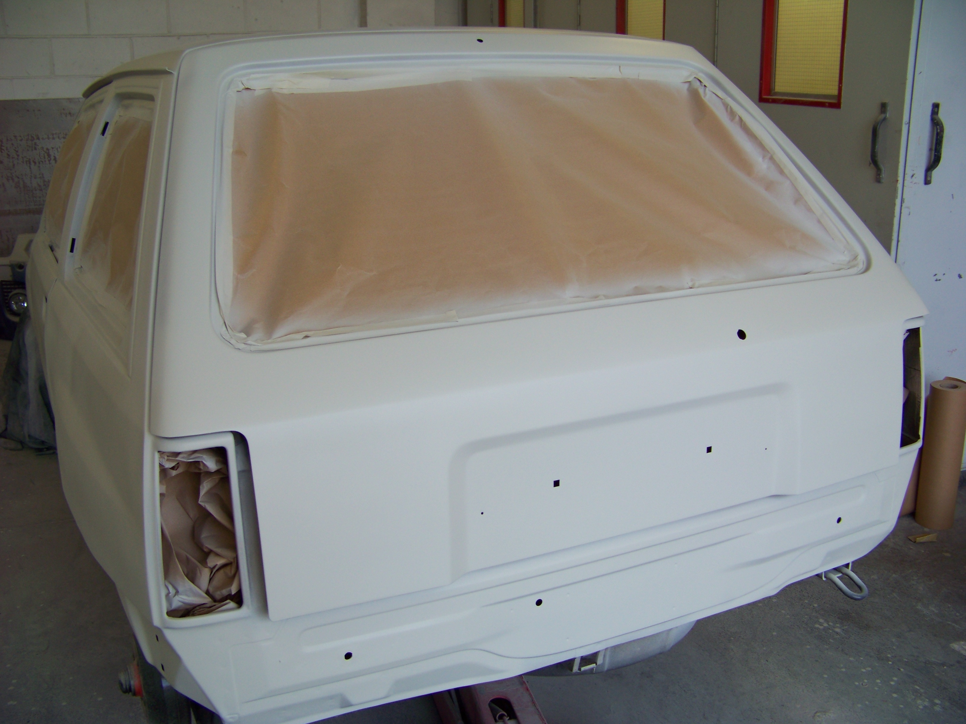

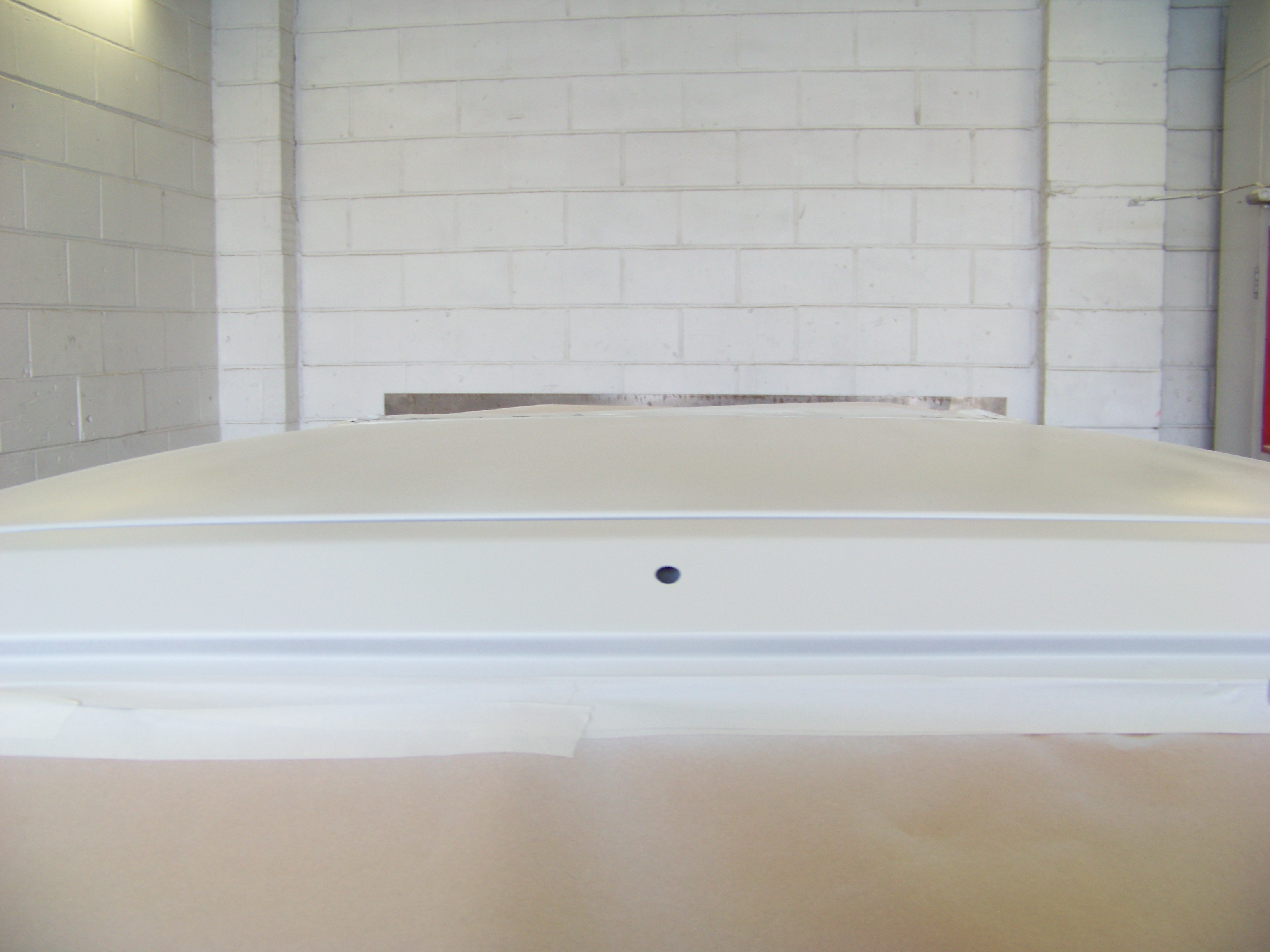

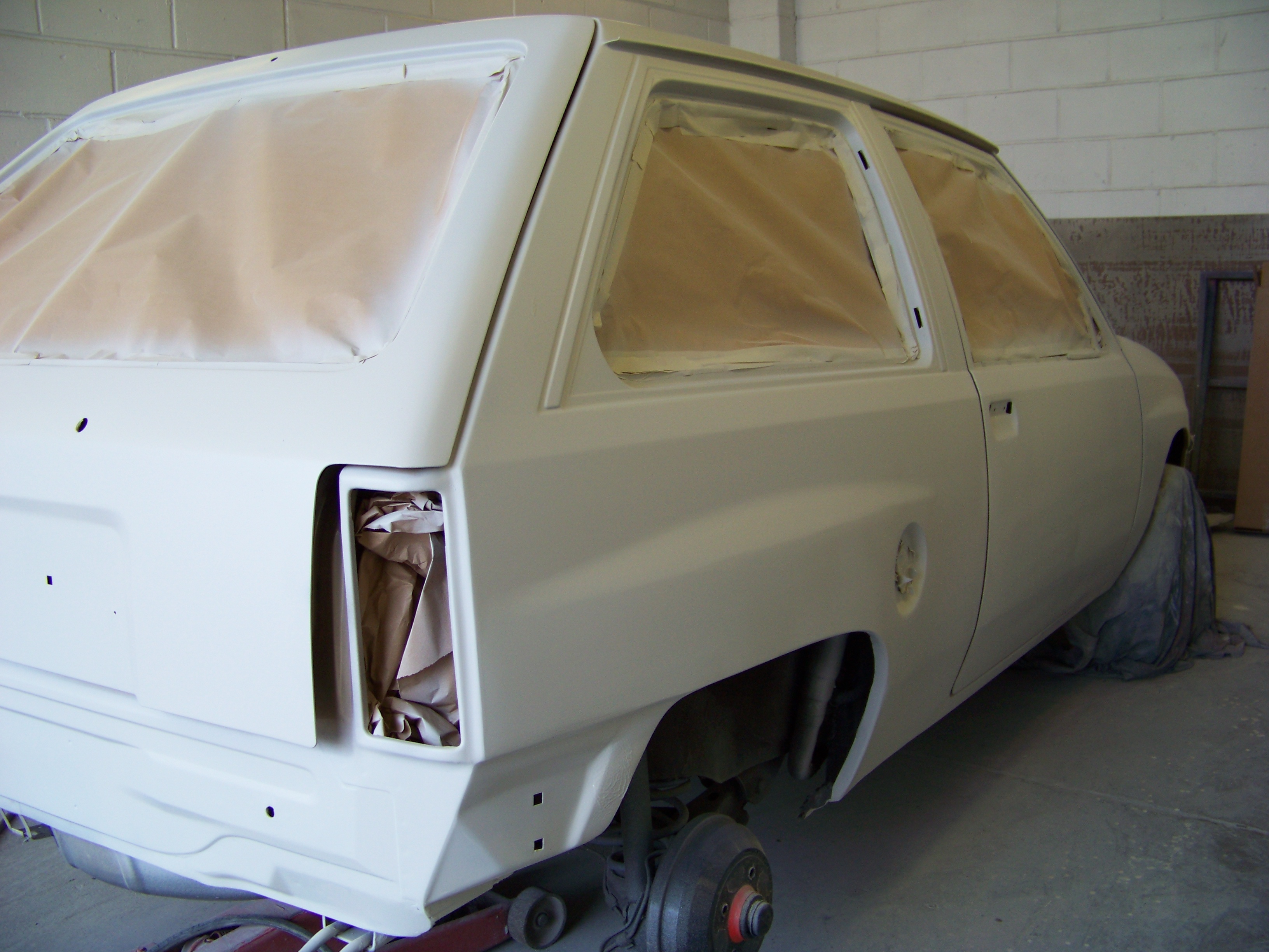

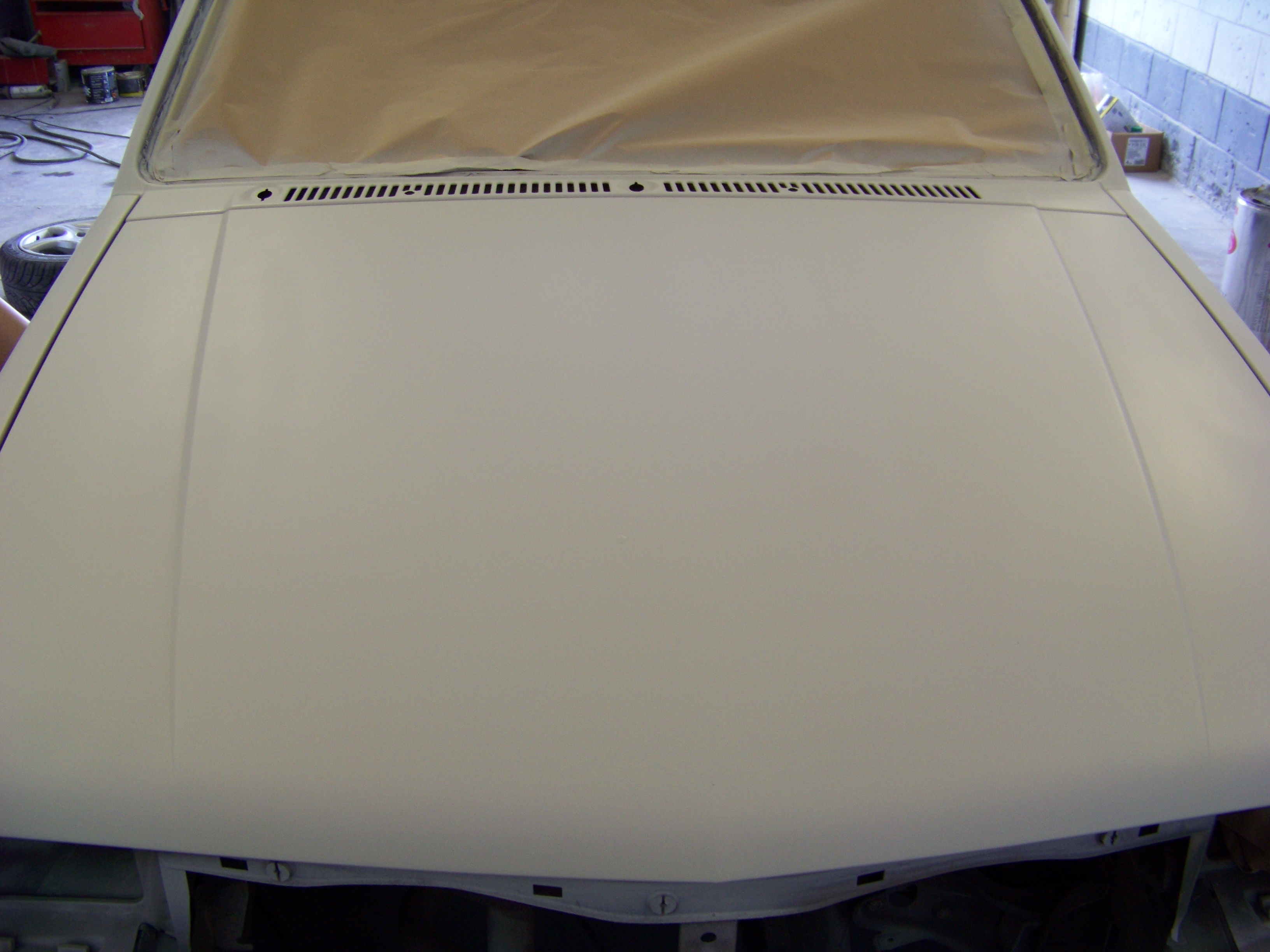

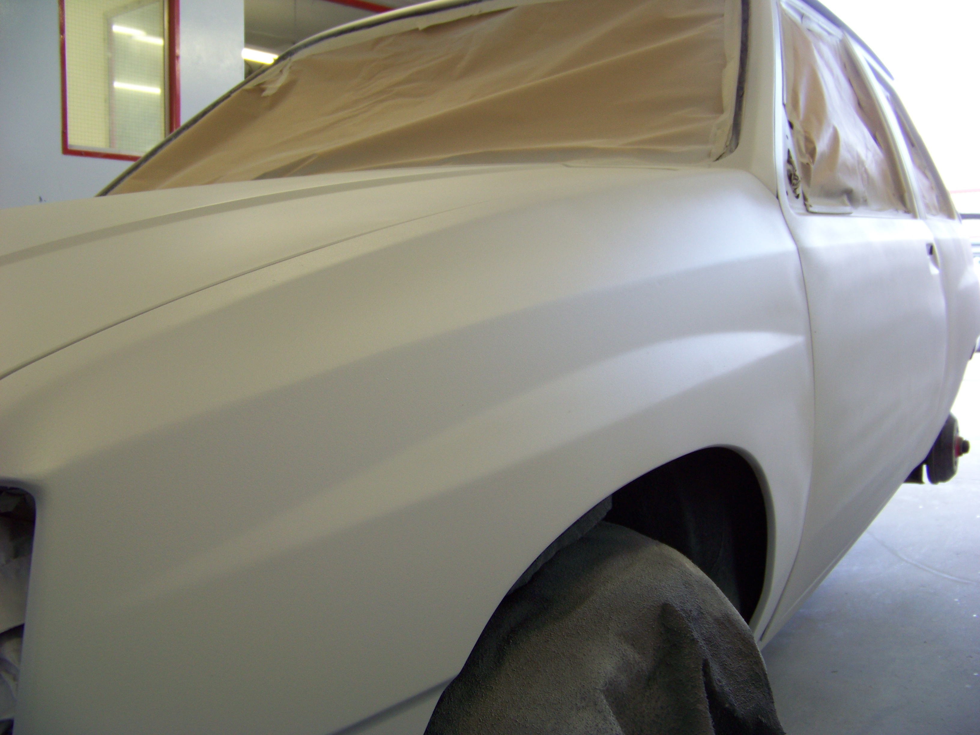

As I arrived the guys pulled the Nova out of the oven, after giving it a few good coats of 2K primer. They wanted to let the primer dry for about a day and a half. So once it had dried in the oven they'd let it sit outside at room temp. This was to make sure that the paint adhered to the filler and the old paint underneath.
Here are the pics as I went round the car:

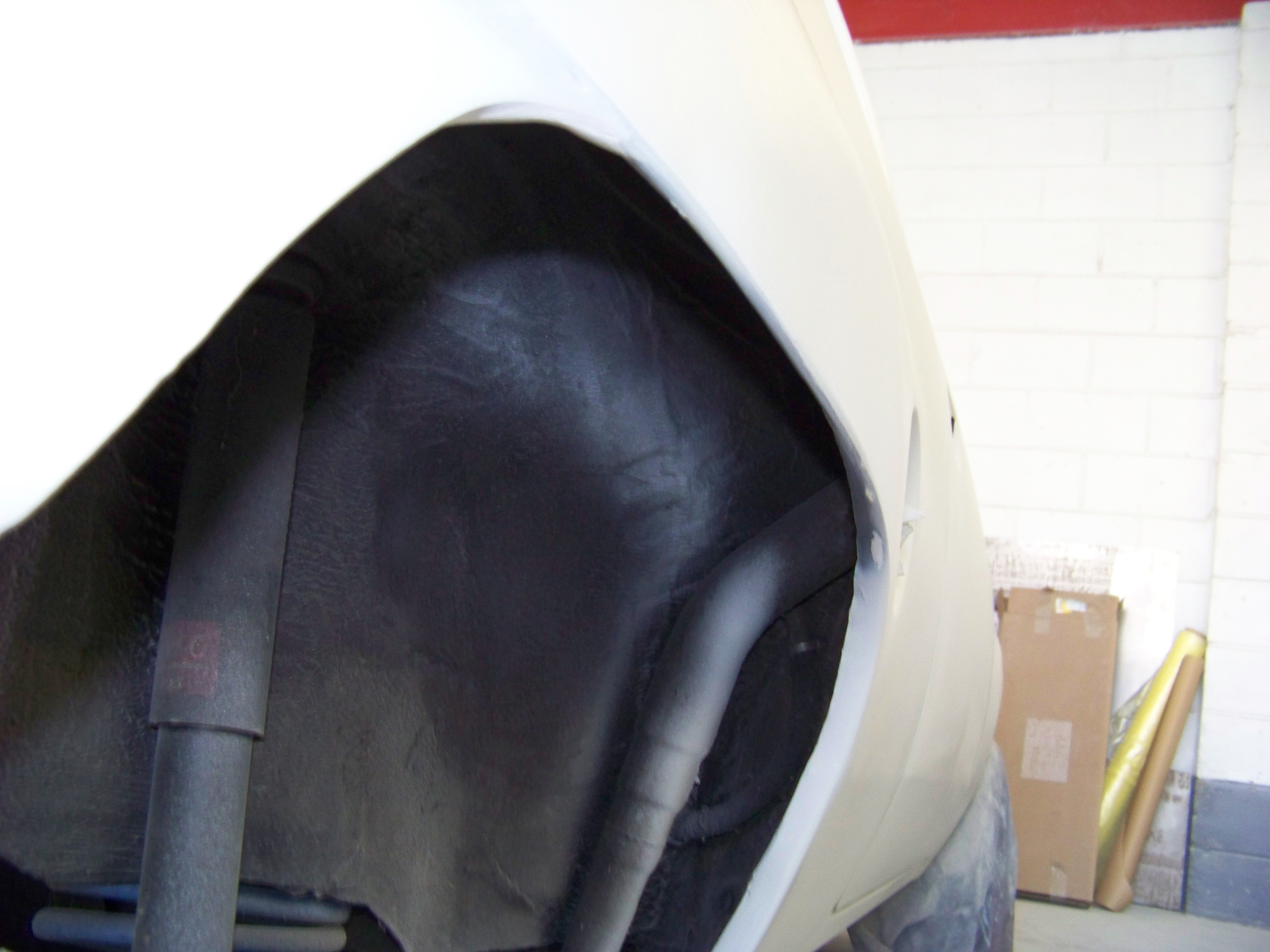

Pics of the arches rolled up. The guys left a few mm gap between the inside of the arch and the lip. This was to reduce the risk of the arch lip cracking where it folds and to be able to seal the lip to the inside of the arch better.
https://images2.imgbox.com/02/38/MHajATeb_o.jpg
One thing is for sure, there's miles more clearance now, yay! ^ Not the best pic but you get the point!

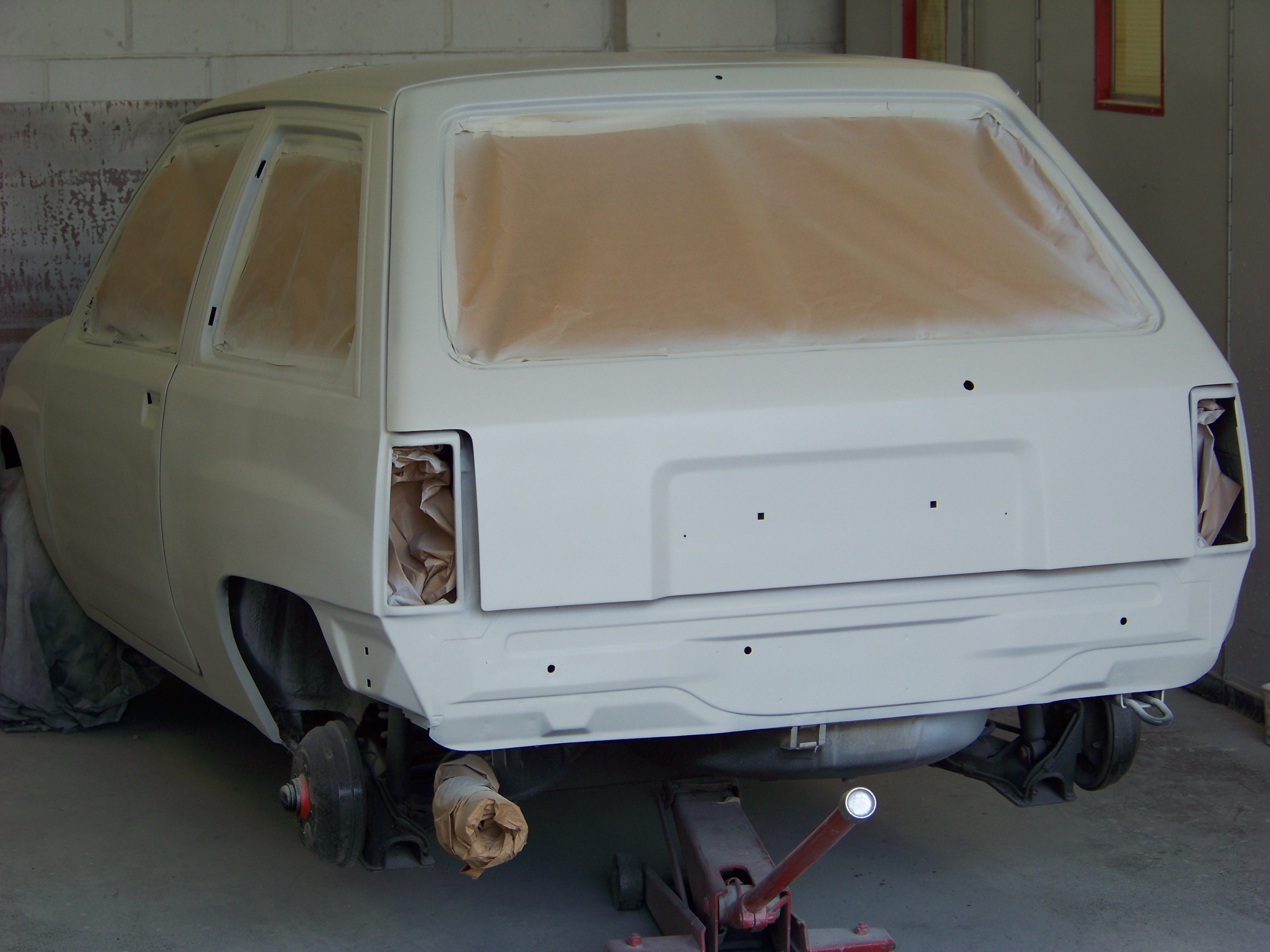

As I left the garage
https://images2.imgbox.com/83/d9/MqqdVlQX_o.jpg
The bay hasn't been done as it'll need the stitch welding done and strengthening plates to be fitted.
The lads said some very minor stopper was needed in a few areas as the primer had showed up some slight imperfections. Once that's been done they'll go ahead and apply primer to those areas and any areas missed, then flat the primer down ready for paint.
It looked so nice in primer, was a nice sight.
