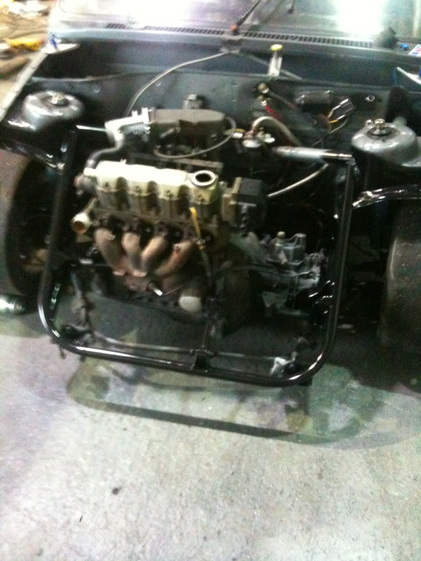

Just one photo sent to me today, with it mocked up with a spare engine and gearbox I had lying around;
http://i285.photobucket.com/albums/l...ps8d0e3645.png
Obviously it won't be running with the standard tie bars as shown!
Front end frame is looking good.
Looks great! Nice to see you back updating the thread too!
Looks good
But I'm struggling to understand how the engine and box bolt in?
Is there more frame work still to be fitted?
Is all this OK with your regulations?
