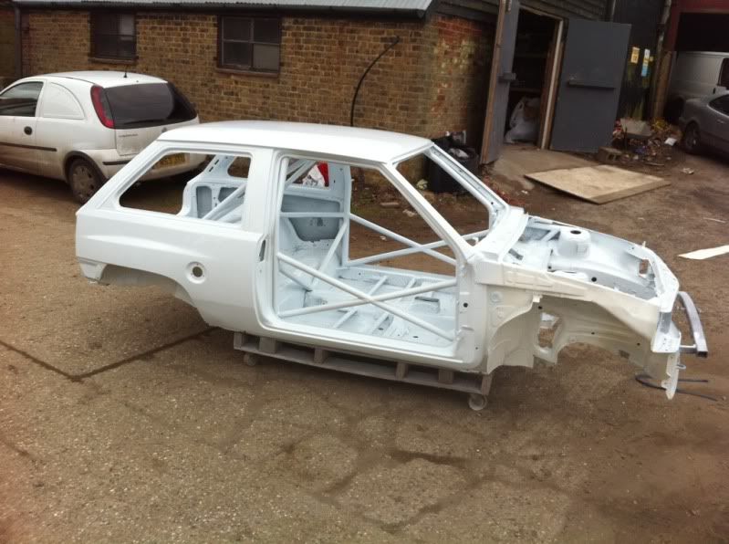

Some outside pics:
http://img.photobucket.com/albums/v1...a/0ce996d8.jpg
http://img.photobucket.com/albums/v1...a/95f07dc6.jpg

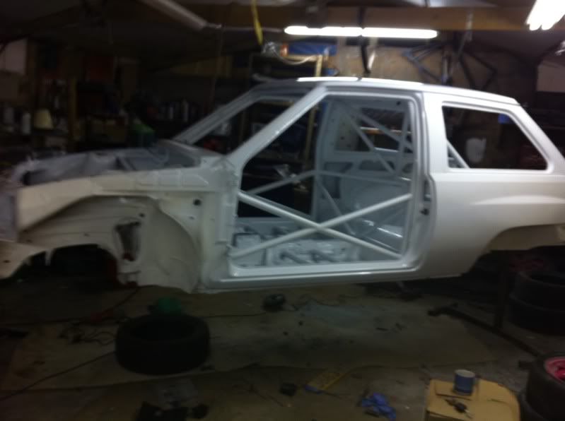

Back at home on the roaster!
http://img.photobucket.com/albums/v1...a/c13dd322.jpg

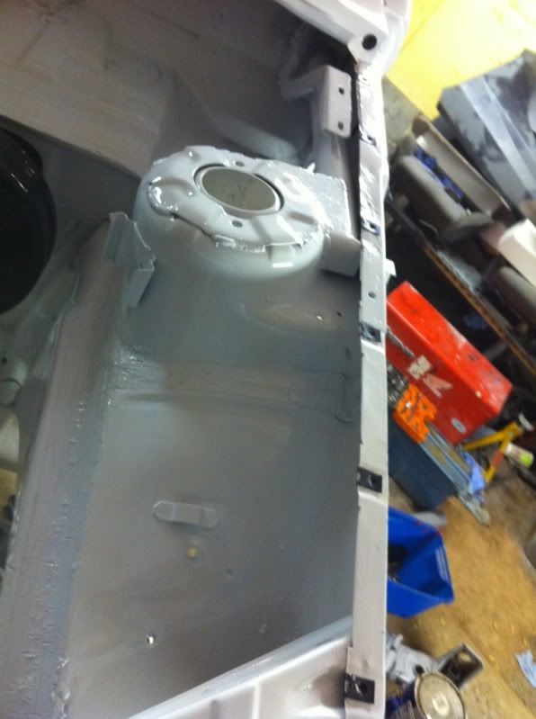

Started fitting a few bits up:
http://img.photobucket.com/albums/v1...a/308f5904.jpg

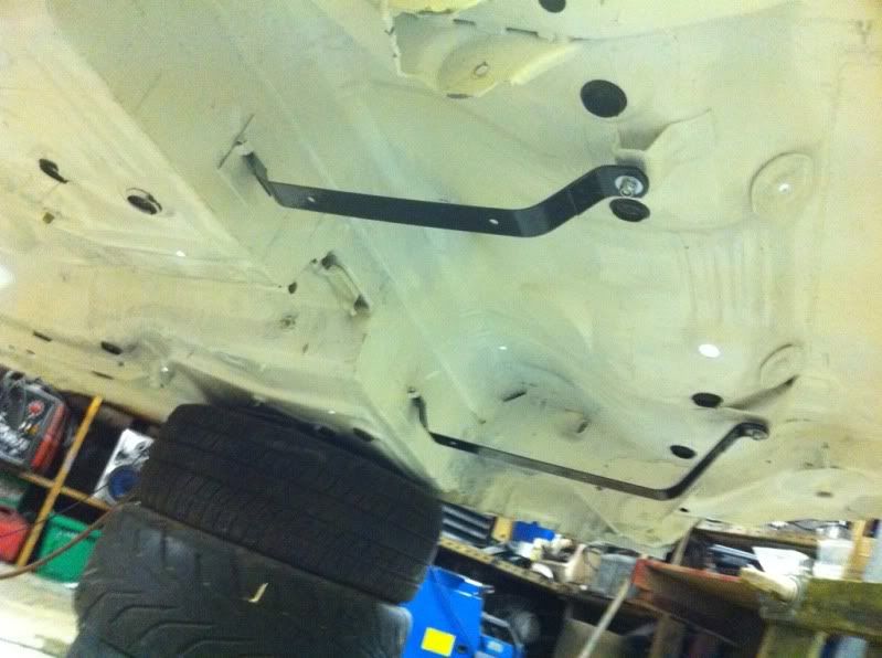

New clips and bolts all round:
http://img.photobucket.com/albums/v1...a/b9818f76.jpg

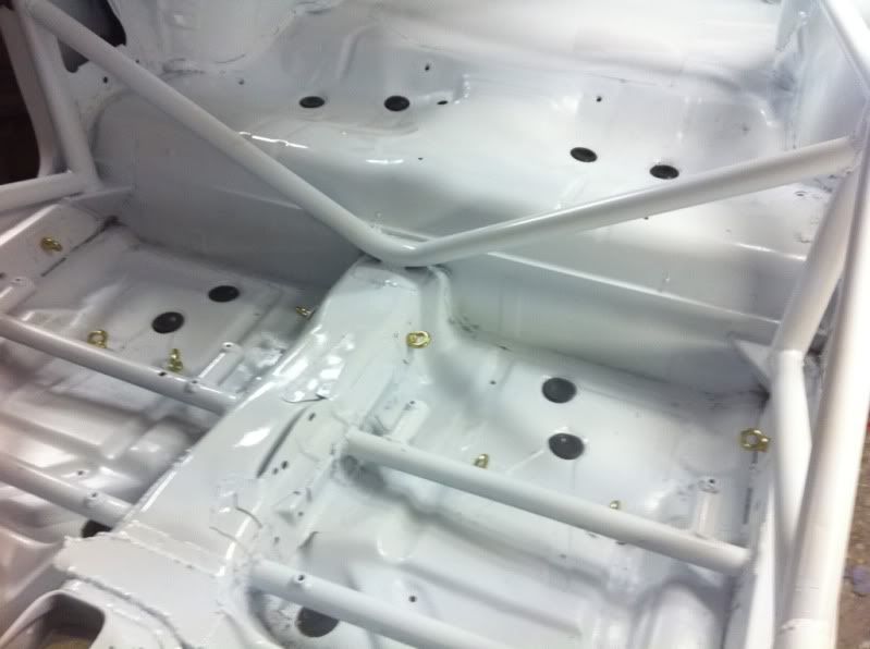

Eyelets all in:
http://img.photobucket.com/albums/v1...a/acee166b.jpg

For the eyelets?Quote:

So I don't pull them out the shell in a crash.
Do they go under or over the shell?
Seam or stitch?

I put them on top, welded round 2/3 of the sides of the square and puddle welded the hole.
