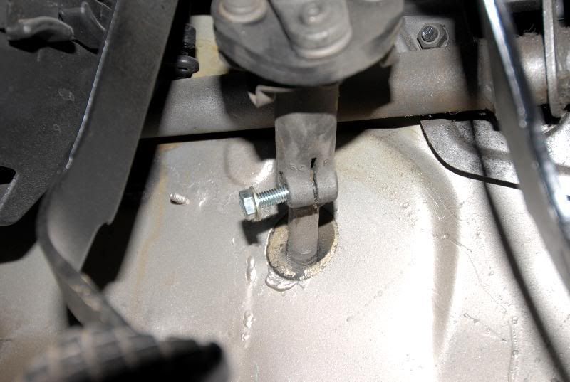

Inside the car, remove the 13mm bolt
http://i136.photobucket.com/albums/q...ure/nc0727.jpg
Upon removal, to get it out the nearside wheel arch, above the gearbox, you have to rotate the rack 45degrees so the bit inside the car is pointing down
http://i136.photobucket.com/albums/q...ure/nc0728.jpg
