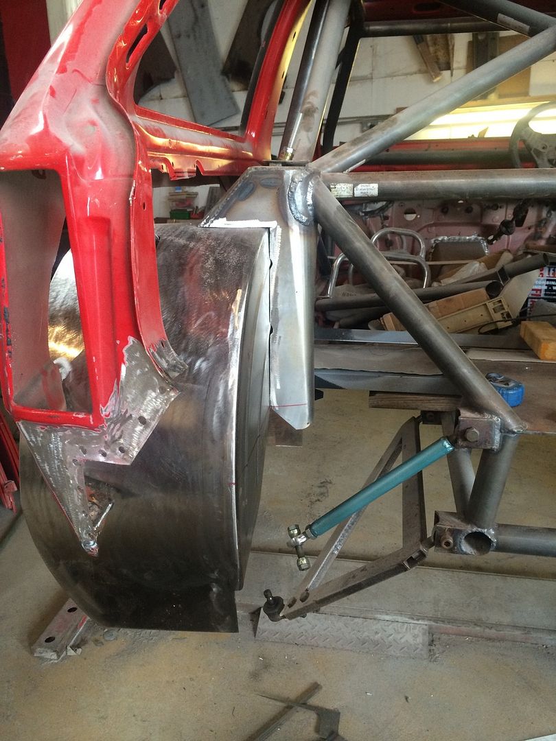

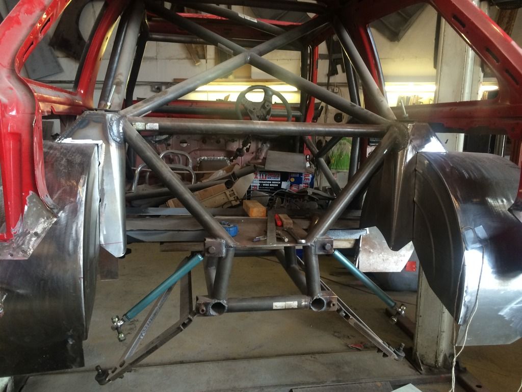

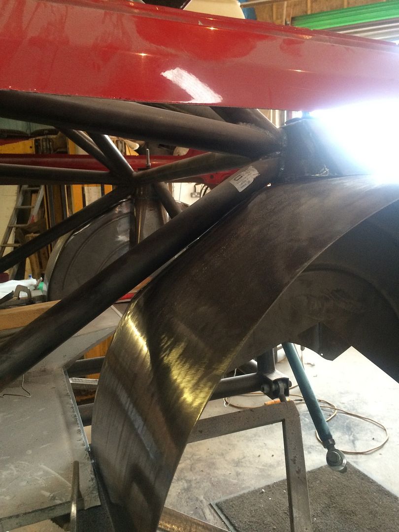

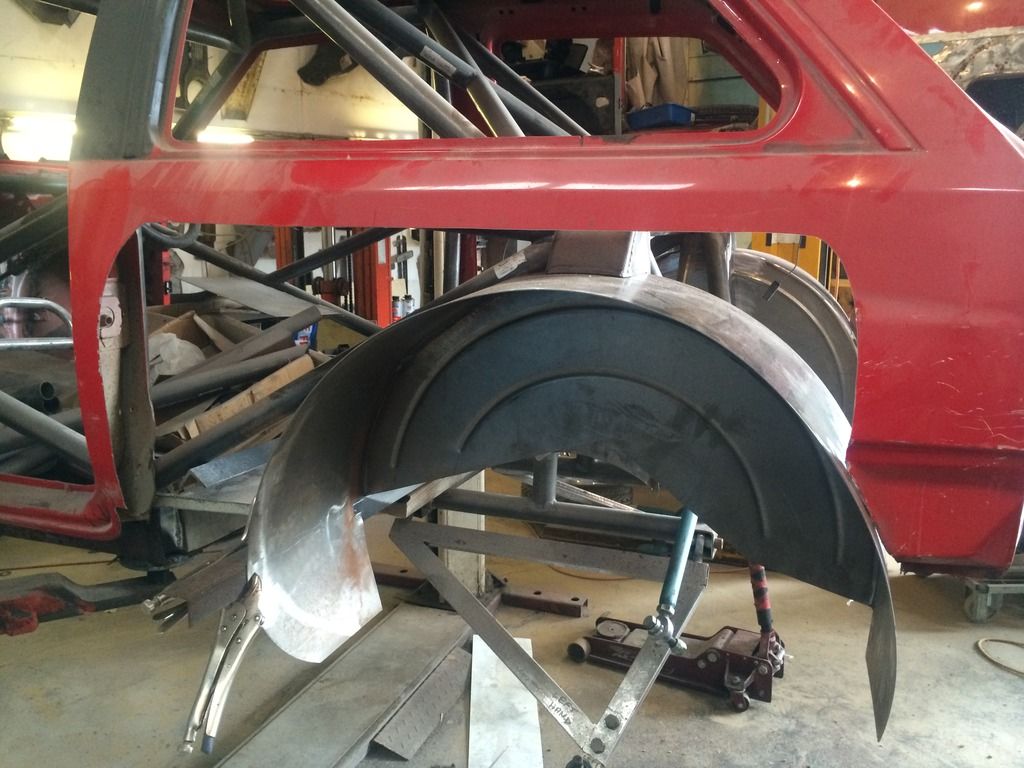

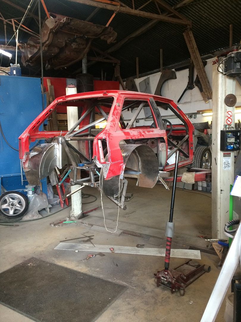

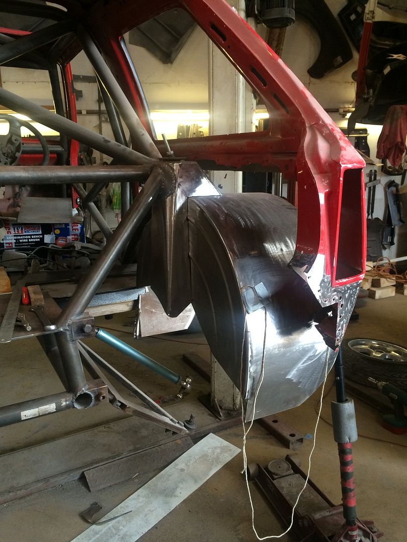

A bit more done. Hopefully the floor will be in, in a week or 2.http://i660.photobucket.com/albums/u...psvfkvhylt.jpg[/URL]

looking awesome. Will the coilover be in the tub? Thought you'd keep it out in the turret. To have as much space as poss.
Thanks :) yeah it'll be in the turret, it's just not been cut out yet. It's still to be cut to length as well.
Ah ok, just didn't look like room from the photos. Loving the fab work.
Those tubs look massive, great to see some progress on this.
Aye plenty of room there Benn, yeah he's done a great job with the fab work :)
There's a fair bit to be cut off them yet. Prob 2" on the width and a good bit off the height. You can see the line in one of the pics where they'll be cut. I know it's about time, I'm away on holiday at the end of the week and hopefully when I'm back it's a good bit on and almost ready to take home.
Cool update Baz! My 1st thought was that why hadn't you mounted them higher while you had the opportunity as they look to be in roughly stock position?. But then I saw you already had to tweak a bit because of one of the tubes.
What kinda ride height will this beast be at?
I haven't actually measured it out but the turrets are much higher than standard height.
No idea about the ride height yet it's really hard to gauge as the quarters have been hacked since the build started really I'll get a better idea when the new ones go on.
