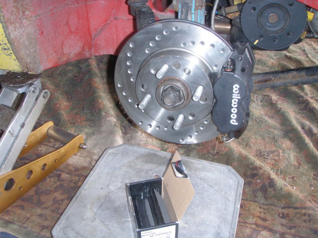

Looking good Colin, nice brakes.

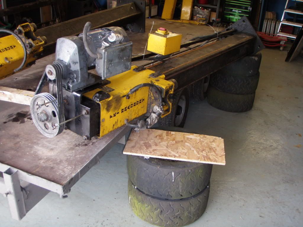

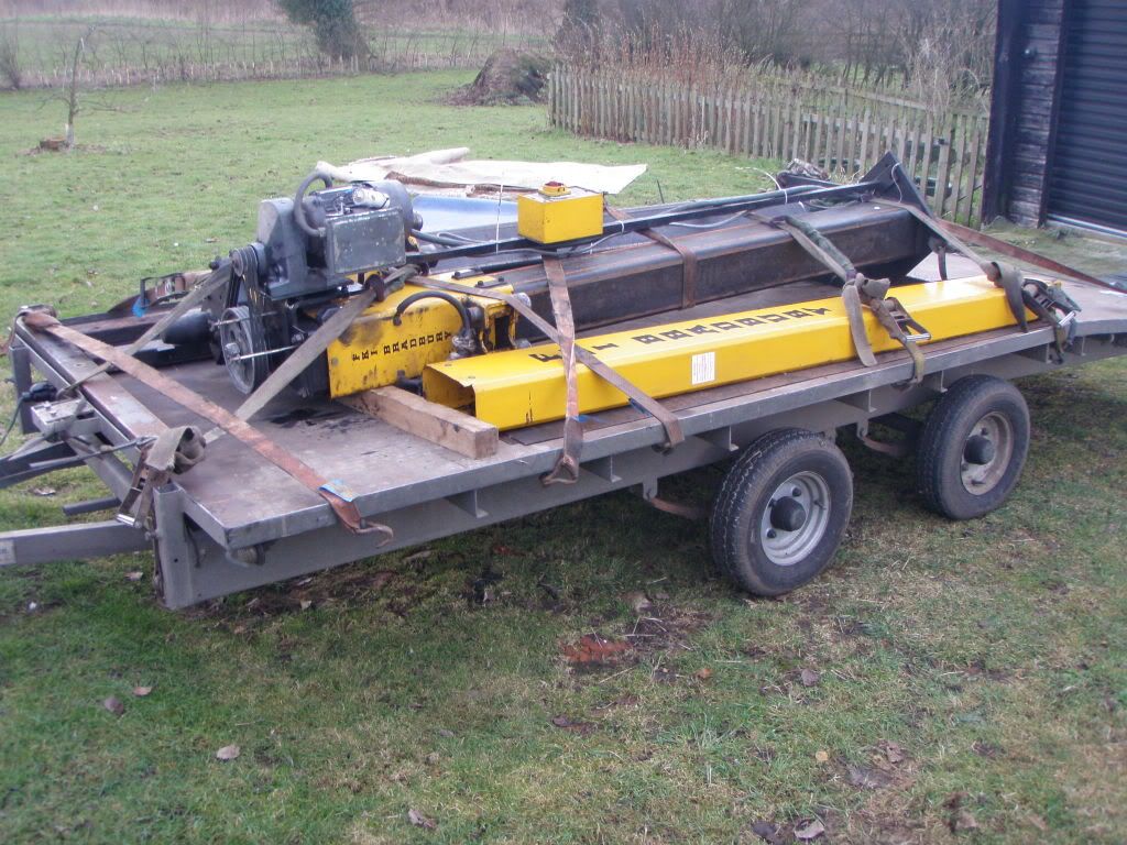

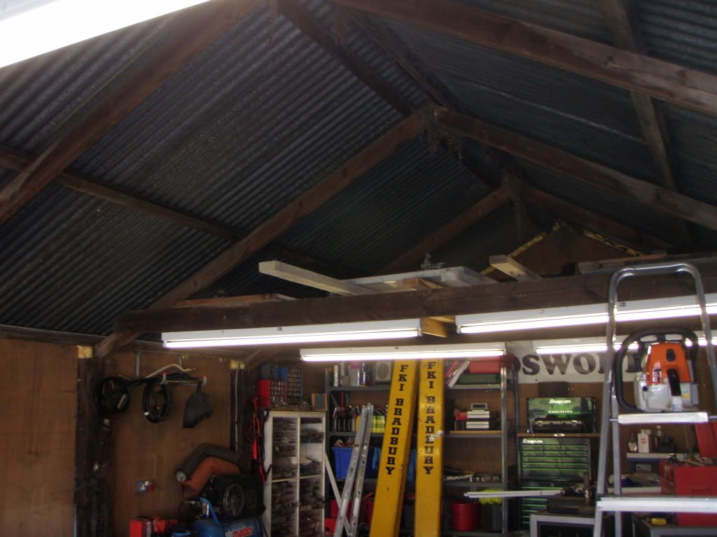

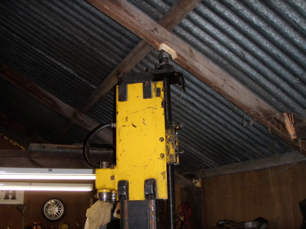

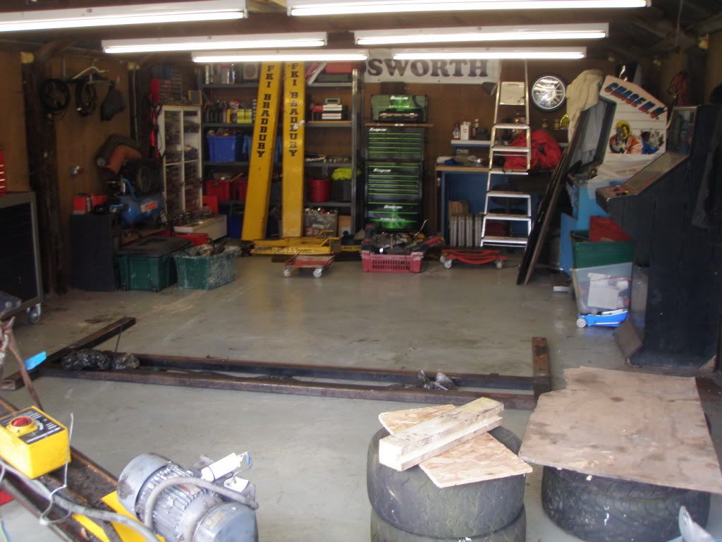

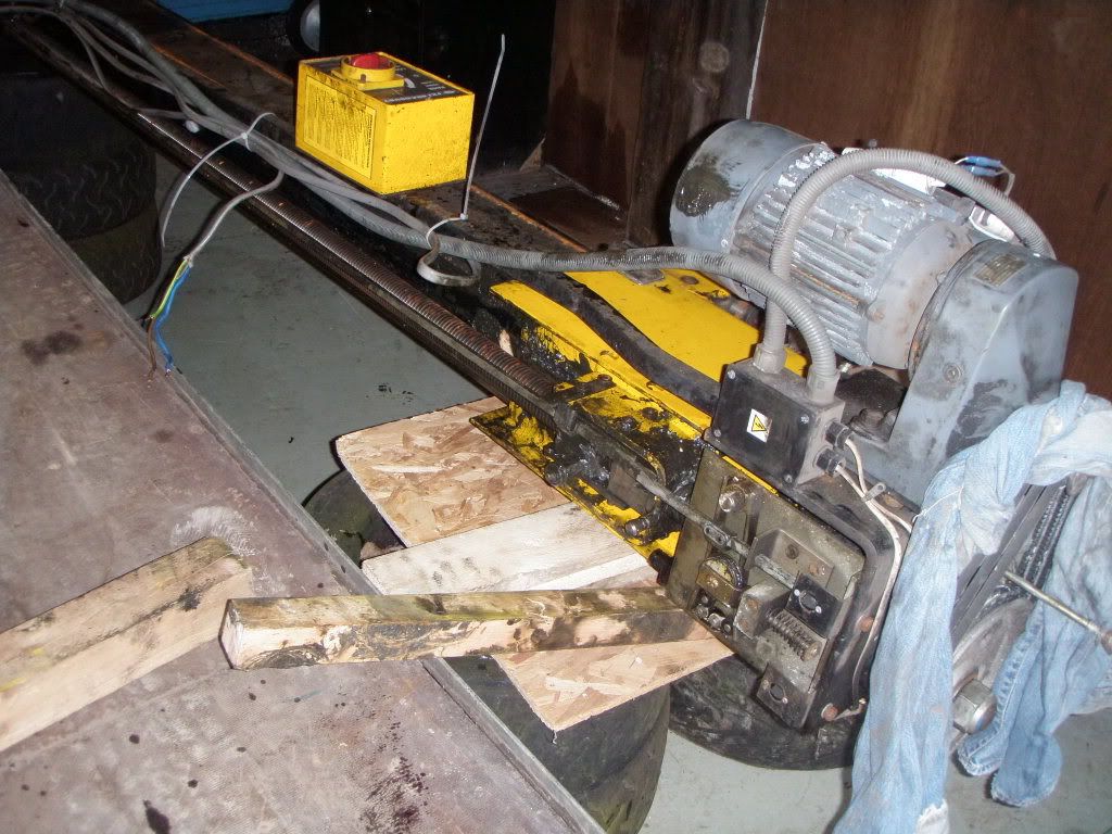

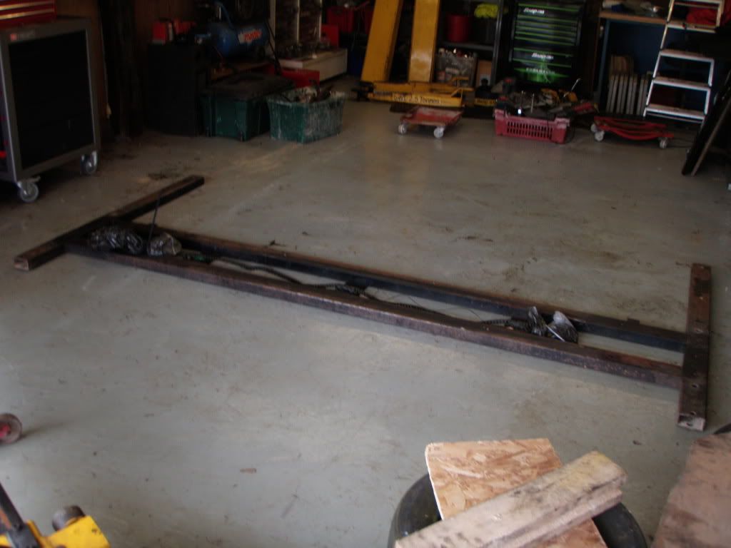

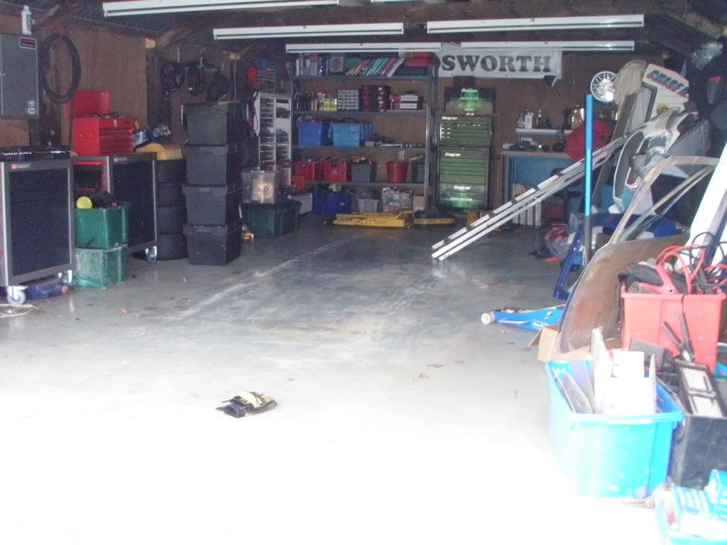

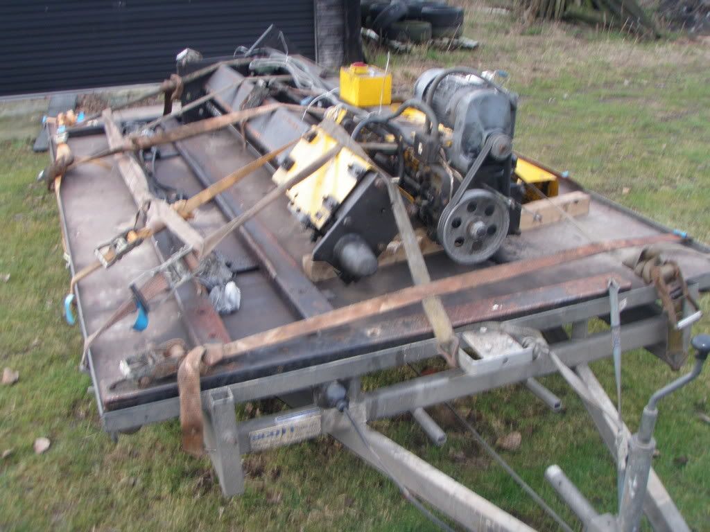

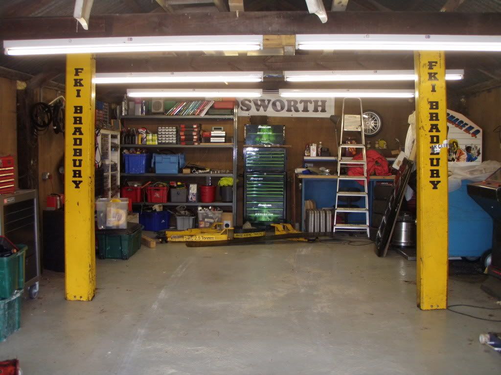

Nothing to do with the Nova directly, but it will make working on it easier.........I picked up this on Tuesday;
http://i285.photobucket.com/albums/l...ort/006-29.jpg
http://i285.photobucket.com/albums/l...ort/007-24.jpg
http://i285.photobucket.com/albums/l...ort/009-21.jpg
And this is where it was to be fitted on Wednesday;
http://i285.photobucket.com/albums/l...ort/008-23.jpg
Playing before the hard work started;
http://i285.photobucket.com/albums/l...ort/010-23.jpg
Unloading it on my own was fun, it weighs a huge amount;
http://i285.photobucket.com/albums/l...ort/011-19.jpg
http://i285.photobucket.com/albums/l...ort/012-20.jpg
http://i285.photobucket.com/albums/l...ort/015-18.jpg
When the fitter arrived eventually, we were able to get the baseplate down;
http://i285.photobucket.com/albums/l...ort/016-20.jpg
http://i285.photobucket.com/albums/l...ort/017-23.jpg

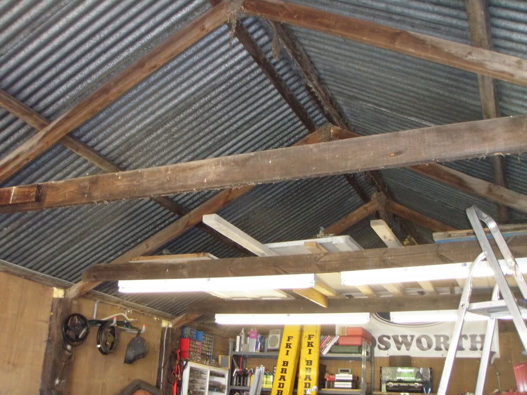

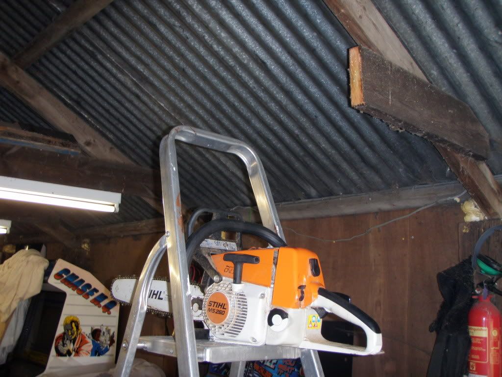

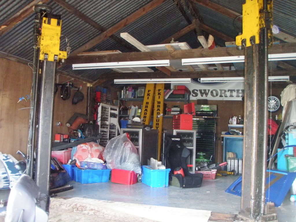

I've got limited height in the workshop, and this beam was right in the way;
http://i285.photobucket.com/albums/l...ort/020-16.jpg
http://i285.photobucket.com/albums/l...ort/018-22.jpg
But easily solved with the aid of the trusty Stihl chainsaw;
http://i285.photobucket.com/albums/l...ort/019-19.jpg

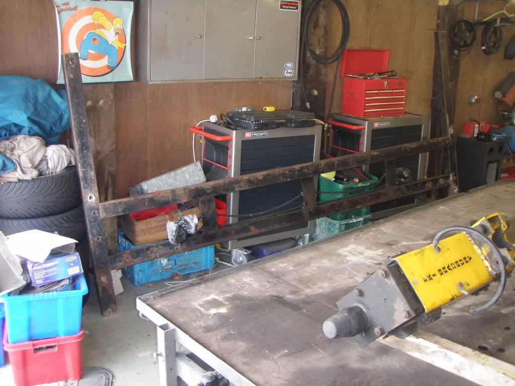

Also had to make some adaptations to other woodwork;
http://i285.photobucket.com/albums/l...ort/022-11.jpg

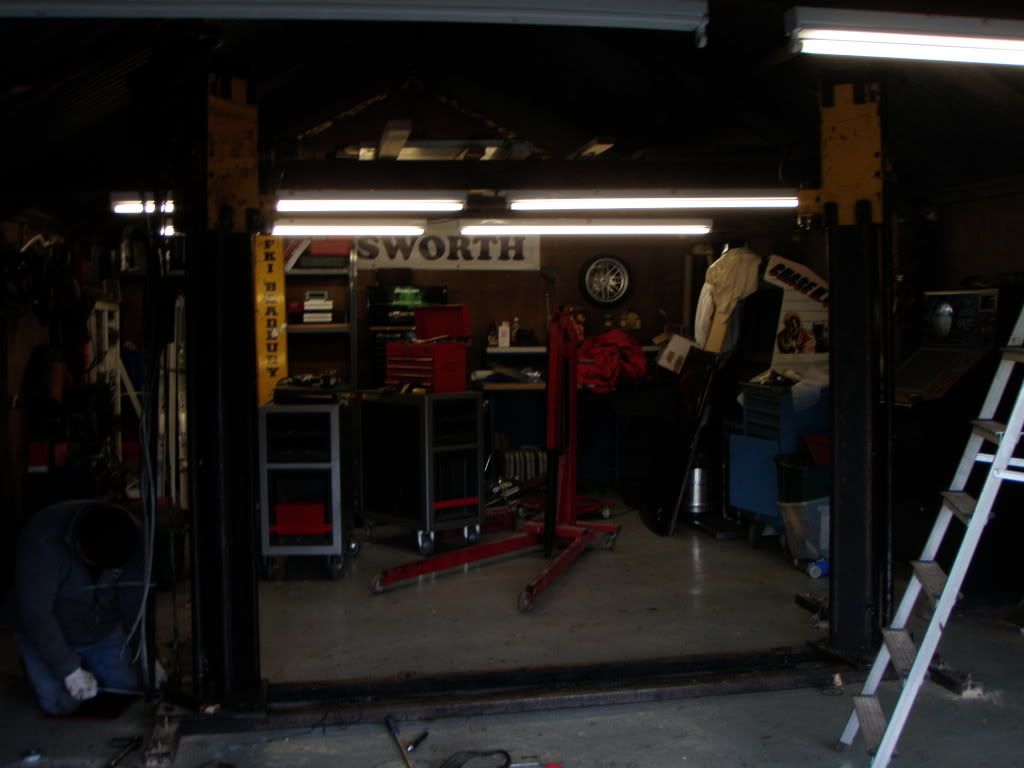

And it was up by lunchtime, with the aid of an engine crane, a few ratchet straps and a very large neighbour farmer!;
http://i285.photobucket.com/albums/l...ort/021-15.jpg
http://i285.photobucket.com/albums/l...cort/023-8.jpg
Just waiting for the electrician to come and wire it up now, as it's on a 30 amp supply. Can't wait to try it out.
Colin, dont mean to be a kill joy but be very wary cutting out horizontal joists :S they stop sideways movement in roof structures...
Other then that, top work :)
