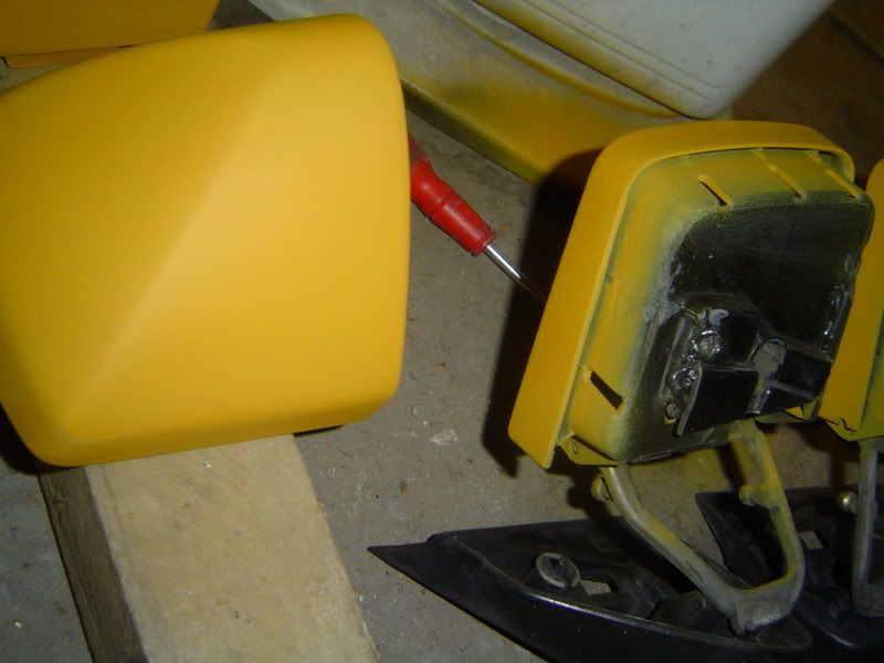

Have been thinking about what mirrors to fit. But thought I’d give the stubby mission a go and see how that went. Manage to get the use of a plastic welder which made the job a lot easier!
Covers cut and welded up
Then the main bodies... Shortened by 50mm
http://img.photobucket.com/albums/v1...9.jpg~original
