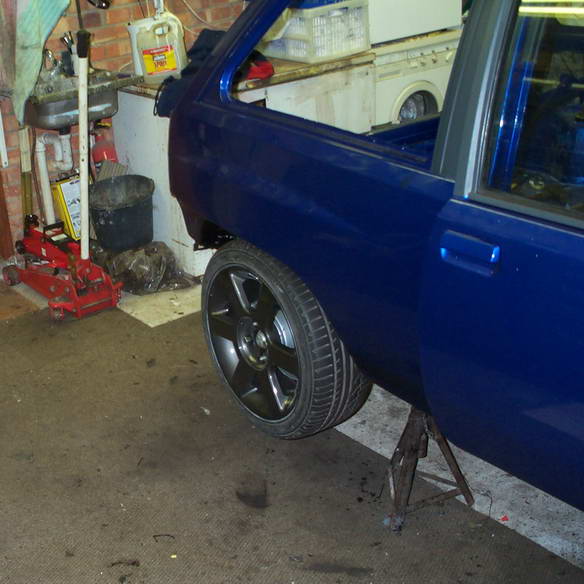

Finally got the back axel mounted - tried my newly refurbed alloys and I am pleased to say that there is loads of clearance between the tyre and the arch as when I had the inserts put in I asked them to pull the arch out by 3-4mm.

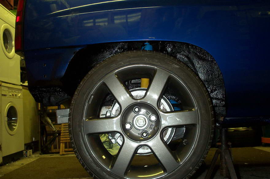

Also Waxoyl undersealed both arches to prevent the tin worm getting in :-

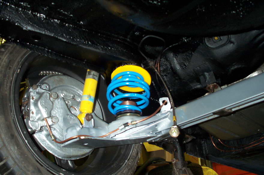

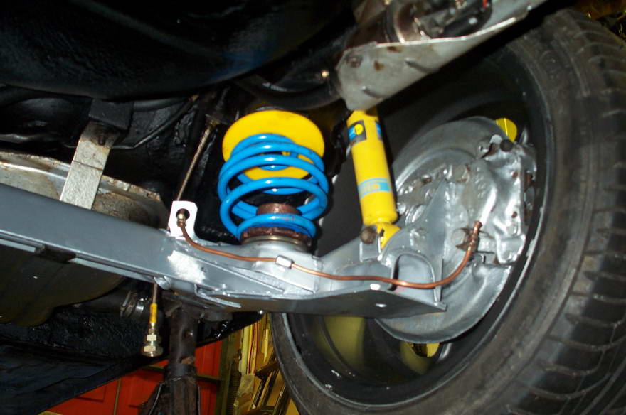

Also been able to fit the new Bilstein suspension on the rear. The rear dampers have a 9 setting in car adjustment and the rear springs sit on an adustable platform for height adjustment - they are set on the lowest at the moment but once I have got some weight in the back I may raise it up a bit. The rear beam was powdercoated same time as the respray and is a 1000% improvement on the scabby rusty one that came off.

Fronts are the billy coilovers I have waiting to go on. Just need to plumb in the rear brakes and handbrake and the rear axle is finshed.

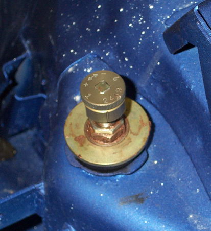

In what way are they in-car adjustable - not seen 'billy's' with this capability before :confused:Quote:

Rear beam set-up looks juicy. I take it the suspension is all part of the Bilstein coilover set-up?

See the pic below - the damper has a 9 point adjuster on the top which changing the valve settings in the damper to make it harder or softer depending on the conditions at hand.

The height adjustable bit is under the spring on the ream beam - works just like a coilover - the spring platform moves up and down which adjusts the ride height.

Craig the suspension is part of the Bilstein coilover set up for a nova apart from the yellow spring rubbers which have come from deflex and a poly bush material so they will last longer and have less compression.Quote:
