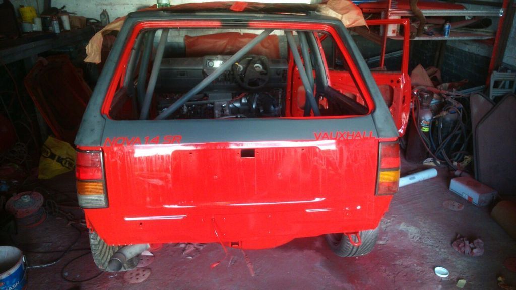

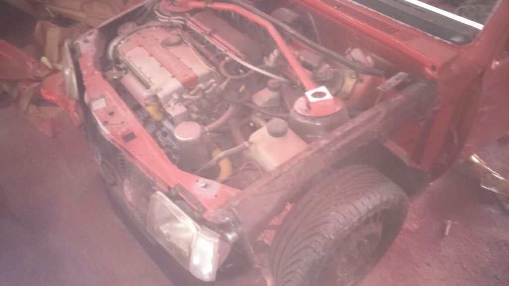

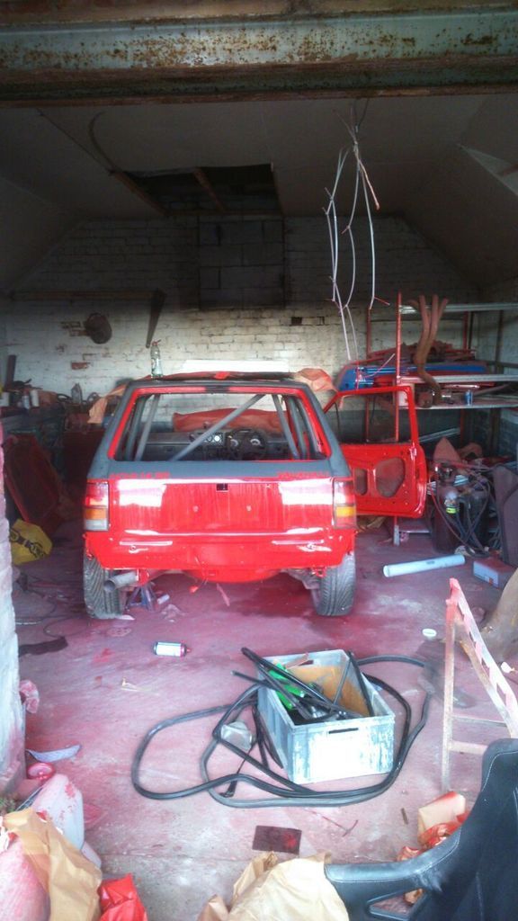

Few pics from today
http://i27.photobucket.com/albums/c1...940E94A99C.jpg
Bit dusty
http://i27.photobucket.com/albums/c1...557D92AEEF.jpg
http://i27.photobucket.com/albums/c1...ED0E16466E.jpg
Can't believe how good it looks compared to how it used to look!!!
