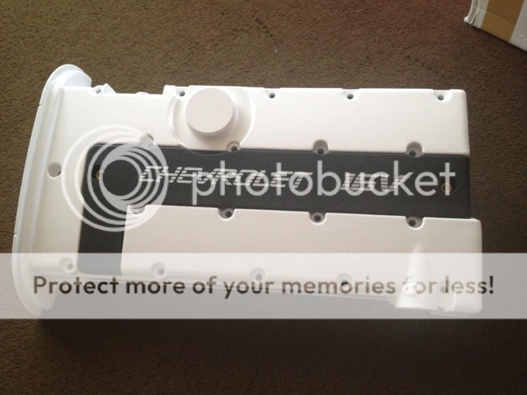

Plug cover will have the oil cap recess welded up, then left as it is with the script and painted red.

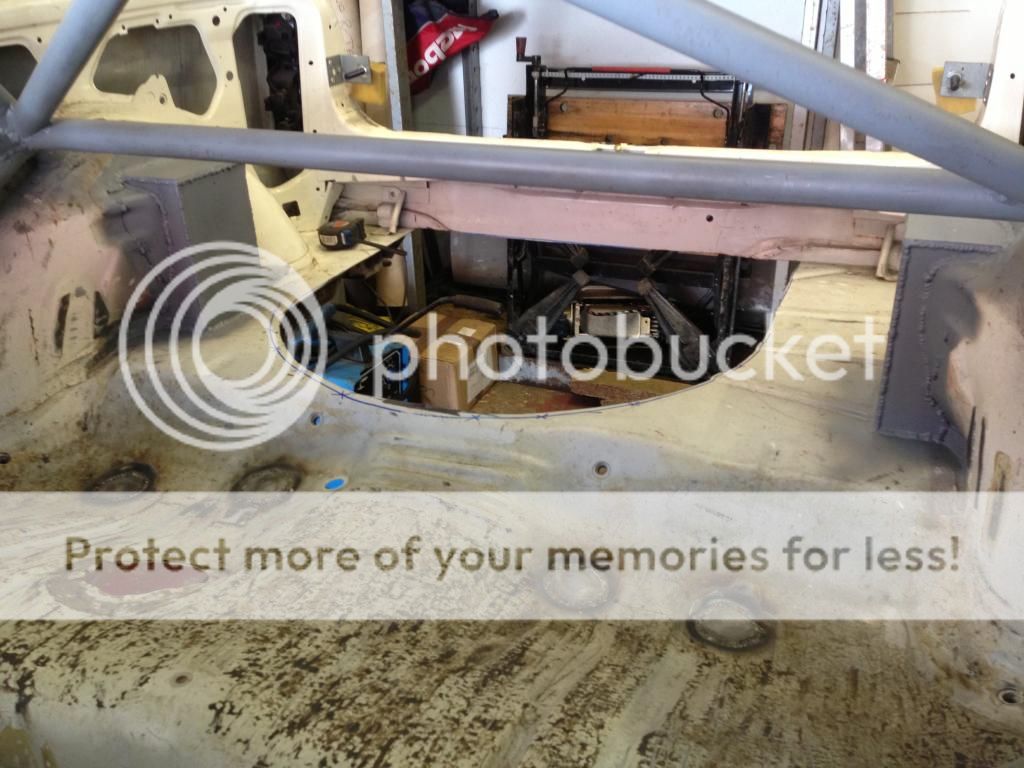

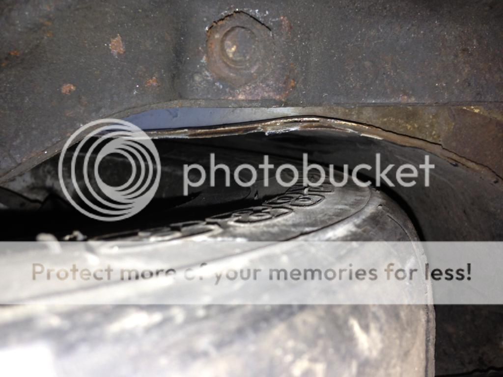

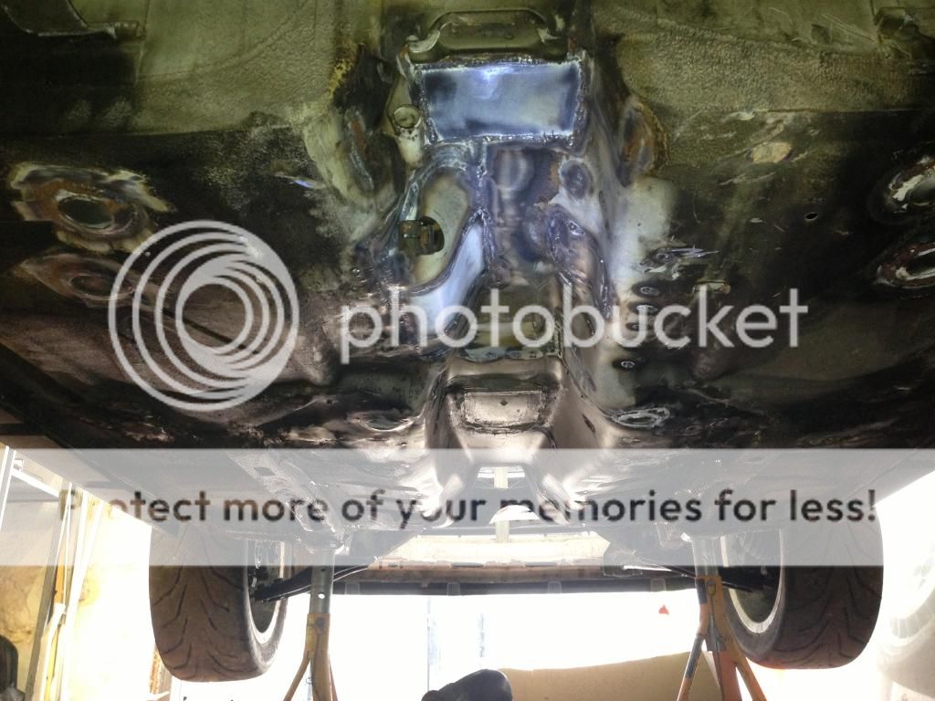

Spent a bit of time on the shell over the last few days too. Started by removing the tank, welding in the last 4 floor bungs & cutting out the spare wheel recess.
http://i995.photobucket.com/albums/a...psb26f6d60.jpg
Two reasons for this. One being that Il probably be knocking up my own exhaust, so makes it easier, and also that at some point in the future I may want to make some sort of diffuser. Just opens up the options as I really don't want to be cutting anything once its painted.

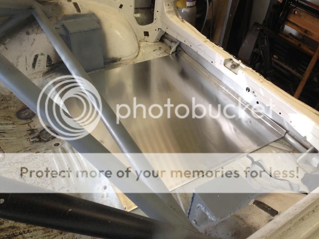

Got a piece of 3mm Ally cut roughly to size, with a fold on the rear edge, so once trimmed into the shape of my cut out, Il just overlap it by 20mm then bond / rivet it in place.

Its a handy area to sit when working under the floor at the moment though, so wont do that just yet.

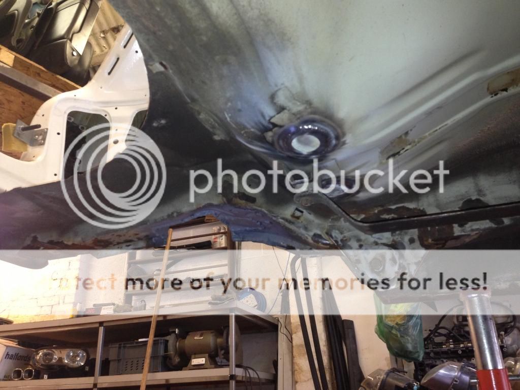

Spent a bit of time under there, and attacked all of the suspicious brown bits with the knotted wheel. Absolutely cuffed to find no structural rust atall.
http://i995.photobucket.com/albums/a...psa63820d9.jpg
http://i995.photobucket.com/albums/a...ps310c7e70.jpg
So went along the whole floor cutting off all of the old fuel and brake line tabs, and removing unwanted brake pipes, heat trays and studs. Gave the welds a scrub, but do need to get under there with the flap disc to smooth some of the bigger puddles off, mostly where the spot welds were repaired.
http://i995.photobucket.com/albums/a...ps671a53b0.jpg
I don't think Il bother removing the old under-seal. From what I can see its done a cracking job so far, so anything that isn't loose can stay and Il just re-apply something in the areas I have removed it from.

White one is having the lip ground off, blasted and coated in silver next week, so should look similar to the WTTC cover.

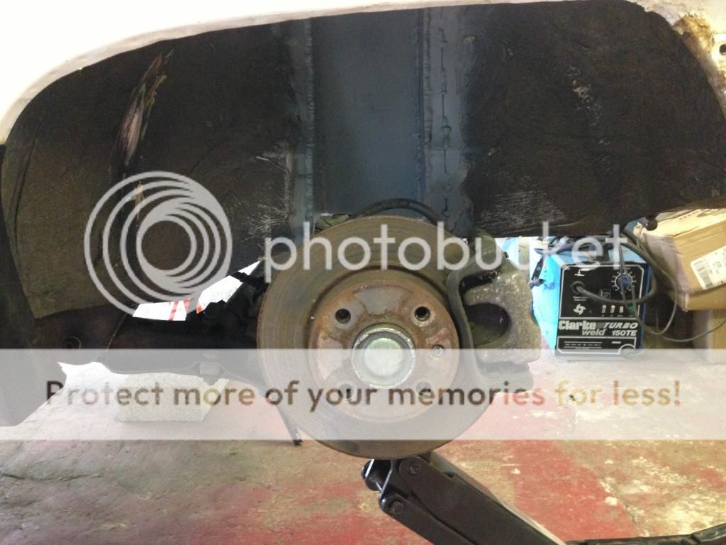

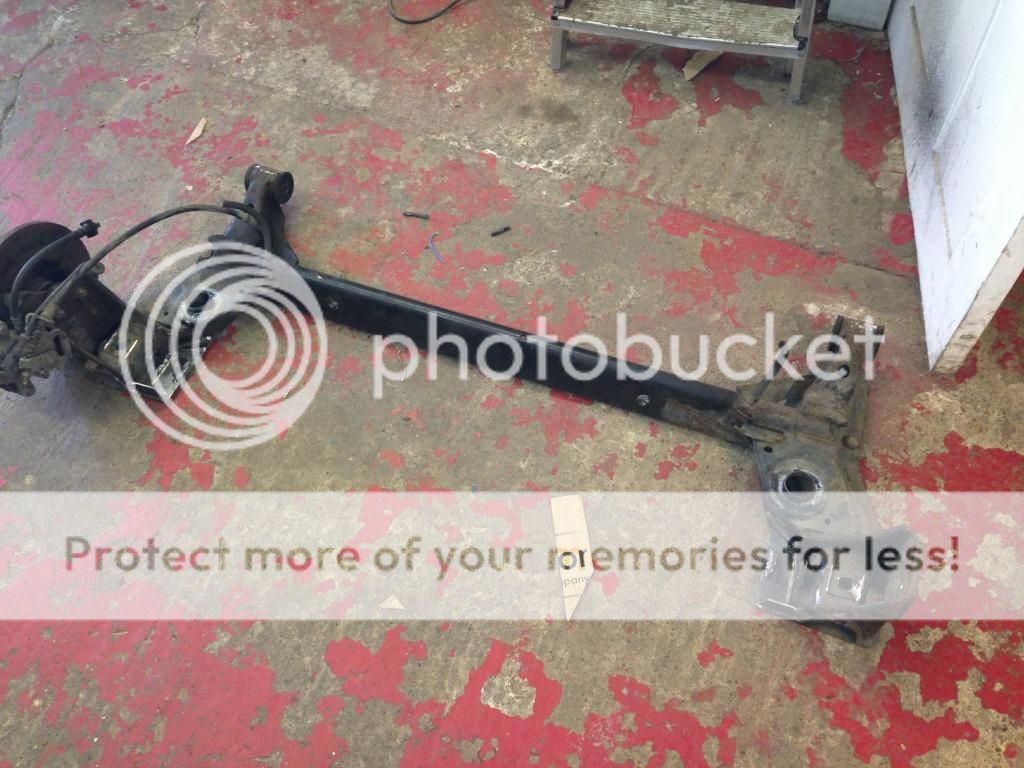

Also had an odd parts request this week for a bare Corsa C disc equipped rear beam, so as I had a few in stock decided to oblige and stripped one down for dispatch. Something I have wanted to try for a while is to see if the stub axles would bolt up to a Nova axle and give the same track as OE, so thought it the perfect time to try it out.
http://i995.photobucket.com/albums/a...ps3822b7a5.jpg
To be honest I was expecting it to work anyway as I have seen it done on Corsa B's, so wasn't too surprised to see the stud pattern was the same.
http://i995.photobucket.com/albums/a...psa870c382.jpg
http://i995.photobucket.com/albums/a...ps4eb50b2d.jpg
Bolted it up and it looked like it was in the right place.
http://i995.photobucket.com/albums/a...psef2421b3.jpg

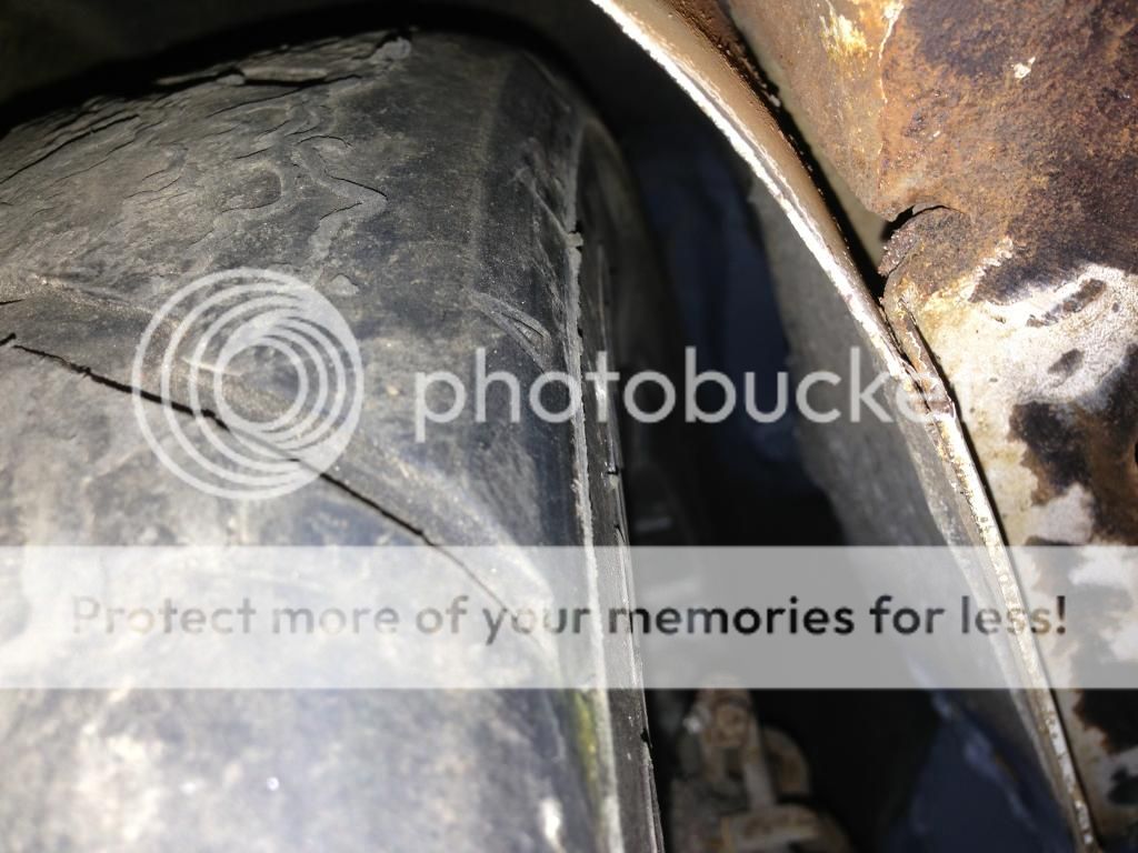

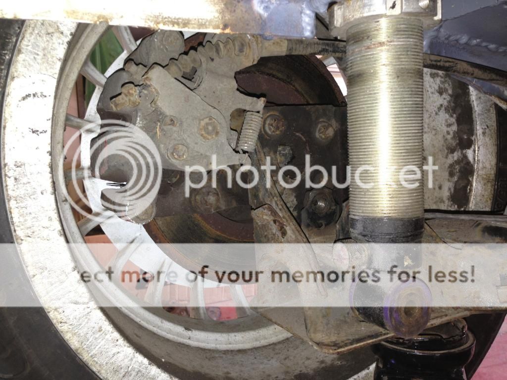

So fitted a wheel and went around it checking for clearance in the normal driving position.
http://i995.photobucket.com/albums/a...psf881c9eb.jpg
http://i995.photobucket.com/albums/a...ps7ebfa337.jpg
http://i995.photobucket.com/albums/a...psc2b2911b.jpg
Delighted to see it all fits fine, so a little fettling the handbrake cable and some custom lines, which it was having anyway and its a pretty simple disc conversion.

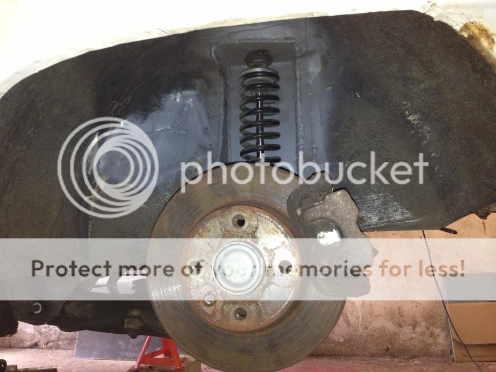

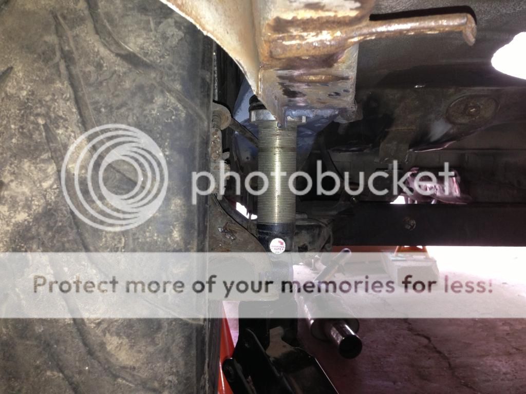

Not quite sure where I'm going to mount the bottom of the strut though? Logic says slightly inboard from the original mount on a boxed section and at the same height, but can't help thinking that with the correct reinforcement the lower level where it is sat now would be better?

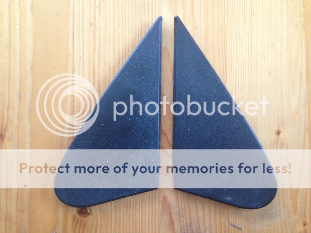

One is a Left exterior mirror blanking plate from a RHD base model. The other is a Right exterior blanking plate from a LHD base model.
Will be using them to de-mirror the car, then drilling holes and using them as base plates for SPA mirrors at some point in the future.

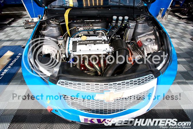

So what chevrolet ran the redtop then?

Chevrolet Vectra GSi was basically a Cavalier GSi in South America, But they still use the engine block now, which is why the Lacetti and Cruze WTC used an XE.

Used in the BTCC too aren't they? Be a shame not to use the new cam cover as it looks ace.
Glad to see you got on OK with the rear brakes - a guy I talked to at PV Show said there were some 'lugs' that needed grinding off on the rear so they sit flush with the beam and also camber discs/plates to get it straight again after doing so - any ideas/thoughts on this?
Yes there are a couple of lugs on each stub that needed filing off, but it only takes a few seconds and doesn't affect the face enough to require shimming as they are only at 3 & 9 o-clock with plenty of flat face showing for reference.

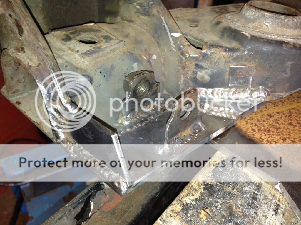

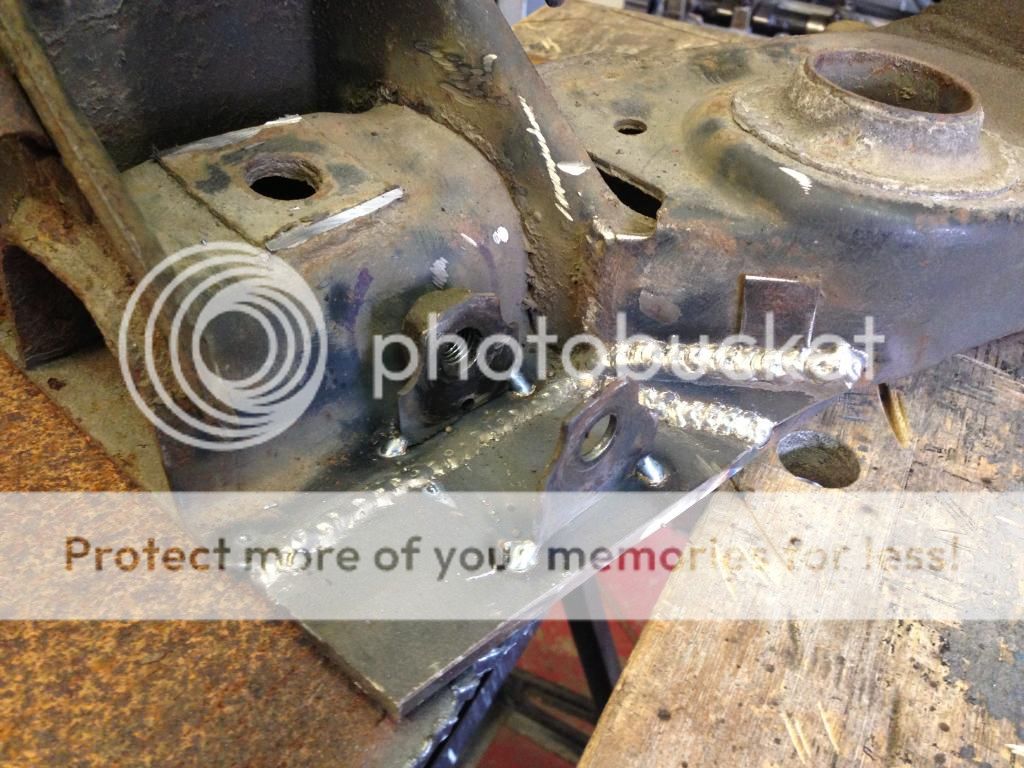

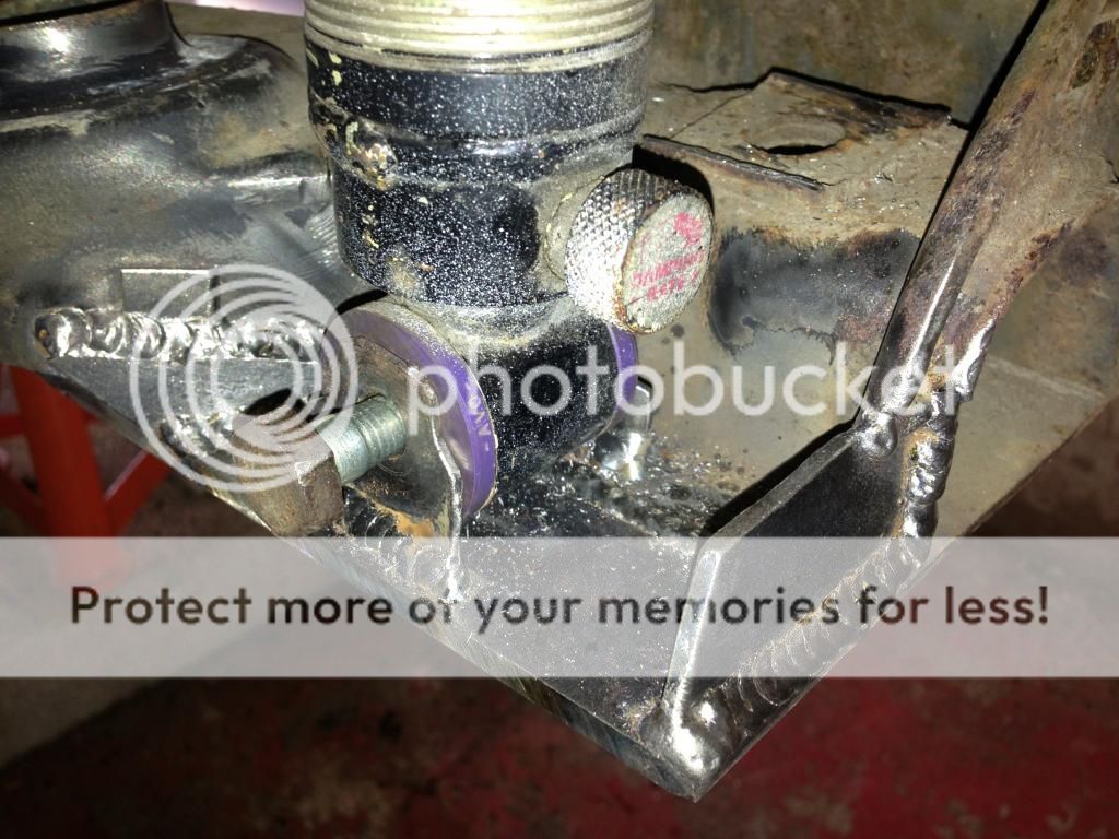

Decided to mount the bottom of the rear strut at the lower level I spoke about before, mainly because it was just easier. So started making a 5mm plate to bring the mounting inboard a little.
http://i995.photobucket.com/albums/a...ps71e03848.jpg
Mounted it up to the car to check it before fully welding,
http://i995.photobucket.com/albums/a...ps94ca4d1e.jpg
Then added a little extra webbing to the end.
http://i995.photobucket.com/albums/a...psbaa41c4e.jpg
I'm not concerned atall that it wont be strong enough, its as solid as a rock, and only half of the mount actually sits on the new addition.

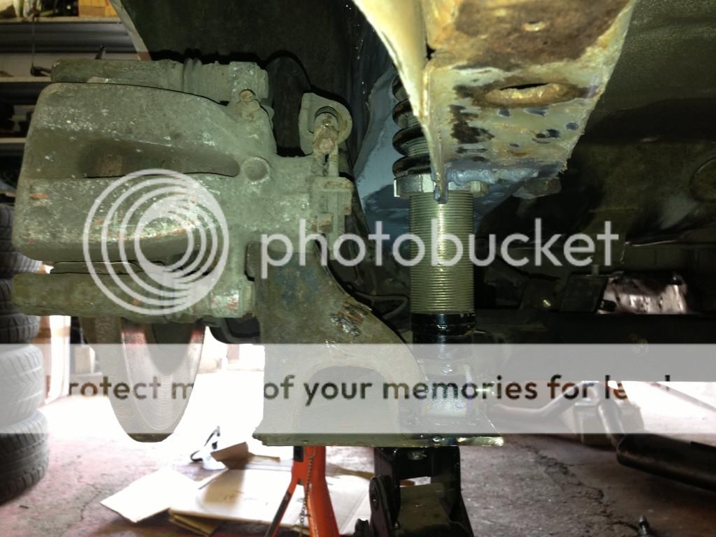

Did the same for the other side then fitted it again.
http://i995.photobucket.com/albums/a...ps2000d5c2.jpg
Only temporary though, it'll be coming off again yet.
http://i995.photobucket.com/albums/a...psef93ecbd.jpg
Drilled for the top mounts and checked it all for square, Nothings out of place and clearance is fine so should work well.
http://i995.photobucket.com/albums/a...ps44274da3.jpg
Plenty of room for adjustment.
