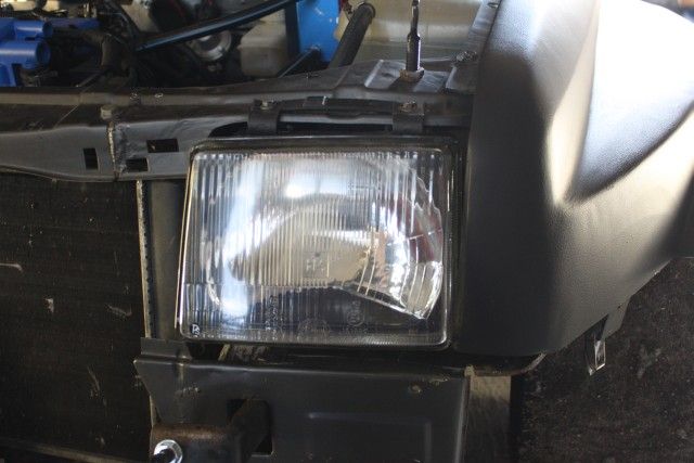

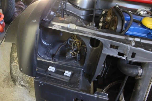

Today i removed the front lights because on the track you don't need headlights and they're simply to heavy.
http://i260.photobucket.com/albums/i...ps6d90e20a.jpg

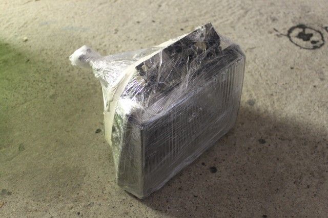

Then i wrapped them in cling film...
http://i260.photobucket.com/albums/i...psc942f33b.jpg

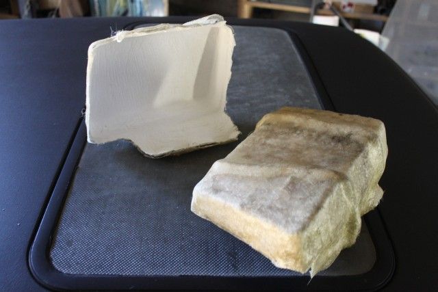

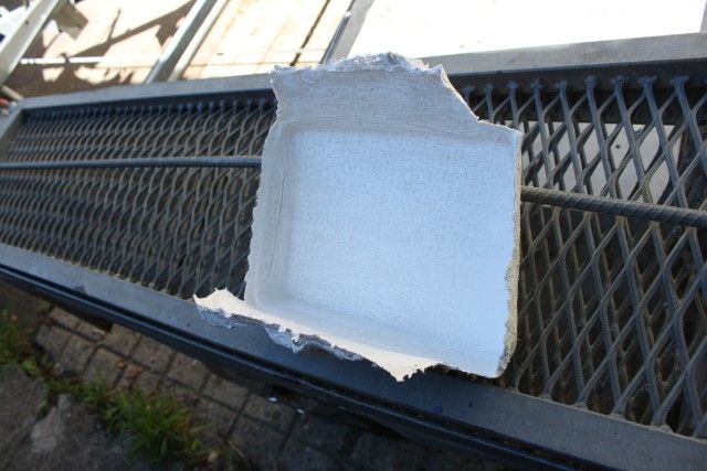

...and made a mould with gypsum bandages reinforced with aluminium tubes.
http://i260.photobucket.com/albums/i...psb0adcaca.jpg

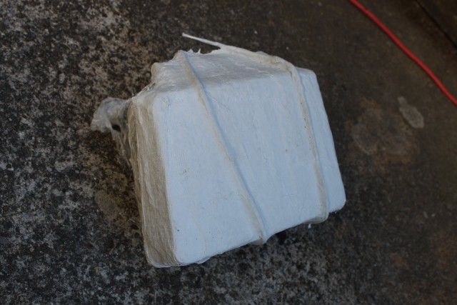

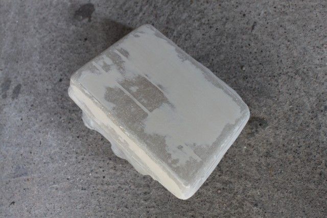

Final mould for right headlight
http://i260.photobucket.com/albums/i...ps08805f39.jpg

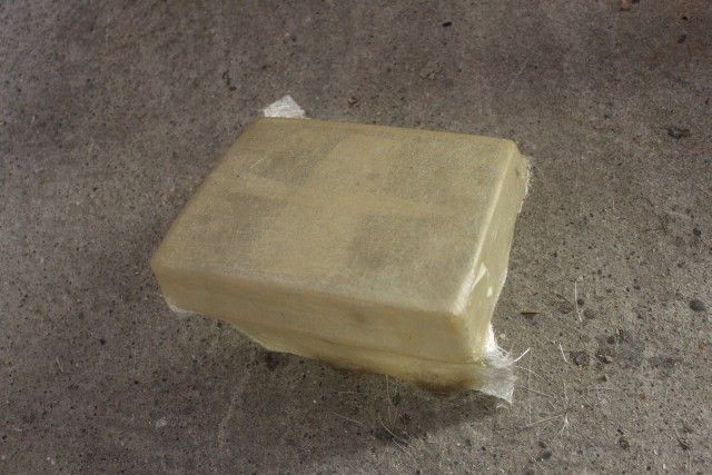

to prevent them from braking i protected them with a layer of fiberglass
http://i260.photobucket.com/albums/i...ps9e41ce40.jpg

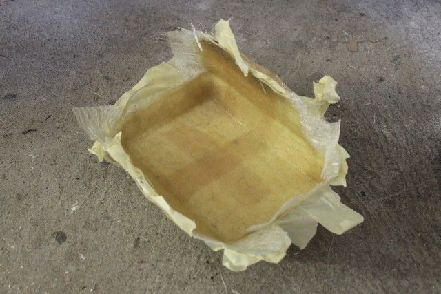

First i used my freshly made mould to create a fiberglass Headlight replacment
http://i260.photobucket.com/albums/i...psbdbec70e.jpg
released from mould
http://i260.photobucket.com/albums/i...pse6b021ab.jpg

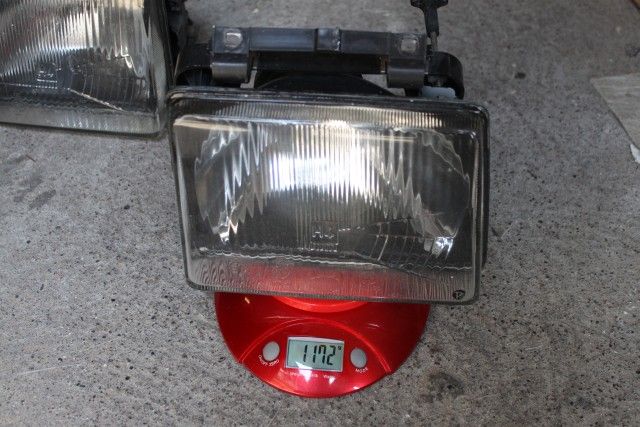

Original headlight weights 1172 gramms

and my fiberlass replacement with applied color and clear coat: 114 gramms :cool:
http://i260.photobucket.com/albums/i...pse8f416a8.jpg
That's 2 Kilos removed from the front :thumb:

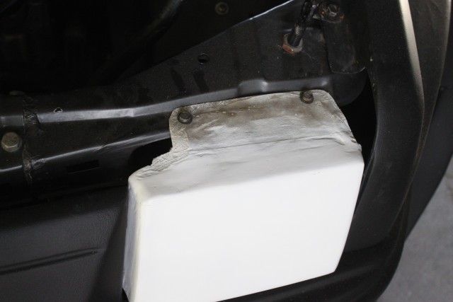

my fiberglass items can be mounted to the original pickup points.
http://i260.photobucket.com/albums/i...ps402c771e.jpg

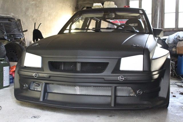

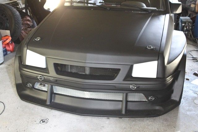

As a contrast I'm quite pleased with the white "headlights" :)
http://i260.photobucket.com/albums/i...ps24d6dae8.jpg
http://i260.photobucket.com/albums/i...ps3d8674b3.jpg
...now searching for other parts that can be replaced with fiberglass lol
That's a really professional look you've achieved there; can you not get some dark mesh for the bumper & maybe a sun strip?
