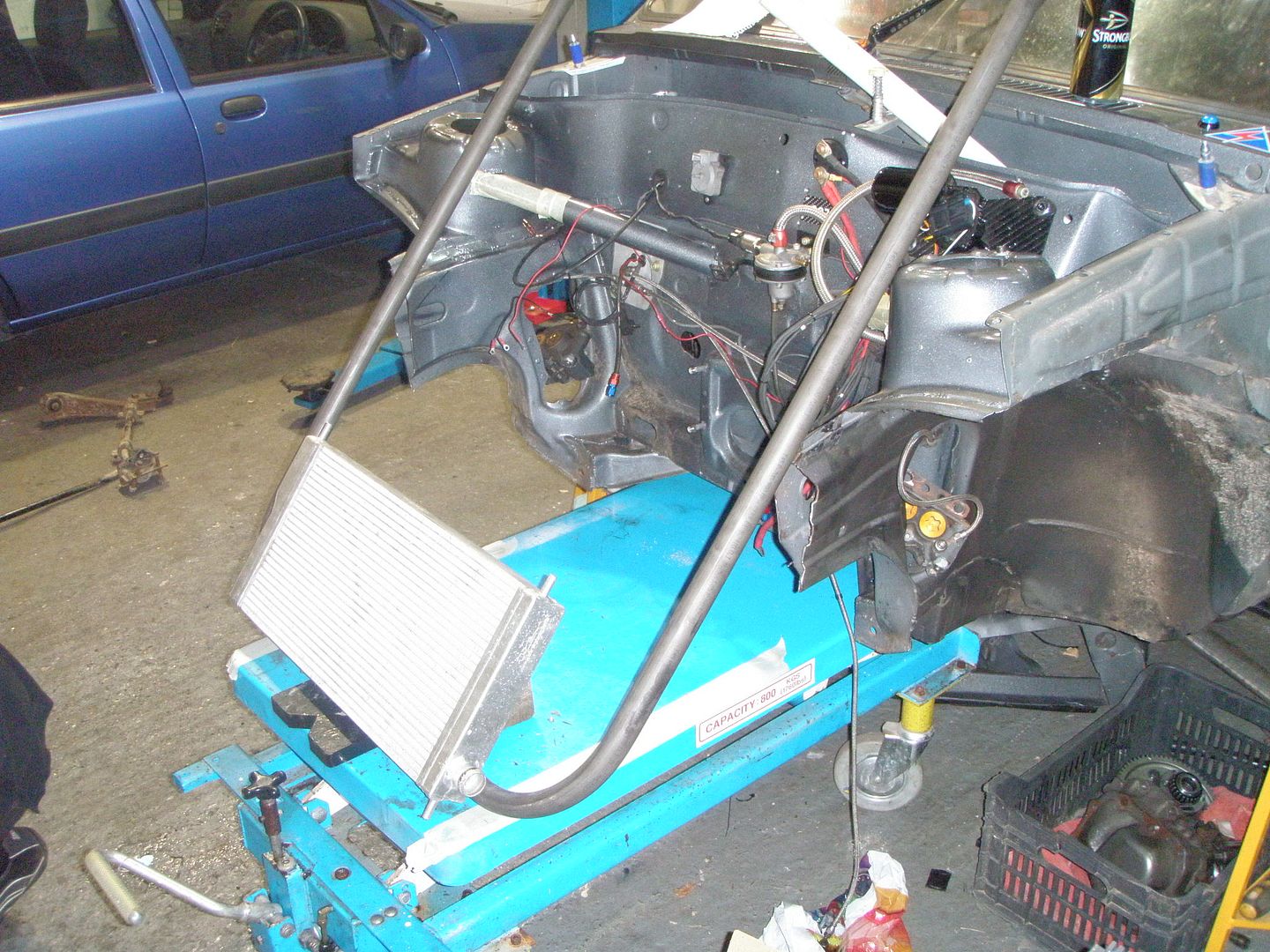

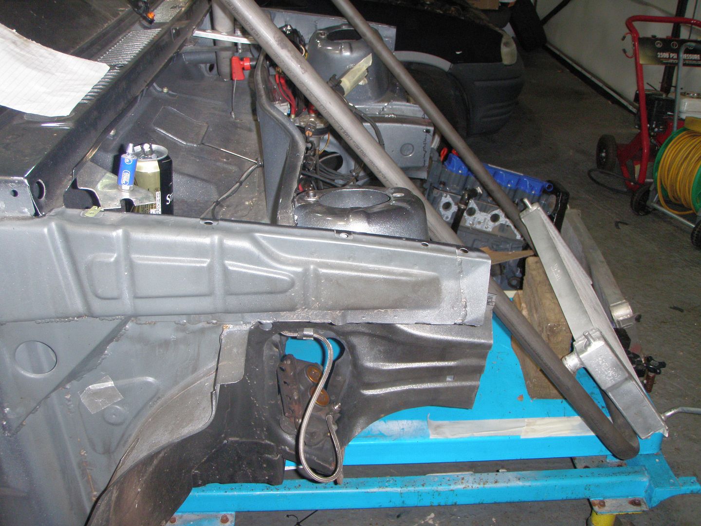

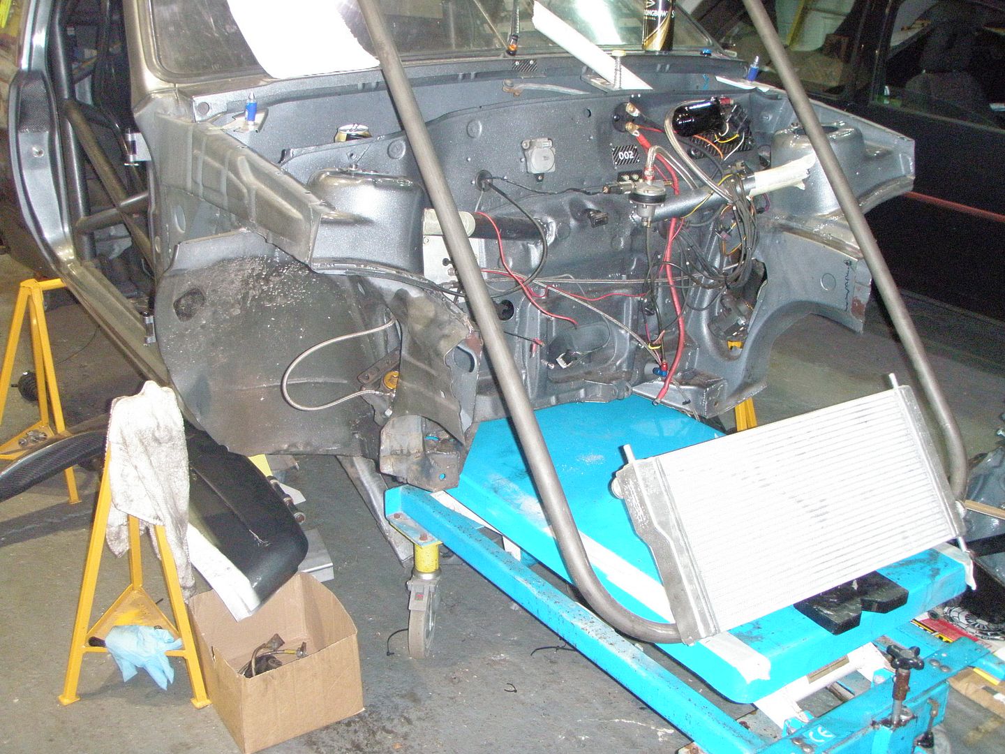

Anyway, a few photos of progress with the resurrection of my Nova, firstly some mocking up of the new front end, following removal of the mangled front inner wings and crossmember;
http://i285.photobucket.com/albums/l...ort/002-93.jpg
http://i285.photobucket.com/albums/l...ort/003-96.jpg
http://i285.photobucket.com/albums/l...ort/004-84.jpg

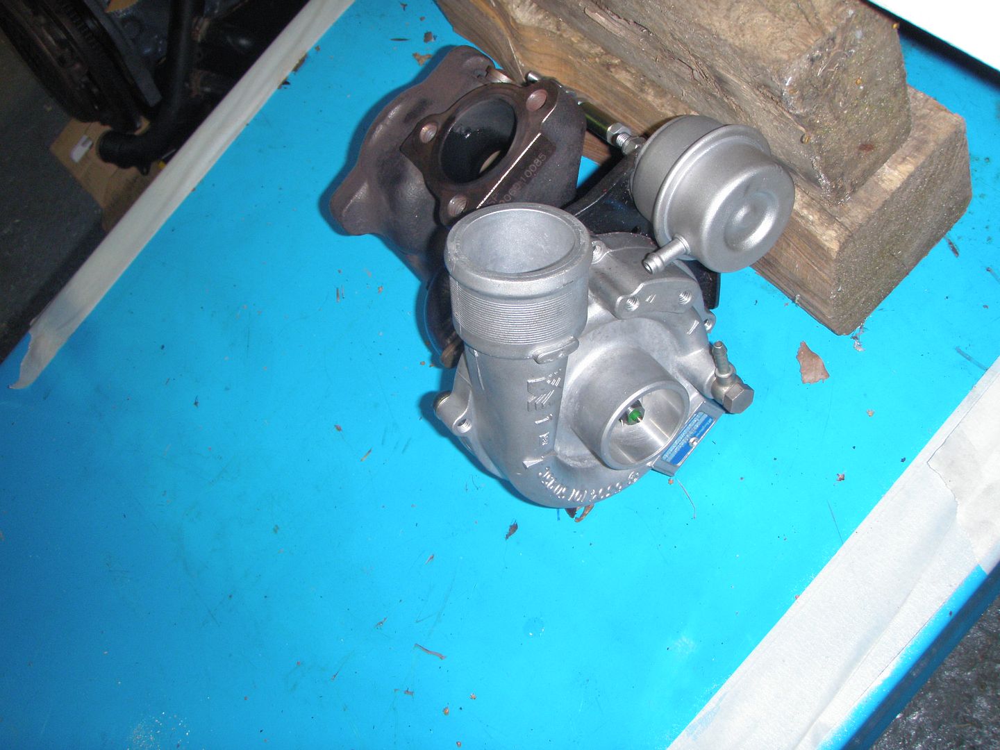

The turbo, fresh from being rebuilt at CR Turbos (great service and sensible prices);
http://i285.photobucket.com/albums/l...ort/008-55.jpg

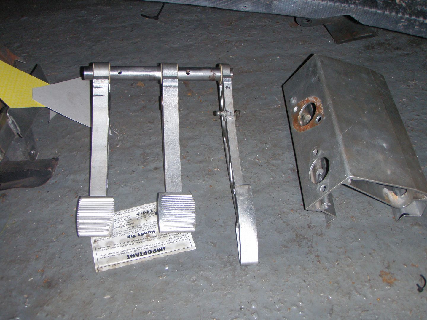

The Lotus Elise pedal box awaiting more modification and installation;
http://i285.photobucket.com/albums/l...ort/009-54.jpg

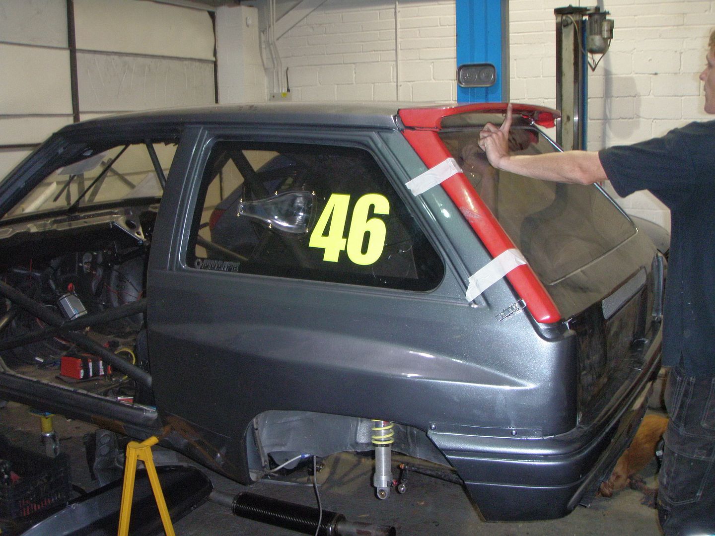

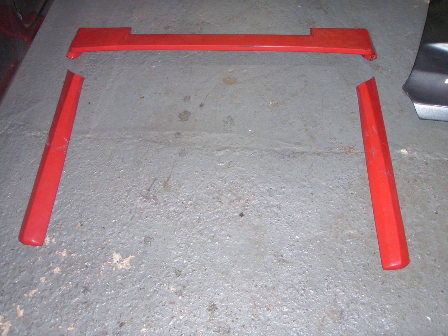

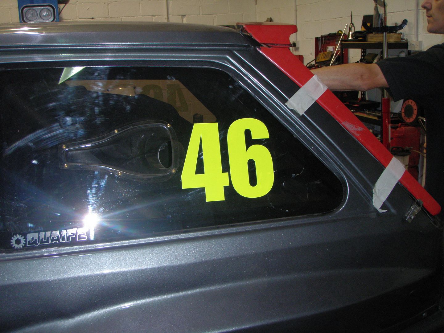

Irmscher 3-piece rear spoiler (many thanks to Vessey for the loan of this). It's going to my aerodynamics man next week for him to assess it's suitability, if it is right for the job I'll get it made out of carbon fibre;
http://i285.photobucket.com/albums/l...ort/015-37.jpg
http://i285.photobucket.com/albums/l...ort/006-76.jpg
http://i285.photobucket.com/albums/l...ort/007-64.jpg

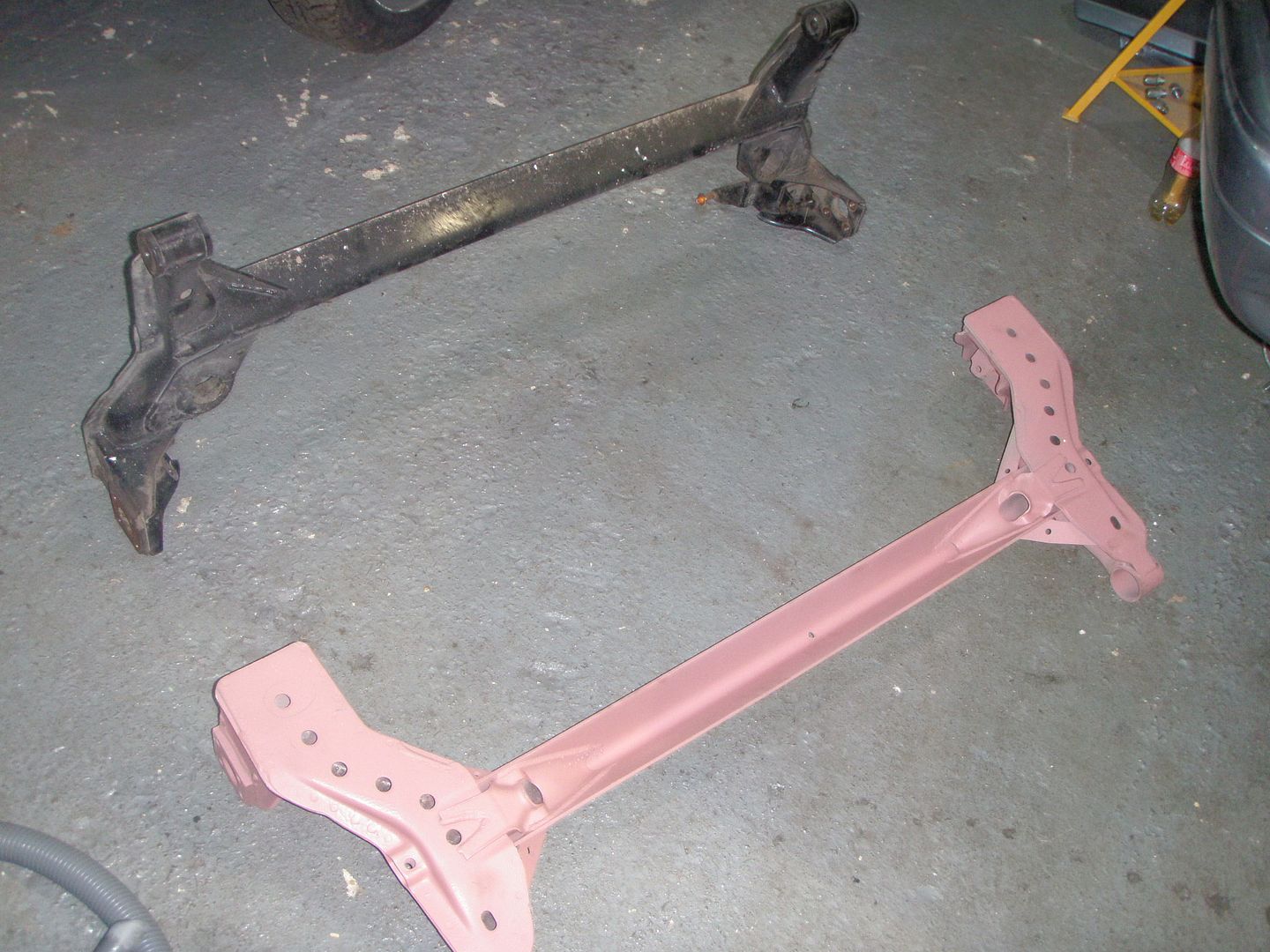

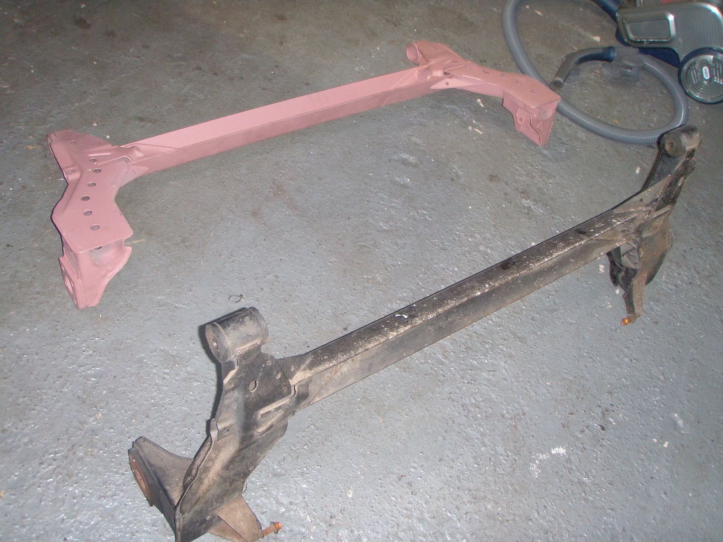

And finally for now, the new rear beam, which has been lightened by 1.5kg compared to my old one;
http://i285.photobucket.com/albums/l...ort/010-53.jpg
http://i285.photobucket.com/albums/l...ort/011-47.jpg

How did you shed so much weight off the beam? I see the pink one doesn't have the parts for the rear anti roll bar. Have you redesigned the roll bar attachments or are they still to be added?
i was curious too, as the new beam has no bushes.
The pink beam still needs bushes in it, we haven't decided yet if we're going to use a rose joint or just the poly bushes that were on the old axle.
The weight has been taken away with a lot of hours of cutting and grinding to smooth down, along with removal of the spring platforms, drilling of holes etc.
I plan to test the car with no rear anti-roll bar, I'd like to think it can run without one to save even more weight. But if it's decided it does need one, we will probably fabricate something in T45 tube as the old one was quite heavy.
liking the new tube front end colin, are you planning to keep the rad angled? thats my plan for this winter but with the rad angle forwards with sealed in airflow entry and exiting out the bonnet via some vents like most current GT cars
i think the plan for no ARB will yield interesting results, personally i think you'll need one, or to stiffen the beam in a different way may be a lighter solution
Any picks or links mike - sounds interesting
