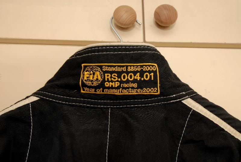

However I have today received my new OMP 3-layer FIA approved race suit, which I got for a fantastic bargain as it retails at £369.99 + VAT :thumb:

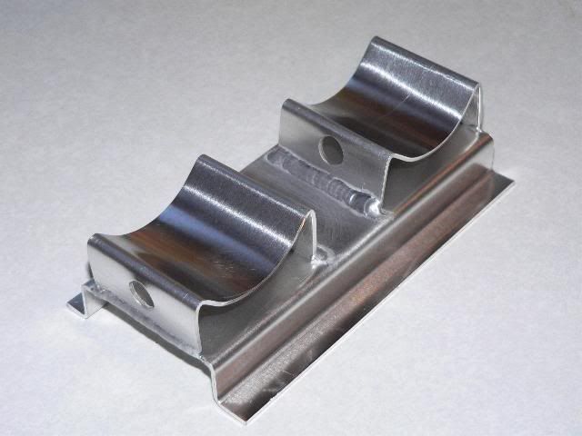

"Timing Strut - Where timing is activated by a light beam, the vehicles will be fitted at the front with a vertical timing strut, minimum vertical height 254mm, the bottom of which shall be not less than 180mm and no more than 200mm from the ground. The strut will be in matt black on both sides, over its total area, which shall be not less than 254mm by 51mm. No other, or further forward, part of the vehicle my interupt these dimension or actuate the timing"
This said, I made a 'to scale' template to take to my alloy fabricators to have one made in 2mm thick alloy, a couple of mm bigger on each edge just to be sure, as it seems they are mega strict!
http://i136.photobucket.com/albums/q...ure/nc0704.jpg

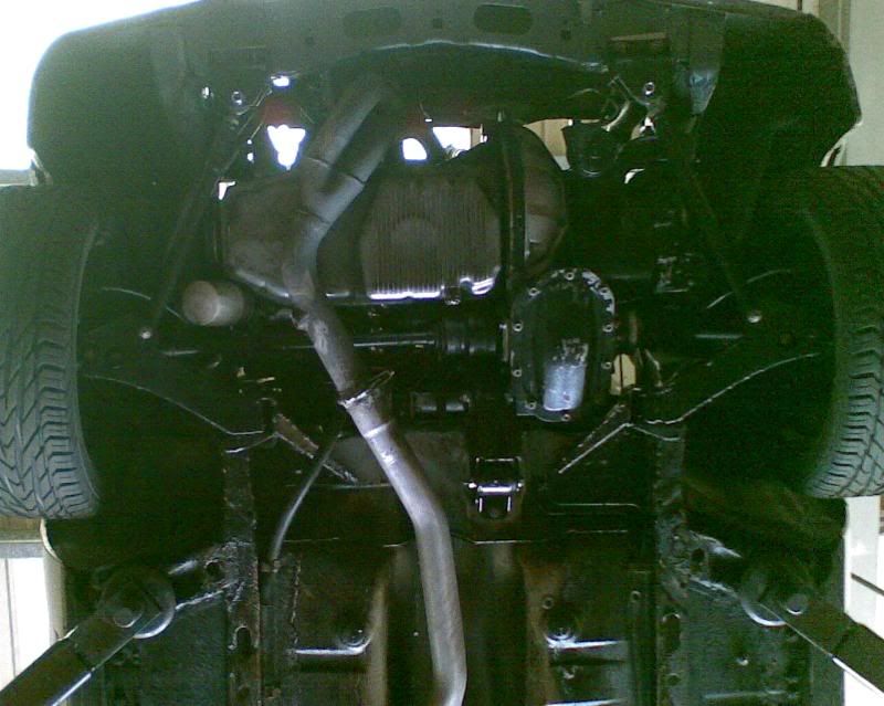

Whilst changing my handbrake cable thougth I'd snap a "under bay" shot
http://i136.photobucket.com/albums/q...ure/nc0705.jpg

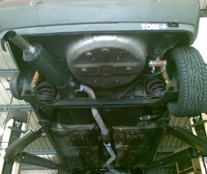

Exhaust path soon to be changed
http://i136.photobucket.com/albums/q...ure/nc0706.jpg

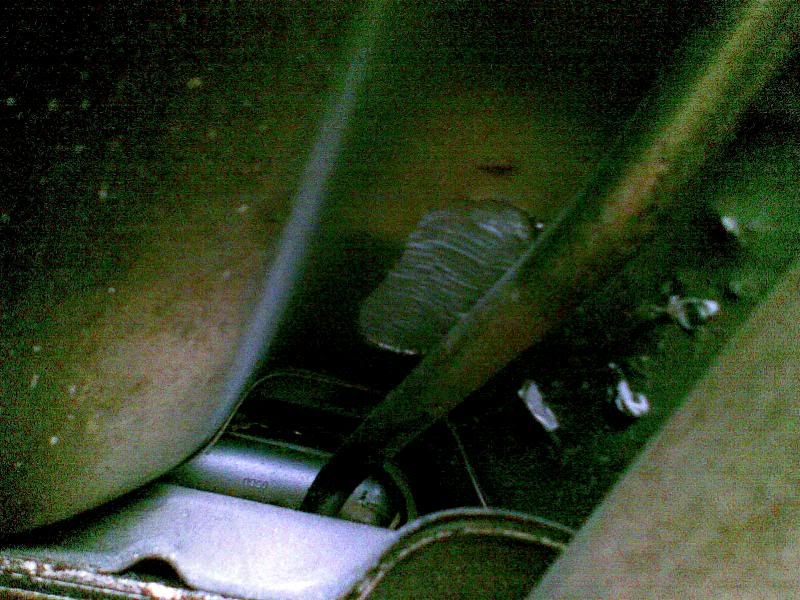

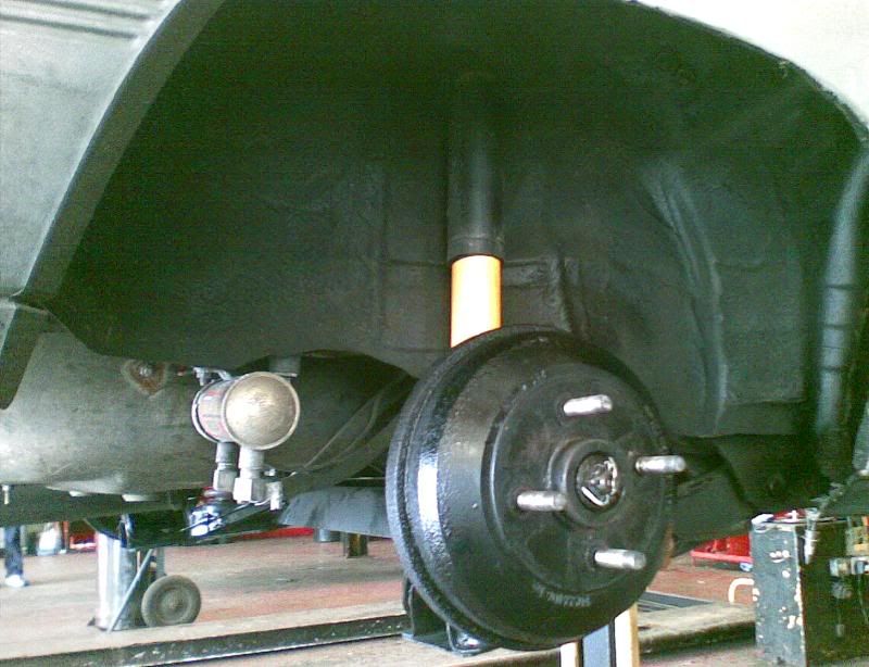

Rear drums resprayed satin black, and inner rear arches waxoyled again
http://i136.photobucket.com/albums/q...ure/nc0707.jpg

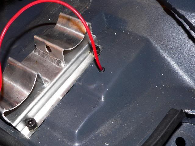

Hole underneath soon to be put to use
http://i136.photobucket.com/albums/q...ure/nc0709.jpg

Going for a new straight exhaust system then? OR modding the current one?
not too sure at the moment, as i like the system I have - i'll probably just make a straight section with a big circular middle silencer :)

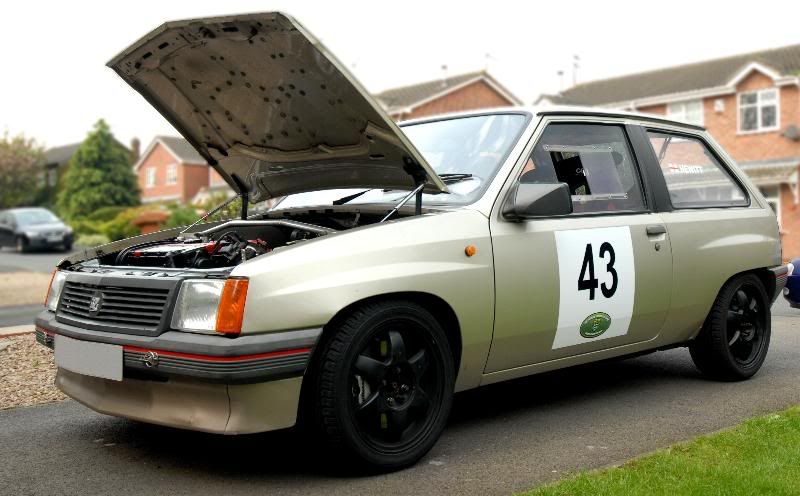

I'm race number 43, here is our class:

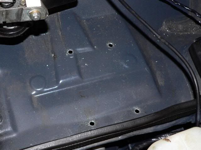

In my usual style, even with no updates to speak of - there are still pics because that I do.
Bay with resprayed covers, brace polished lol, inner wings resprayed
http://i136.photobucket.com/albums/q...ure/nc0710.jpg

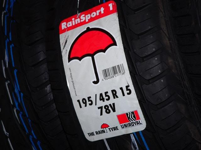

Aforementioned numbers, Rainsports have been removed in favour of dry whether and my Mod Prod 3B class allows me to run 888s so I shall be doing so!
http://i136.photobucket.com/albums/q...ure/nc0713.jpg
