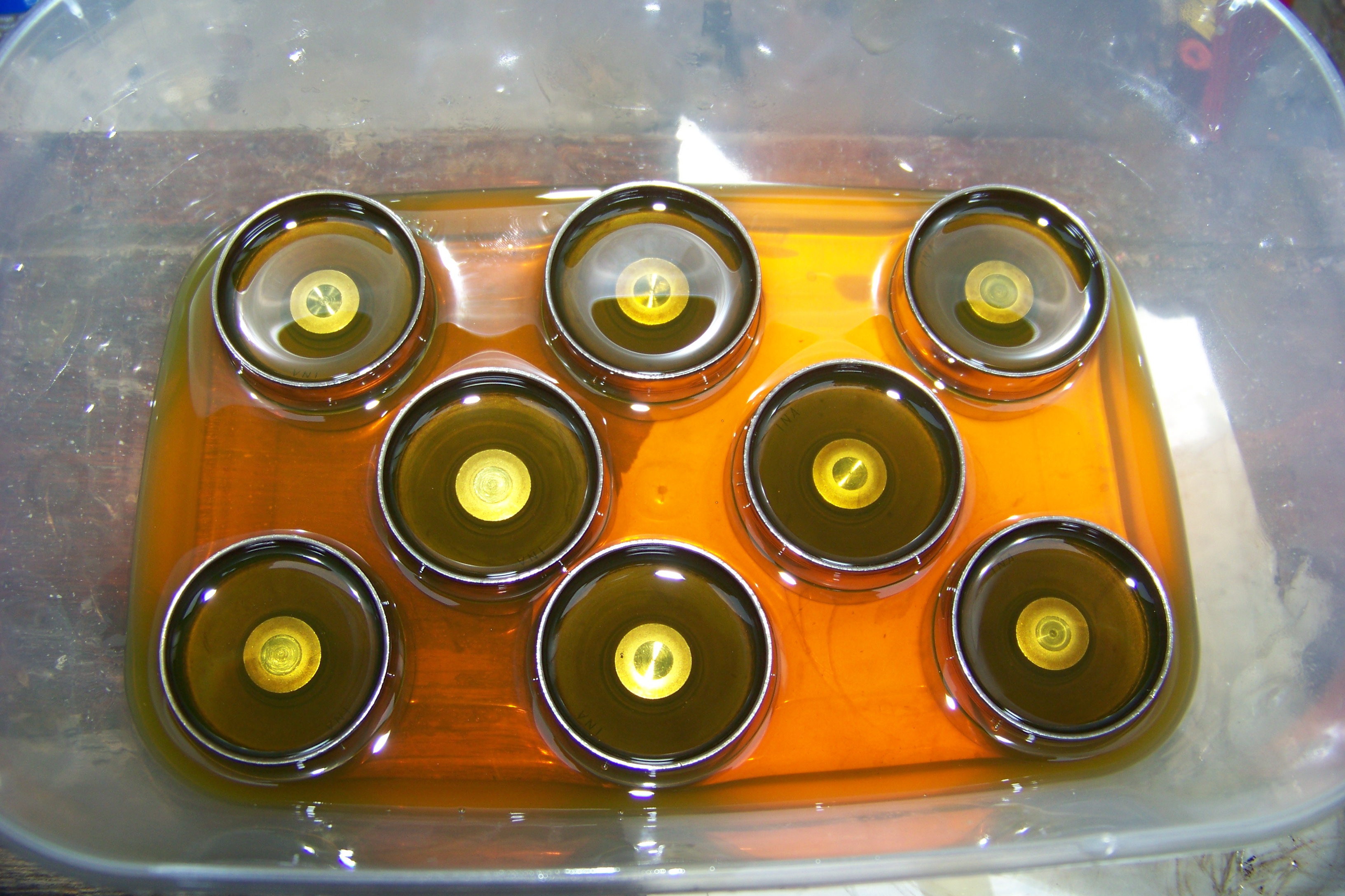

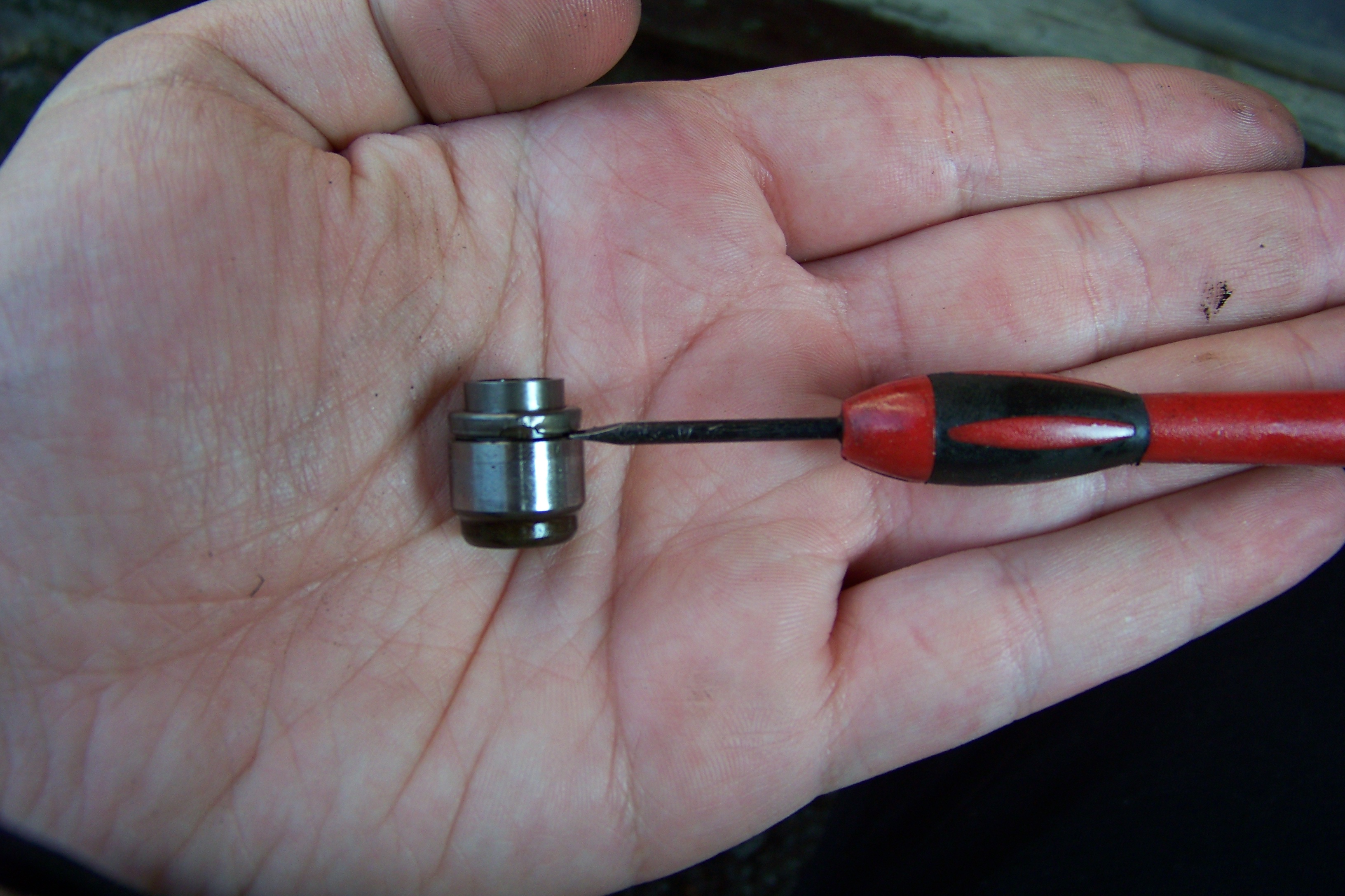

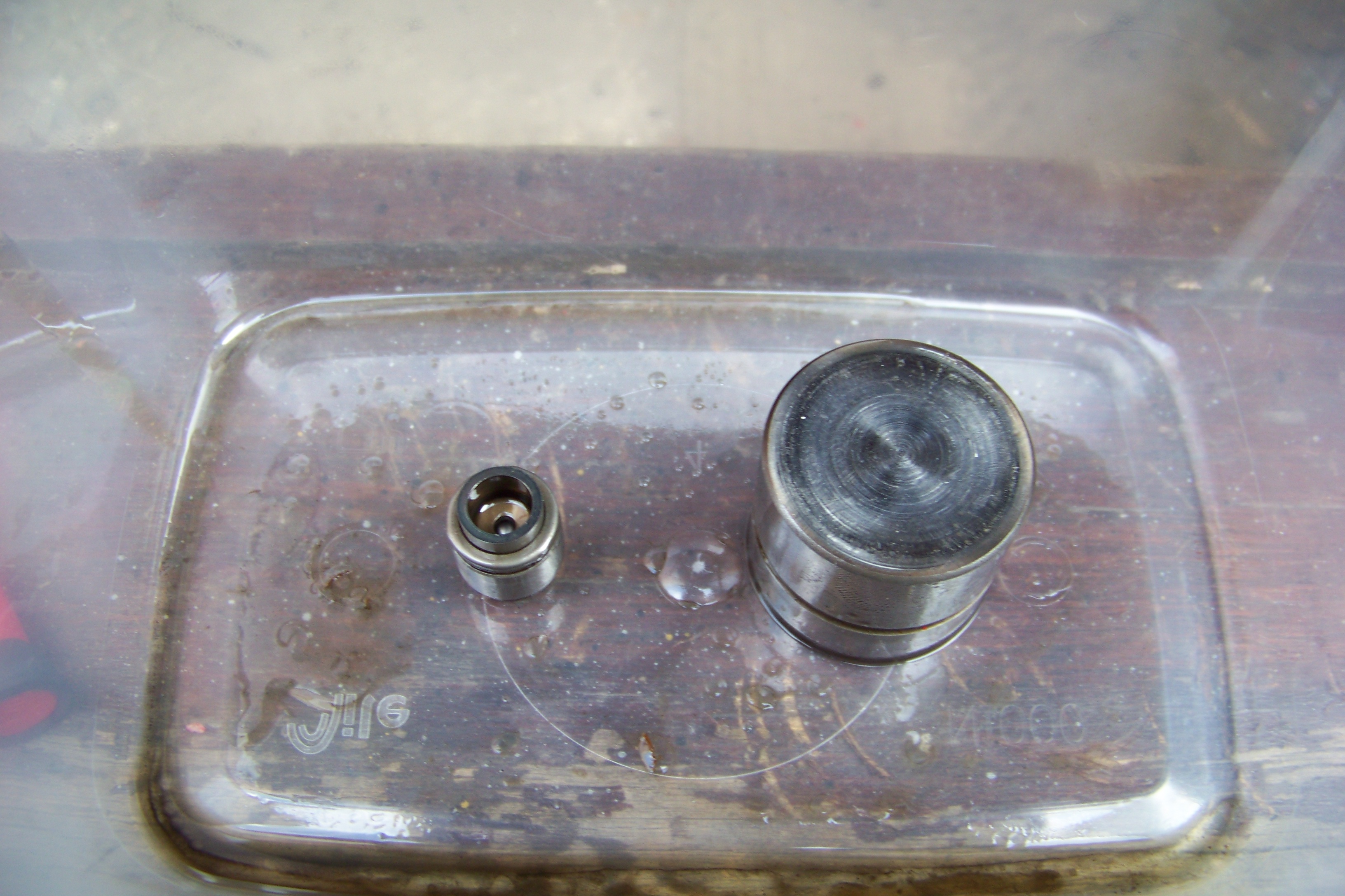

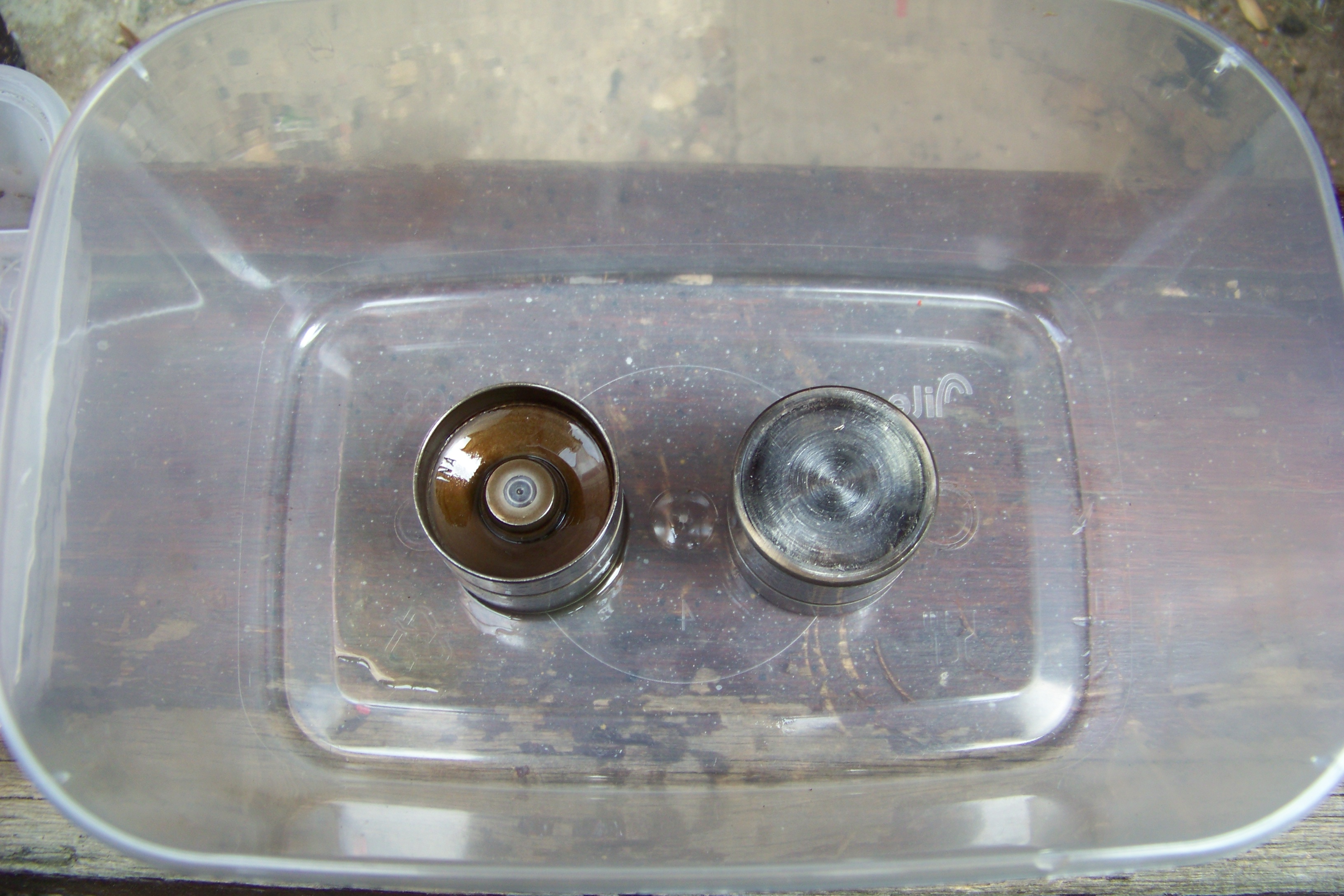

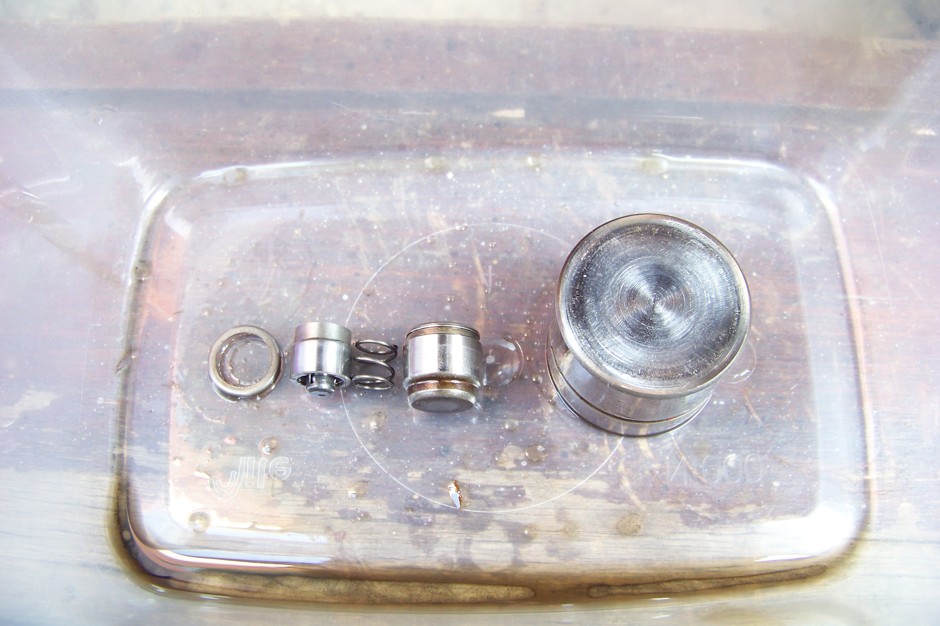

So here we have one seized hydraulic tappet. A couple firm whacks against a firm surface, a quick jiggle and pull removes the centre part of the tappet and we now have two pieces
https://images2.imgbox.com/91/14/ASIKN5pO_o.jpg
I assumed that cleaning it as it stood would solve the seized-ness (as some people don't go all the way to remove the smaller section into it's separate parts) but it still wouldn't compress. So no choice but to go ahead and crack open the little tappet. I personally used a small precise flat blade screwdriver to carefully prise off the retaining ring (it simply clips on to the body of the tappet).
https://images2.imgbox.com/e8/cf/Xnr4o4ny_o.jpg

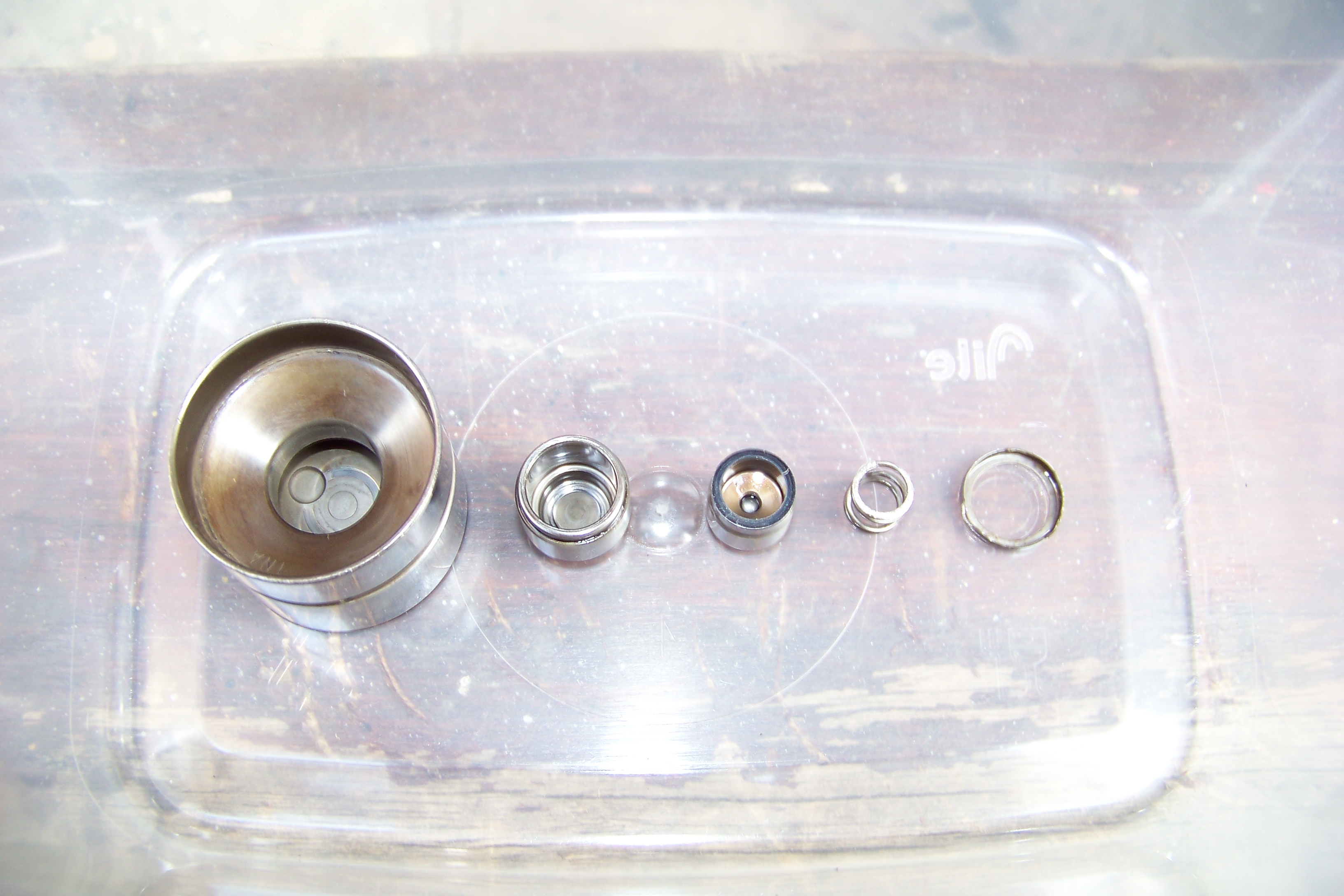

Once carefully removed we now have the outer sleeve, inner sleeve with the ball bearing, spring and retaining clip.
https://images2.imgbox.com/bd/02/VK7ukRE5_o.jpg
Everything seemed ok but there was a bit of gunky oil with slight deposits. The oil was blacker than black though. Gave the bits a good clean allowing them to soak in some meth spirit and a blast of carb cleaner to remove the gunk. After a wipe with a clean cloth and left to dry for a mo, I was left with the bits looking like this
https://images2.imgbox.com/87/b6/XAVdrsfd_o.jpg
So fresh and clean!

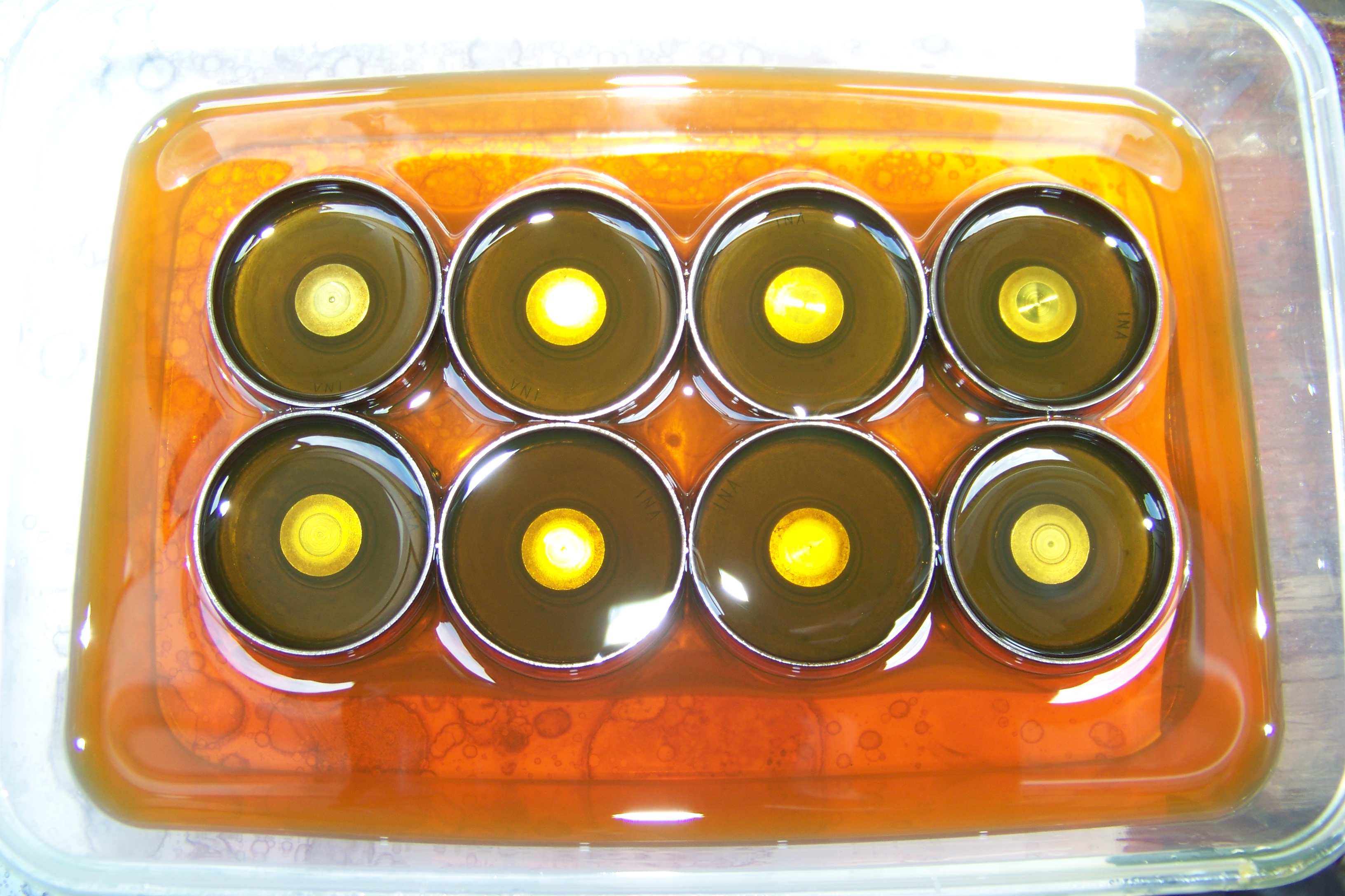

Then it was back to re-assembly. Got out some part empty oil, in this case some fully synthetic Mobil 1 SuperSyn stuff and literally put a drop of oil into the outer sleeve. I then put the spring on to the inner sleeve (sits on the bearing assembly) and slotted the bits into each other. The trick here is to only put a drop of oil as too much oil into the sleeve won't allow it to fully compress and therefore will feel seized and/or really stiff.
Once slotted back I put on the retaining ring and firmly pushed down to lock the ring in place. I then put a couple drops of oil into the larger half of the tappet and pushed the smaller bit into it. One fully working tappet all clean and compresses fine. Two cleaned ones together
https://images2.imgbox.com/36/ca/2NhQh7Lz_o.jpg
I then did the other six and thought I'd leave it for now as my fingers were aching . Once I had one row of tappets sorted I put them into a clean container and filler it up with some more oil and will leave them in there until the head is rebuilt.
https://images2.imgbox.com/e4/31/FogaLBK4_o.jpg
Next up is to do the remaining eight. May stick this up in Articles for reference.

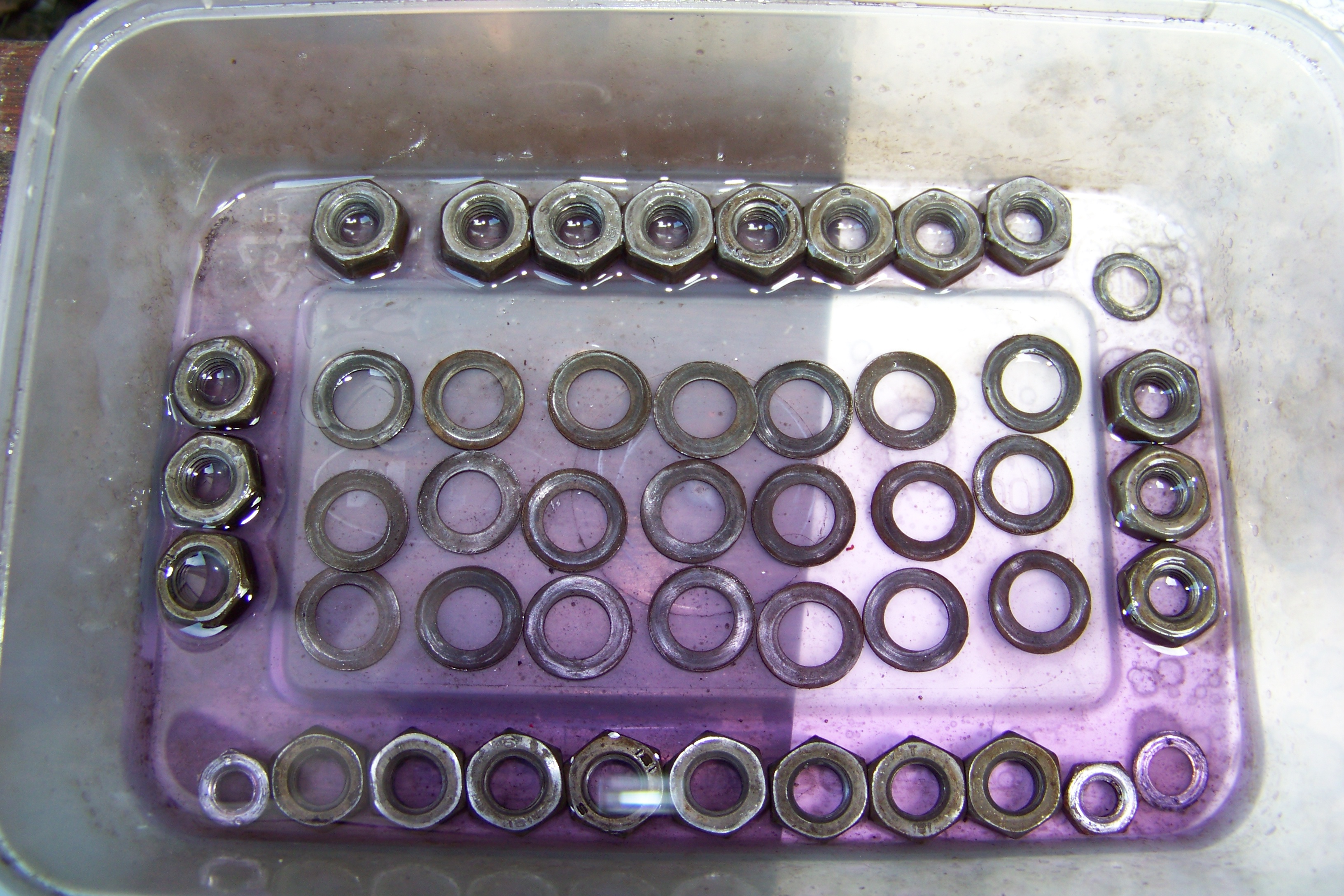

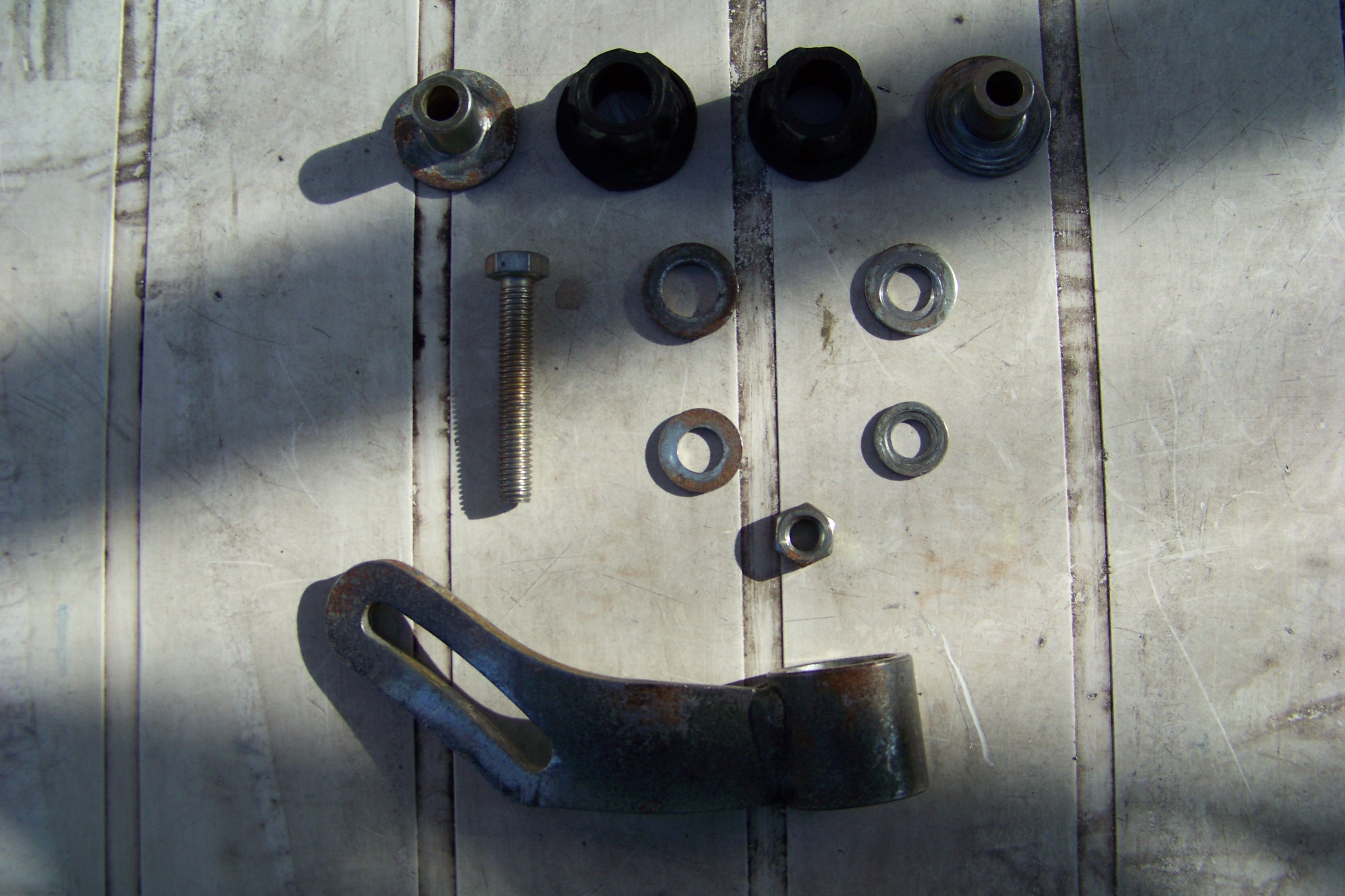

Also managed to clean up the camshaft nuts and washers as they were filthy too. They used to be black but now look more like this
https://images2.imgbox.com/16/3f/BbHlBFT6_o.jpg

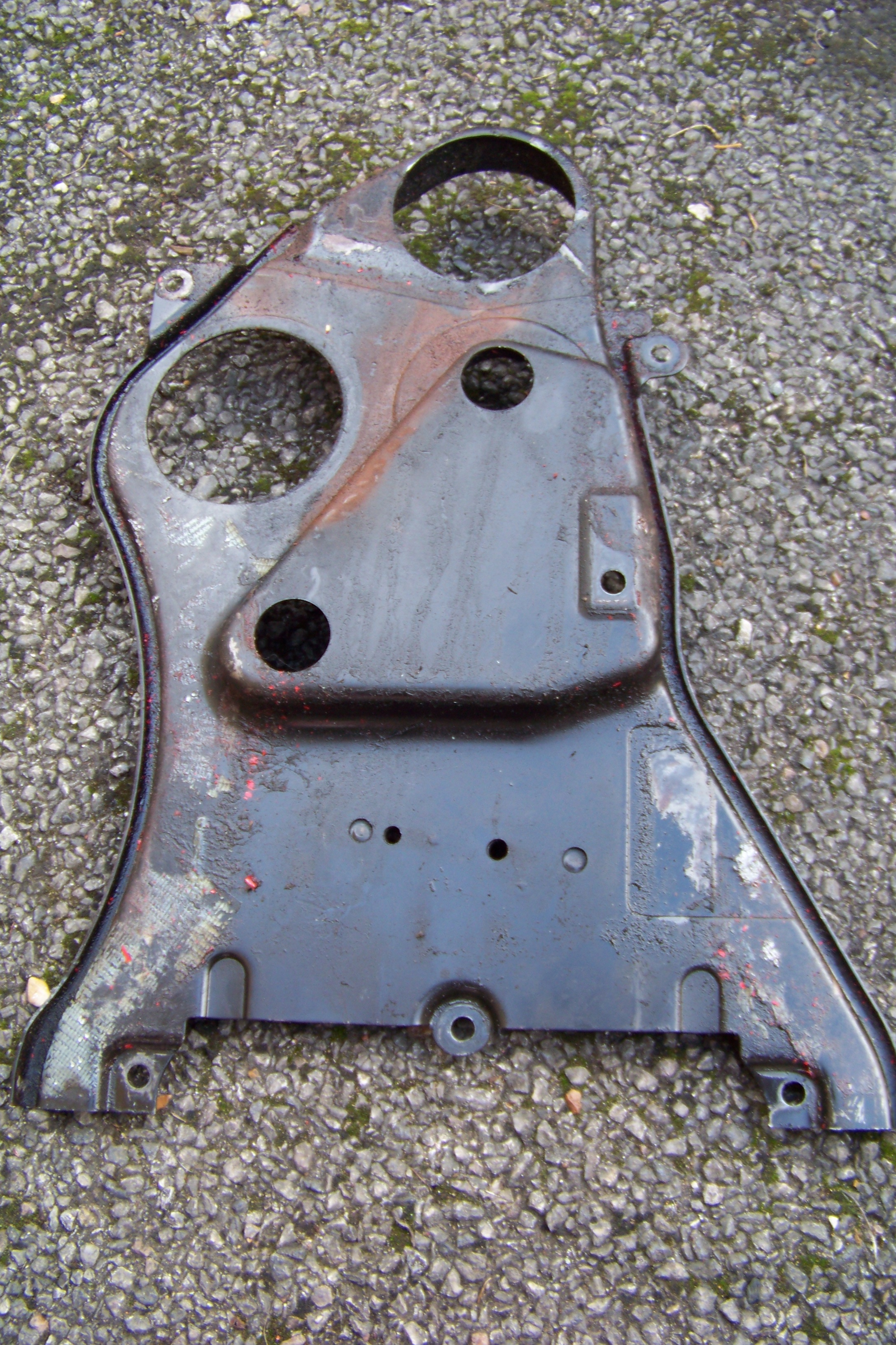

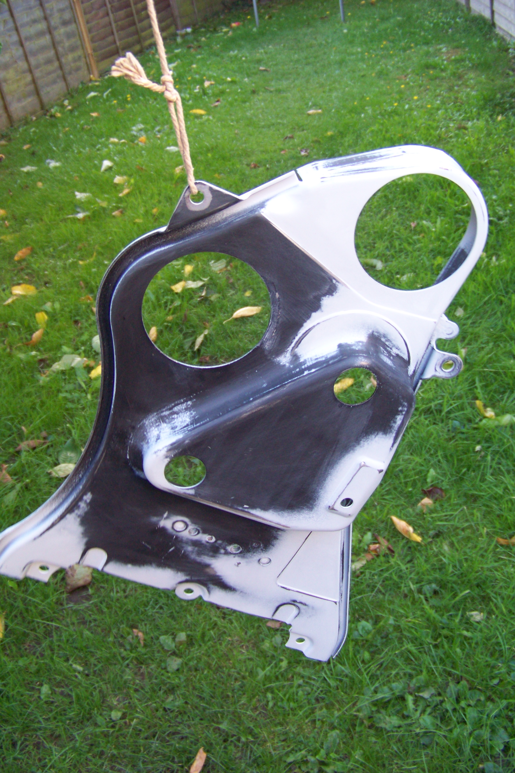

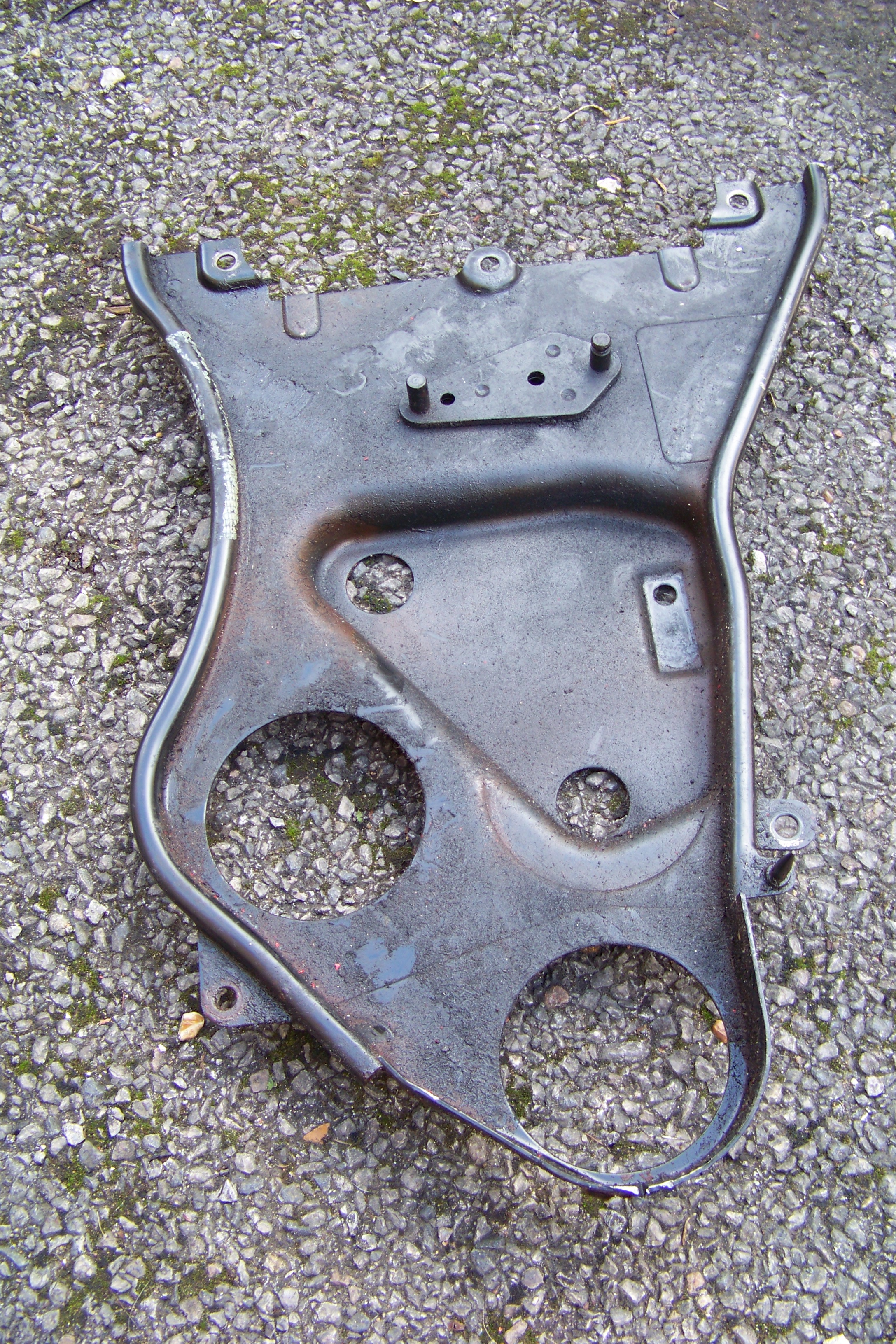

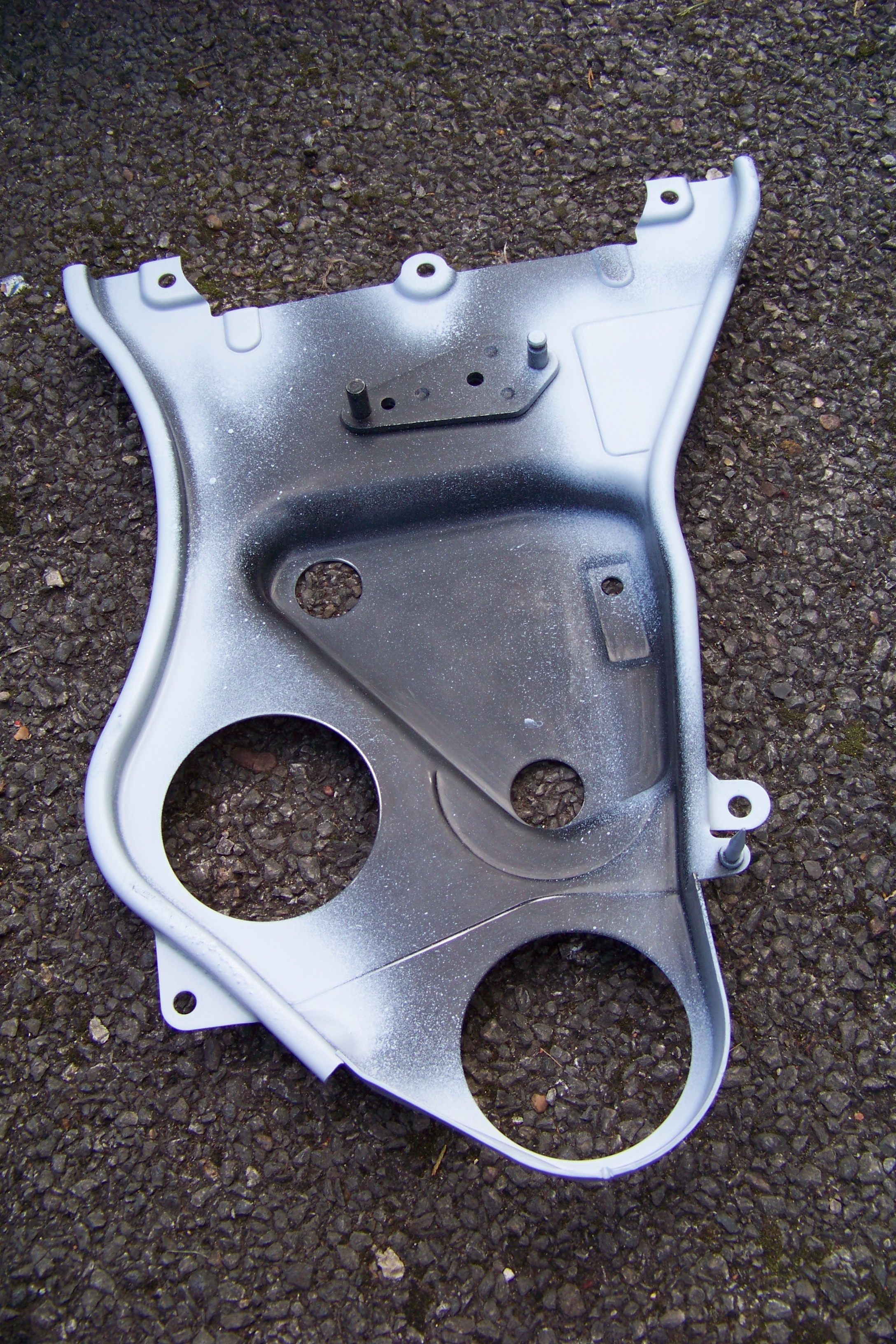

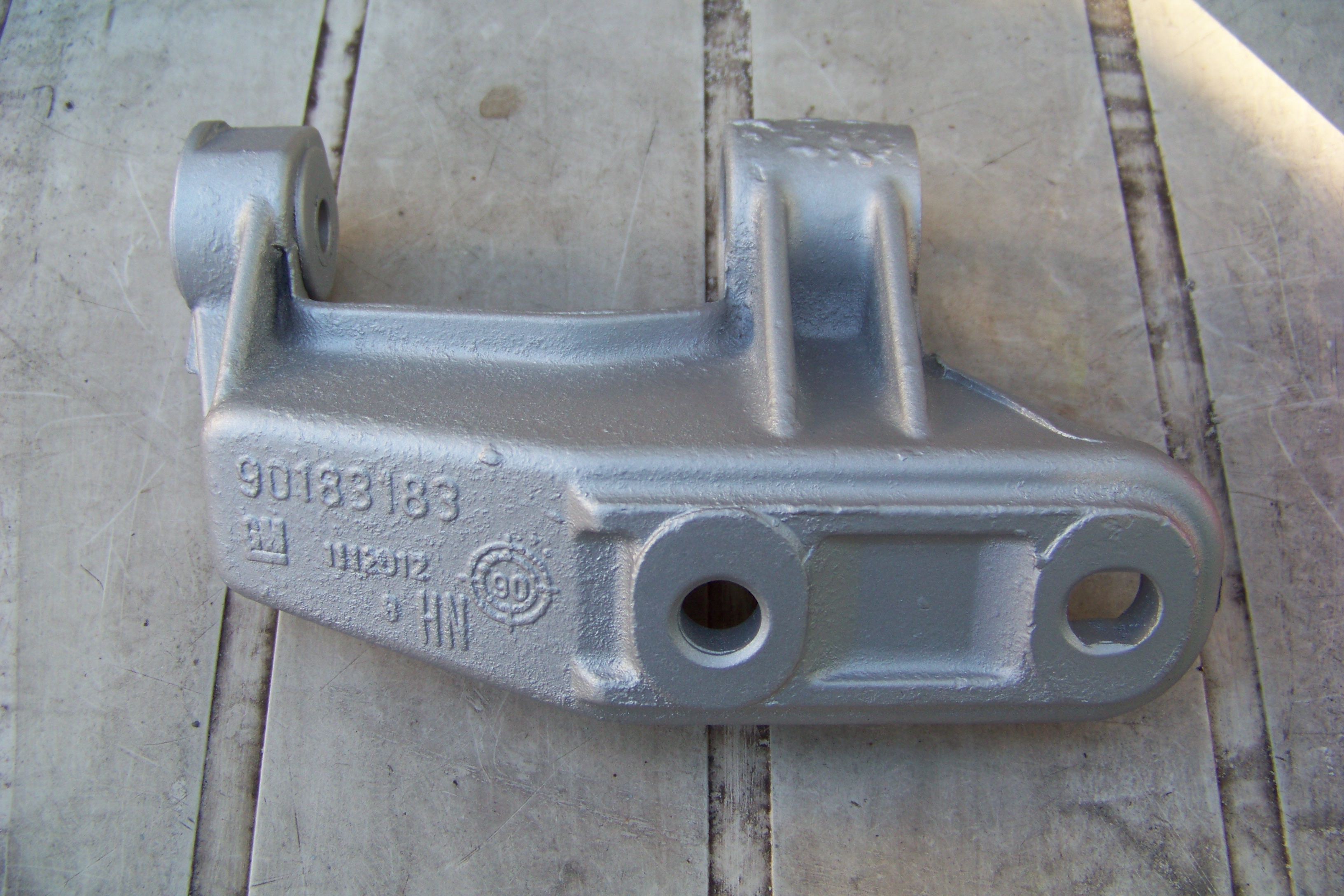

Todays task was to clean what I could... I started with this
https://images2.imgbox.com/c8/8a/tJ4kjyfi_o.jpg
https://images2.imgbox.com/0e/ea/hBwei5Gd_o.jpg
It doesn't look 'bad' but it was shockingly dirty. Took a whole loads of detergent, a couple scouring pads and lots of water to get half the mess off. Once off a good going over with 400 wet and dry got it to this stage:
https://images2.imgbox.com/21/c6/Egj0Pwkh_o.jpg
https://images2.imgbox.com/9a/99/BbdIgaSV_o.jpg

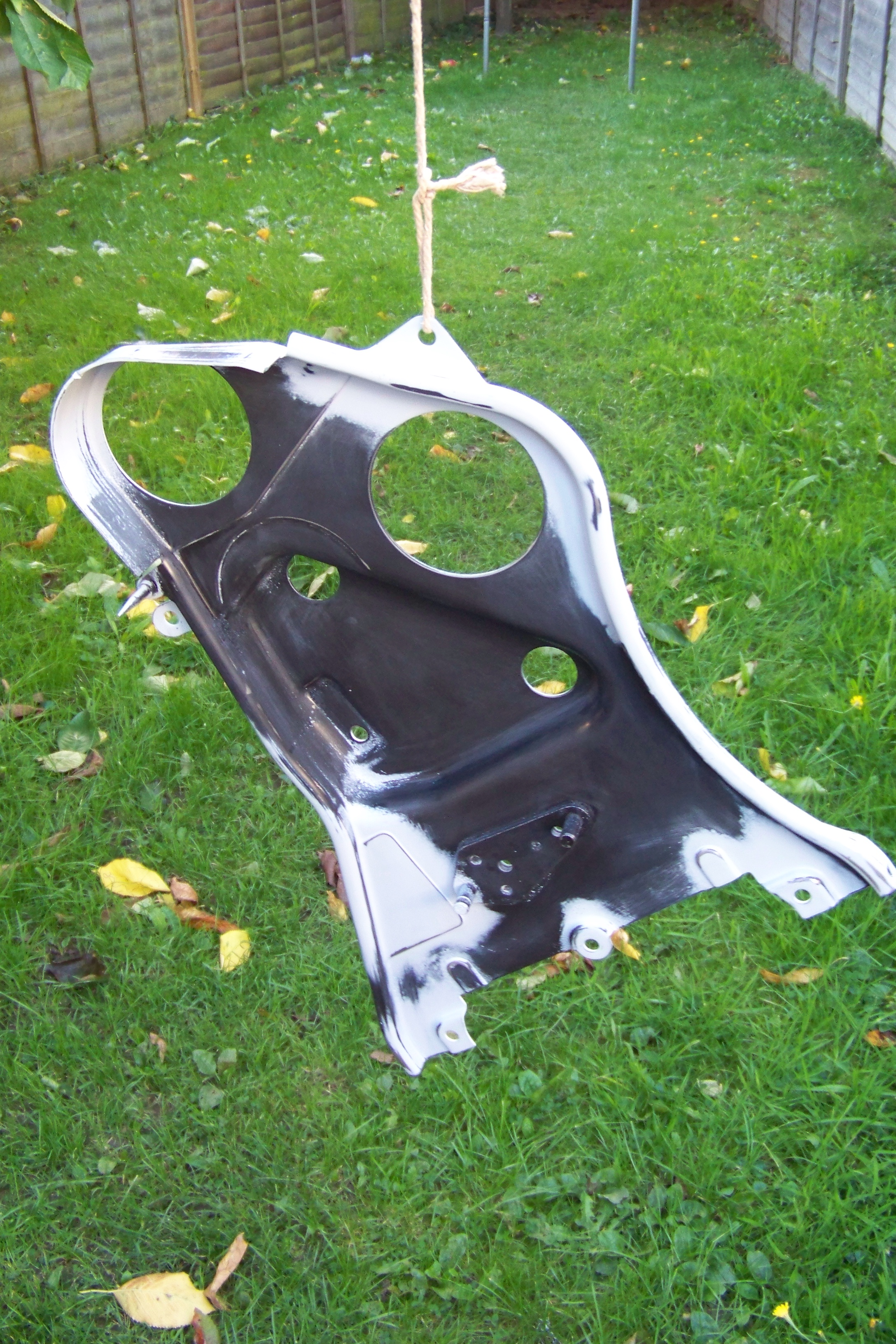

Luckily, I found enough etch primer to be able to give the bare metal areas a decent coat... so that was up next. A bit tricky spraying as there were really heavy winds about. I left it to dry for a few hours:
https://images2.imgbox.com/51/e2/KHnvqX6V_o.jpg
https://images2.imgbox.com/5e/38/Qaz5PnGc_o.jpg
When dry, a good going over was needed with 1200 wet and dry (I'd normally use 800 but as there was none left 1200 was the next best). A good while later I got it to the paint stage.
https://images2.imgbox.com/0d/ed/ppB82Z8n_o.jpg
https://images2.imgbox.com/36/9d/cWpHAORW_o.jpg

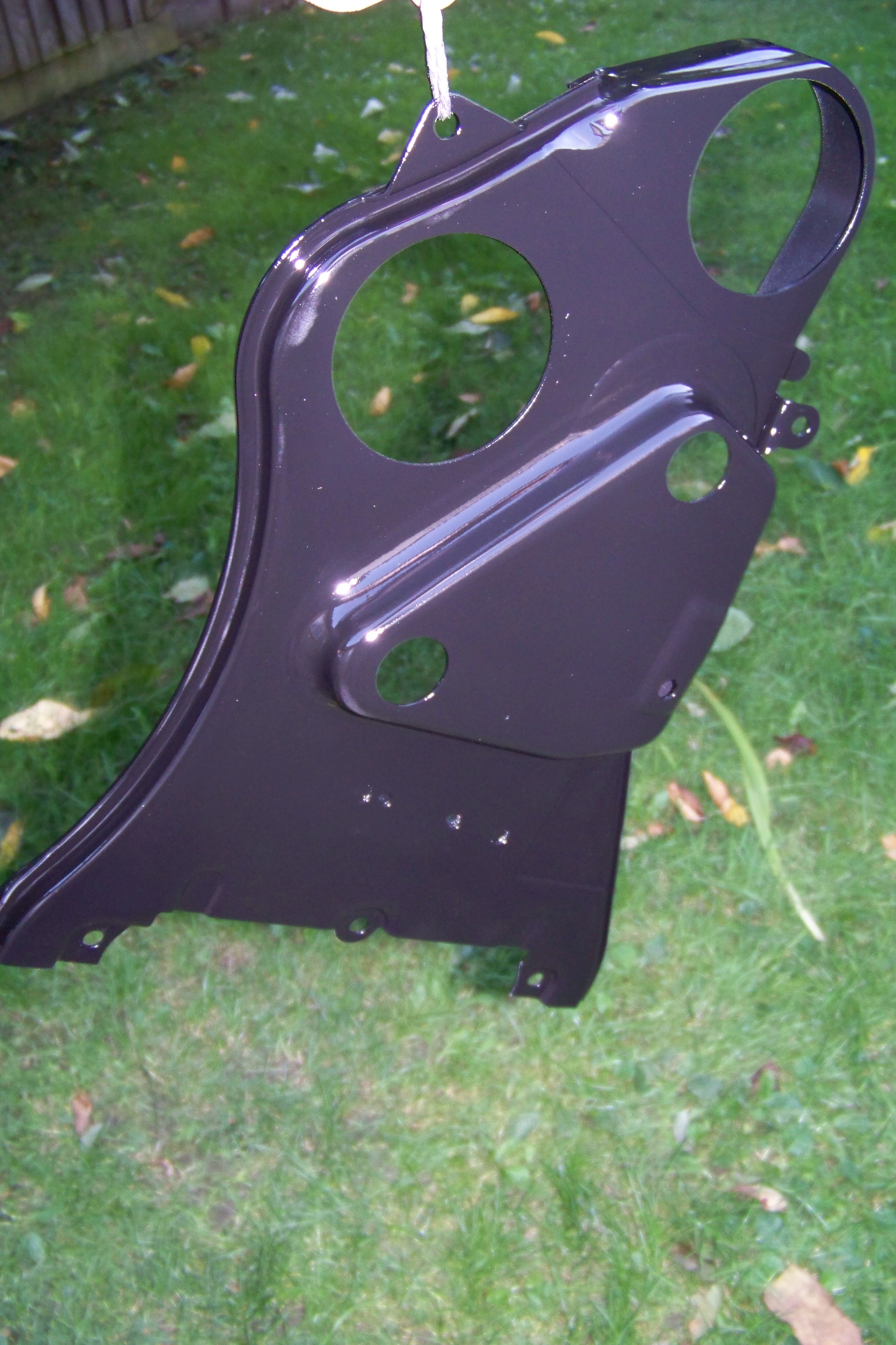

At this point I was really contemplating whether to paint or not as it was still really blustery and the backing plate would just spin and bounce in the wind. I thought 'what the hell' and gave it as many coats of satin black possible with the amount of paint left in the can. Considering the conditions, it came out like this:
https://images2.imgbox.com/47/0b/RbHSr7I1_o.jpg
https://images2.imgbox.com/ca/27/3lEroO6B_o.jpg
Not bad eh?

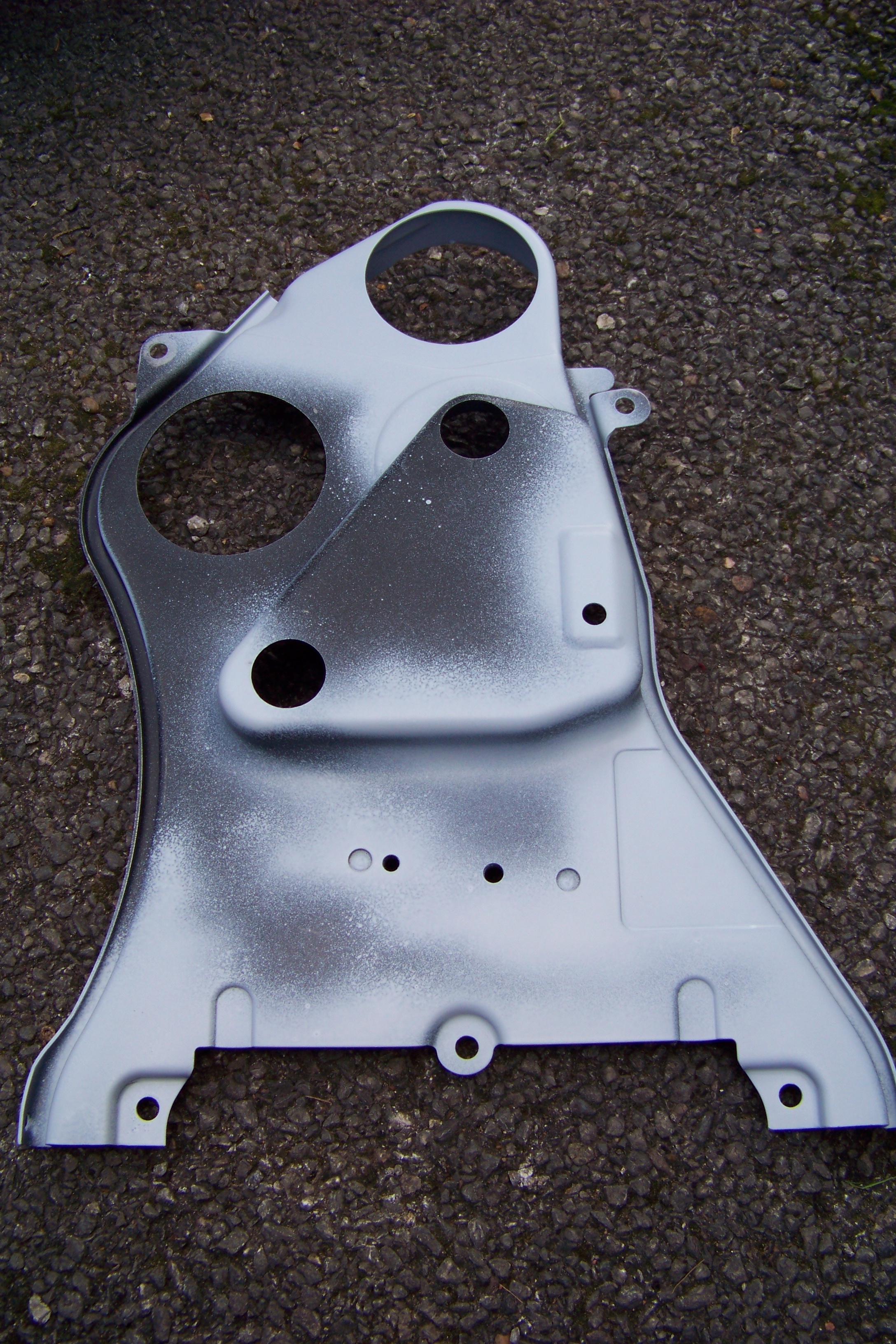

Let it dry slightly and then decided to give the back half of the plate a coat of oil/fuel resistant lacquer. The front face didn't need it as it would be protected by the cambelt cover.
https://images2.imgbox.com/2c/fa/HkG9f0IM_o.jpg
Let that properly dry in the garage overnight. Should come out a treat tomorrow. If the dry weather holds out, more cleaning tomorrow is on the agenda.
UPDATE

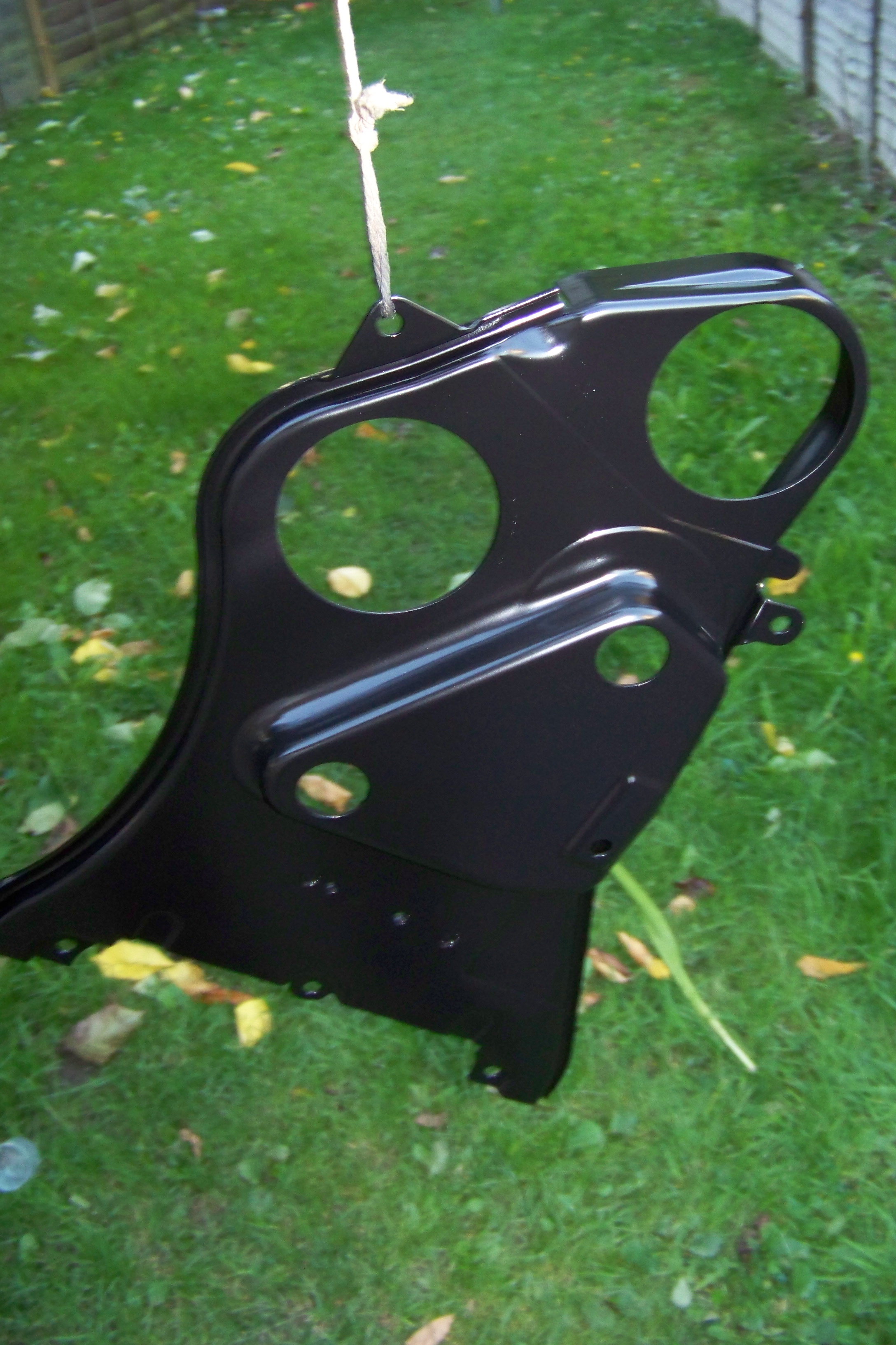

After leaving the cambelt back plate in the garage overnight, the lacquer hardened nicely and looks tons better.

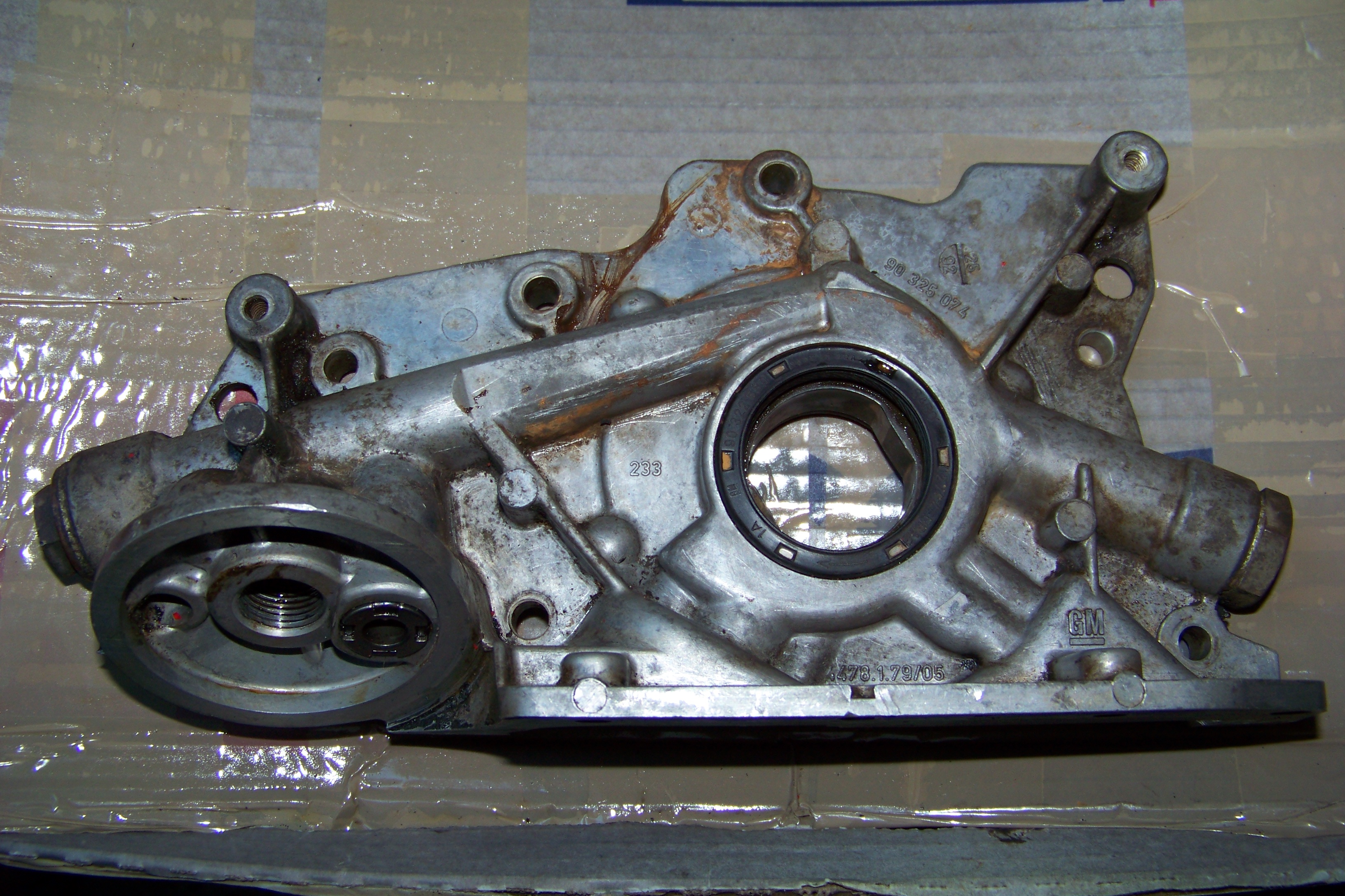

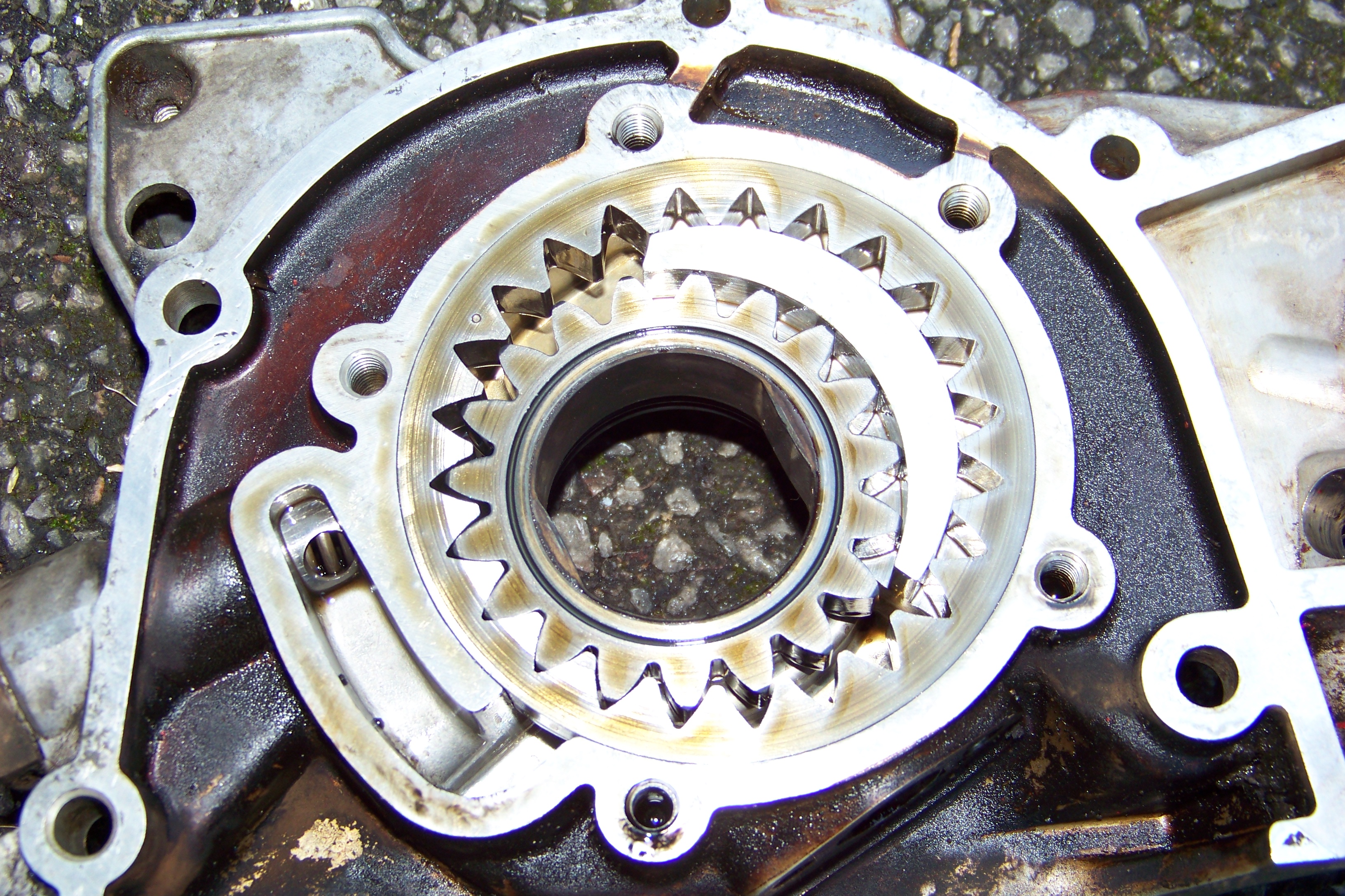

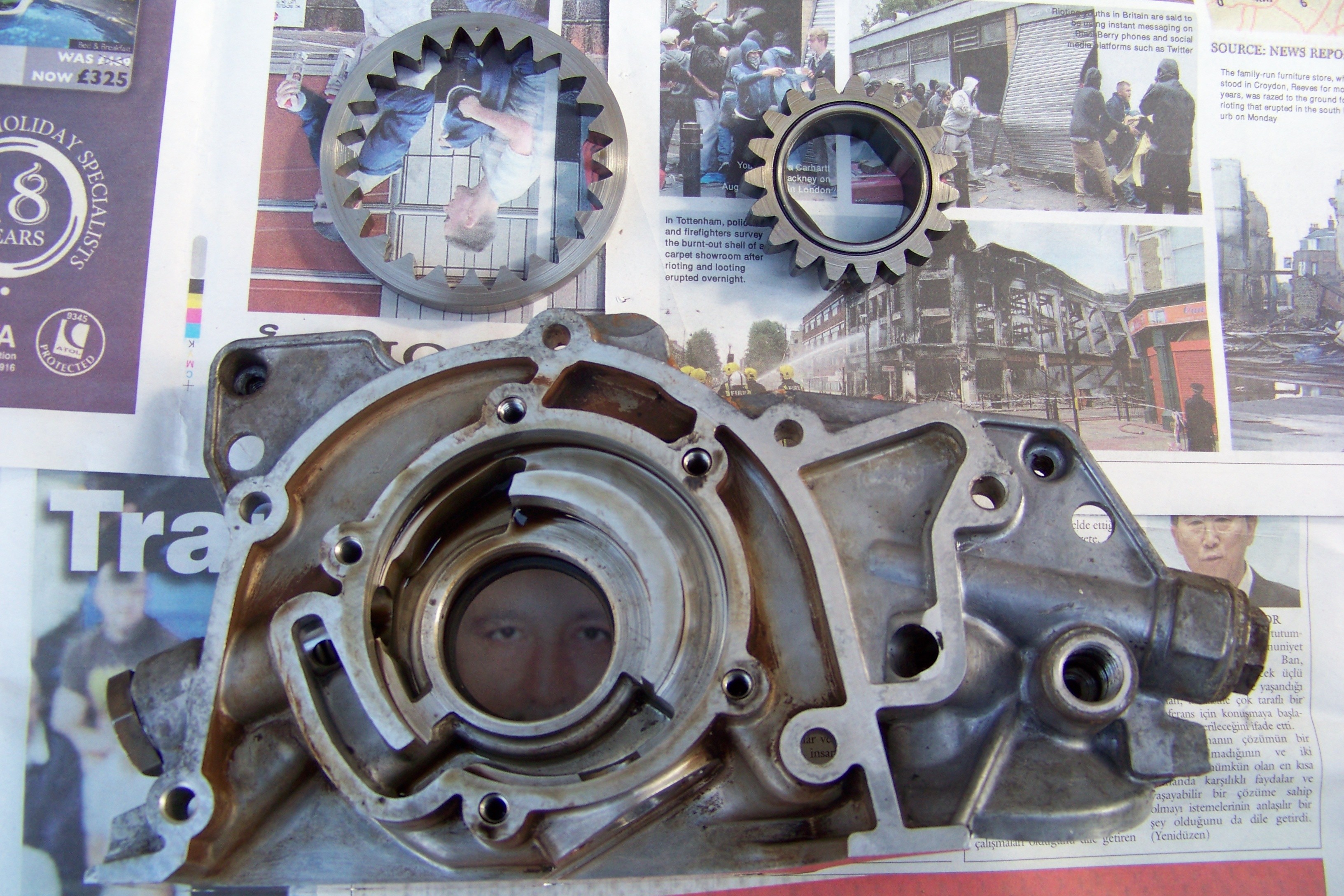

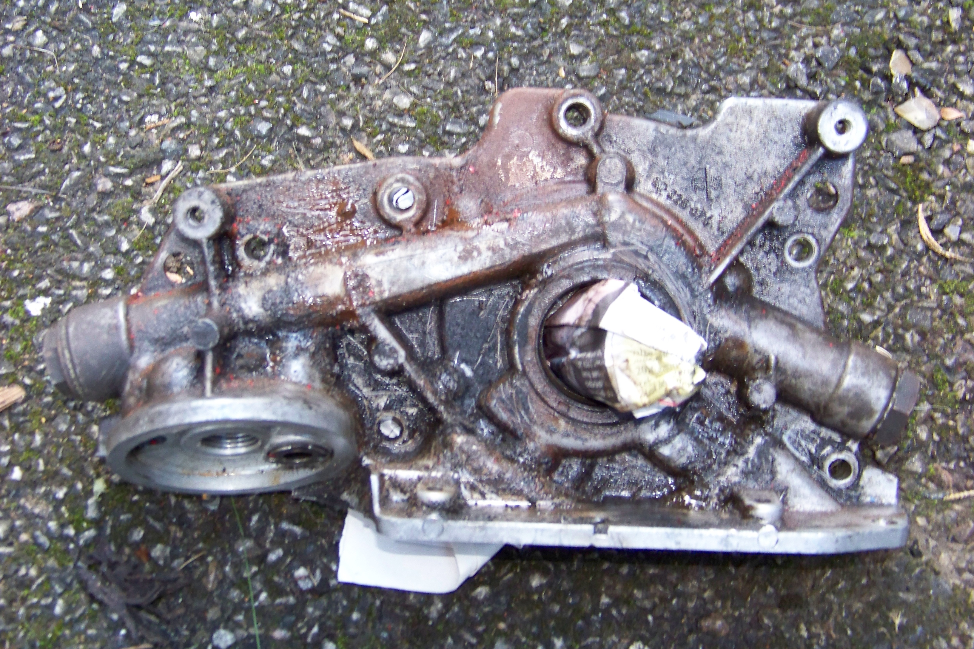

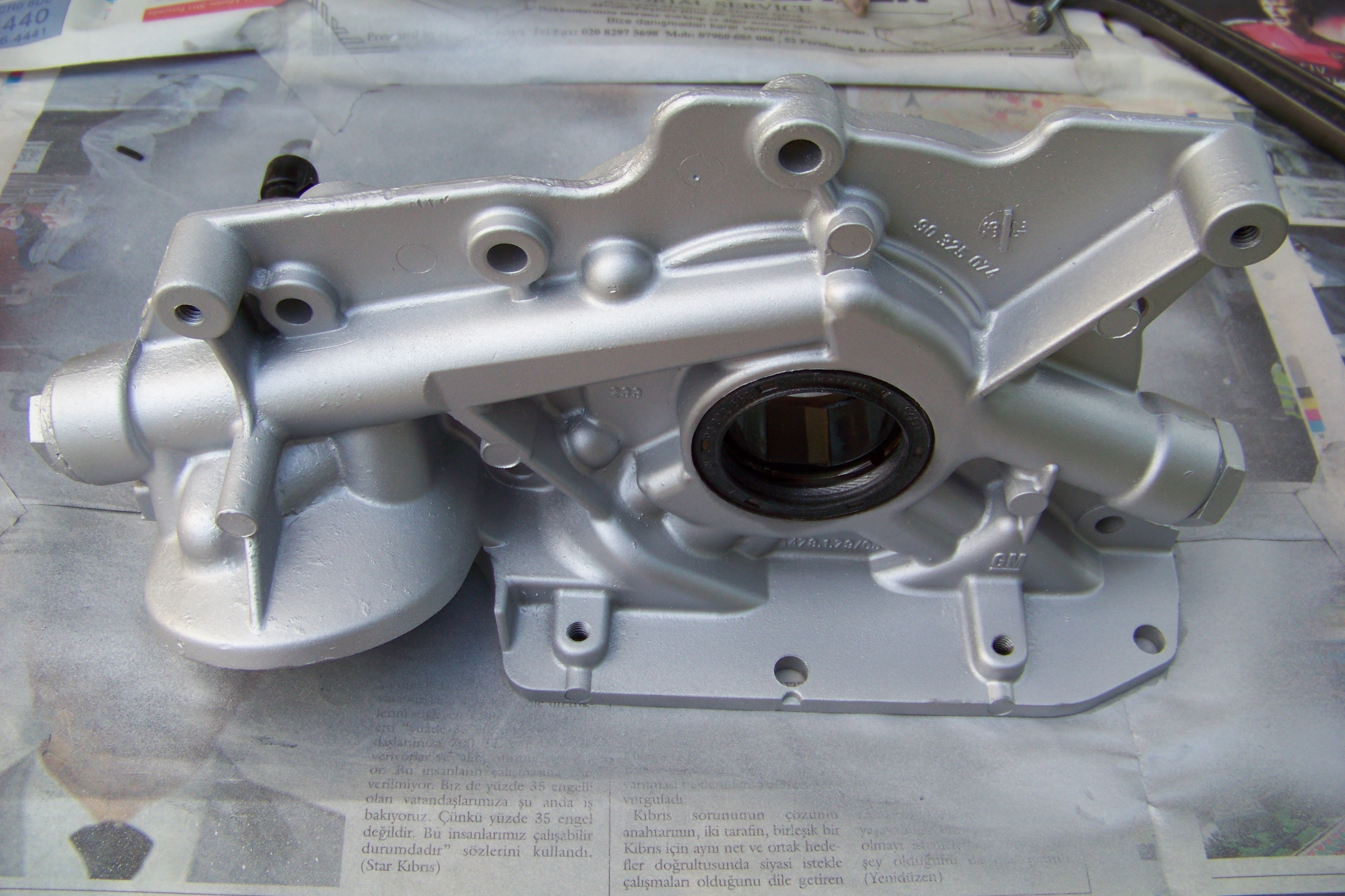

Next up was the oil pump. I know that there is a bit of debate over the oil pump normally whether to change it completely for a zLET pump with modified pick up pipe, or to go for SBD gears in standard cLET housing etc. Then again some people swear by just giving the thing a good clean making sure the gears aren't shagged.
Heard of relief valves getting stuck open... what would the causes be and is there anyway to tell if the valve is past it on inspection?
I'm currently going for the later option if the gears are not worn. So my first task was to clean the sh*t out of it as it looked like this
https://images2.imgbox.com/95/4f/HBahflYw_o.jpg
The usual load of elbow grease, carb cleaner/degreaser, tooth brush etc got it to this point (needs a bit more cleaning but I ran out of degreaser)
https://images2.imgbox.com/56/44/pAkdbHHC_o.jpg
Will continue cleaning it up tomorrow once I get some more degreaser. Once totally cleaned it'll get a coat of aluminium paint to match the rest of the engine bits. I cracked open the backing plate to check out the gears
https://images2.imgbox.com/bb/bc/EIoWWw7j_o.jpg
https://images2.imgbox.com/ee/89/A6DpALBW_o.jpg
Looks like it had fresh oil before it went off the road. Need to go over it with a feeler blade but it looks fine with the naked eye. If it does prove to be perfectly fine, I'll be renewing the seal and giving everything a good flush and clean before it goes back on as you can feel dirt particles when turning the pump by hand.

UPDATE

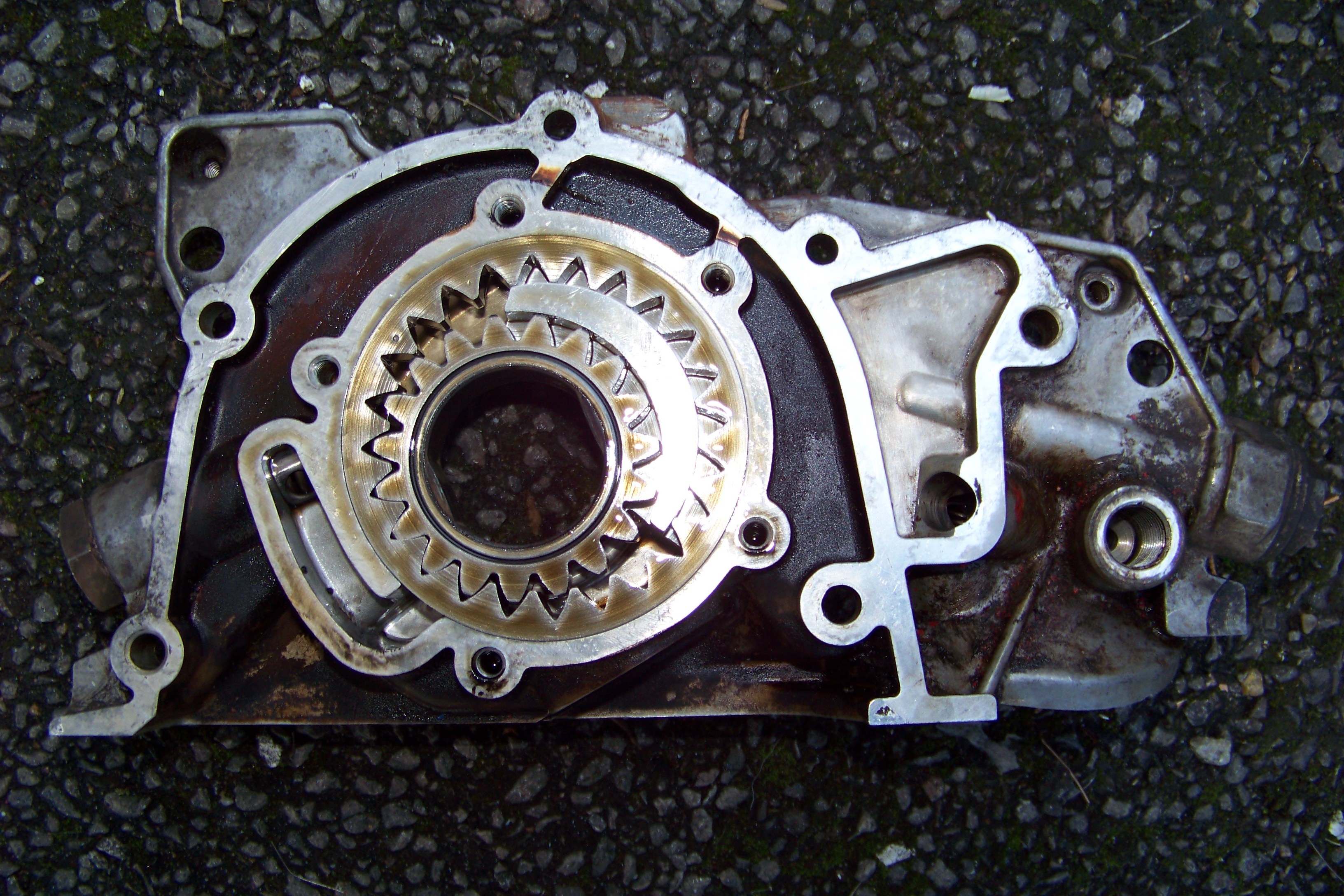

After picking up some more cleaning products, I continued where I left off with the oil pump. I wasn't ecstatic with the outcome of the clean up I did yesterday as there was still a bit more filth in places. As I picked up some carb cleaner and Swarfega Jizer (thought it said Jizzer lol ) I thought I'd give the Jizer a go. Gotta say that it does shift crap real nicely. Very impressed... it is now on my list of useful products.
https://images2.imgbox.com/af/2f/eNZ1AlUk_o.jpg
Here's the outcome
https://images2.imgbox.com/5f/8a/VqePNKF3_o.jpg

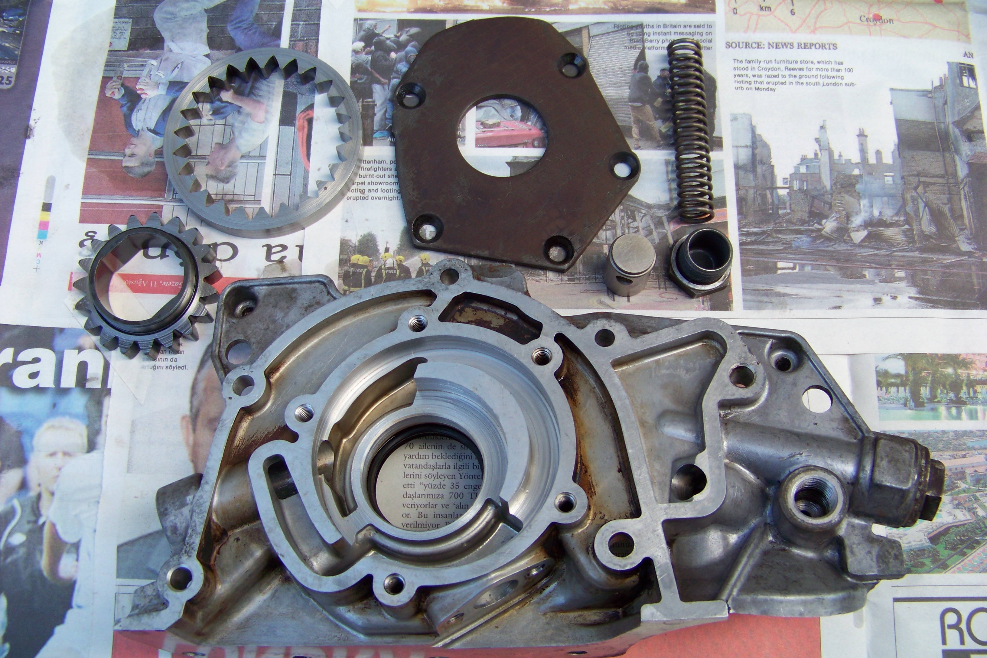

I then cracked open the cover plate again to expose the gears for a clean up
https://images2.imgbox.com/3f/fe/ayJLwRTZ_o.jpg
https://images2.imgbox.com/a8/7b/BJgz2Coq_o.jpg
A good going over with plenty of carb cleaner got all the bits looking like this
https://images2.imgbox.com/c3/e4/JbGcW3ol_o.jpg

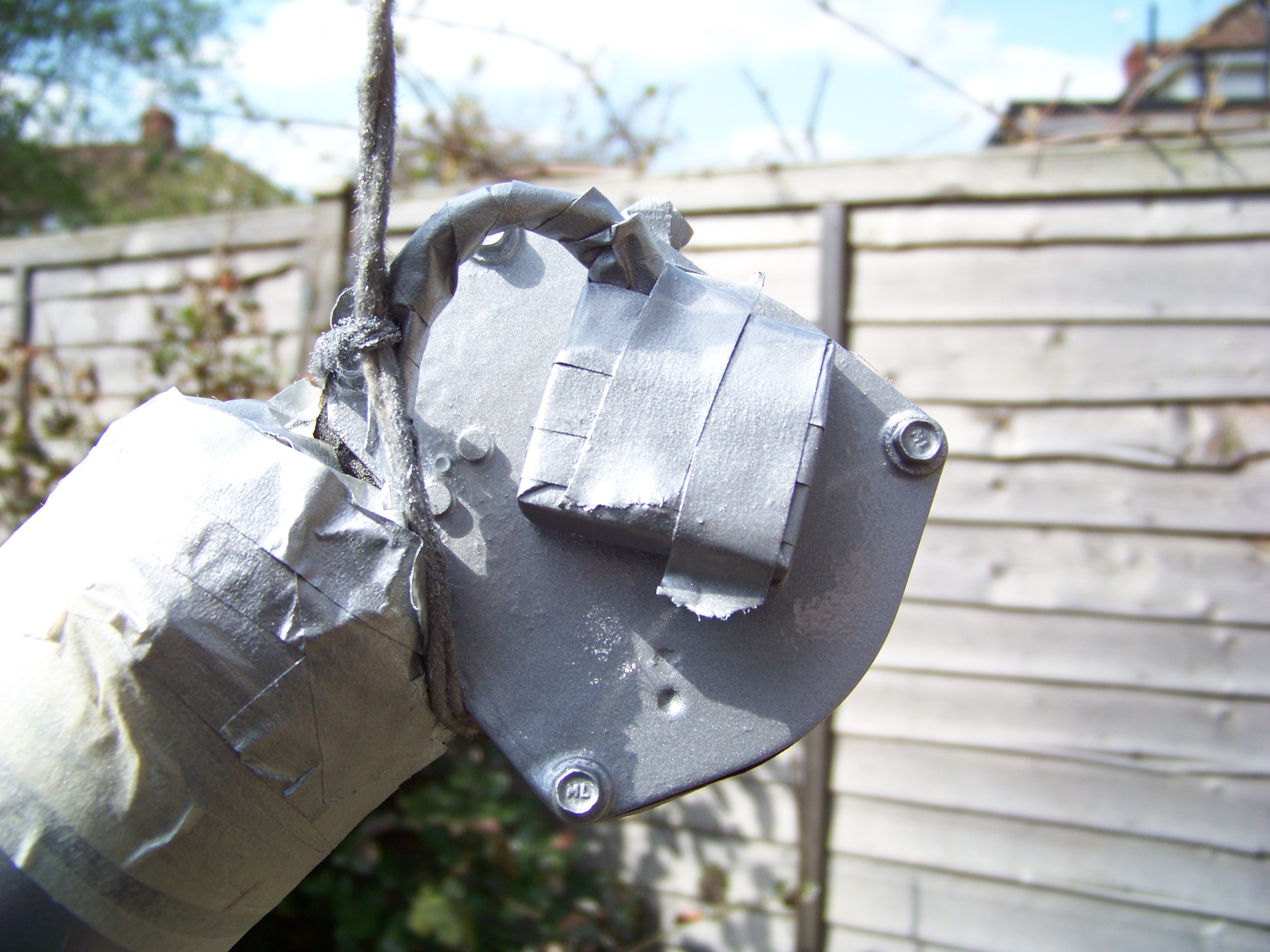

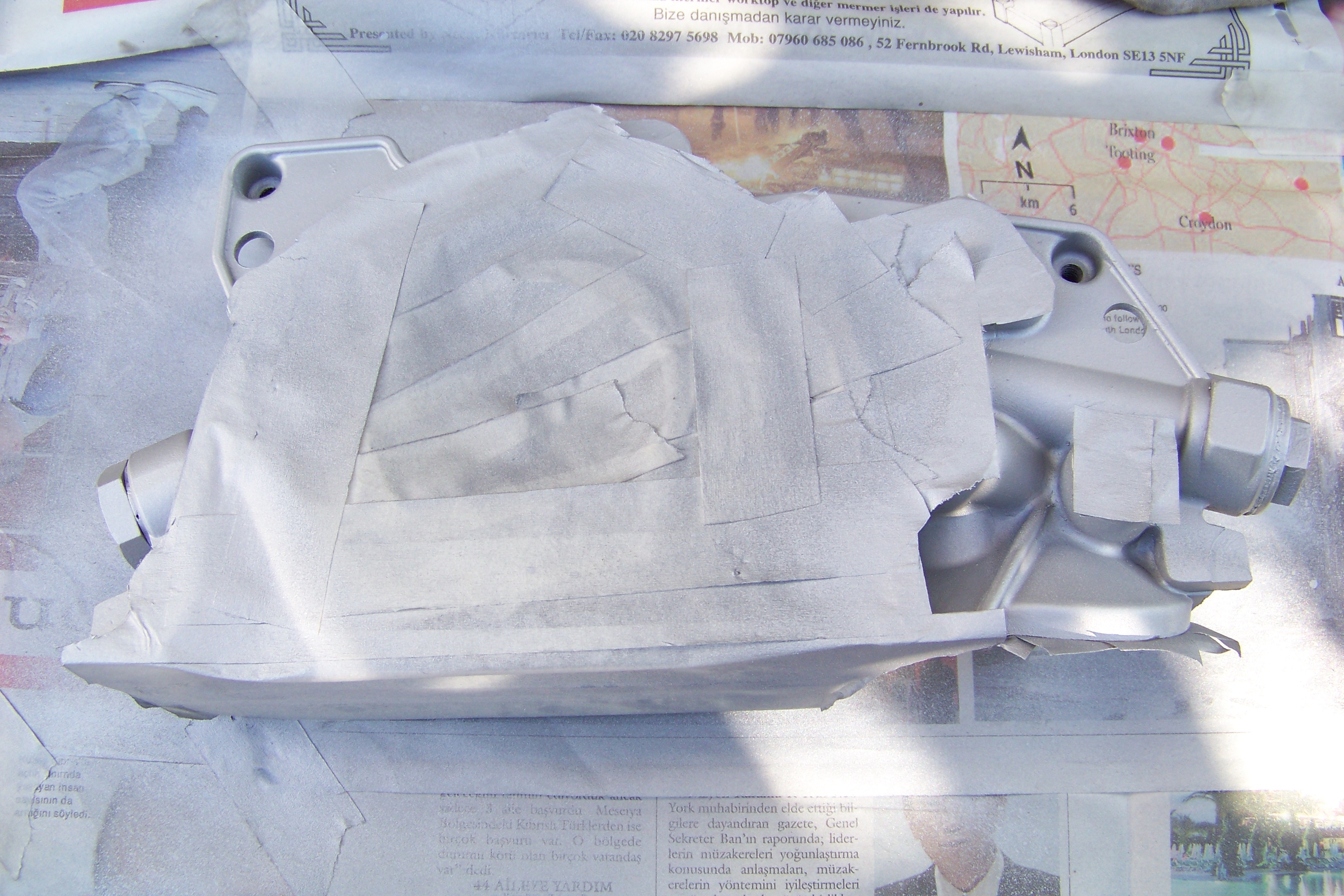

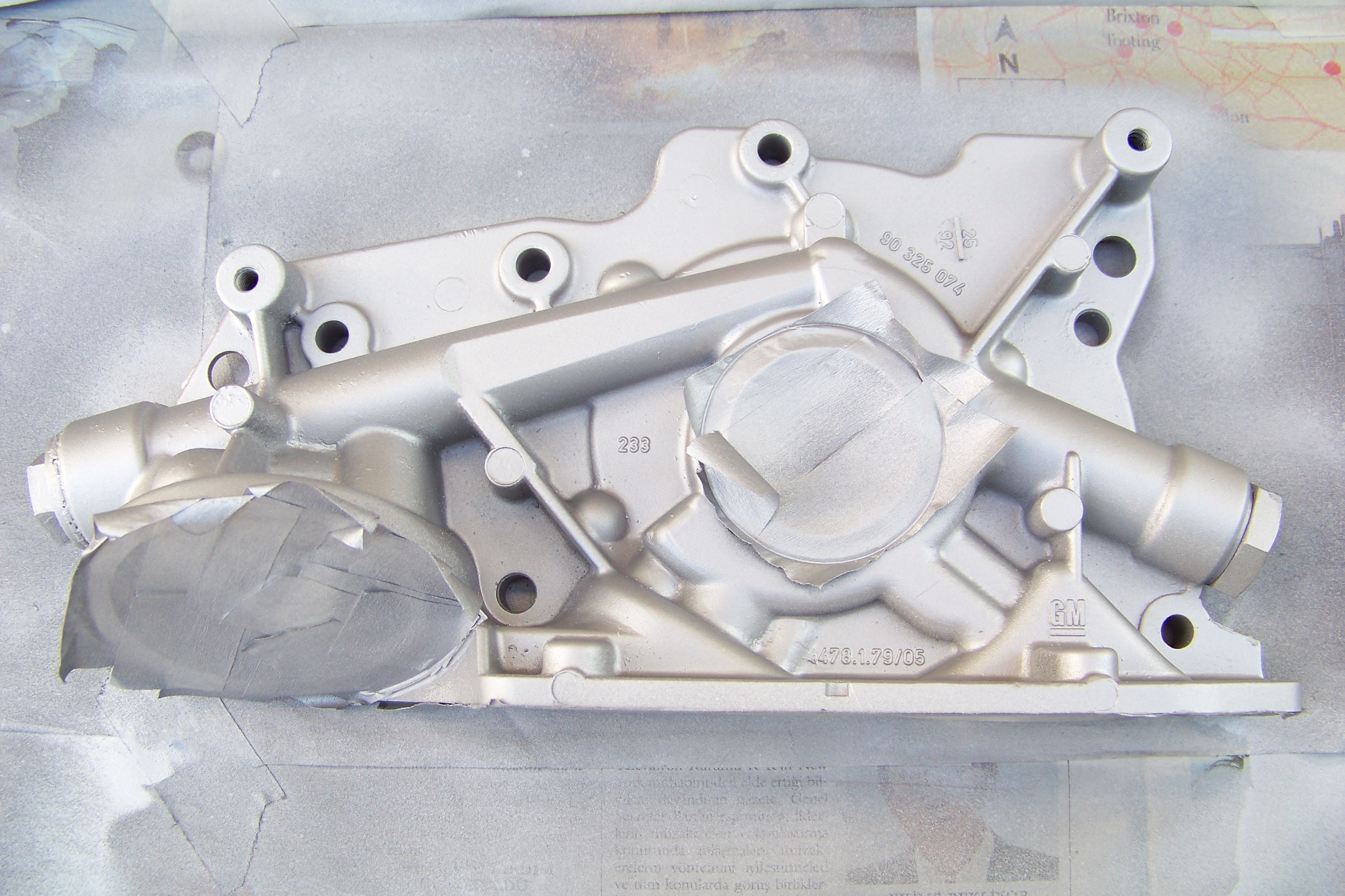

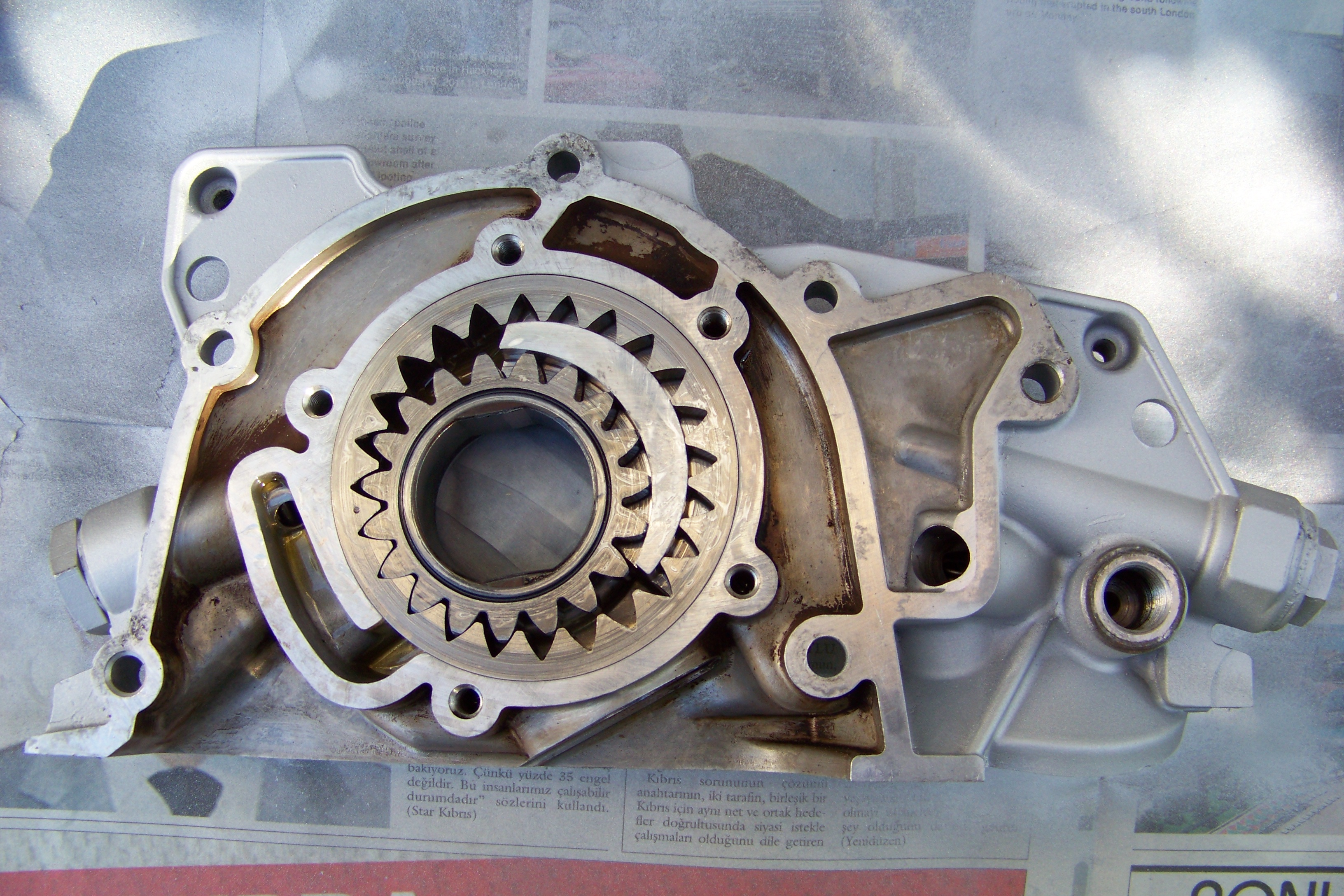

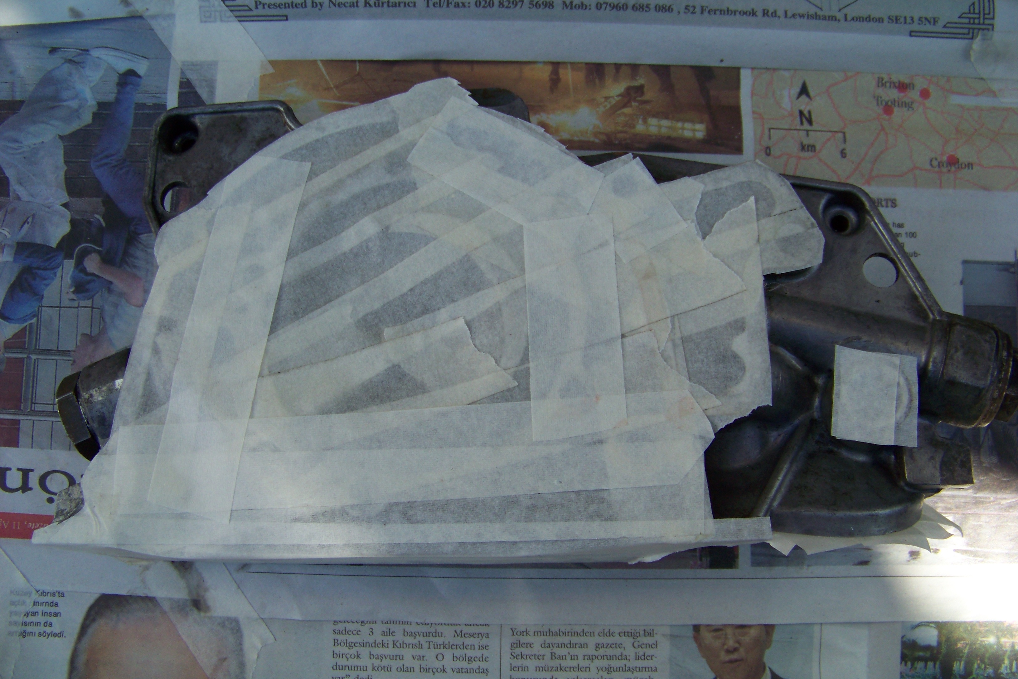

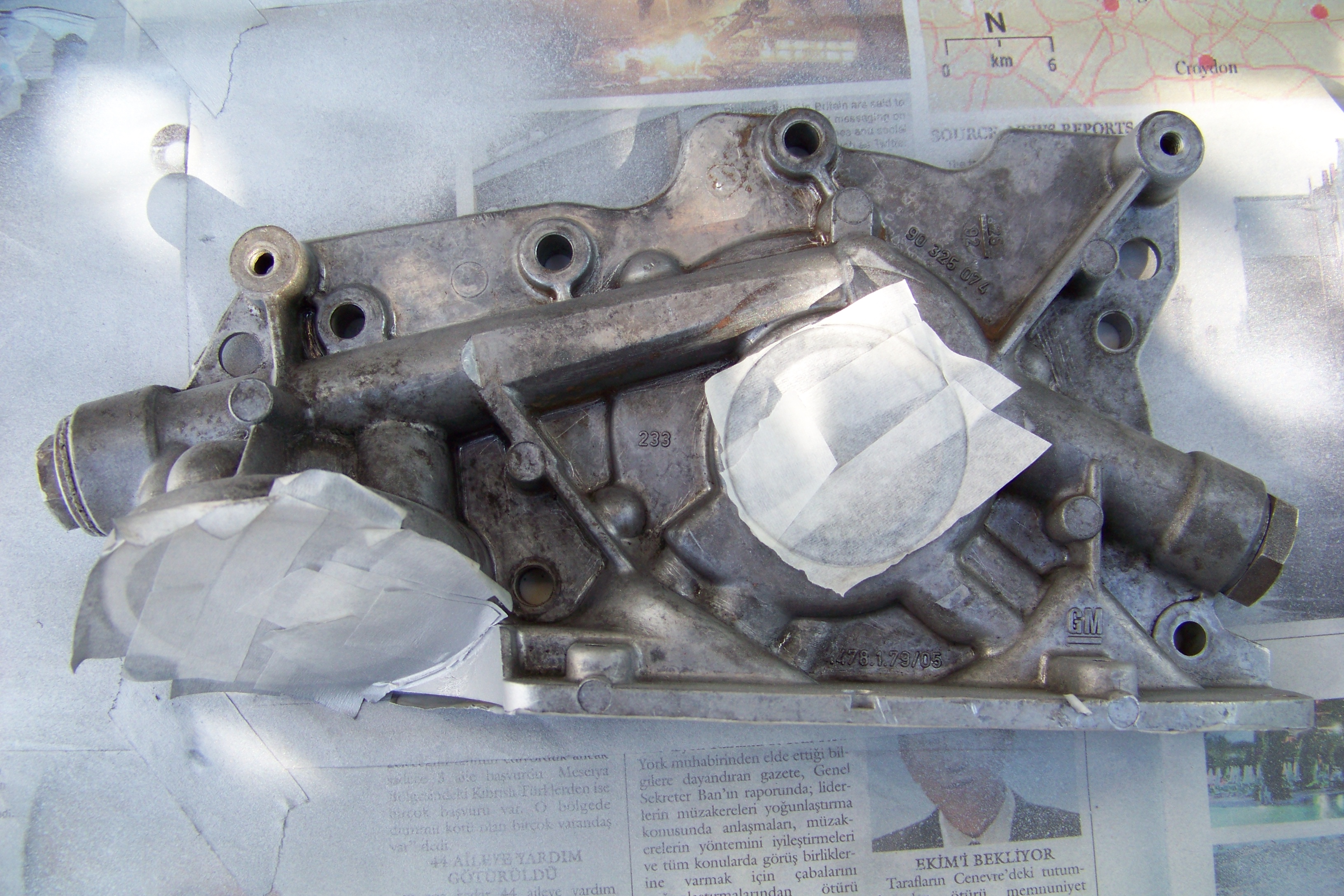

Then came the fun bit of masking up bits so I could give the pump a lick of paint
https://images2.imgbox.com/79/41/LUehPAif_o.jpg
https://images2.imgbox.com/9f/8d/hIMNYB9G_o.jpg
First gave the back side a few coats...
https://images2.imgbox.com/9f/76/DABHG34q_o.jpg
Let it become touch dry, then did the front...
https://images2.imgbox.com/39/06/07txMYOQ_o.jpg
Re-assembled the pump internals
https://images2.imgbox.com/34/20/rIbPCmNx_o.jpg
Poured a few drops of clean, fresh oil and gave it a few turns by hand. Much better as there was no feeling of hearing dirt getting crushed when turning over like it did before. Closed up the back plate, fetched the oil pressure sender from the garage and fitted that also. End Result
https://images2.imgbox.com/ae/dc/TK1QJOIW_o.jpg
I'll be most likely changing the relief valve as that had some uneven wear by the looks of it. SBD do the Relief valve kit with Nylon valve, spring, nut and washer for £49.95. The Steel inner gear is £130. In terms of parts that need an inspection, clean, rebuild... I think that was the last of them. Just a case of hearing from the engine shop about what sized bearings are needed after the reground and ordering bits to put the LET back together.

The relief valve has deffo concerned me a little Niek, some scoring generally but more so a shiny spot on one side where there looks to be more friction. £50 is no real big deal price wise so worth doing. The gears look ok with even wear. Couldn't find exact wear tolerances to measure with a feeler blade but all teeth seemed to have even wear. Was a bit surprised as to how many few parts there are to an oil pump lol two gears and that's about it :)
The steel gear would be a nice addition but I'd need to find a £130 notes from somewhere.

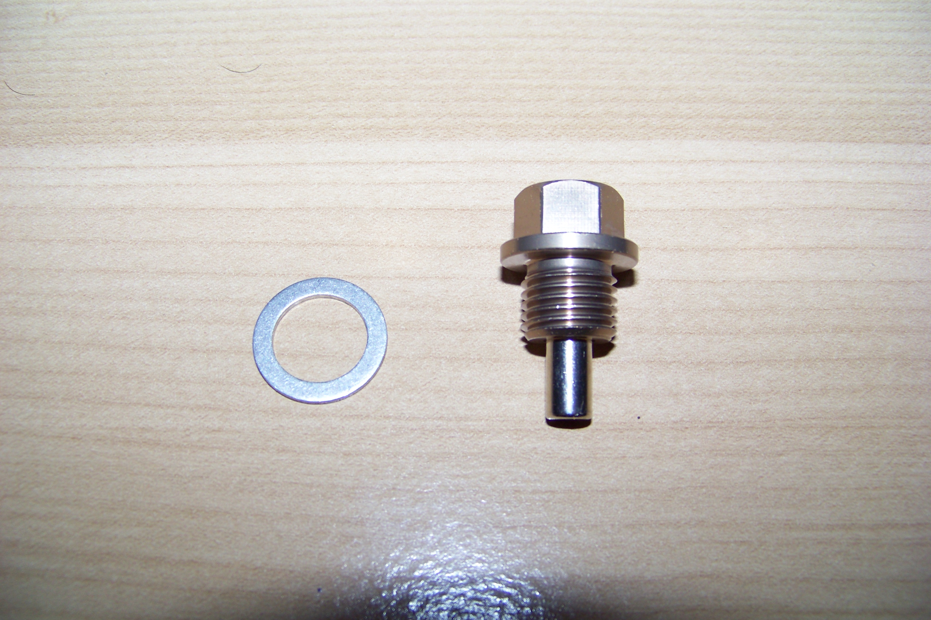

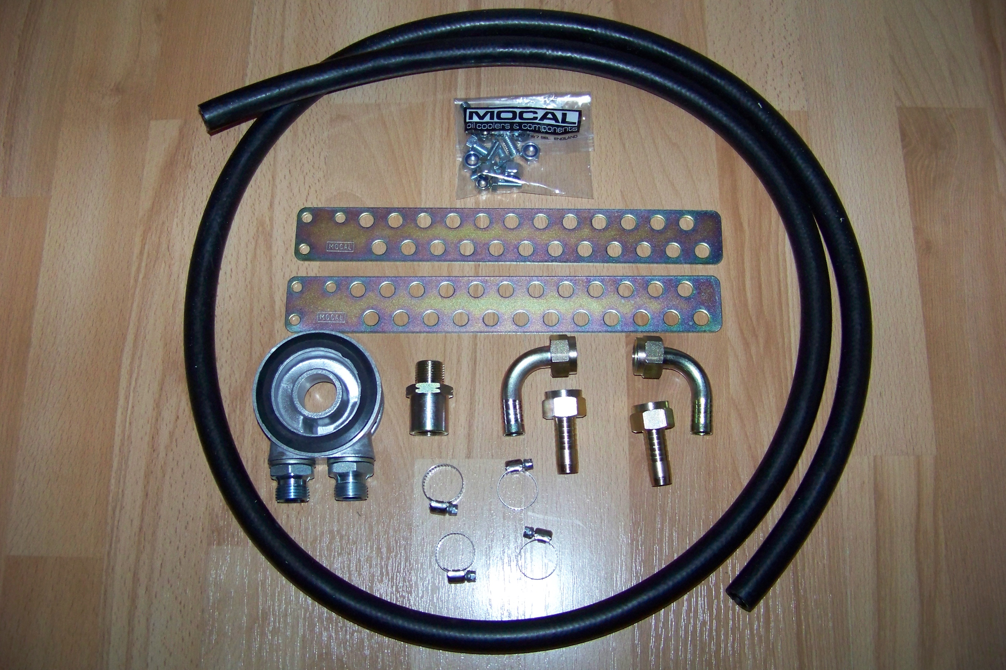

Got a few bits today...
I wasn't going to get this particular part originally as I didn't quite plan going all out and doing a rebuild but seeing as the engine was in the shop getting bits done to it I decided to
TX Autosport Magnetic sump plug (pretty strong magnet)
https://images2.imgbox.com/a5/e7/rfFBMtj5_o.jpg
Also got this a bit later on in the day
https://images2.imgbox.com/94/aa/VzgwWKip_o.jpg
Mocal Universal Oil Cooler kit:
Oil filter sandwich plate M18
Sandwich plate seals
2x 1/2bsp sandwich plate hose fitting
2m of 1/2inch ID high temp/high pressure oil hose
2x 1/2bsp straight union
2x 1/2bsp 90degree union
4x hose clips
Oil cooler mounting brackets and all the nuts/bolts etc
Only problem I seem to be having is finding out what size the inlet/outlet is on the cooler itself. I opted for the smaller 1/2bsp fittings as there was a 5/8bsp kit available also, but the cooler seems to have smaller fitting on them

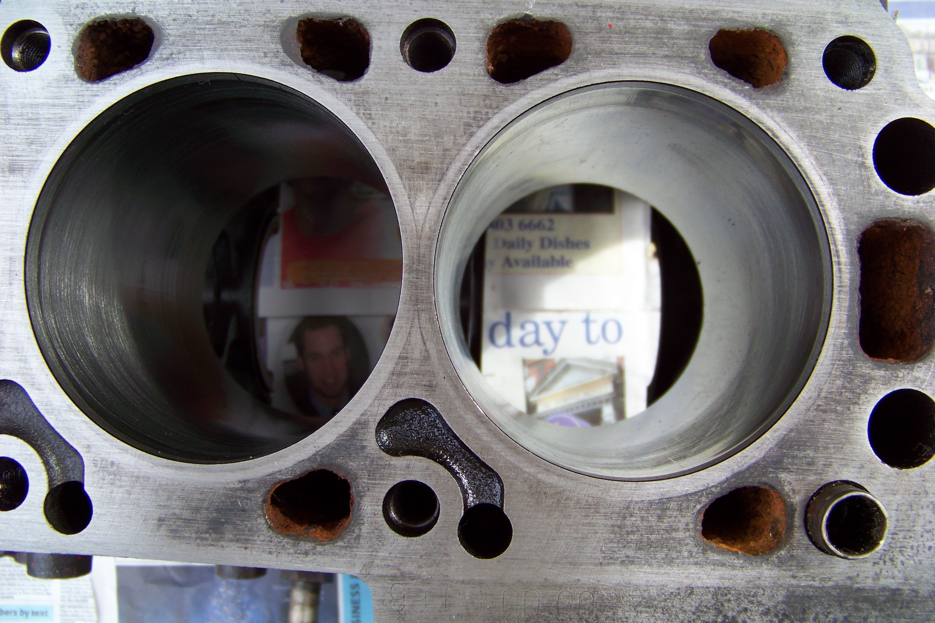

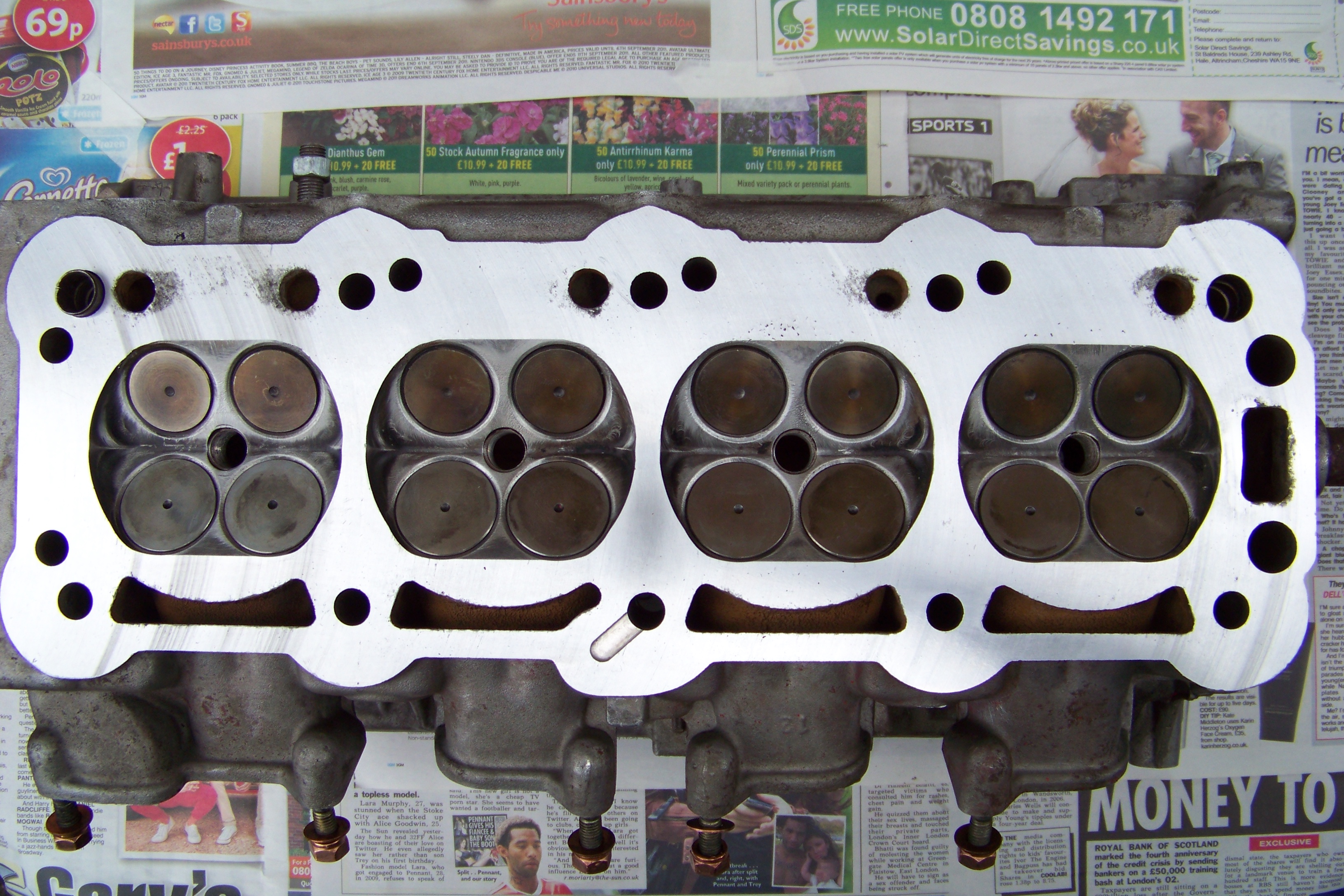

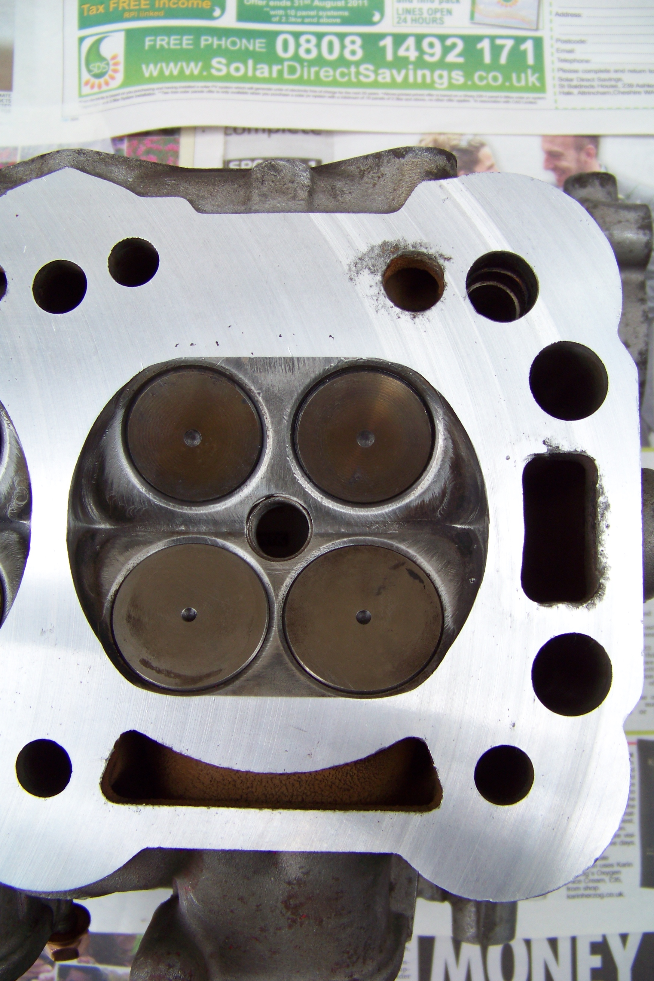

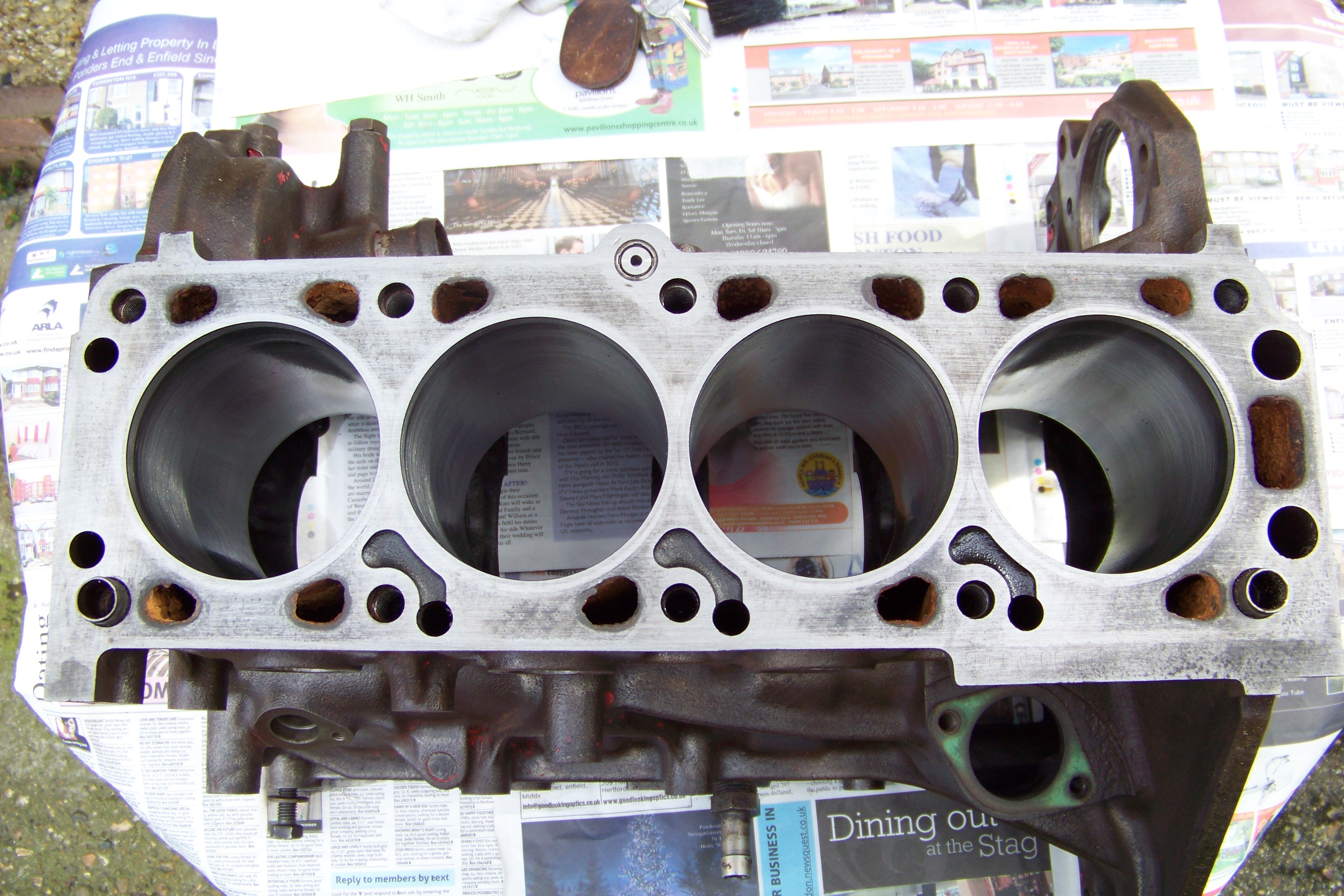

Day off so I headed to the engine shop in the morning to pick up the block, head and crank. All was well, when I noticed that he forgot to remove a snapped bolt from the head. Previous owner must've snapped an inlet stud, tried to get it out but messed it right up! It will be removed and then have a new insert fitted. Will be picking the head up when I'm next off.
In the end the following was done:
- Block flushed
- Honed bores
- Crank re-ground .25 and polished
- Tad bit of weld needed where a waterway had corroded on head
- Head skimmed
- New valve guides
- New valve stems
- Re-lapped valves
- Vacuum tested after valves refitted
- Pistons measured

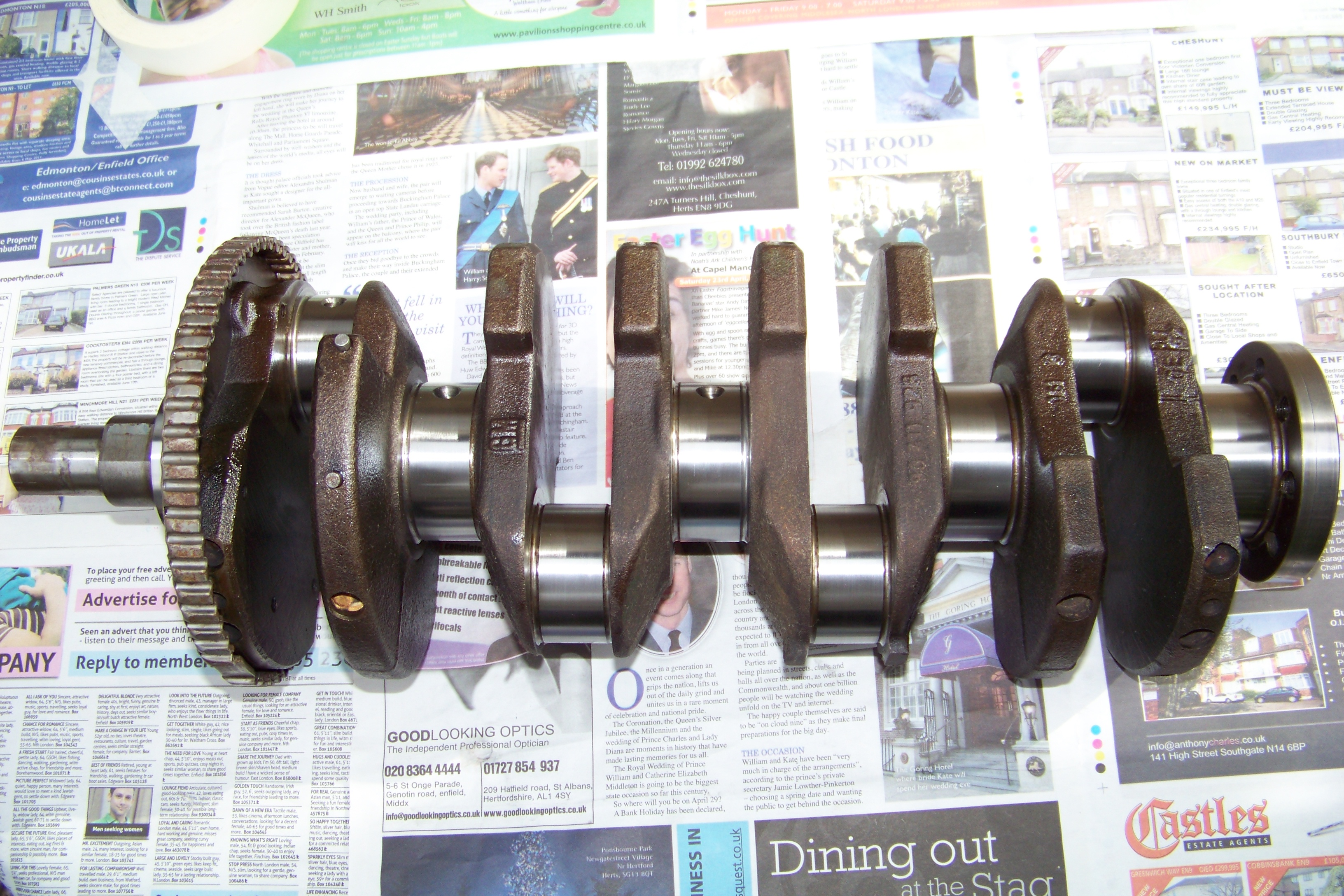

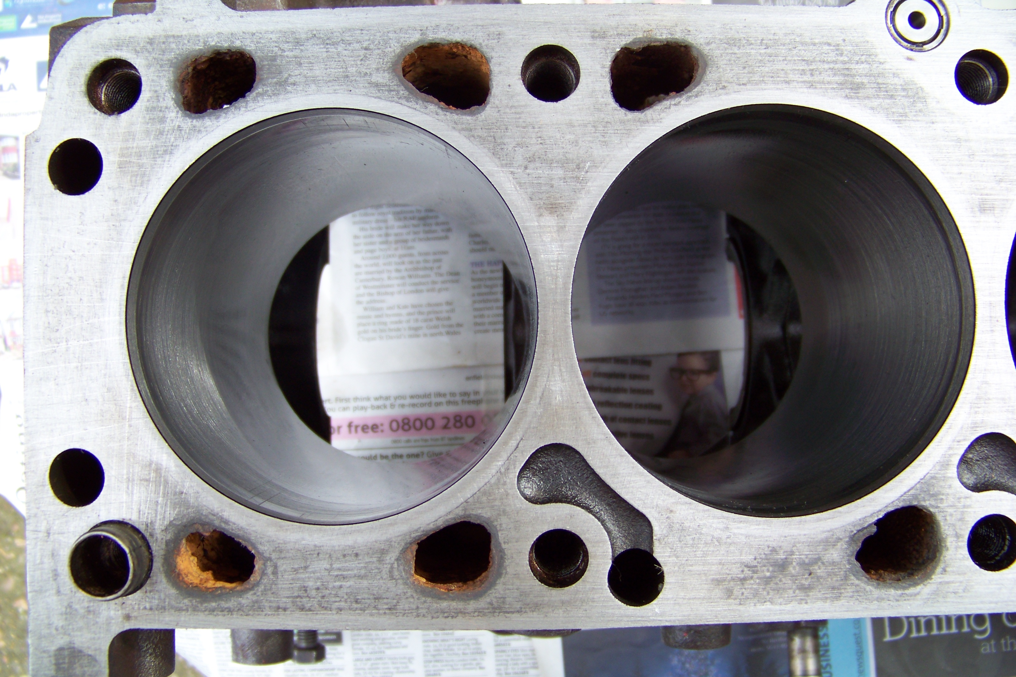

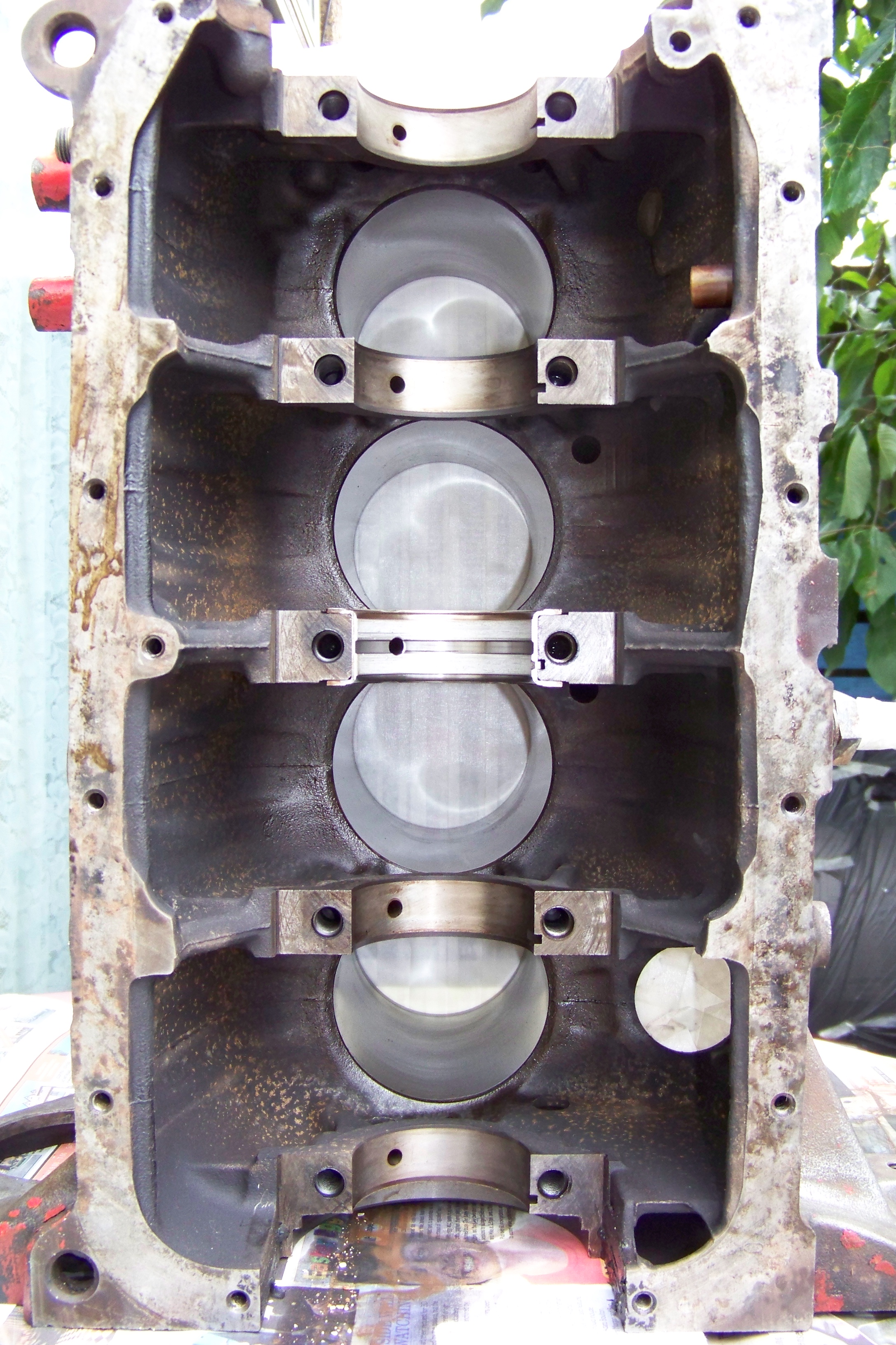

Got the bits home and decided, as the weather was good, to prepare and paint the block.
First up, the crank in it's new condition
https://images2.imgbox.com/b1/6a/6fM5A2uu_o.jpg
And the block
https://images2.imgbox.com/36/aa/6Ja6Csvv_o.jpg
https://images2.imgbox.com/64/50/y287MoiA_o.jpg
https://images2.imgbox.com/11/69/fjduB5LO_o.jpg
All clean on the underside and inside
https://images2.imgbox.com/ce/16/4WSiVzrh_o.jpg
I then set off removing the last bits of old red paint on the block. Had no choice but to use a small wire brush and a flat blade screw driver to chisel off the paint. It took absolute ages but I was finally happy with it. Gave it a cleaning with degreaser (Jizer), wiped it dry and masked places that didn't need painting.
Front of the block
https://images2.imgbox.com/e1/ff/PENmvIoS_o.jpg
The back was just as clean. Now it was time for paint... gave it about 3-4 coats of paint and let it dry
https://images2.imgbox.com/d0/ce/9UAlc1tZ_o.jpg
As it became touch dry, I thought 'now's the chance to weigh the block and see how heavy it is'. Got out the scales and put it on there. I got 35.4 KG's the first go. 'This can't be right' I thought, 'feels heavier than that'. Moved the scales to another flat surface and tried again... 35.4 KG's. So there we have it, unless my scales are totally out, the block weighs that much!
Block is now in the garage to fully dry over night.

Cooler sandwich plate... Don't you want one with a thermostat built in? Or are you going to get an external thermostat?
Yep, can't go wrong for £12
I'll be getting an external stat, think it's best that way. But I'm sure something is missing, as there is no where for the oil filter thread adapter to screw on to (or am I being a tard?)
The real fun begins now :)

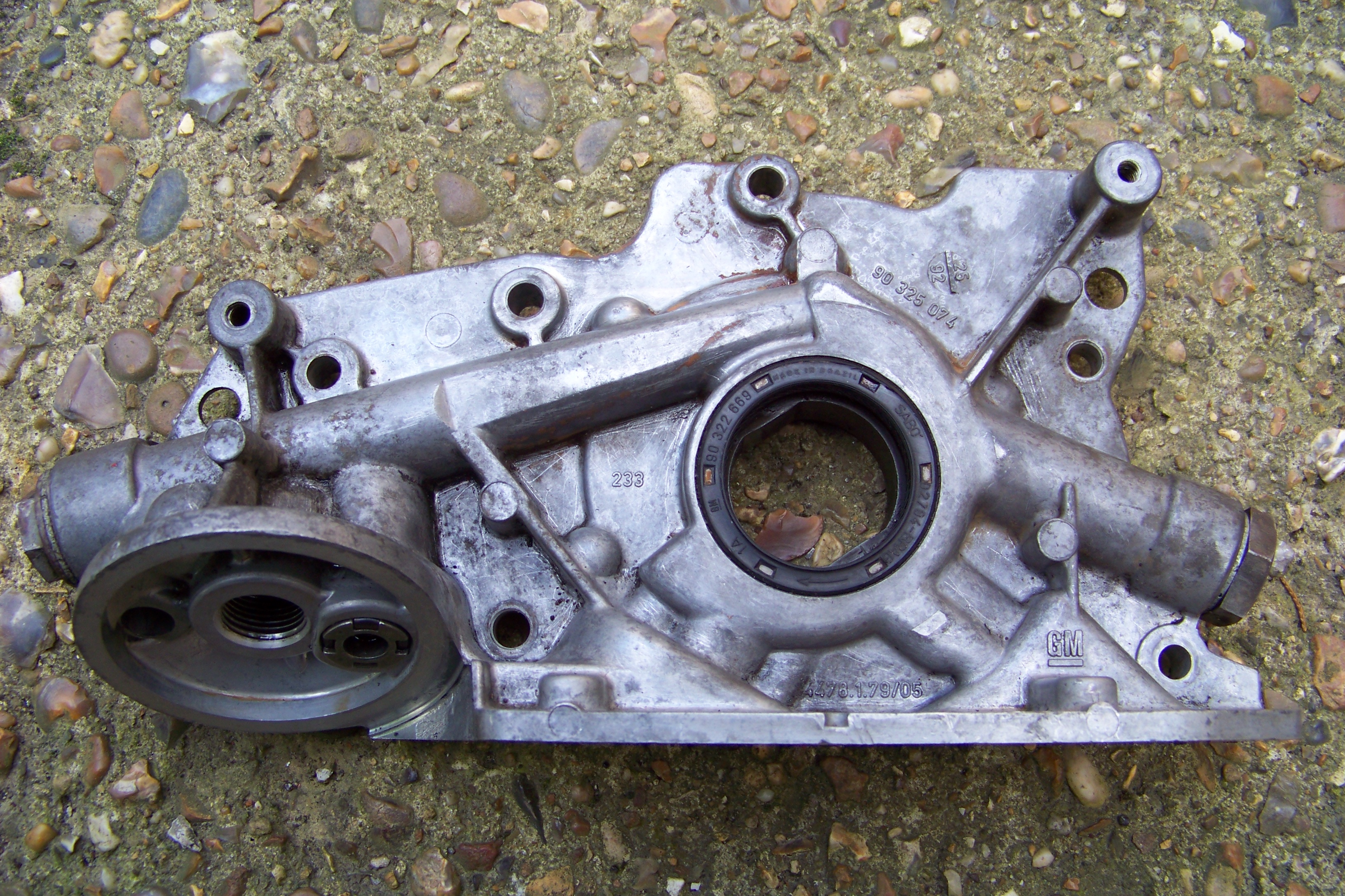

it goes through the sandwich plate and screws into the oil pump.
Im selling that kit with the oil cooler off my project lol
Ok so the big double ended bolt (male/female) seen below next to the sandwich plate
http://img525.imageshack.us/img525/2944/1002741t.jpg
fits through the sandwich plate and screws into the thread seen here in the picture of the pump right?
http://img191.imageshack.us/img191/4301/1002730w.jpg
So there needs to be a male attachment to screw into the female part of the adaptor as the oil filter is female. (Apologies in advanced if I'm missing the point, it's been a long day, I've eaten too much dinner and feel sleepy lol)

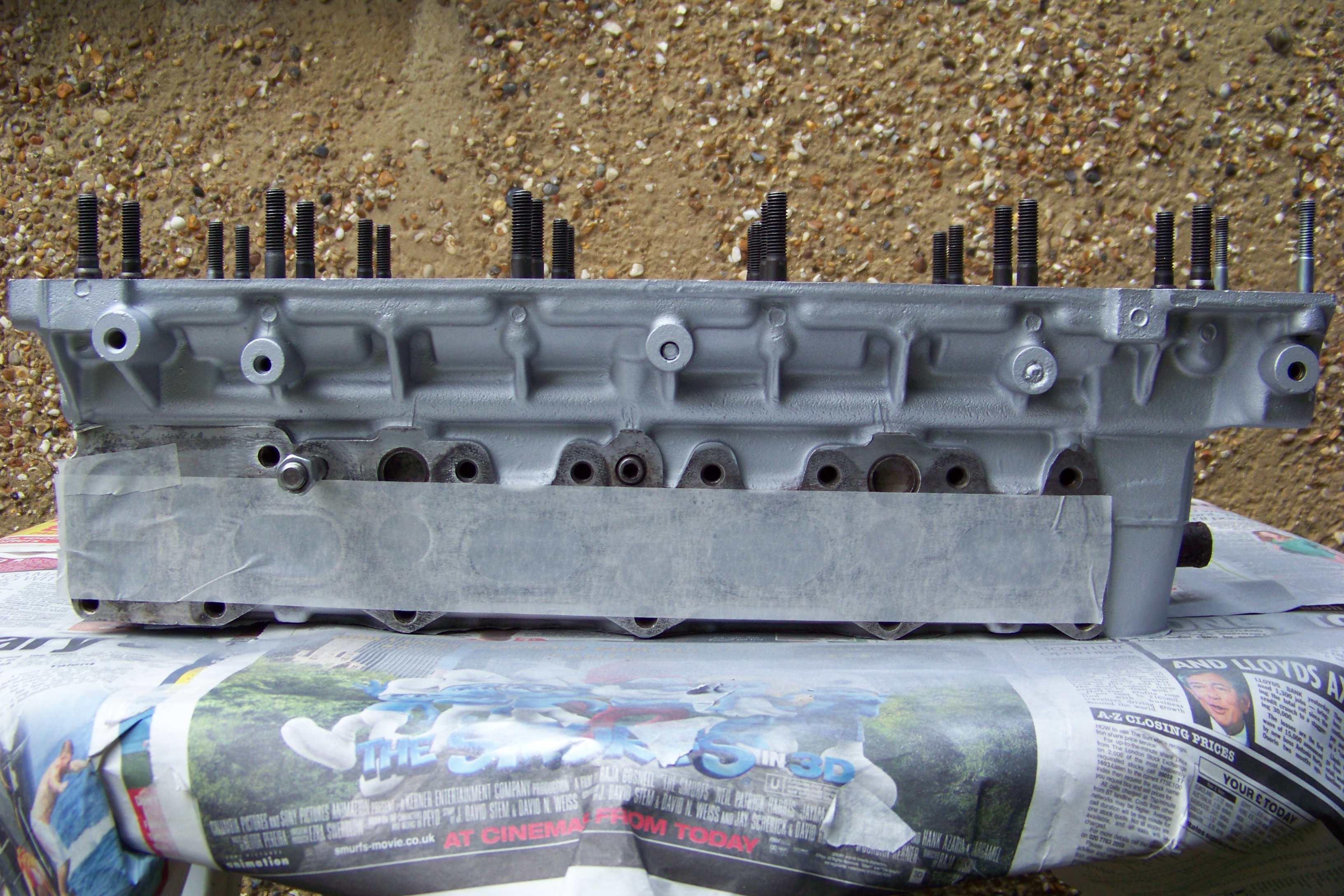

UPDATE
Another day off (why do days off go by so quickly?), weather was a bit rubbish but it was dry for a good few hours giving me the chance to finish off what I was doing the other day. I picked up the head from the engine shop on Friday but was too busy over the weekend to post up any updates. So here it is with, as I mentioned before, skimmed, valves lapped, new valve guides, new stem seals, pressure and vacuum tested.
https://images2.imgbox.com/56/f0/AbBv9F9H_o.jpg
Close up of where it was welded (water way), didn't need much but it did need it
https://images2.imgbox.com/03/fb/wPAyCIyU_o.jpg

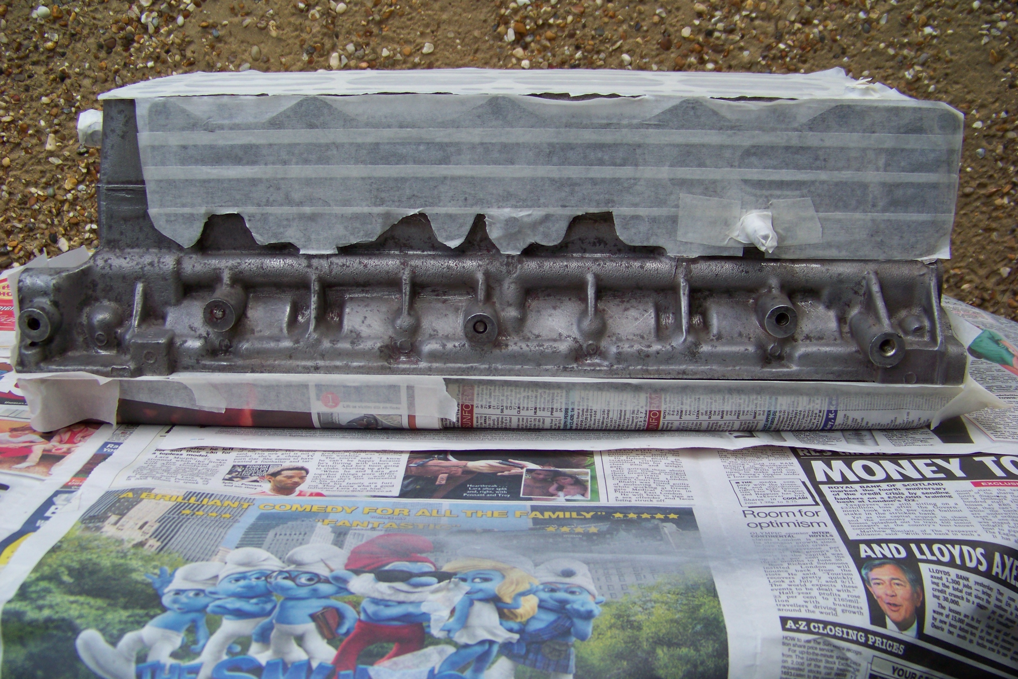

Then came the real fun bit of masking up the head... took, what felt like, hours to do.
https://images2.imgbox.com/d2/ab/KmAs8eDW_o.jpg
I then painted it same colour as the block, finished 3/4 of a can and let it dry.
https://images2.imgbox.com/2a/90/bM6reO0U_o.jpg

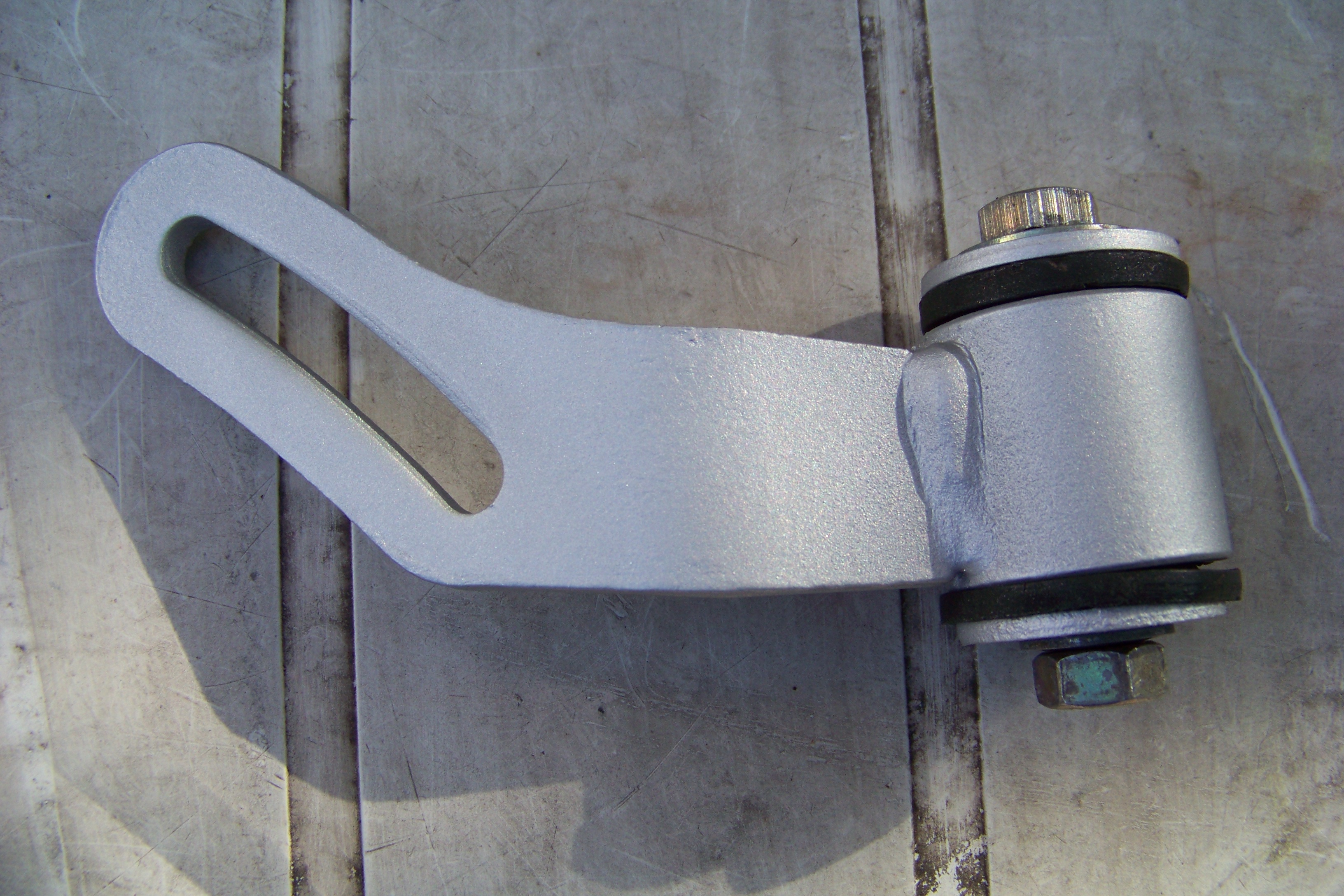

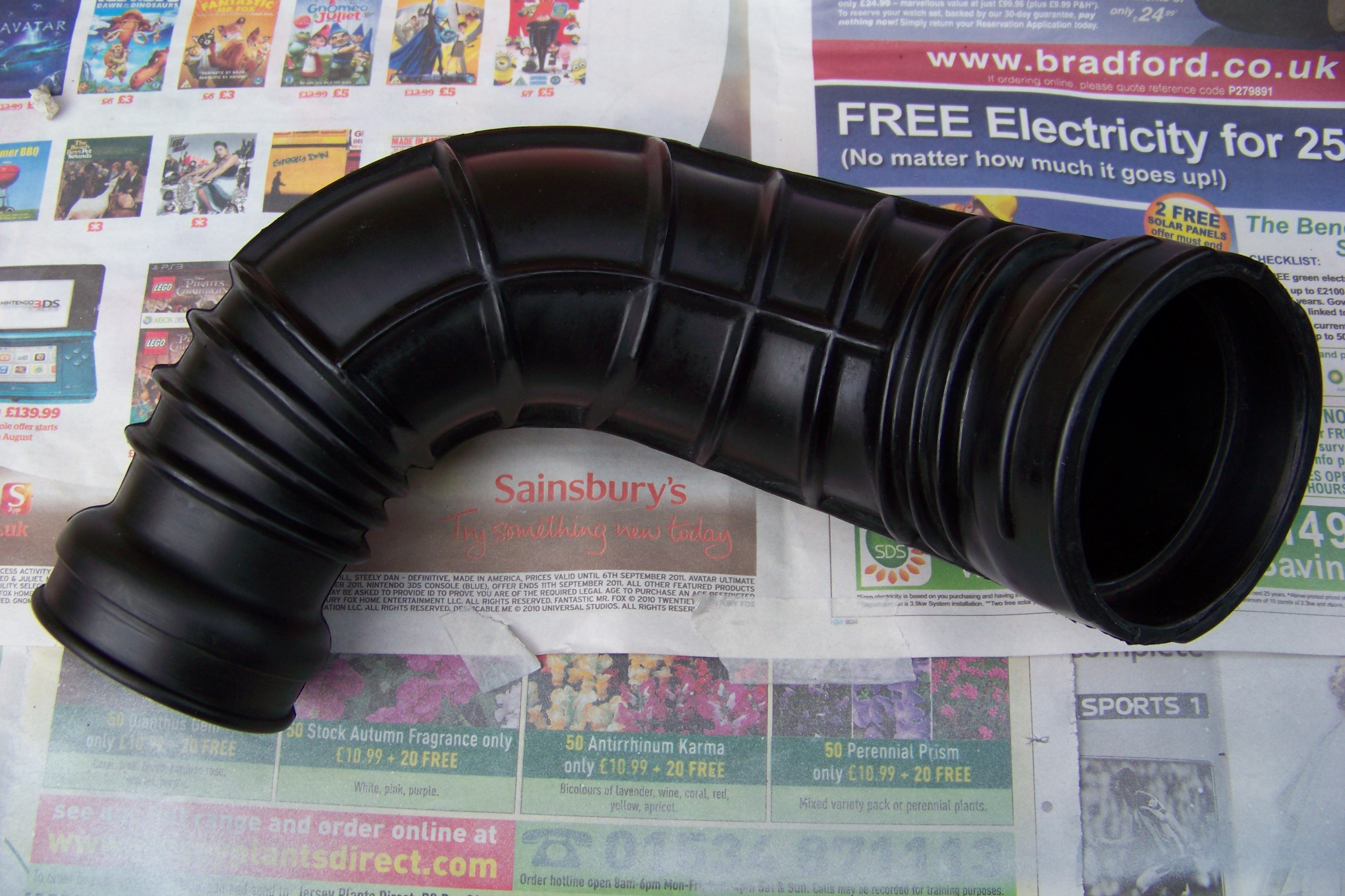

As it was drying I thought I'd quickly clean up the air filter to turbo hose. For those that forgot what it looked like
https://images2.imgbox.com/95/29/dRAxvzih_o.jpg
After a scrub and a good wipe
https://images2.imgbox.com/78/4b/MeutNoaG_o.jpg
Much better!

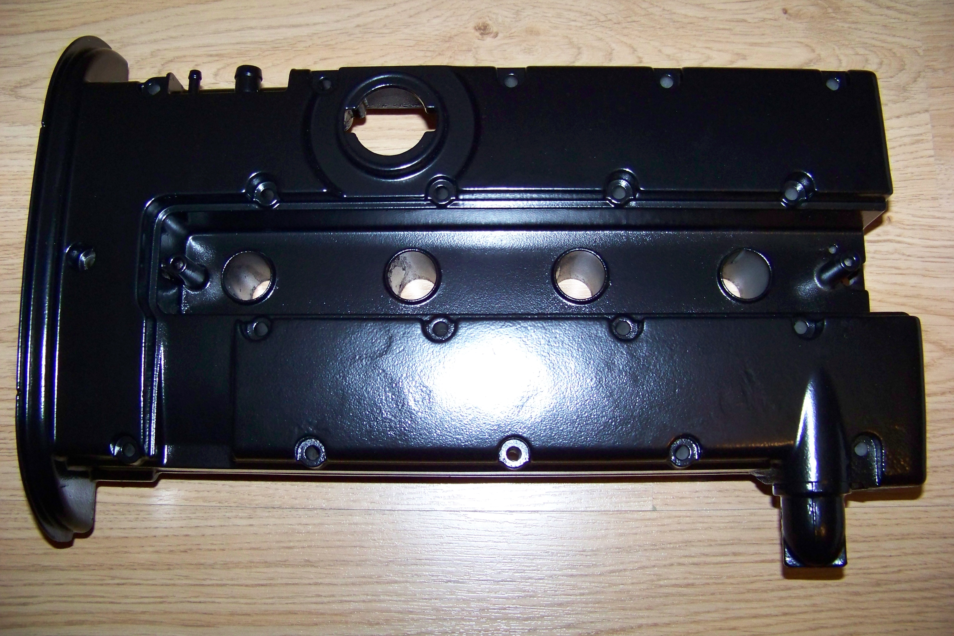

By the time I got that sorted the head was dry enough to handle. Took off all the masking... It was now a good chance to weigh the head to see how heavy it was, seeing as I weighed the block............................................. ...................... outcome was 14.6 KG. considering it has the valves, valve springs, stem seals, inlet/exhaust studs. I then thought 'hmmmmmm'... so I got out the crank and weighed that too. Outcome of that was 17.2KG (reground crank .25). So far then, a bare block, crank and head weigh 67.2 KG's.

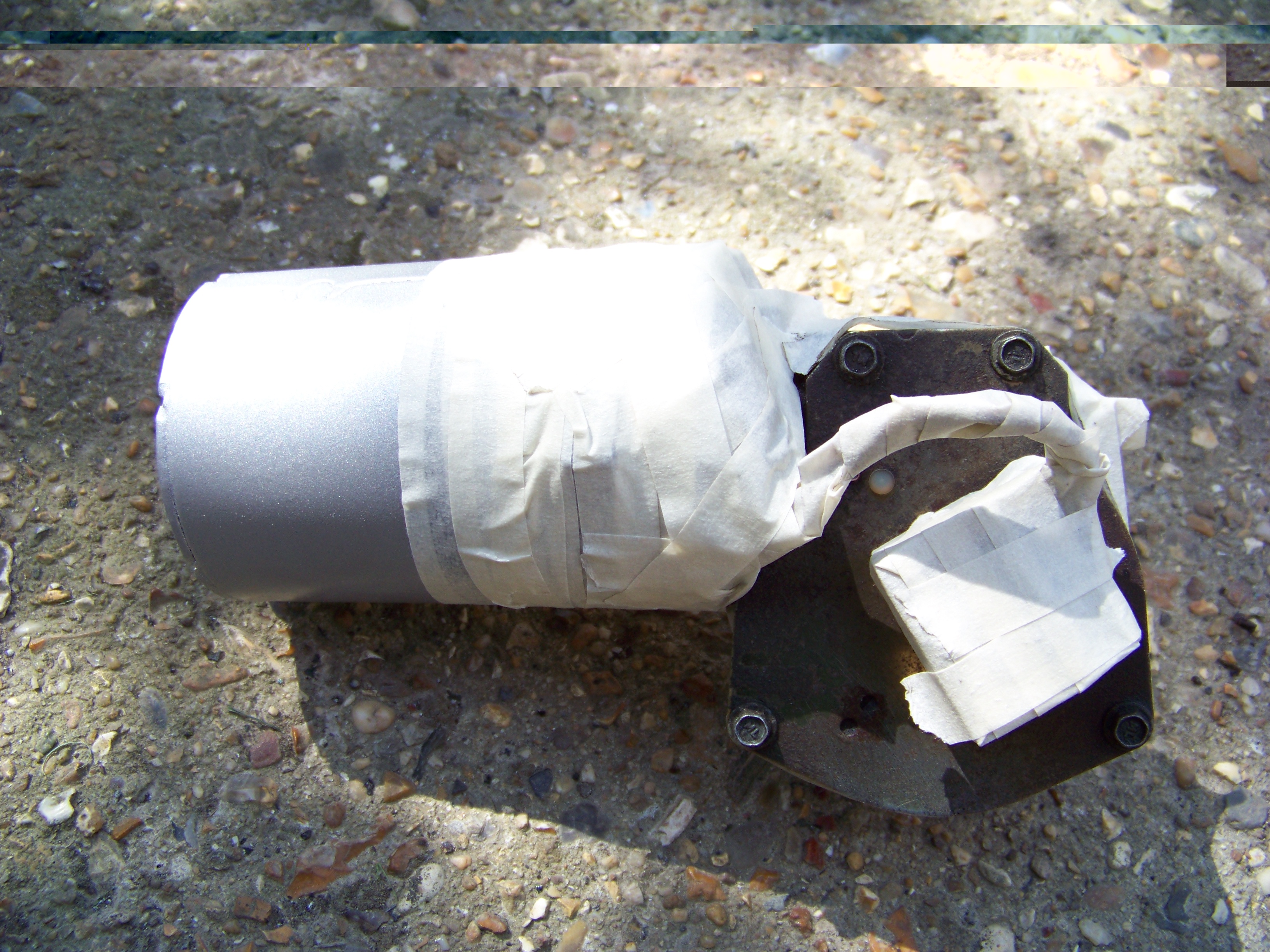

https://images2.imgbox.com/30/ef/sfOc2I2q_o.jpg
Gave them the usual clean...
https://images2.imgbox.com/2c/75/kU6G336e_o.jpg
Then a few coats of the usual colour paint...
https://images2.imgbox.com/65/93/Rirj2xel_o.jpg
and the bottom bracket. This was already silver when it came with the engine but it had flaked and needed a re-coat
https://images2.imgbox.com/b1/e1/DRVfdATK_o.jpg

https://images2.imgbox.com/55/bb/hAQ5kon1_o.jpg
http://img808.imageshack.us/img808/5236/1002761q.jpg
Comes with these included as well as a battery charger, battery, bits and a 3 year warranty lol
https://images2.imgbox.com/5b/47/oG8m365G_o.jpg
http://img204.imageshack.us/img204/7889/1002762w.jpg
Not bad for £19.99!

I've still been trying to gather parts for it and have managed to get this part ticked off the 'want' list

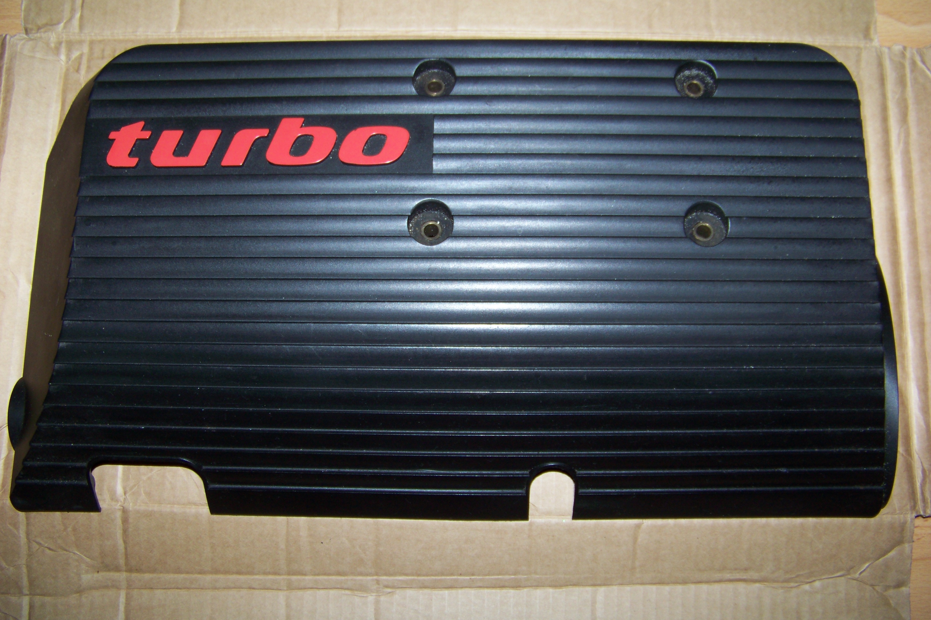

https://images2.imgbox.com/83/a7/Y9QLDIo4_o.jpg
http://img7.imageshack.us/img7/2497/1002788s.jpg
It's in great condition, bordering mint! Thought I'd never find one that's not been cut or isn't scratched up etc.

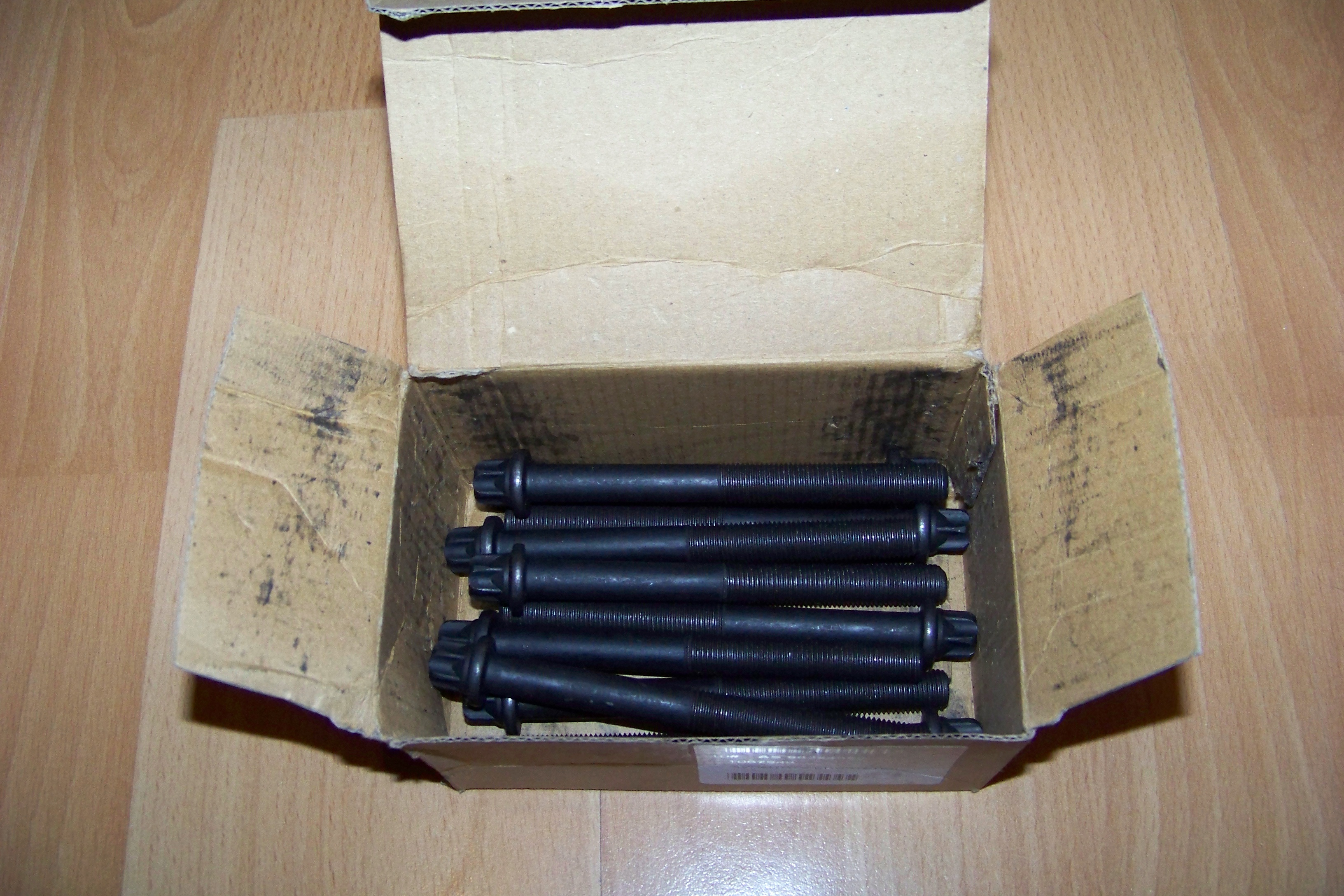

Ripped open the long box to find some goodies
Headbolts
https://images2.imgbox.com/33/69/ZAKw0Jmy_o.jpg

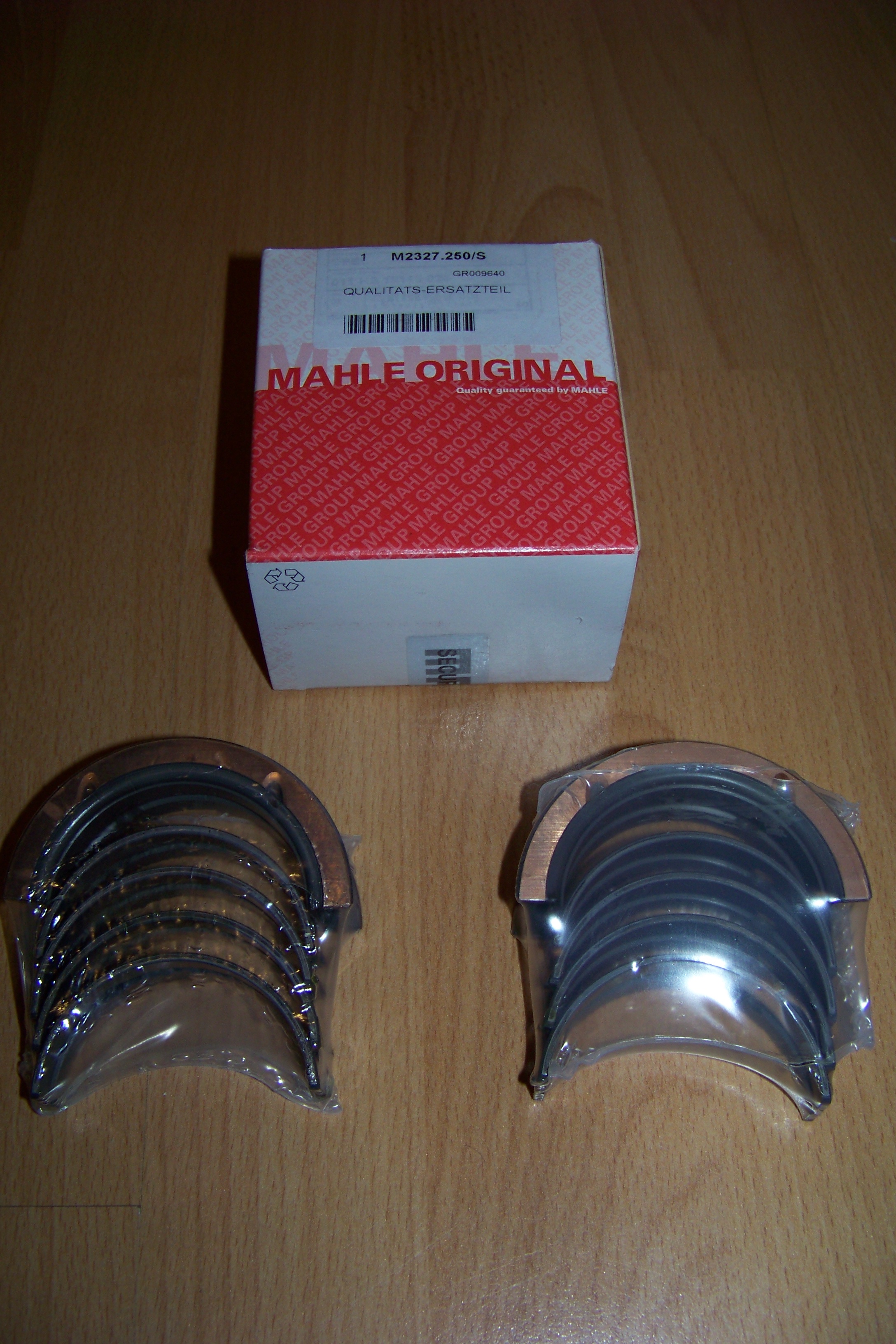

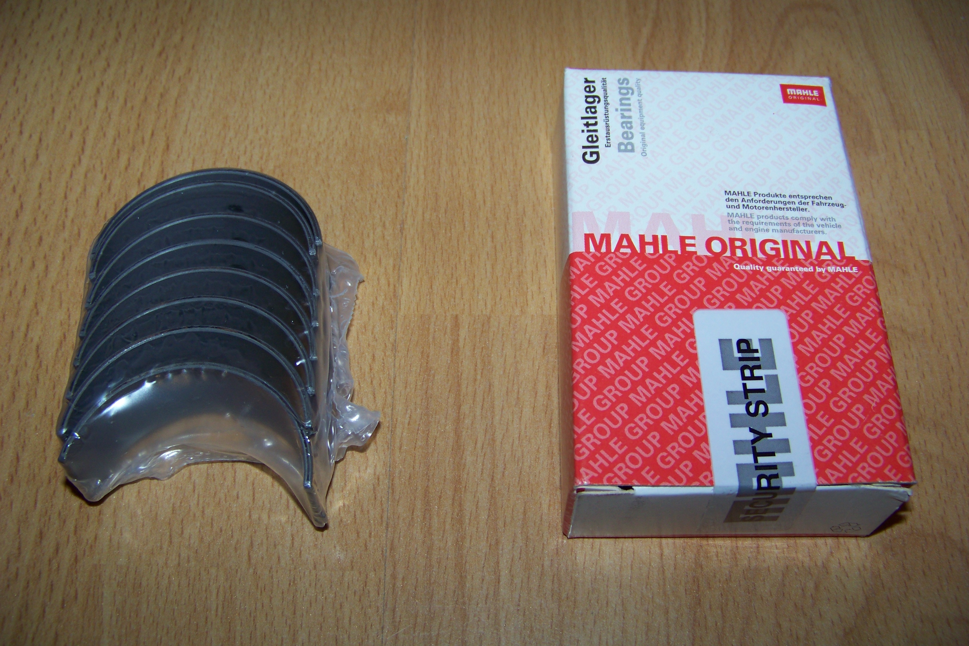

Bearings
https://images2.imgbox.com/b6/13/a7guNbqj_o.jpg
Main bearings
https://images2.imgbox.com/8a/bb/34e50XAf_o.jpg
All in all £180 spent including delivery.
