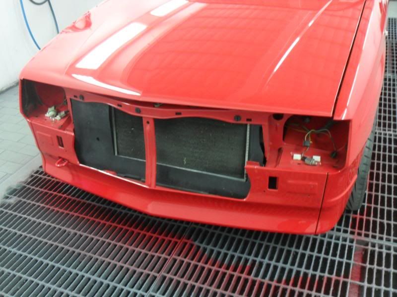

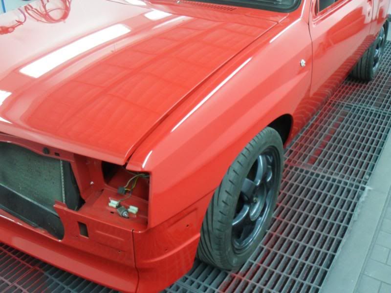

A few more.........
http://i84.photobucket.com/albums/k2...bowip128-2.jpg
http://i84.photobucket.com/albums/k2...bowip129-2.jpg
http://i84.photobucket.com/albums/k2...bowip130-2.jpg
http://i84.photobucket.com/albums/k2...bowip131-2.jpg
http://i84.photobucket.com/albums/k2...bowip132-2.jpg

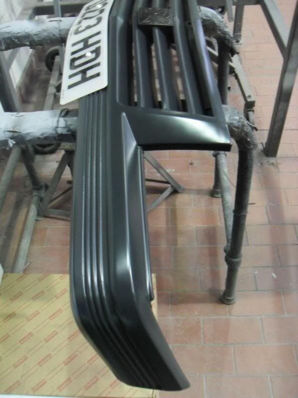

After work that evening I flat/polished the paintwork to remove the gun finish and any minor dirt inclusions. Then I turned my attentions back to the bumpers.......

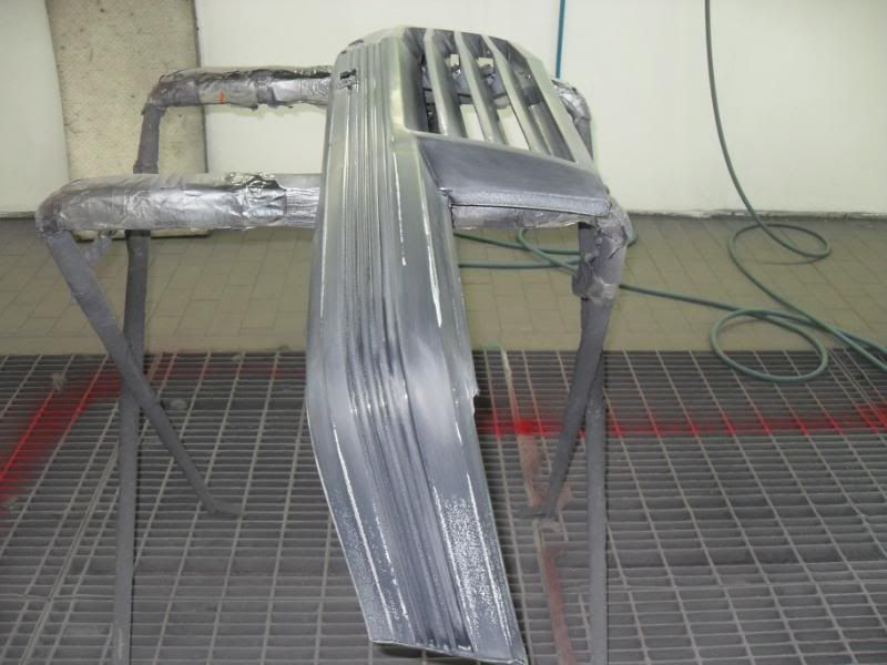

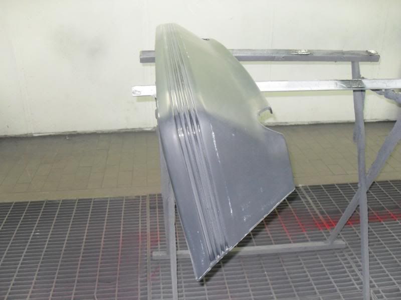

I painted these once only to find they just werent smooth enough as some texture was still visible. The only way to fix this was to rub them down and go again. You can see just how heavy the texture was if you look closely at these pics as Ive rubbed back through the colour coat to the primer in some areas........

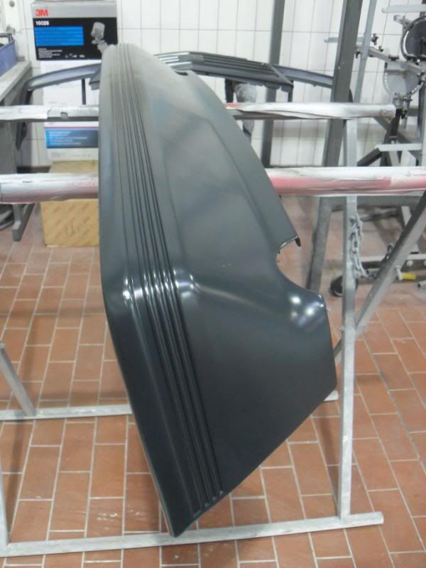

But after another shot at these I did get the results I was after......

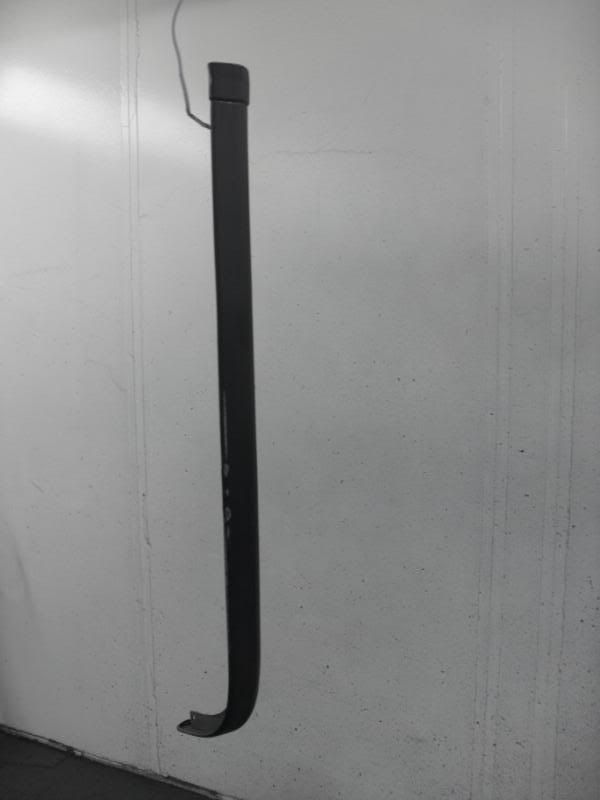

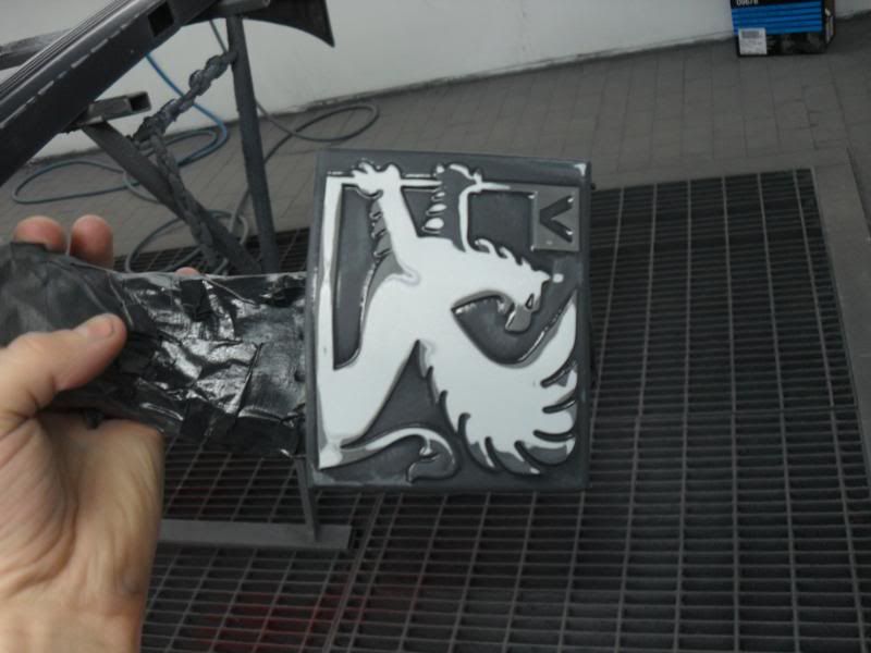

I decided to go for black on the badge with a matt finish. I thought silver may look odd with my colour scheme but didnt want everything grey so tried to break it up a little!
