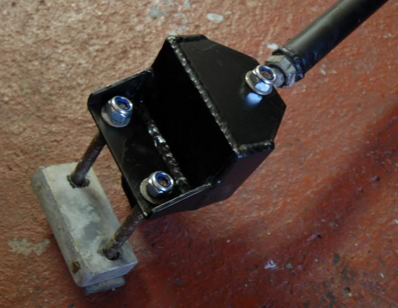

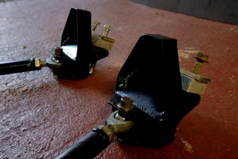

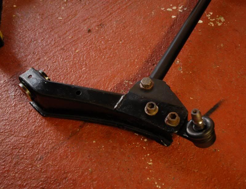

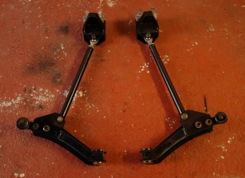

Well today I took delivery of some very fancy adjustble rosejointed tie bars, lowered tie bar brackets and strengthened bottom arms from Jonboy - thanks very much.
Got them, stripped them down, cleaned them up, gave them a few coats of the ole' satin black, and built them back up again.
Fitting them tomorrow in time for Combe - and some piccies:
Waiting to dry and Nova in background not knowing whats gonna happen to it
http://i136.photobucket.com/albums/q...ure/nc0679.jpg

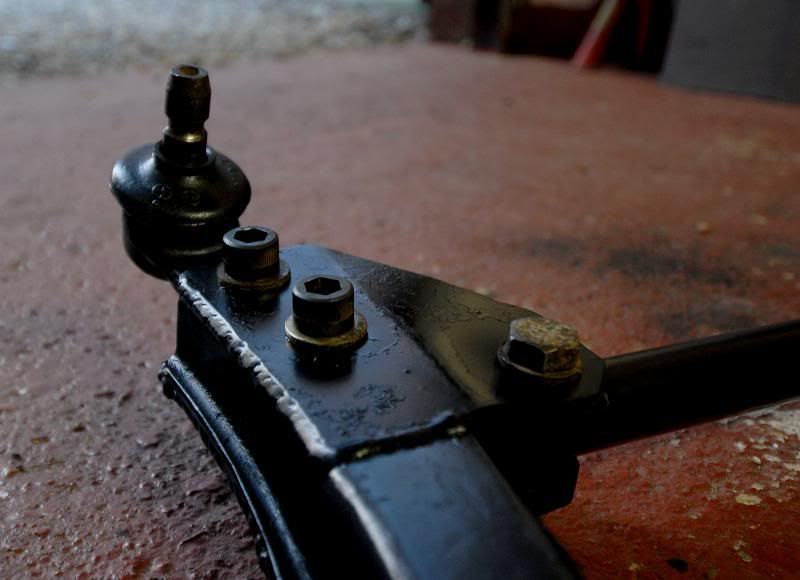

Uber neat welding on the brackets
http://i136.photobucket.com/albums/q...ure/nc0680.jpg

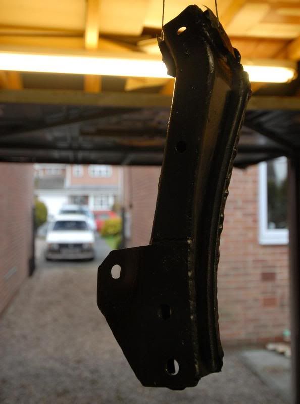

Stengthened TCAs
http://i136.photobucket.com/albums/q...ure/nc0681.jpg
Standard balljoints for now, however on the lookout for some Uniballs maybe
http://i136.photobucket.com/albums/q...ure/nc0682.jpg
Semi built up
http://i136.photobucket.com/albums/q...ure/nc0683.jpg
http://i136.photobucket.com/albums/q...ure/nc0684.jpg
All done... bring on the castor!
http://i136.photobucket.com/albums/q...ure/nc0685.jpg

Seems a shame to have boggo ball joints on there... sort of defeats the object...
There is a chap on here selling some uniballs for £150 ish.
I was going to do all that to mine (and I bought all the stuff!) but decided against due to fact I use it on road too...

Just to add. Rosejoints dont make the front end any more jarring over bumps etc.
Common misconception dreamt up by people that havent tried them. Bits look spot-on Olly.
Fr end I'd say no. Rear end maybe (if one has been added). general opinion is to leave fr one off. Can help with sloppy suspension though.Quote:
Have you tried them?Quote:
Not quite sure what you mean by 'jarring', but it deffo makes the ride more harsh... its meant to! (at least its meant to get rid of the 'squash' of teh bushes)
If you were to go over a pot hole for example with rose jointed everything you WILL notice that the 'effect' would be more noticable to say the least!
Also adds extra pressure onto other components of teh shell, and they dont last as long as rubber/poly bushes. Thats what I was referring to when I said I chose poly.
Indeed Will, thats why I went the route of Nylon bushes. They need replacing every season, but its cheaper than replacing a rosejoint!!
When Chris T let me have a go in his, there was about 4mm play in the tiebar ones. made for an interesting drive lol
I've got the TCA's running RJ's, Have done since 2002.Quote:
Probably need replacing then.Quote:
If you dont notice any difference between them and your old rubber bushes they will need replacing. lol

Will - as said, the standard ball joints are "for now", however I think £150 is better spent elsewhere to get me more prepared for Hillclimbs & Sprints, namely Quikrak kit, for one.
Also, I can't see how having standard bottom ball joints "defeats" the object of the whole package really.
> The lowered tiebar mounts help improve turn in, and prevent "digging in" under hard braking
> The tiebars are now adjustable in length to gain castor is the main reason for the setup. Again - to improve turn in again.
> The bottom arms are now strengthened, which appealed to me because I have the 14 Harry Hockley plates on - I've wanted to plate them for ages anyway
> The fact they are rosejointed, in my opinion - is just a bonus the fact it gets rid of another 2 polybushes.
Also - I know they'll need replacing, as does every consumable, but not in my life time in owning the car - despite the car being road legal - I very rarely take it out on the road.

Rose jointed bars don't make the ride any harsher ?? LOL
Clearly not used a set, I've sold those with a disclaimer to Olly that he MUST avoid big potholes etc..
The original Pro tec mounts that Chris and I used do suffer from them knocking the bearings out, christ knows how many sets I put in mine and Chris had mentioned to me his had failed.

Didnt mean to sound negative dude... it doesnt 'defeat' the object your right.. just a shame thats all! ;)Quote:

Crack is whack mate... My kit is a TAS kit for just the inner TCA's. Admittedly I've only done about 25k on them. But the joints are still smooth & offer some resistance to movement like a new bearing does. I live in a town with mostly poorly patched road surfaces, the rest of the front end is bushed with Poly Race 'hard' compound bushes. Personally it feels no worse in terms of jarring or harshness than the previous setup I had other than IMO the steering feedback & accuracy is massively improved.Quote:
Originally Posted by Jonlem
Lets leave it to Olly to decide, however I was just offering a little advice prior to trying them that they might not be the teeth shattering addition everyone thinks they are.
Olly if your after a set of uni balls got a pair here you can have for £100. Sorry if im being cheeky :D
2/3hour drives in a stripped out nova rules ;) :cool: lolQuote:
Without doubt the conversion to using those type of rose joints on the tie bars makes it a VERY harsh ride.Quote:

OK then - out of the list of bits to do, I decided to get my new fancy tiebars etc on.

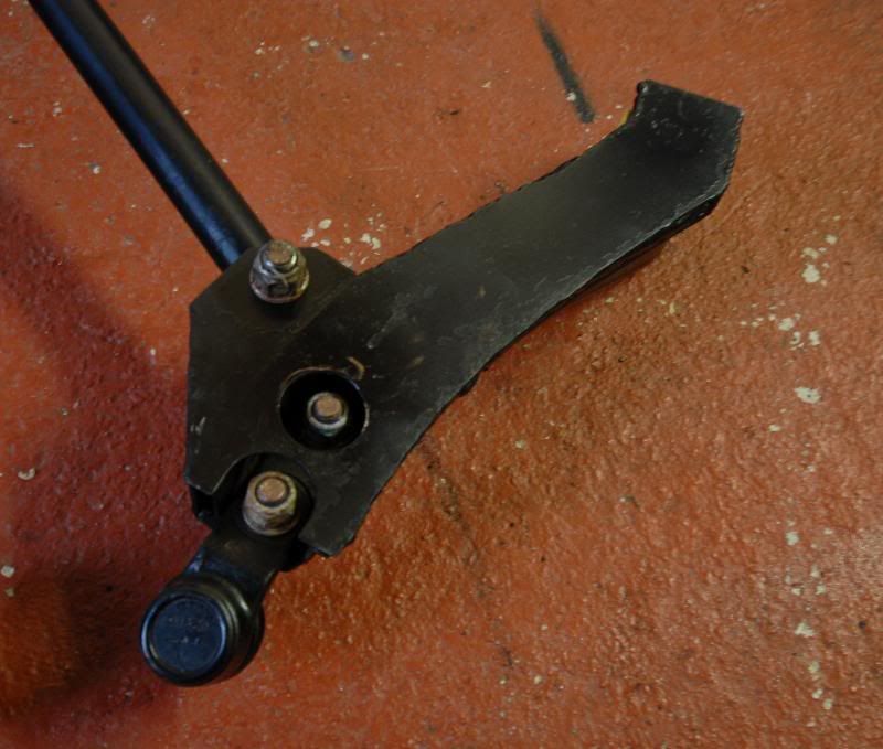

So off with the drivers old, and a photo to compare the two, new & old
http://i136.photobucket.com/albums/q...ure/nc0690.jpg
Drivers fitted
http://i136.photobucket.com/albums/q...ure/nc0691.jpg
Some detailed pics, fitted on the car
http://i136.photobucket.com/albums/q...ure/nc0692.jpg
Welding is beaut
http://i136.photobucket.com/albums/q...ure/nc0693.jpg
Strengthened wishbones
http://i136.photobucket.com/albums/q...ure/nc0694.jpg
Gotta love stiffies
http://i136.photobucket.com/albums/q...ure/nc0695.jpg
Passenger before & after
http://i136.photobucket.com/albums/q...ure/nc0696.jpg
http://i136.photobucket.com/albums/q...ure/nc0697.jpg
Still love the quality of the welding
http://i136.photobucket.com/albums/q...ure/nc0698.jpg

Benn, The TCA's are the original ones made by Lee303, they have been slightly adapted and the tie bars and brackets are a totally different design.
