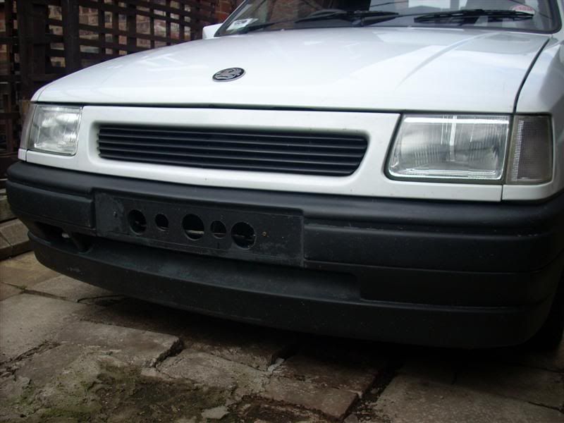

All ready for Donny now, booked tomorrow off work so will fit the camera mount etc ready :)
Also might cut some air holes in my std mk2 front bumper, to make the car look more hard core:cool: lol

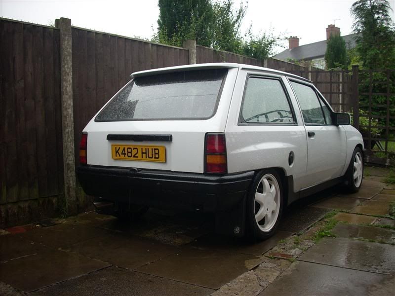

Will be looking at the sky through the windscreen lol
Right, did Donington yesterday, and to make it look a bit more hard core, i found my hole saw and std mk2 bumper, and the result = :cool:

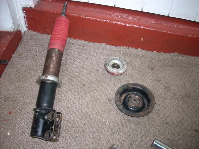

Coilover removed and in bits(again)
http://img.photobucket.com/albums/v8...1058Medium.jpg

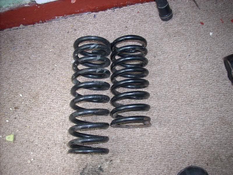

Old spring left, new right
http://img.photobucket.com/albums/v8...1059Medium.jpg

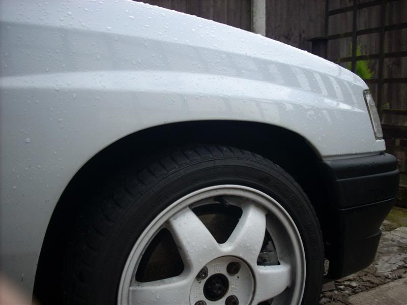

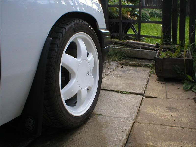

Refitted the strut, and the ride height is now just what i want.
This is with the spring platform wound up to about 1-2" off the bottom
http://img.photobucket.com/albums/v8...1067Medium.jpg
Compared to the old springs fully down
http://img.photobucket.com/albums/v8...1057Medium.jpg
So im well pleased with that result, can go lower but i want to keep some damper travel, so i'll leave them at that.
The shorter springs also means i no longer need wheel spacers :cool:

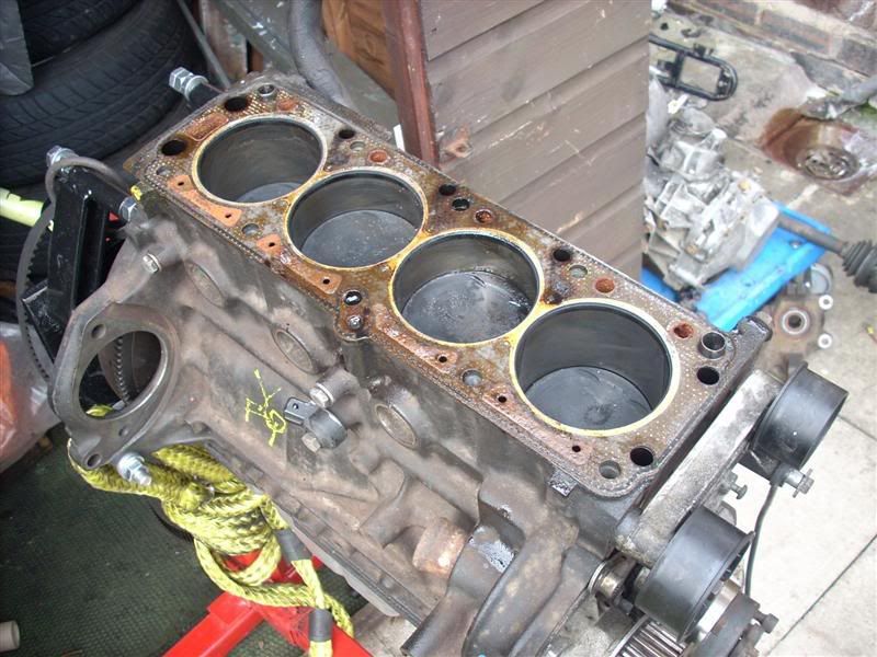

So have been stripping that down this weekend ready for rebuild.

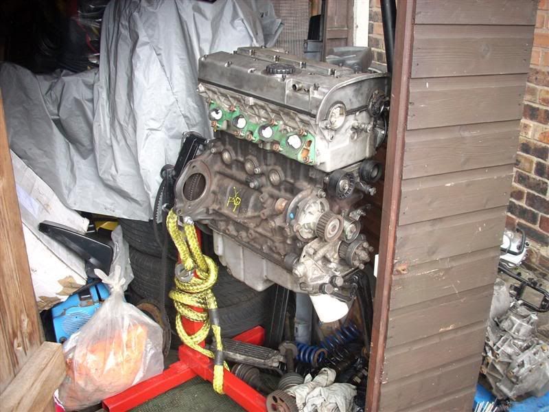

All de-greased/cleaned, and up on stand
http://img.photobucket.com/albums/v8...1105Medium.jpg

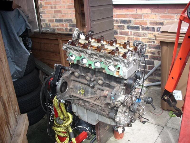

Cam cover off, ready to undo headbolts
http://img.photobucket.com/albums/v8...1107Medium.jpg
Head off, and we have 4 pistons which is cool :D
