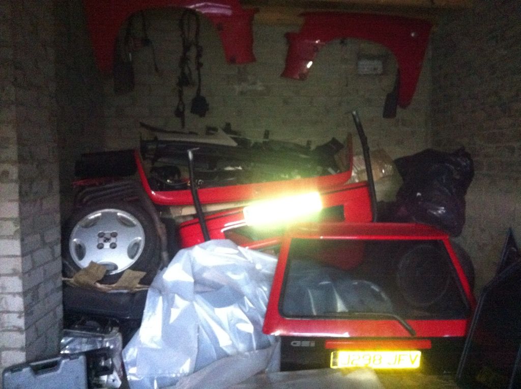

Other tub turned up. I'll get it to the shop tomorrow hopefully.
http://i660.photobucket.com/albums/u...pseyymhhza.jpg
No idea mate, last I heard he wasn't doing nova parts anymore worth an ask though!

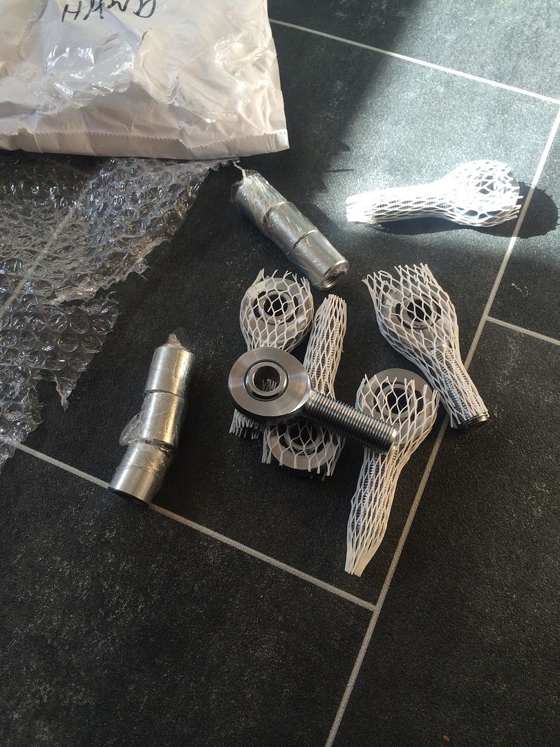

A few parts turned up today. 6 of each, left and right hand rose joints and adapters.
http://i660.photobucket.com/albums/u...pshrn44ht9.jpg
Lots of nice parts arriving, just need to see them put together now :)

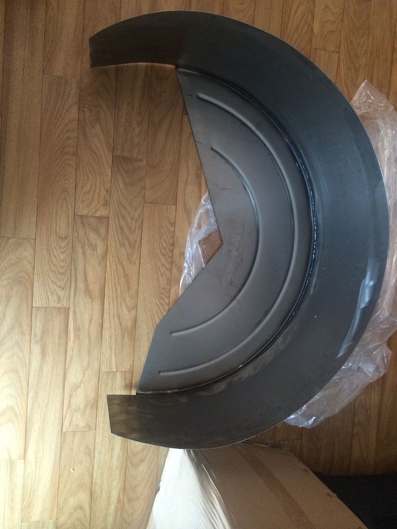

i went in past the shop today they've been getting some rough sizes of where the tubs will be going. Cage might be in this week too.
http://i660.photobucket.com/albums/u...psi1gbd1vc.jpg
Wow those tubs look massive. Can't wait to see it all welded up with the turrets.
That's what I thought when I saw them lol they'll be cut to suit though. Hopefully some good updates this week.
Love it! I would just mount those tubs up as high as you can i.e. to that top edge near the window line.

No idea what I'm running yet but lots of room for different options.

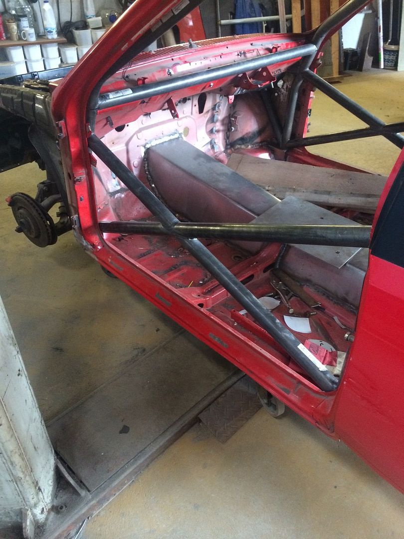

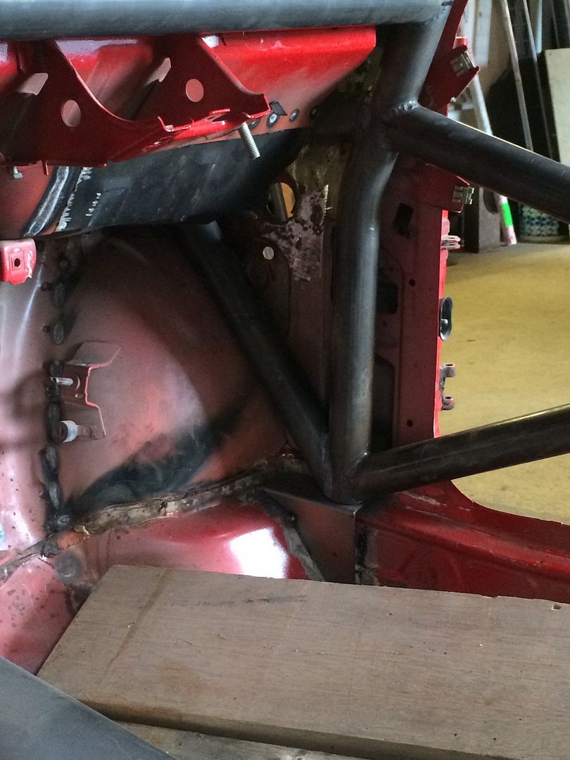

The cage has been going in today front is not quite finished a few bars still to go in.
http://i660.photobucket.com/albums/u...pslp2rch3d.jpg
http://i660.photobucket.com/albums/u...pso40nggob.jpg
http://i660.photobucket.com/albums/u...psgutz1go9.jpg
http://i660.photobucket.com/albums/u...psfba9wjbt.jpg
http://i660.photobucket.com/albums/u...pskqirv8wb.jpg
Sunroof staying?
Nice work with the cage!
I've got a carbon blank going in, decided not to cut the roof off just now.
cheers it's getting there.

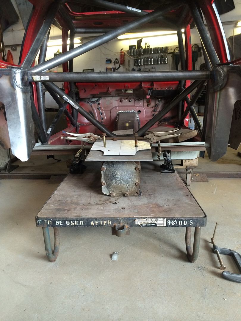

Might be silly, but. Will you not be running seats mounted on rails, rather than std mounts? Just odd they've left the strengthening bit in the floor for them... And wont the turrets be all different as you'll have rear uprights as its 4x4?

Ive got bits to be welded in for the seats, he dsnt know what I was doing with seats that's why it's still there. I'm using front suspension on the rear, I don't want to give too much away yet but I'll have pics soon enough!
