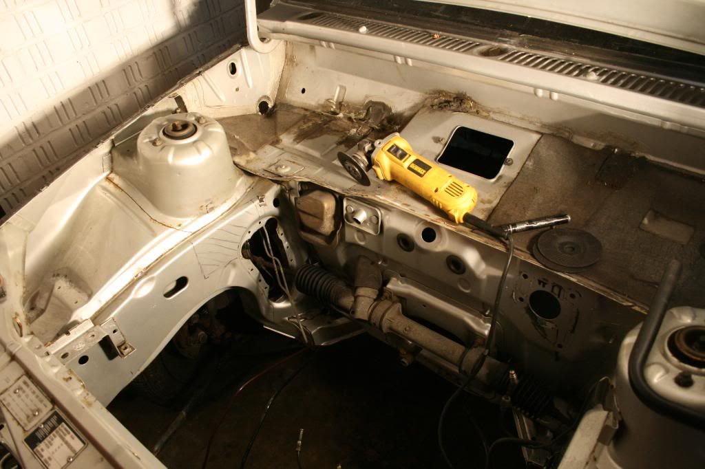

Hi everyone not had an update for a bit as i haven't had much time on the car this week but i have done a bit so here goes...

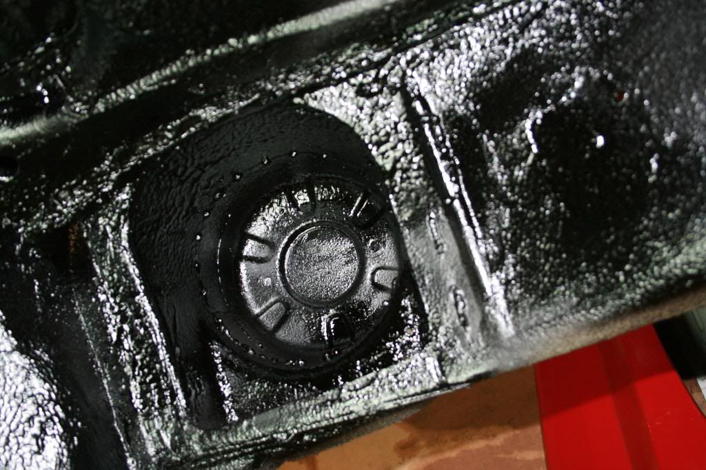

I stone chipped under the front turrets and in the inner wings
http://i248.photobucket.com/albums/g...ndseats130.jpg
http://i248.photobucket.com/albums/g...ndseats131.jpg

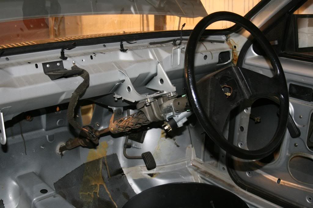

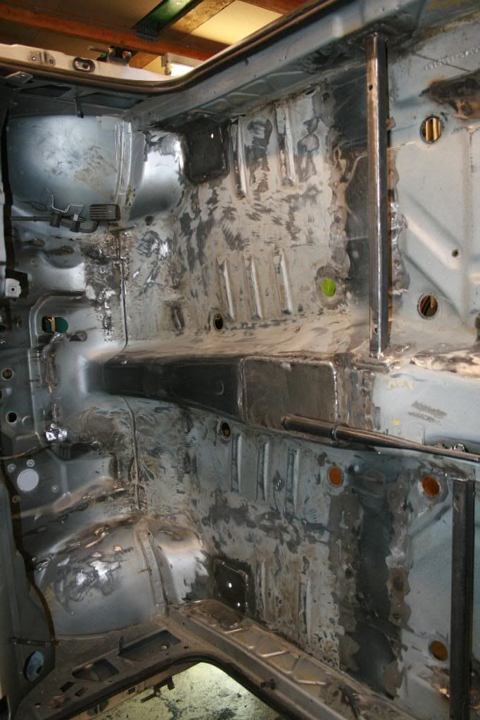

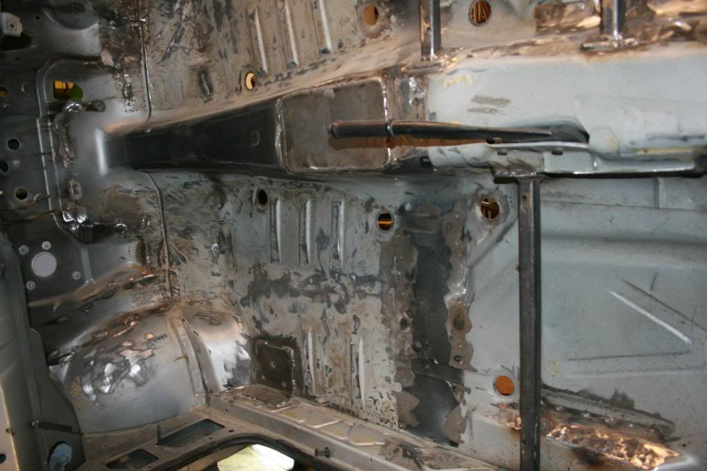

Then i made a start on the paint prep on the inside of the car (warning this does include some extreme weight saving measures please have a tissue to hand at all times lol)
Just a general clean at first
http://i248.photobucket.com/albums/g...ndseats132.jpg
http://i248.photobucket.com/albums/g...ndseats133.jpg
http://i248.photobucket.com/albums/g...ndseats134.jpg

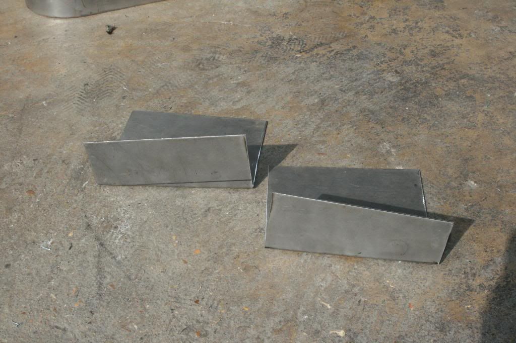

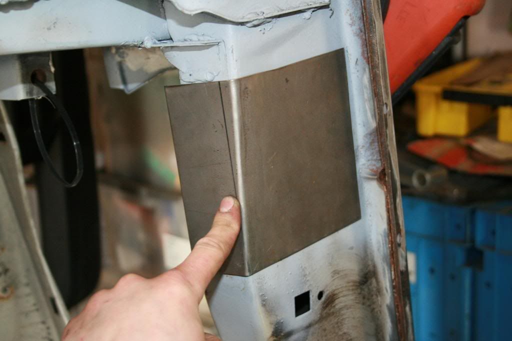

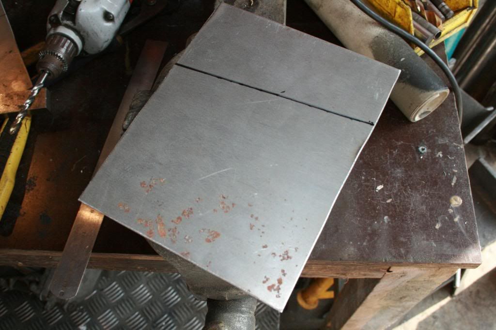

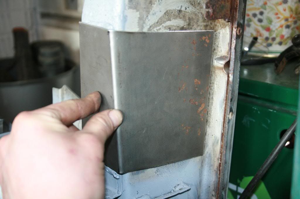

Then i made up some strengthening plates for the front panel (these are the only chassis strengthening plates i am fitting)
http://i248.photobucket.com/albums/g...ndseats136.jpg
http://i248.photobucket.com/albums/g...ndseats141.jpg
http://i248.photobucket.com/albums/g...ndseats142.jpg
And they go here
http://i248.photobucket.com/albums/g...ndseats143.jpg
http://i248.photobucket.com/albums/g...ndseats144.jpg

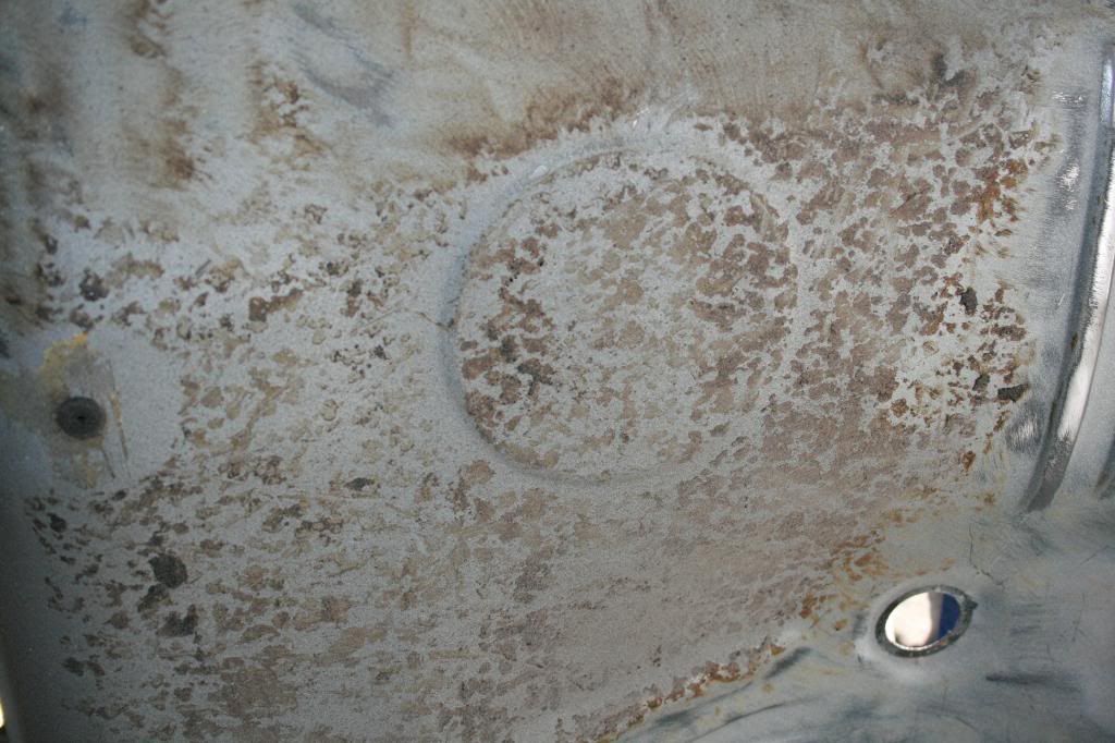

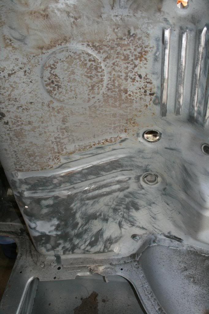

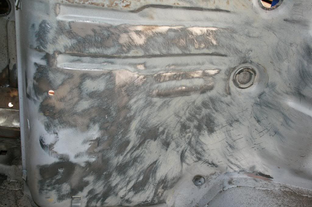

At this point i decided i would go back to the interior and remove the final remains of that tar like cr@p
http://i248.photobucket.com/albums/g...ndseats145.jpg
A wire wheel on a drill proved to be the best method
http://i248.photobucket.com/albums/g...ndseats146.jpg
http://i248.photobucket.com/albums/g...ndseats147.jpg

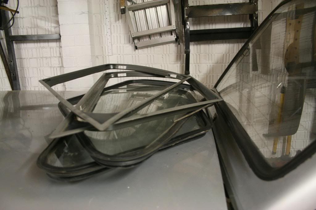

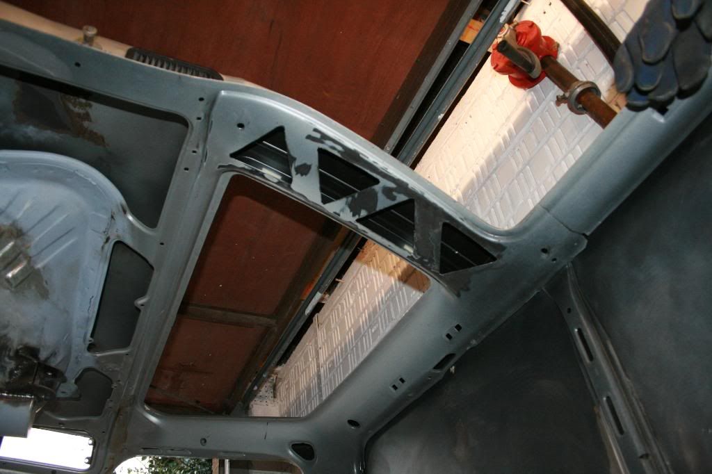

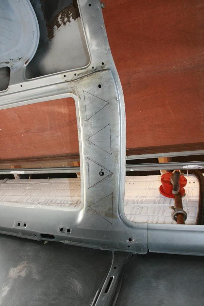

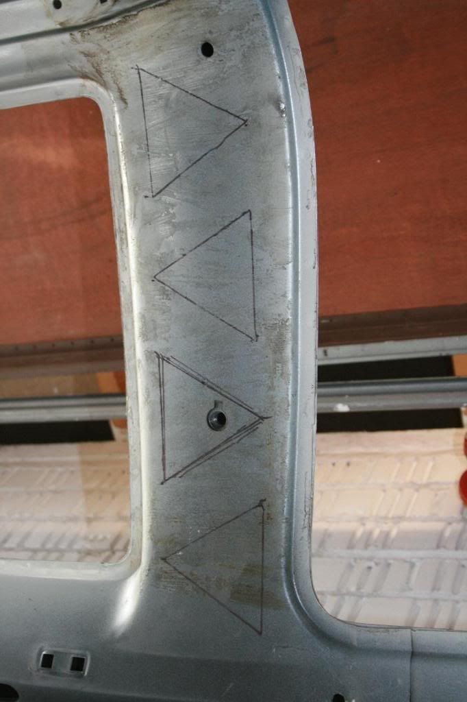

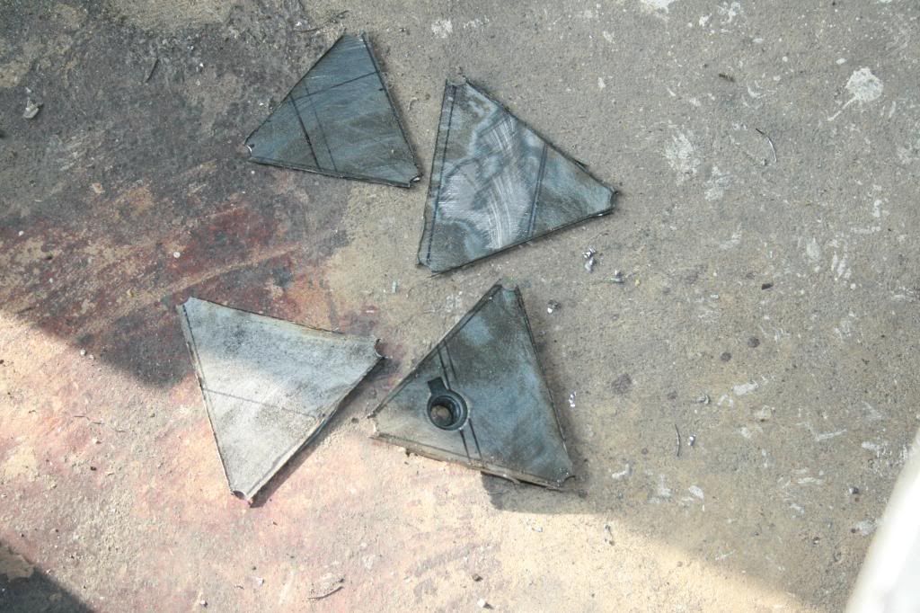

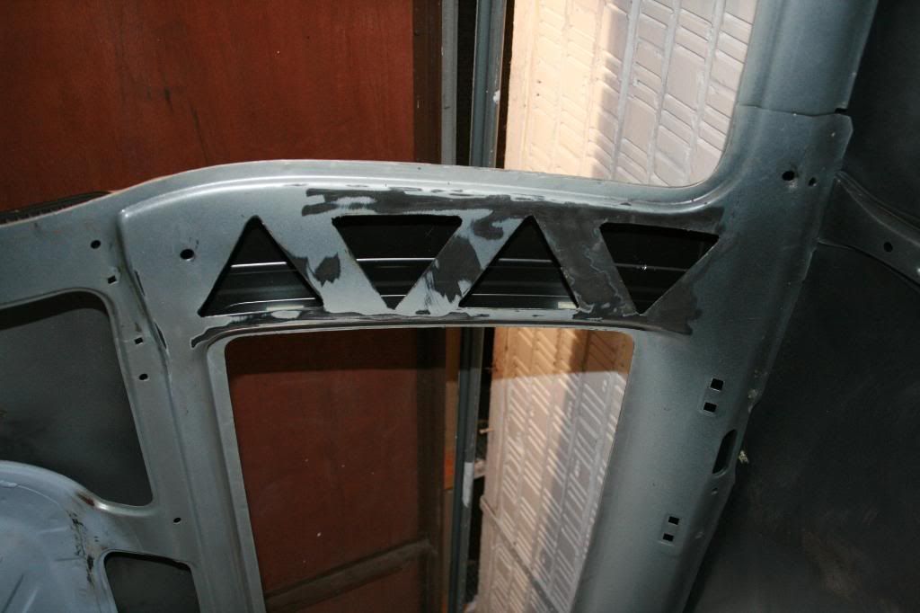

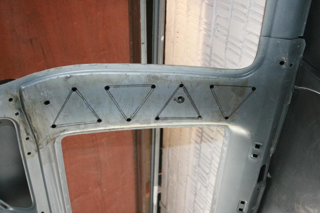

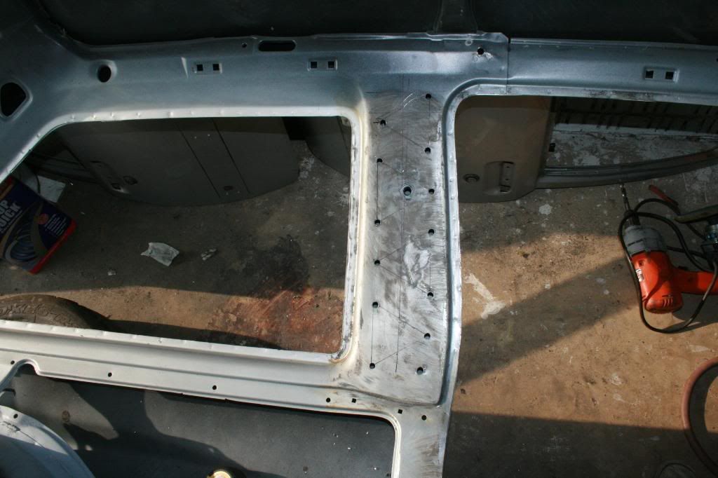

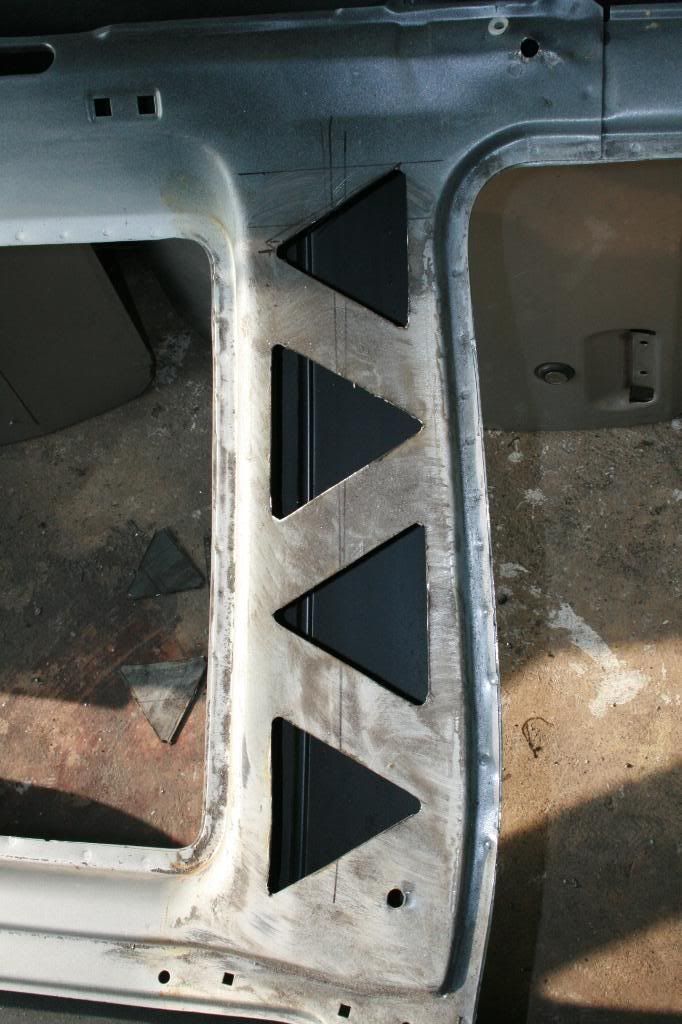

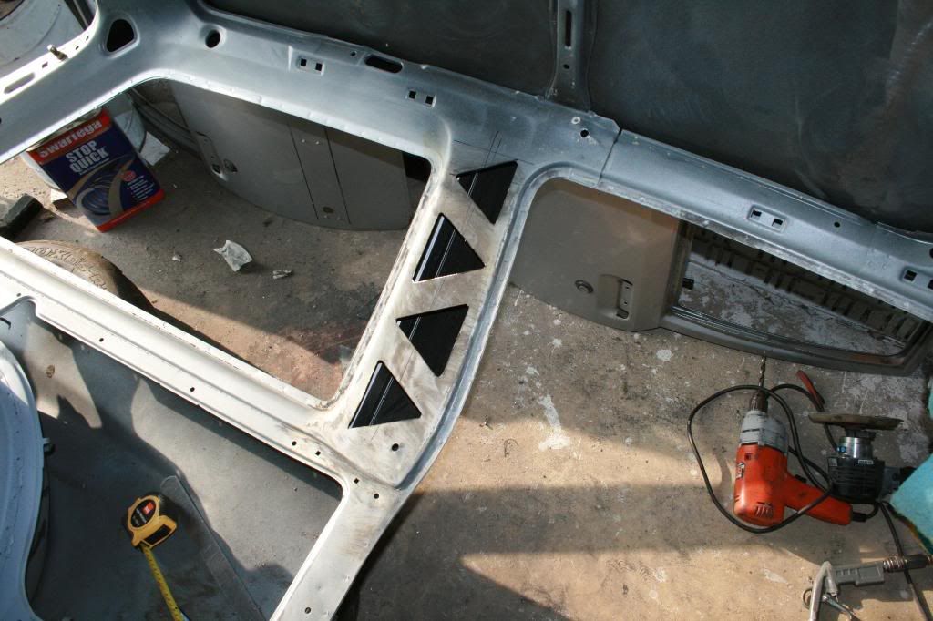

After finishing that off i though i would have a go at some more weight saving measures...it started like this
http://i248.photobucket.com/albums/g...ndseats153.jpg
http://i248.photobucket.com/albums/g...ndseats154.jpg
That then progressed to this
http://i248.photobucket.com/albums/g...ndseats155.jpg
And then this
http://i248.photobucket.com/albums/g...ndseats157.jpg
http://i248.photobucket.com/albums/g...ndseats158.jpg
And the other side
http://i248.photobucket.com/albums/g...ndseats149.jpg
http://i248.photobucket.com/albums/g...ndseats150.jpg
http://i248.photobucket.com/albums/g...ndseats152.jpg
The remains
http://i248.photobucket.com/albums/g...ndseats151.jpg
:thumb: :thumb:
How much you saved there count?
Good point....not loads but every little helps and there is more to come lol
That's pretty cool, love the triangulation theory lol Also picked up retro cars on friday, love your not-so-furry dice :thumb:
lol i was genuinely asking, i want to do a bit of weight saving on mine in places that can be hidden and are not sacraficing too many comforts, as you say, every little helps lol
Constantly enjoying the updates James, keep them coming, the saloon looks excellent in RC, I must of red it five times already
