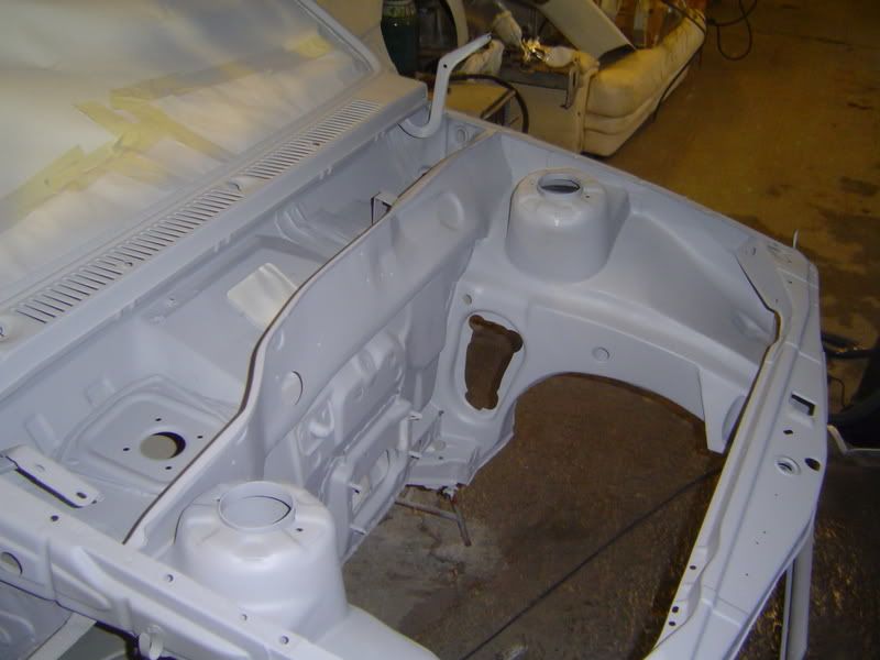

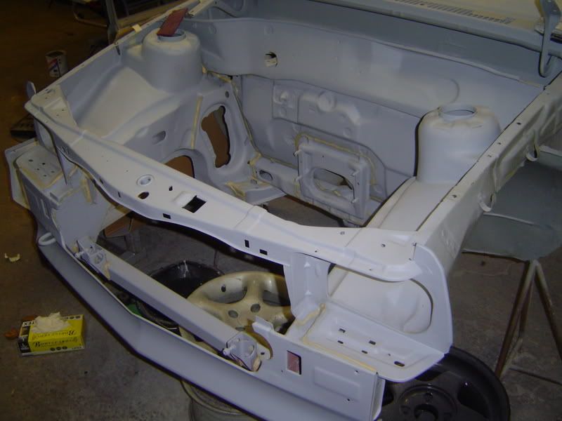

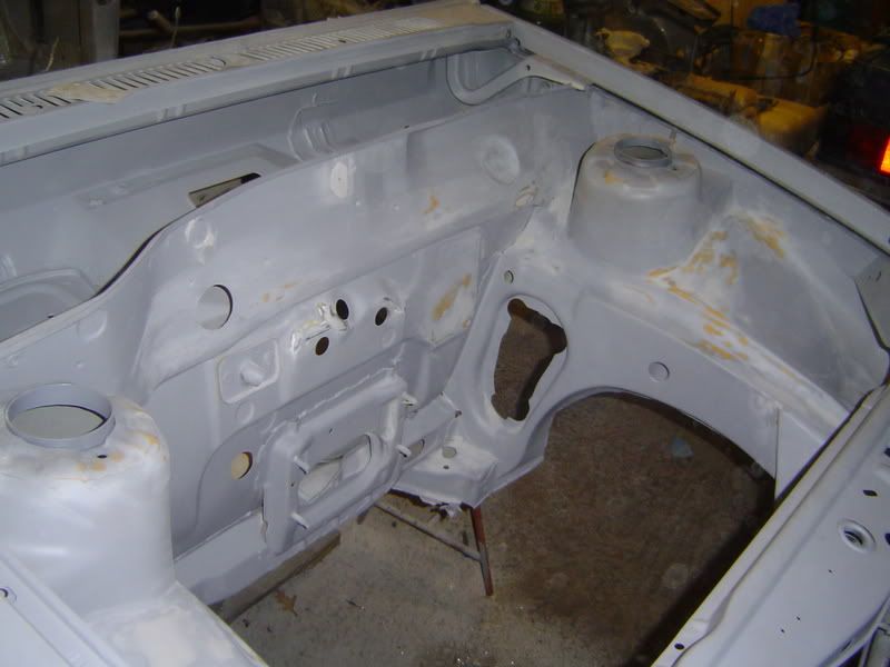

Have spent a lot of time going over areas of the bodywork and engine bay which needed a re-going over, then re-primed again..
http://img.photobucket.com/albums/v1...5.jpg~original

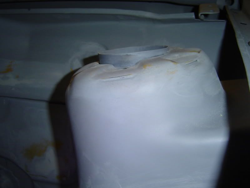

Cut out the middle of the turrets to make room for some eccentric top mounts, and bent up some rings of 1mm steel to beefen up the turret.

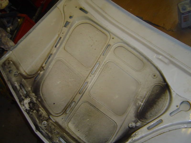

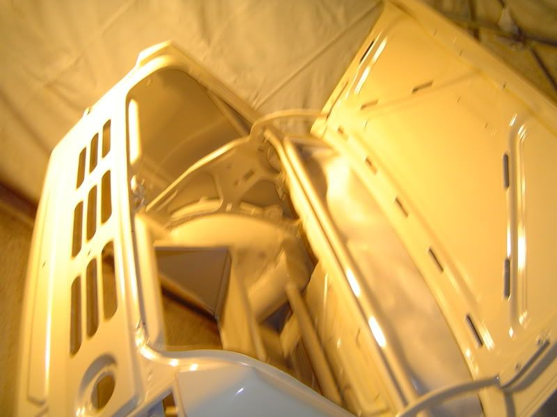

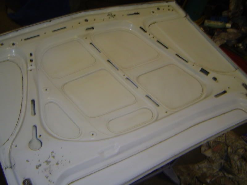

Very manky bonnet
http://img.photobucket.com/albums/v1...2.jpg~original
All cleaned up before rubbing down

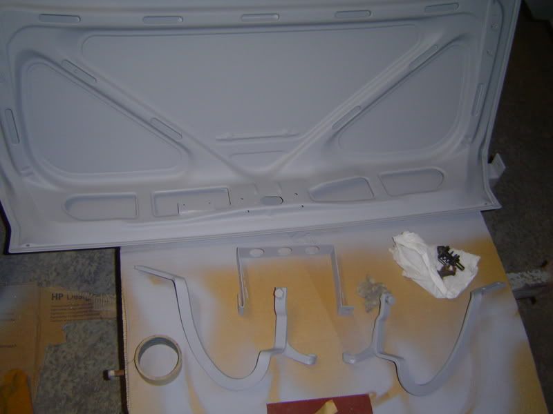

bootlid

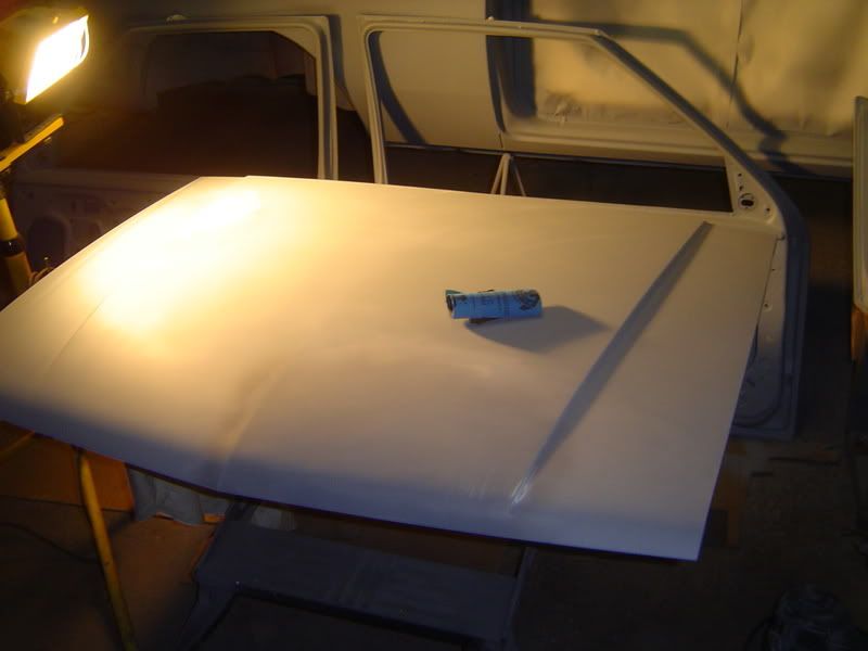

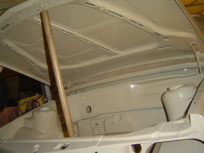

bonnet nice and sorted

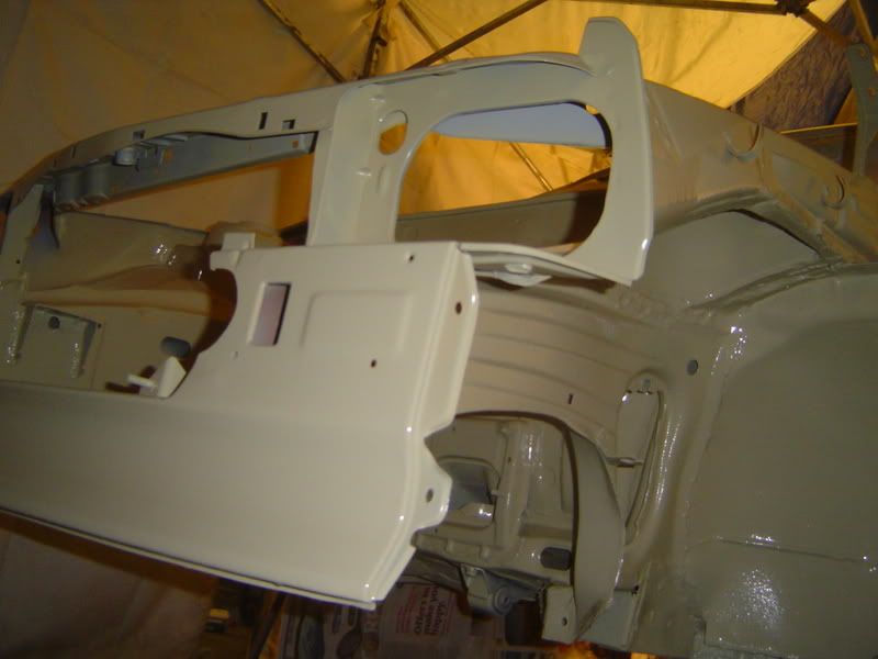

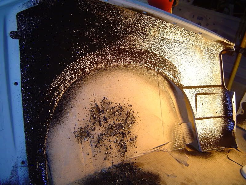

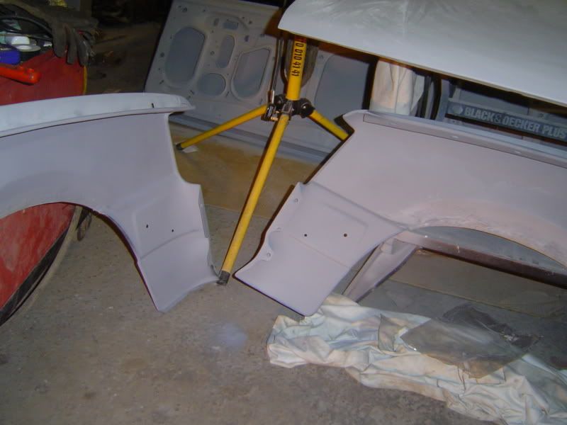

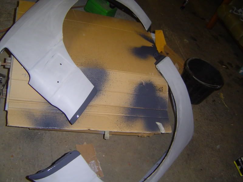

Front wings in primer
stone-chipped

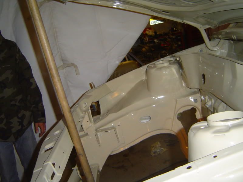

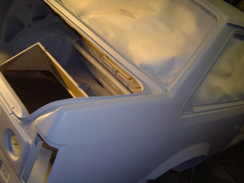

Engine bay sealed up
http://img.photobucket.com/albums/v1...3.jpg~original

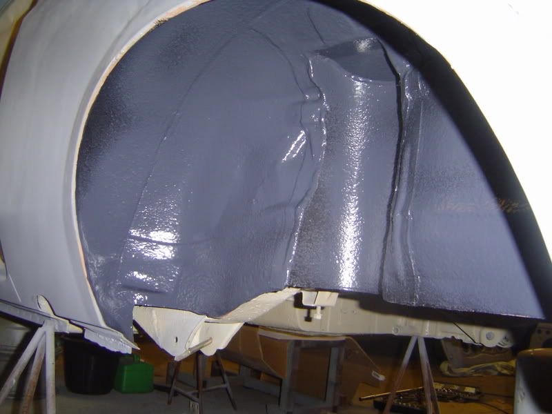

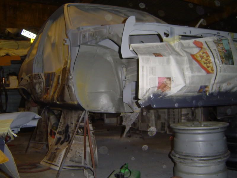

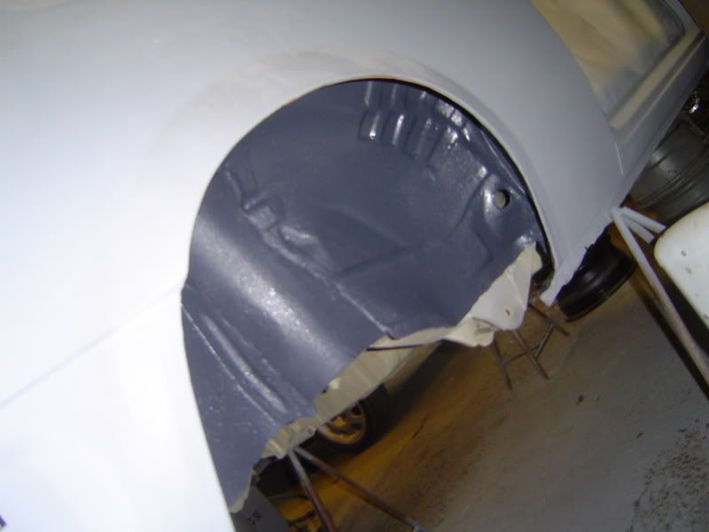

Rear inner arches primed then stone-chipped

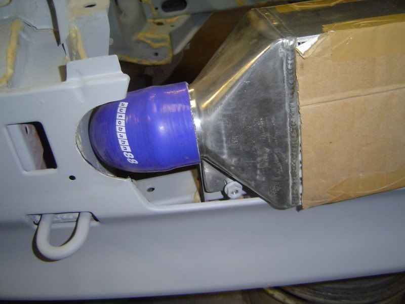

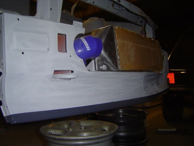

Filed the front panel a bit for a better fit with the boost pipes.....getting all the small jobs sorted
http://img.photobucket.com/albums/v1...7.jpg~original

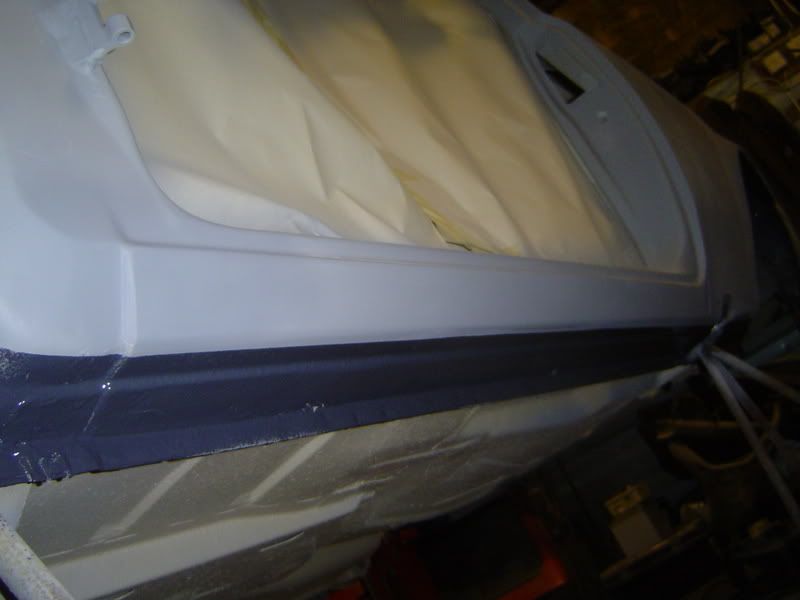

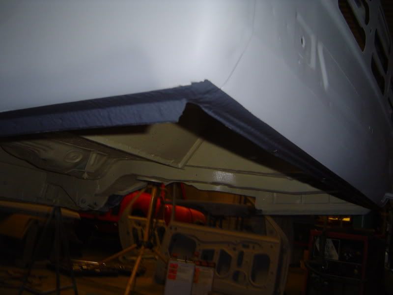

sill all sorted and ready
Masked up the car for some stone-chip around thebottom inch or so of the car

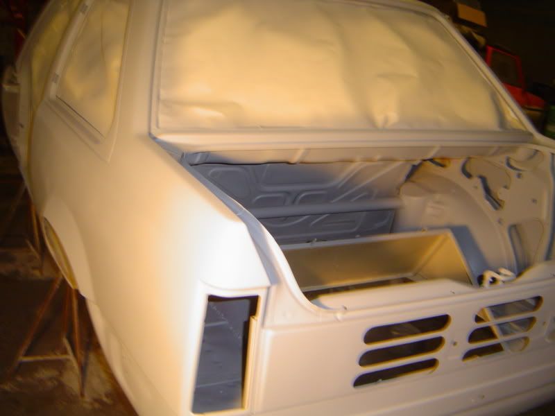

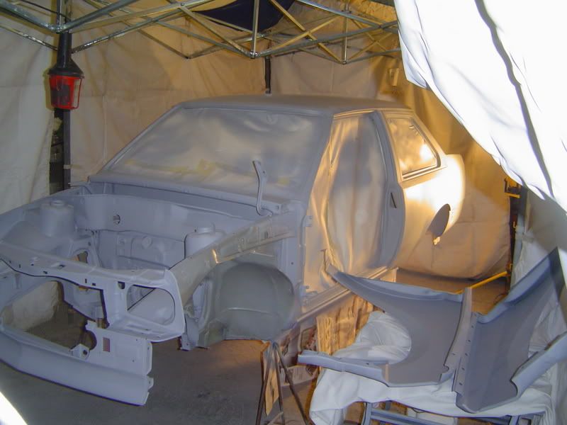

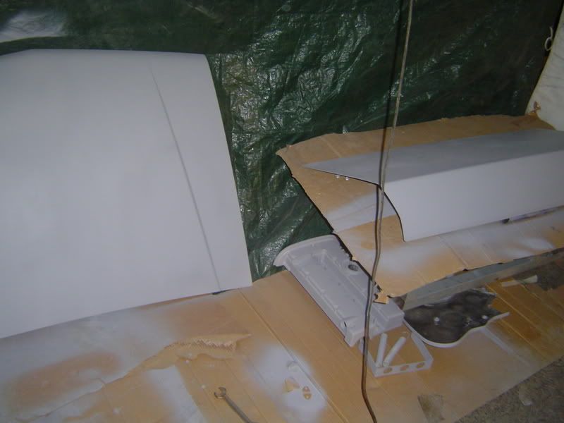

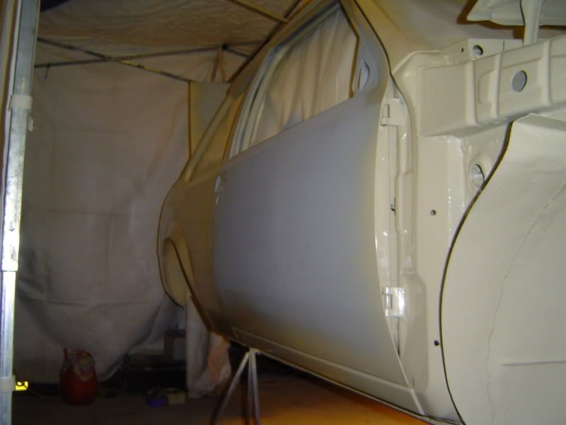

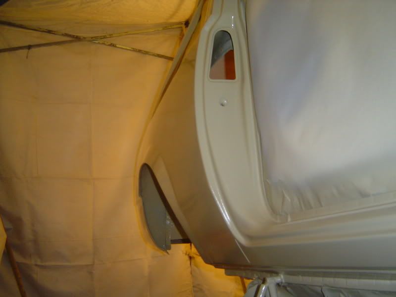

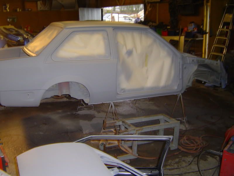

Set up the 'ez-up' marquee as my temporary spray booth.. Works very well with a couple of heaters in there. I wetted the floor before de-dusting and spraying , and this worked very well.
http://img.photobucket.com/albums/v1...8.jpg~original

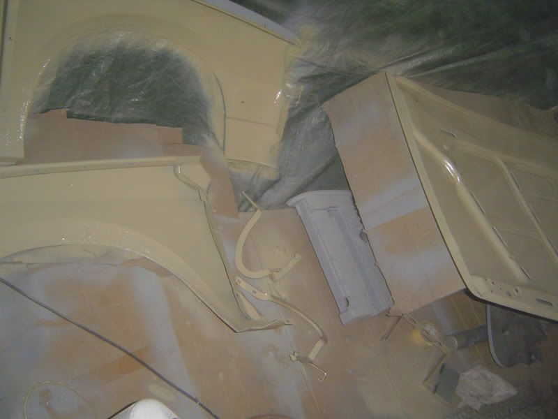

panels in primer
http://img.photobucket.com/albums/v1...9.jpg~original

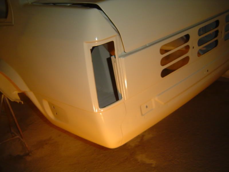

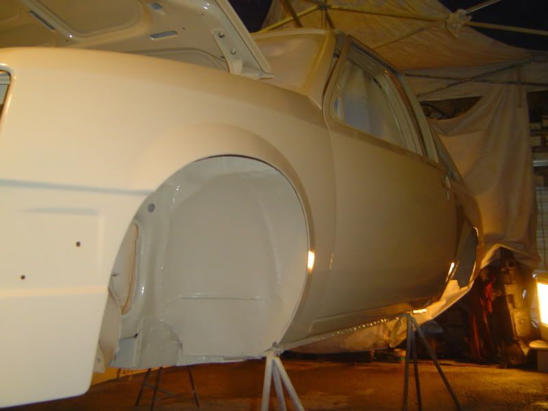

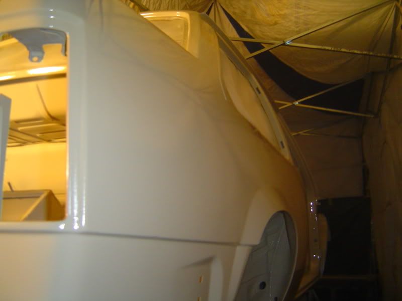

I sprayed the door inners, bonnet underside, bootlid underside and the inners of the front arches off of the car and sprayed the rest of the car
http://img.photobucket.com/albums/v1...6.jpg~original

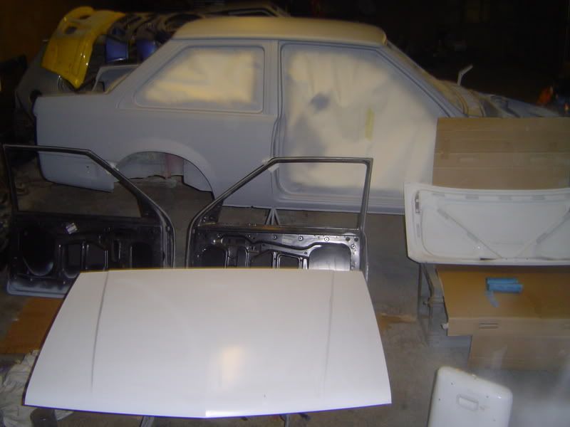

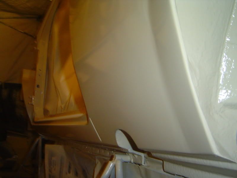

???..then fitted the doors, boot, bonnet and front wings and gave the whole lot a go over.

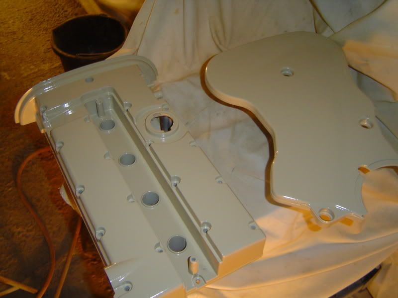

Rocker and cam cover

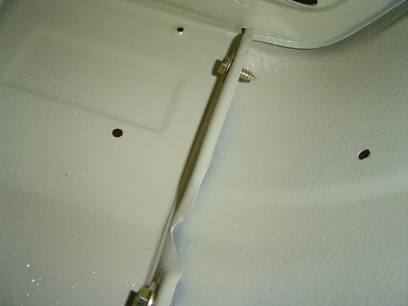

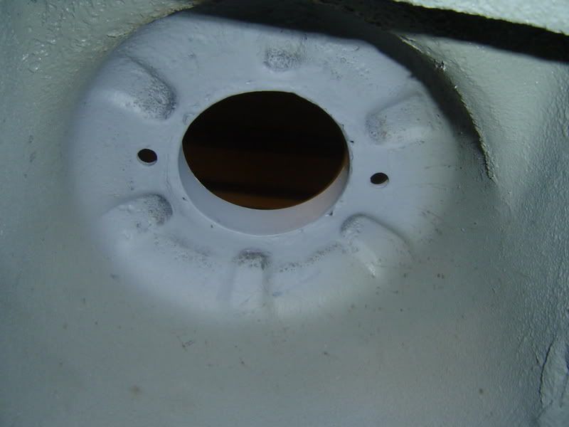

Waxoiled behind the front arch bits before fitting the wings, as this won?t see the light of day ever?
New bolts all round

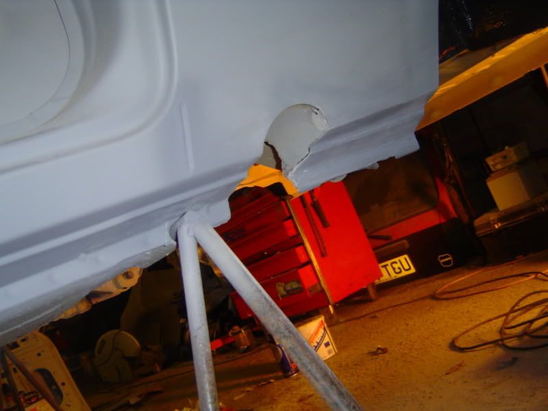

More photos to come! I?ve blocked the whole car down again with 600grit and am waiting for good weather then I?ll give it a final coat. As you can see, there are a few places which missed teh paint first time round. Also spotted a couple on dings which i've now sorted and re-primed.
